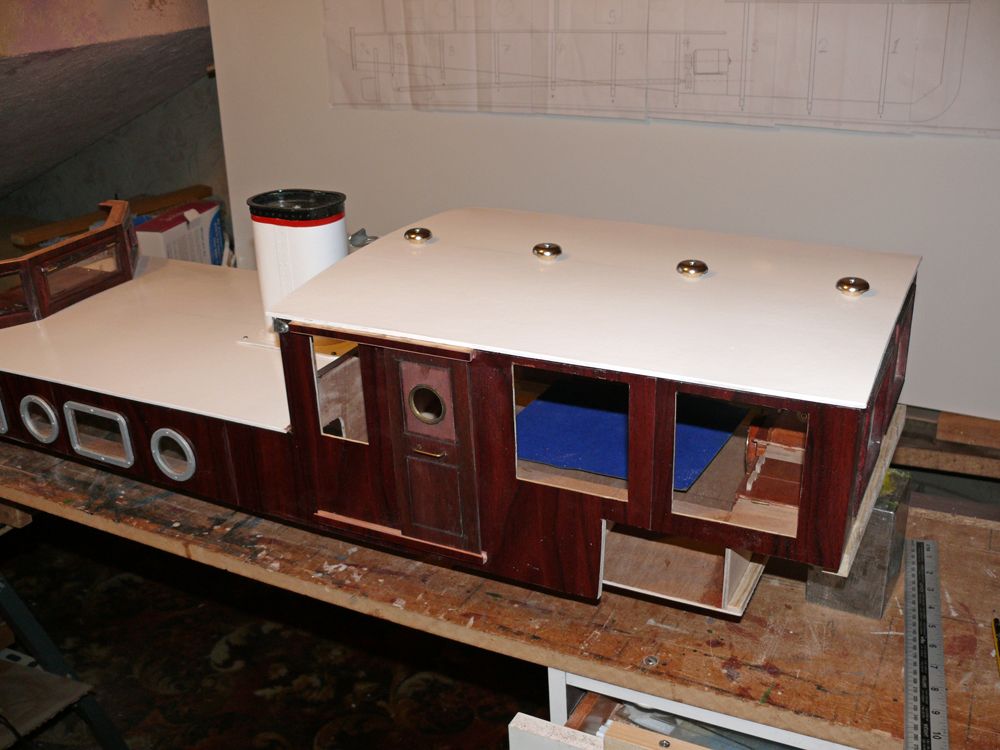

                  A bit of light relief from all that heavy motor talk
                  Working on the cabin section again
                  Air vents………Which are actually furniture feet……Supplied by the intrepid Duckie

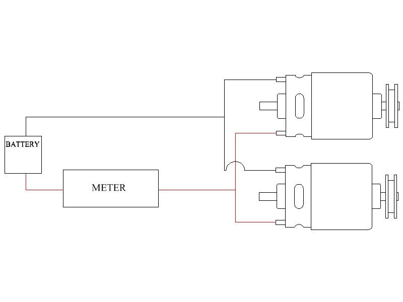

                    #57231
                      Hello Paul
                      Do you agree with the wiring diagram I proposed the other day?
                      #57232
                        Hello Bob
                        To prevent any further prolonged debate perhaps we should follow a simple diagram.
                        I think that the following is what you are talking about.
                        Remember that the boat must be fully ballasted or you will just be wasting your time
                        Edited By Paul T on 13/04/2015 15:43:31
                        #57233
                          Hello Paul
                          Thanks for the diagram
                          I propose the battery wires are extra long so that the Wattmeter can be hand held and then the wires can go back to the boat in the pool
                          We will do the test….As is……Then repeat it with the extra ballast and see what the difference is!
                          And repeat the test…..Pushing against the pool wall

                                  I have been trying to avoid getting involved in this debate as there is a lot of misleading and irrelevent information flying backwards and forwards. However I just could not resist joining in.
                                  Bob,
                                  Do the test as Paul suggests, one battery supplying two motors in parallel with the wattmeter reading the supply voltage and total current taken by both motors. This will give you your highest current, worst case load on your speed controller. Assuming that your VGC is currently ballasted so that the propeller is fully submerged and does not cavitate at max power, I am willing to bet there will be no significant difference in the wattmeter reading for your three test conditions, i.e.
                                  1 Static pushing against the side of the pond
                                  2 Accelerating from a standstill along the pond
                                  3 With an extra half a dozen bricks for ballast.
                                  What will make a difference, contrary to what Paul says on the previous page, is what type of battery you use for the test. If you use a 12 volt gel cell it will not be capable of delivering a high current because the voltage will fall off rapidly as the current drawn by the motors increases. If you use a 12 Volt NiMh or NiCd stick, it will be capable of sustaining a higher voltage as the current increases and you will be able to reach much higher current values.
                                  I await your test results with interest. I am betting no more than 10% difference between all three tests and probably less than 5%
                                  Gareth

                                    Kevin
                                    Please note that the basic circuit drawing indicates a basic ammeter rather than a fancy wattmeter.
