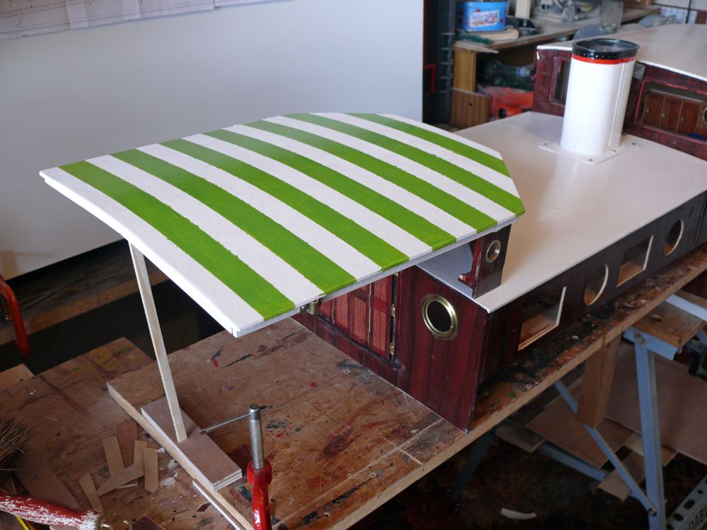

              Finally ordered the ESC`s……40amp…….With fingers crossed!
              Taken a leaf out of Ralph`s MSC book and added stripes to the Canopy

                  Ralph Pinch
                    @ralphpinch41762
                    Hi Bob,
                    She looks great in the raft, glad to see you have striped the canopy, enhances the classic look.
