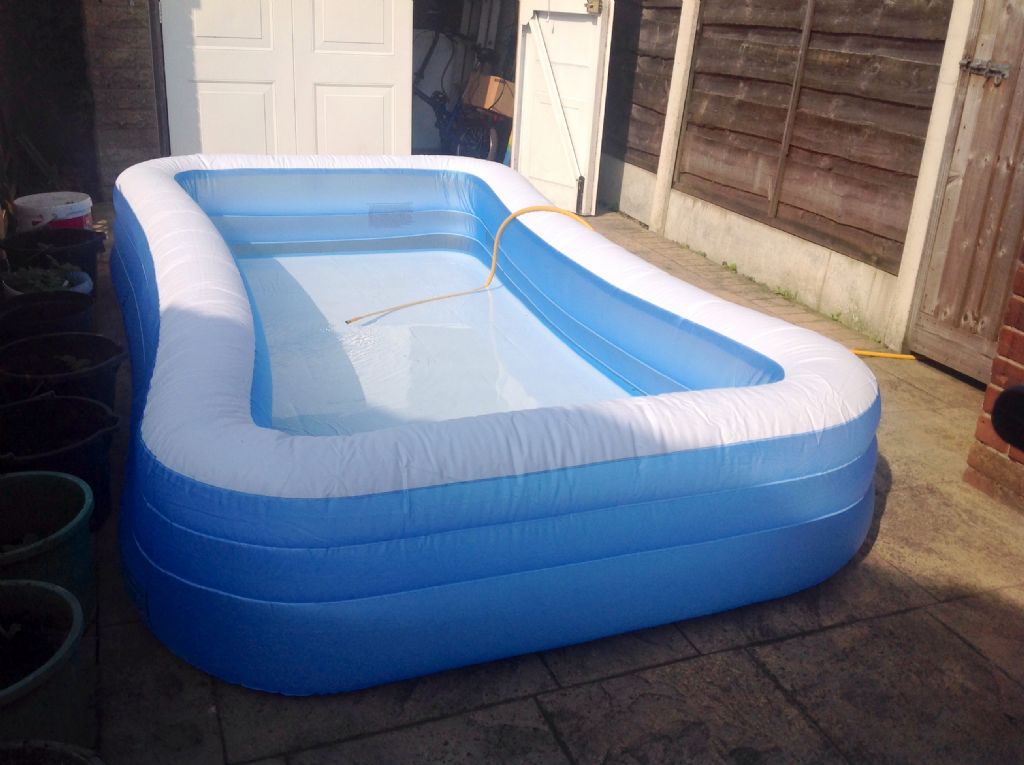

            Here we go, boys!
            Filling up Lake Coniston at the moment…………..( I live on Coniston Close, you see )
            It taking 30 mins for the water level to rise 50 mm
            We might have a floatation test this evening

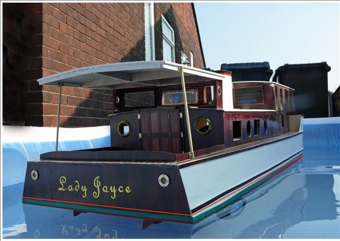

                    Test results
                    One 7.2v battery driving one 850 motor, with the other motor being back driven, gave a reading on the Watt Meter of
                    17.5 amps…….With the prop running in fresh air, the amp reading was about 8 amp
                    With a fresh 7.2 v battery,……..The motor ran at a useful speed for at least 9 mins, before we switched it off, as the motor was quite hot
                    One 12v battery driving one 850 motor, with the other motor being back driven, gave a reading on the Watt Meter of a whopping 32 amps!
                    Photographs to follow

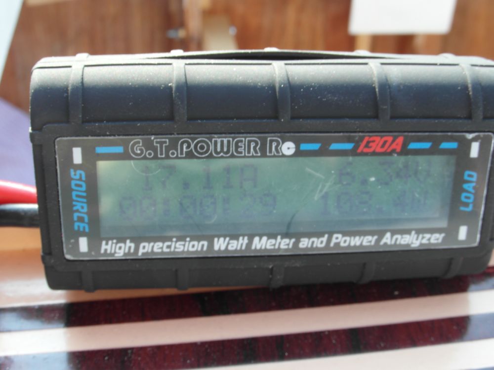

                                We disconnected the idle motor by removing the belt and the amps dropped by only one amp!
                                At the moment, I`m going for the 7.2volt option with a 40amp ESC driving two motors
                                With a 10 minute flatout runtime which will probably span out to nearly 20 mins when the other motors share the load, is ok by me
                                It was interesting to note, that one motor powered the boat quite nicely…….So four motors should be quite exciting!
                                The Sun was exceedingly bright and reading the Watt Meter was quite difficult, Duckie took a photo of the readings
                                The waterline with no ballast was nearly correct at the stern, but about 1" low at the front
                                The model was lovely on the water and was very stable and didn`t want to wobble about
                                Sample photo….

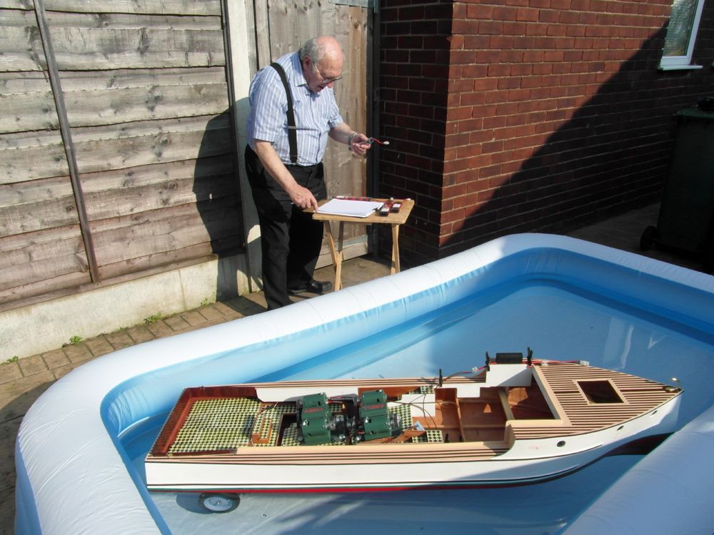

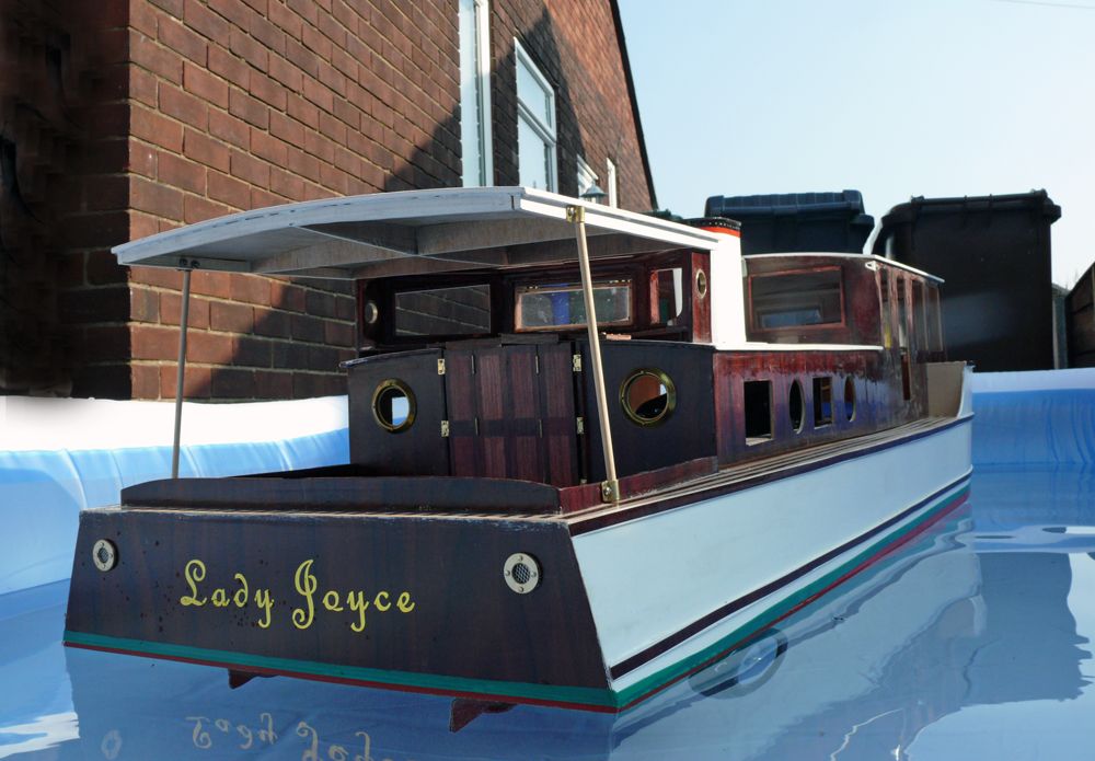

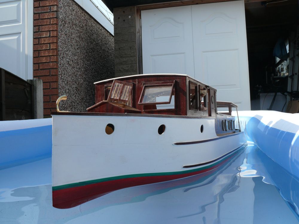

                                      More pictures of the lovely great fun day!
                                      The Watt Meter has still got it`s protective plastic cover on, otherwise the figures would be much clearer
                                      More pix to follow tomorrow

                                        Missed a picture out….
                                        Showing the gentlemanly prop wash and Bob trying to read the Watt Meter
                                        Had to drain the pool…..As the Wife had visions of finding a dead cat in the pool….Tomorra morning!

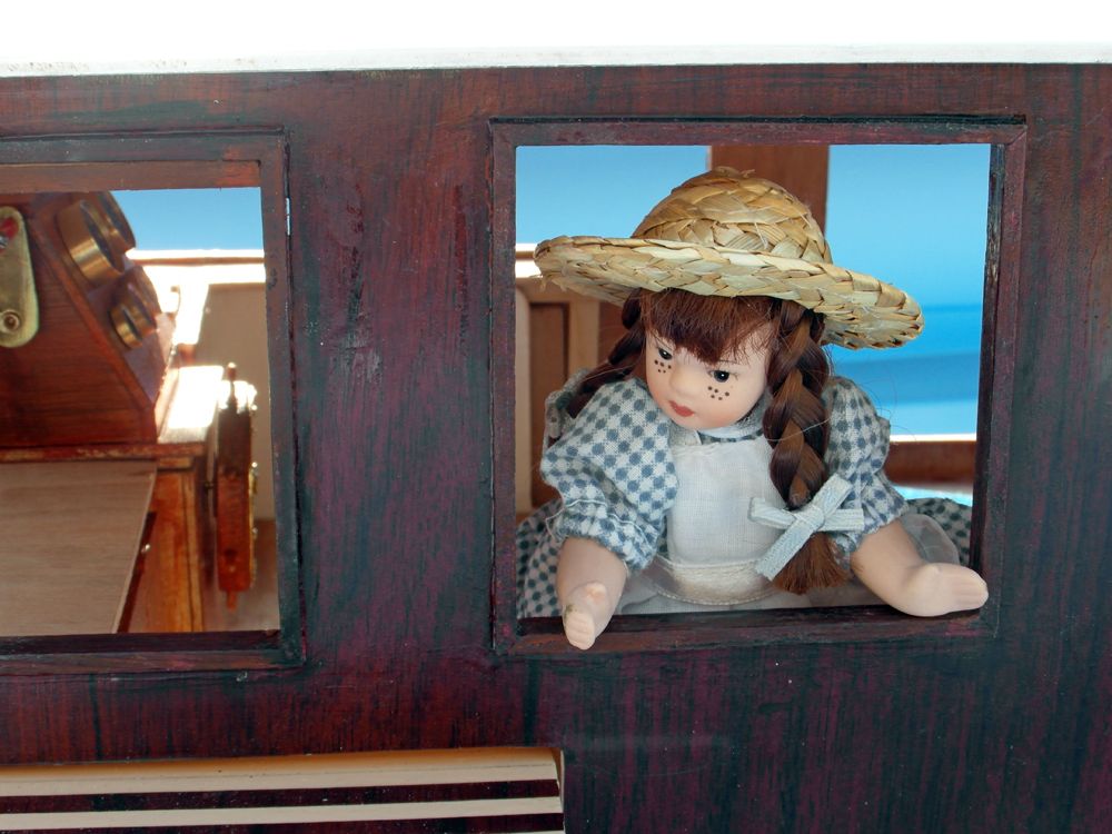

                                          Kevin requests more pictures please
                                          Happy to oblige, old chap!
                                          Phew!….It was so hot, we had to open the windows!

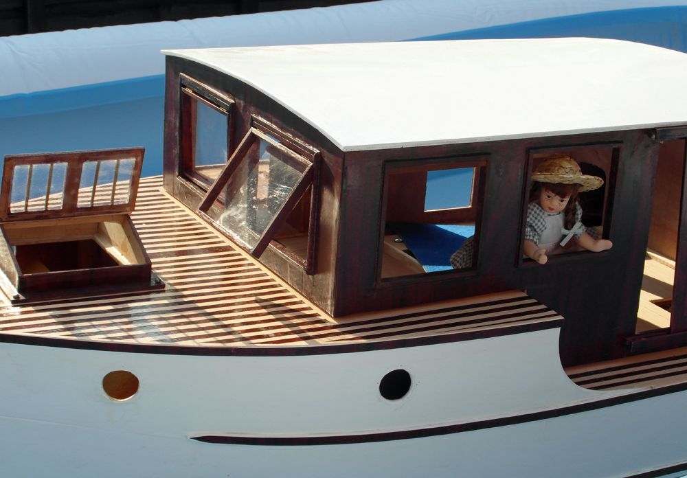

                                            More pix…
                                            Duckie`s been mooching round the junk shops again!

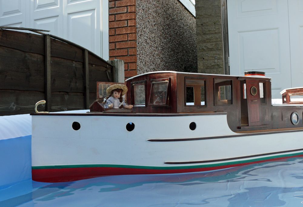

                                                    You seem to have had a lovely time messing about in the sunshine and the Lady Joyce looks great in the water but I am sorry to say that I am the bearer of bad news.
                                                    Sorry old chap but the waterline on the Lady Joyce transom is lower than designed.
                                                    The design depth for this hull is slightly above the green line
                                                    #57163
                                                      It's not bad news at all, Paull……..You exaggerate
                                                      There's no ballast in the hull at the moment and depending how it sails round the lake, we may not add any
                                                      We checked the hull for stability and wobbleness in the pool and it passed with flying colours
                                                      Haven't ordered the ESC's yet…..I was expecting some technical comments first
