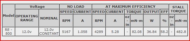

                                  What is the advantage of using 800 motors?
                                  #57002
                                    The advantage is they only rev to half wot an 850 revs to, and take half the current. One 800 or 850 will turn a 50mm prop easily. The are identical, can-wise so you can swap them over dead easy.

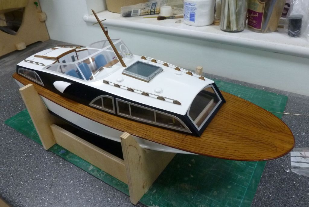

                                                Shemarah weighs about 65 lbs fully ballasted and is powered by a single 12 volt 7.2 amp hour lead acid gel battery. As Ashley says its a short fat hull and rather different to your VGC. I am quite happy with the performance of Shemarah, its not fast but it bustles through the water, probably faster than scale speed. Heres a picture to give you an idea. I think it is at, or close to, full throttle.
                                                Gareth
