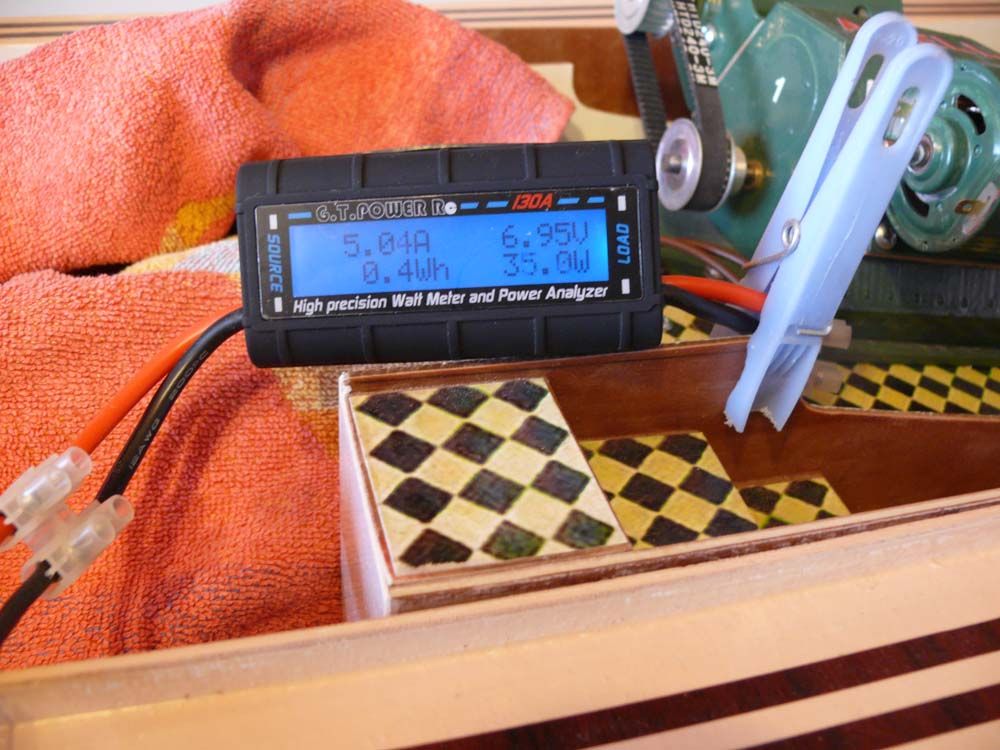

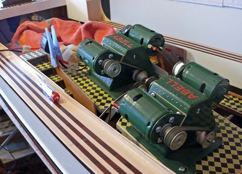

      Had a short test at last….
      7.2V Battery…… Running one motor, via the Watt Meter, driving the lay shaft, driving the prop shaft with 50mm x 3 blade prop and it all ran very smoothly and happily
      The readings on the meter were flashing about and constantly changing
      Spotted 36w and 5 amp appearing quite often
      Any comments on this?

          I'm only showing the World that I've connected the Watt Meter and battery to a motor
          Since Dave was taking bets!
          The current figures may be of interest to him

            Bob,
            Was that 5 amps measured with the prop in the water or just run on the bench?
            If its just one motor driving a propeller in free air its a pretty high current for an unloaded running case – seems like a lot of friction somewhere.
            If it was measured with the prop in the water it seems your overall power consumption is going to be relatively modest (for a complicated 4 motor installation)

                It's a fresh air test, Gareth
                The plain bearings may need running in?
                Got plenty of power to spare, anyway?

                    The dry run results could have a value.
                    You could use the figures to check how much extra power is required to turn the propshaft and see if one or both are drawing high amps, this would be a useful indicator for misaligned bearings or a bent shaft.
                    Run each motor individually (not connected to the belts) to see what they draw. Connect one motor at a time to the belt and propshaft to see how much the draw increases.
                    The set of four results should be consistent but if they are not it would be a good indicator of where a problem is.

                                Just managed to do a quick check with Shemarah still in its box. On 12 volts, it took 1.9 amps / 21 watts. It has an 80 mm 4 bladed propeller. The belt drive is the standard MFA unit with ball bearings on the layshaft. The propshaft is a sealed Raboesch unit.
                                Maybe you need to run your system in and put a bit of oil on all the bearings. If you are losing 36 watts on all 4 motors your passengers will be nice and toastie warm inside, but your batteries might not last as long as you would like.

                                        One MFA850 motor running light uses 1.7 amps
                                        #56967
                                        shipwright
                                          @shipwright
                                          The data for an 850 is here :
                                          You can see that MFA 850 spec says that on no load the MFA draws 1.9 Amps at 9778 rpm with v = 12 volts …… so assuming that Bob is running his 850 off a 12 volt battery his result is close to the nominal specification. At maximum efficiency the motor draws about 11 amps (with 12v supply) though note that maximum efficiency is only 62% (so nearly half the of the electrical power input is wasted).
                                          Ian

                                              I've got the shafts out at the moment, filing the flats on them for the pulley grub screws to bite onto
                                              The motors are very well behaved, surprisingly…..There's no fierce running at all and is very pleasant to switch on and off
                                              Ideal for this type of boat
                                              I think twin motors in line would be ok too, as opposed to my side by side arrangement

                                                  Hello Paul
                                                  Starboard line
                                                  One motor powered….One motor back driven………..One 50mm prop
                                                  8.1 amp……6.1v……..48 w
                                                  Same test
                                                  One motor powered….One motor not connected……One 50mm prop
                                                  4.9 amp ……6.1v………36 w
                                                  So it takes 3.2 amp and 12 w to back drive idle motor
                                                  So if the RH stick controls motors 1 and 2……..There will be no back driving, as both motors will be driving RH prop
                                                  Edited By Bob Abell on 01/04/2015 20:35:08
                                                  #56978
                                                    Hello Paul
                                                    Ran test No1 again
                                                    Same readings
                                                    Then powered up No 2 motor……….Twice the power and sounded powerful too
                                                    4.0 amp………………………………………24 w………..On the one motor
                                                    Success!
                                                    PS The thread has had 350 views since last night!
