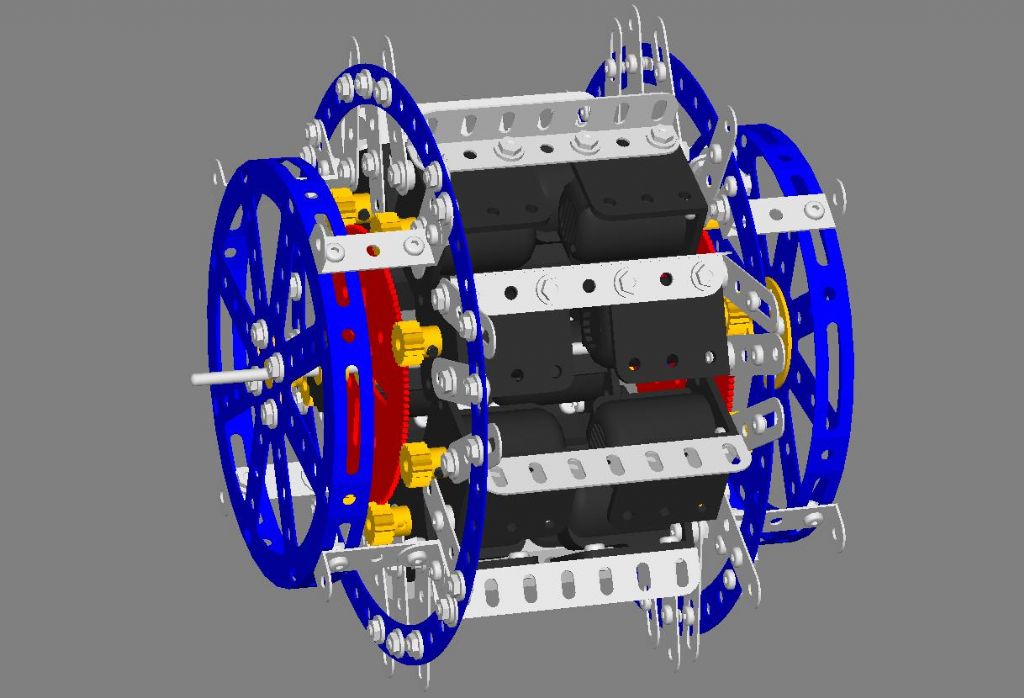

                  A motor fit for a Queen!
                  "The Lady Jane" cruiser in fact!
                  Paul`s latest creation, the Vintage Gentleman`s cruiser deserves an impressive motor
                  A motor that we would enjoy showing our fellow modellers with pride, at the pond and at shows!
                  The actual working motor drive for the model would look even more impressive, with brass handrails etc and some Bling……Dial gauges would look nice?
                  Paul……………….I`ve decided to build the model afterall! ……..Being a glutton for punishment…………….We had so much fun building the last three models, I suppose I`m hooked now?
                  PS……I've forgotten to show the prop shaft…..Use your imagination

                    Nice looking power unit , Hints of a big V8 driving twin alternators.
                    Motor detail on the big block and it will be a masterpiece. I wonder if I can find a 1/12 scale model of a massive V engine ?

                      Thank you, Mike
                      I've been thinking about this idea for some time
                      It should like quite nice in the model, as long as the wiring and stuff is neatly laid out?

                        If you designed that engine with the electric motors under rocker covers, it would have a real feel to it .
