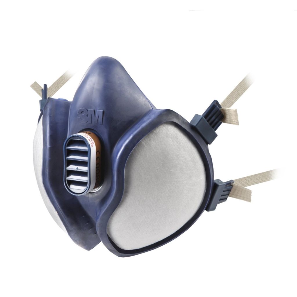

                                Hi Bob
                                With the kind of work that you are doing the minimum requirement would be what is classified as P2 but I always use a P3….this is the amazon link for the P3 **LINK**
                                71bonurbhul__sl1500_.jpg This is the type of mask that I use as it works with fine wood dust and paint fumes
                                This link is the HSE factsheet for dust masks used in the construction industry. **LINK**
                                Edited By Paul T on 26/05/2014 16:13:54

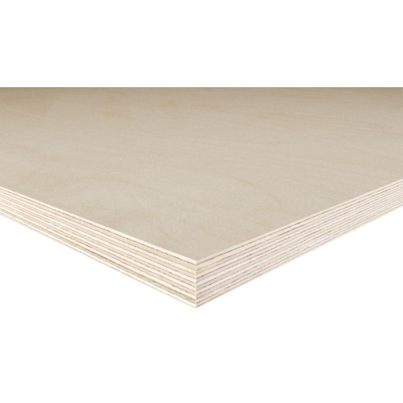

                                      This is an image of the plywood that I think will be best for the keel and frames on this project.
                                      This plywood has great strength owing to its multi laminations and the quality of its construction ensures that the individual veneers are sound, glued and compressed together correctly.
                                      Yes it is expensive (but cheaper than marine ply) and you don't want to cut corners on quality when building a model of this size.
                                      #49171
                                        Looks lovely plywood, Paul, but it'll be more than likely to be bowed!
                                        Much better to glue two sheets back to back
                                        #49173
                                          This ply wont bow, it is a quality product that will stand up to a lot of abuse as it is made up of top quality veneers and glues that have been pressure clamped together.
                                          #49183
                                            As usual you point the way forward as not everyone will be willing to spend money on expensive plywood especially when they can double up with thinner cheaper alternatives.
                                            #49184
                                              Well, that's very noble of you, Paul
                                              I would have used the cheap stuff myself and taken the bow out by glueing two layers together
                                              It does produce dead flat and extra rigid formers and keels, by that method
