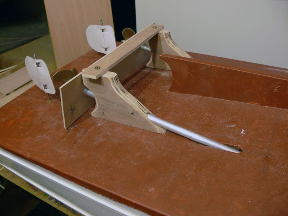

          Work in progress………Sorting out the prop tube alignment and the rudders……Great fun and very interesting
          The cross pieces are for setup purposes and will be removed later
          The tube supports are tall and can be used to rest the hull on the bench and will also protect the props…… The stand is not required now
          They will also be used for rudder supports
          What do you think of it, Paul?

            The propeller shaft / rudder support look ideal but the design does leave an awkward gap between the hull and tube
            The rudders look great with the large surface area and should provide plenty of turn even at low speed.

              As a matter of fact, I did take the supports all the way back originally and covered the tube completely, but it looked very bulky
              Luckily, it`s out of sight normally

                I understand what you mean about the piece being bulky if extended to cover the tube, would you consider filling the gap with P38 and blending it into the tube.

                          Dont like the prop shaft supports. All that turbulence destroying good water flow!!! would sooner see just a wide normal plate skeg possibly exptended upwards if you want to protect the porps and so on. (personal opinion)

                            I don`t like them either, Ashley…………..Back to the drawing…..eh?
                            The problem is caused by the shallow stern…..ie….No rudder support……..Similar to Brutus
                            Got an idea………Small removable stand at the rear only……..(No room in the car for the big stand)
                            Now the prop supports needn`t be so strong

                              How about a good old vintage "wire" approach??? would look very period suiting the boat and also lending a period feel to the build. You know what I mean, noit exactly coathanger wire, but something, looping from the end of the rudder posts over the props??
                              #54636
                                Have you got a picture of the good old vintage wire approach?…..Or a few more words?
                                I could easily invent a brass wire contraption, but would prefer something historical

                                  I quite like the tube supports, they serve a double purpose and have a stylish shape.
                                  They might look bulky but don't forget that this is a big boat and these parts will provide excellent protection for the props and rear half of the hull.

                                            If Paul likes the tube supports……That`s good enough for me!
                                            I think we can afford some inefficiency as the benefits are worthwhile, but I will streamline them some more
                                            They are not glued down at the moment, but we can see better when the rudders are in situ

                                                      Latest work in progress to stimulate some light hearted banter
                                                      I like a sturdy rudder support
                                                      I also like the idea of the joining the columns together and a length of screwed rod and a few nuts will fit the bill nicely……..May be a good weed catcher though
                                                      A good coat of paint will also improve the appearance
