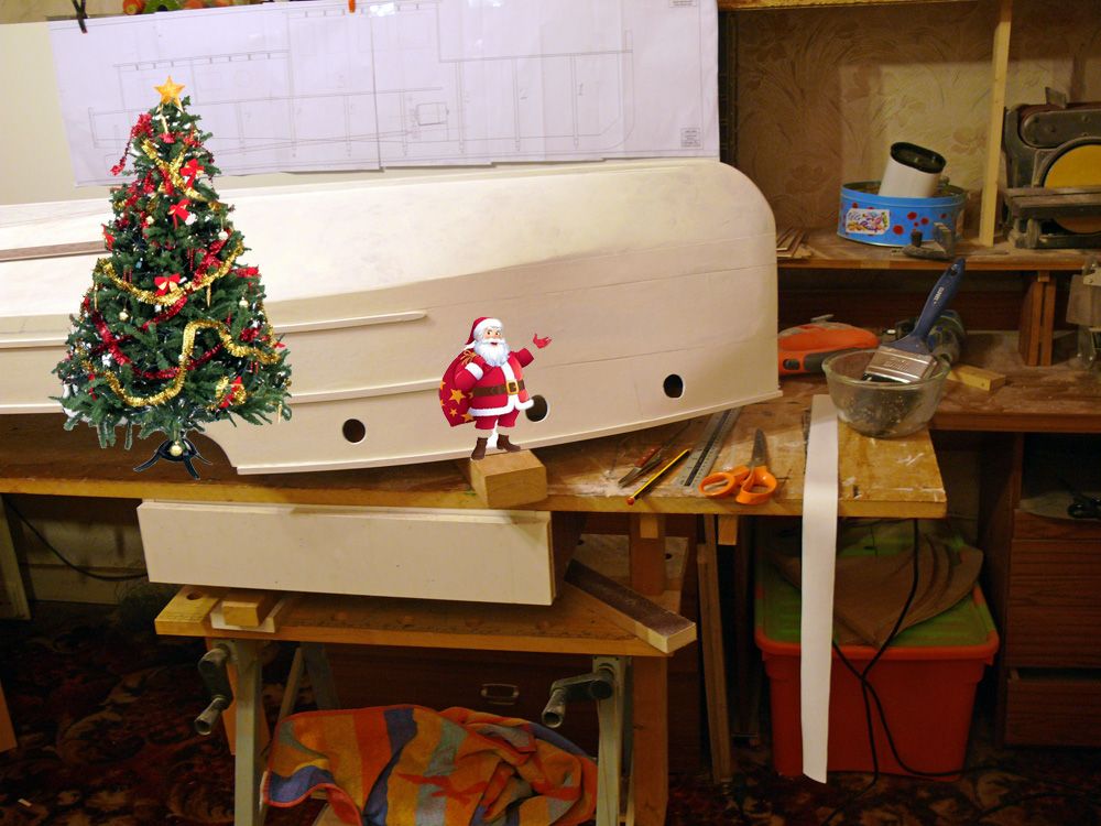

                        With the help of Santas gang of Elves, on time `n `arf………We soon had the bows covered
                        Rudolf

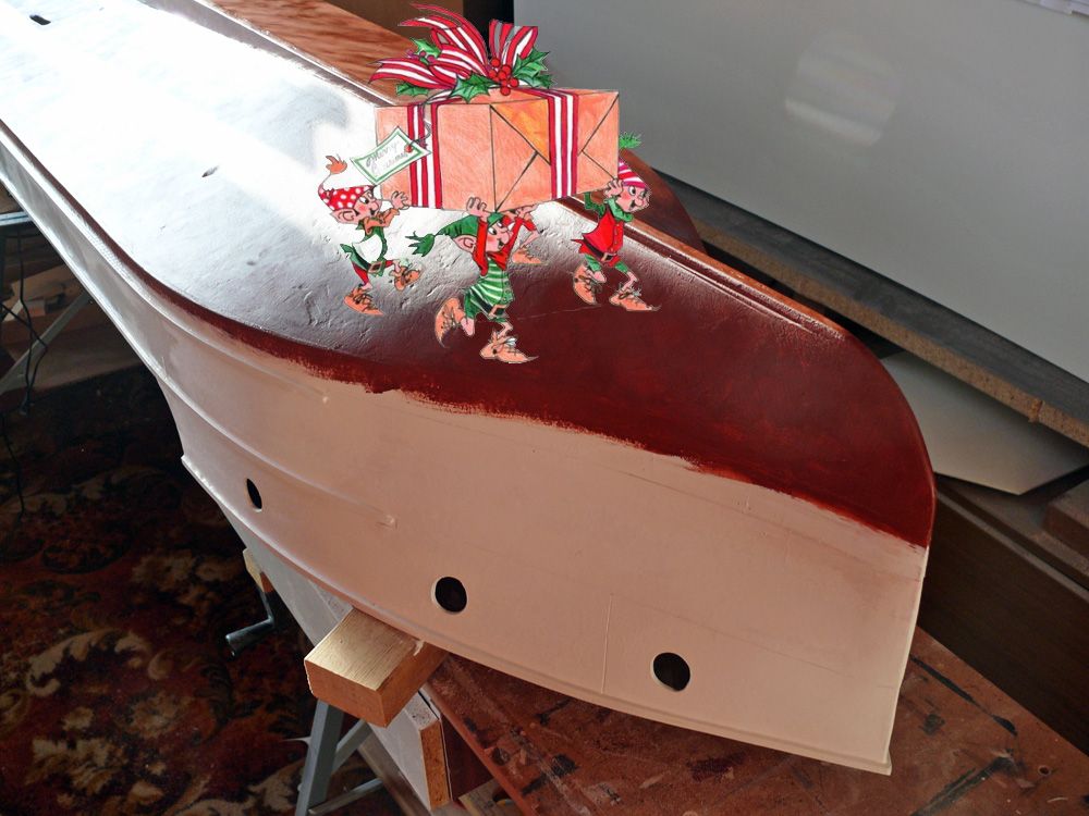

                        #54579
                          Continuing the Festive Season of fun with another consignment of paint and brushes for the paint shop
                          Gave Lady Joyce`s bottom a coat of red oxide…..Just for fun
                          If it wasn`t for the propshaft holes, we could have towed her round the lake today, since it`s the club`s Frostbite Sail event
                          It`s a nice idea though……..Pal Duckie has got a Wyeforce Tug that would do the job nicely………Would make an exciting photograph and video
                          Next job……Get the propshafts installed
                          You were nearly right with your prophecy, Paul!

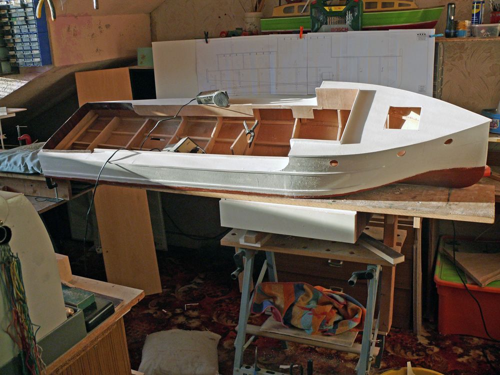

                                            The first coat of gloss has dried nicely
                                            Now working on the rudders
                                            Paul, for your records, the propshafts are 180mm apart and the rudders are 75mm from the transom face
                                            Your side elevation shows the rudder and prop protected from knocks by the keel skeg, but on the twin version to gear is sticking out like a sore thumb!
                                            Suggest we build a short length of skeg in front of the props, which will allow the hull to stand up without a stand and the bottom edges could be used to bolt on bottom rudder supports
                                            I`m pleased you like the idea, without it…..We`ll be Goosed!
