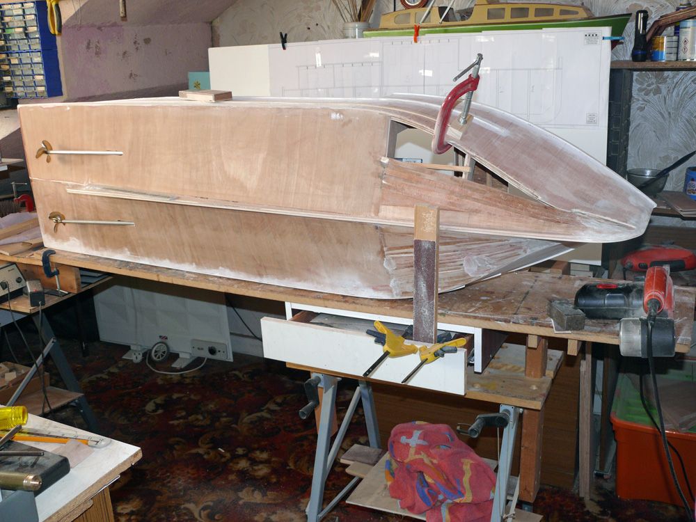

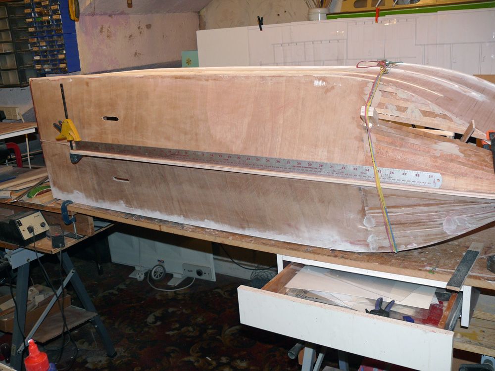

              Hi chaps
              Decided to finish off the hull planking at long last……Not been touched since last August!
              Lady Joyce`s bottom………Ahem!
              That`s a twelve inch rule on the keel……Ahem!

                Has anybody at the club looked into the elf & safety implications of this crane? does its operation fall under the LOLER and PUWER regulations.
                Bob your latest photo shows how angles can produce optical illusions………the keel looks curved.

                  #54471

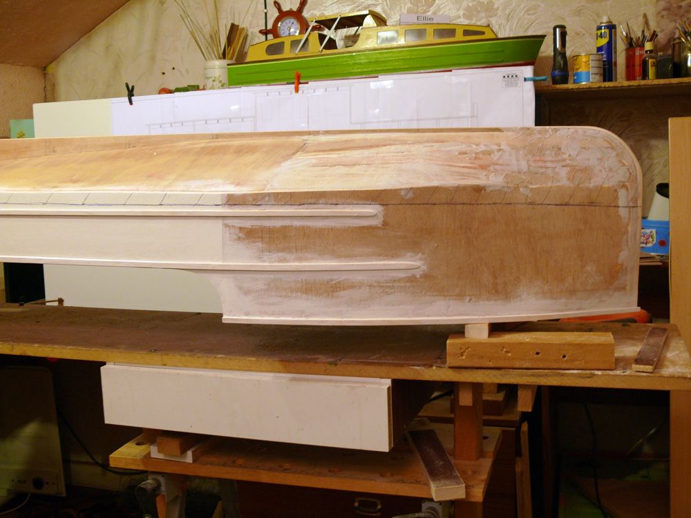

                    Hello Paul
                    The keel did look a bit propeller shaped, but I think it was just an optical illusion
                    Is this any better?
                    #54474
                      I am afraid thats no good bob, using a bent rule…..
                      #54475
                        That looks a lot better.
                        I know that Bob doesn't have a bent ruler as he lent it to me for my banana boat.
                        #54477
                          Hello Paul and Ash
                          The keel has a 0.020" bow in the middle and looking down the keel with one eye…….it looks awful!
                          Will have to sand it away

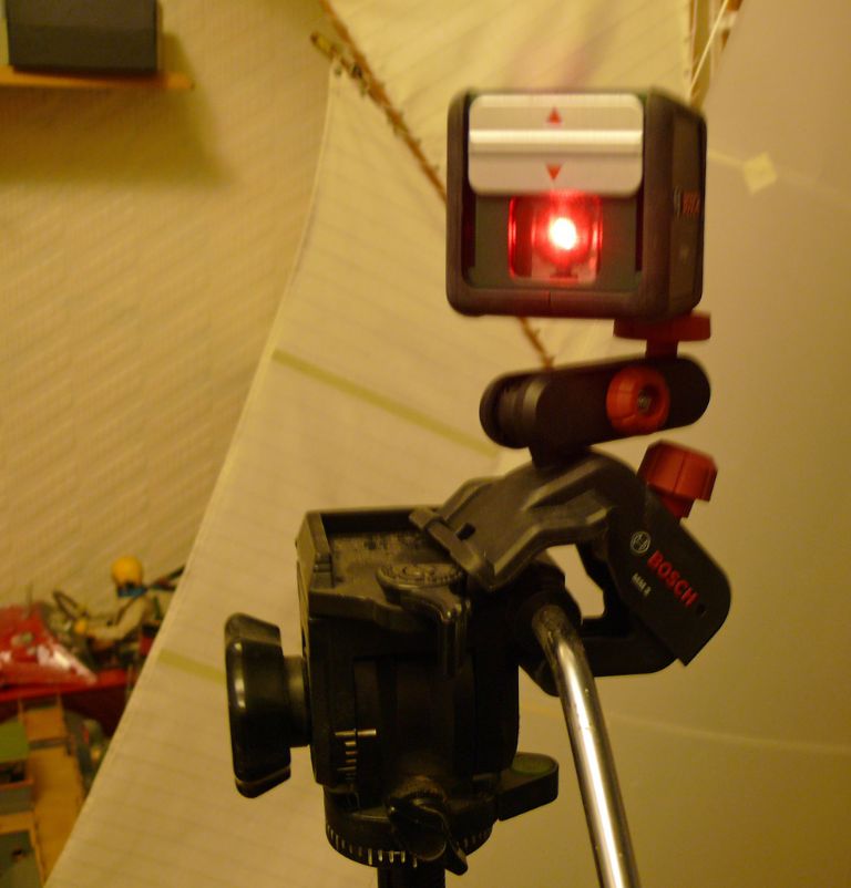

                                  I've got a Lazar beam thingy and would like to see the run of the waterline
                                  So I've got 13mm at the transom end…..Where is it at the pointy end?…..Please

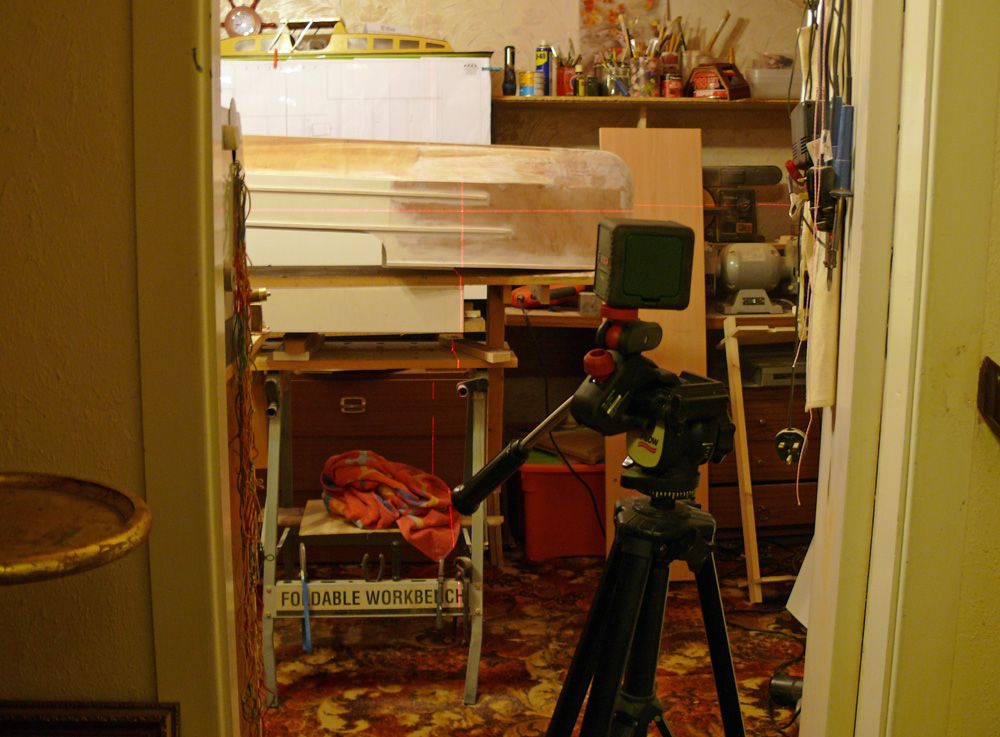

                                    If Colin thought that using a Bandsaw was a bit OTT……….Then take a look at my next offering!
                                    A Lazer gadget!……..WHAT?…..I`ve seen it all now!…….What does it do?……He asks excitedly
                                    It projects a vertical and horizontal beam of light!……From here to the Moon and back!
                                    I want to see if the edge of the hull at the rear end is in line with the curvy edge at the front
                                    I`m sanding the curvy line at the moment and can adjust it, in the process
                                    And can also project the waterline for the red painted area………As the bath is a bit small!
                                    Exciting clapping and roars of approval………Heard off stage
                                    I`ve been dying to use this gadget since last Christmas!
                                    Capt Bob……Having fun!

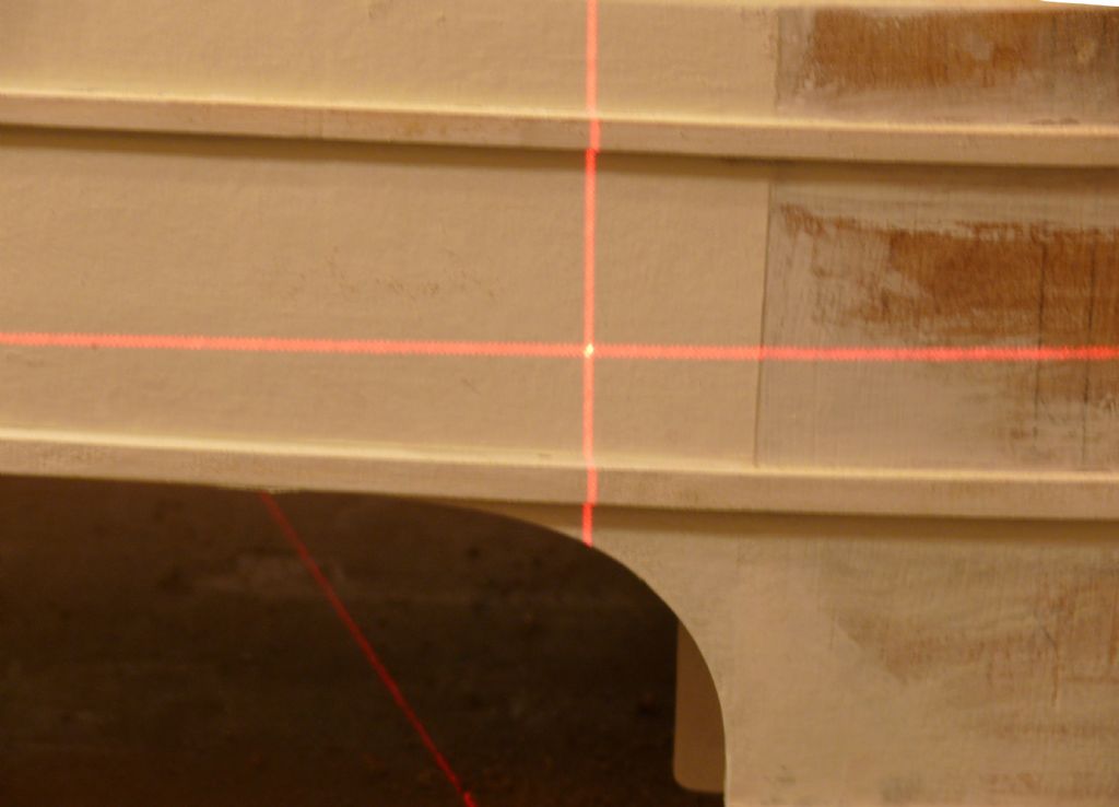

                                    #54489
                                      Your floor isn't level, Bob.
                                      Paul – check out the Darwin Awards then reconsider your last statement.
                                      #54490
                                        Proof of the Christmas Pudding!
                                        The curvy chine is slightly out…….Which is nice to know
                                        Need the waterline position at the front please, Paul…….Or post me sheet 22 please
                                        Many thanks to Duckie for the Lazer machine…….( Last years Christmas present )

                                            The waterline at the bow is 112mm from base of keel however an easier way for you to establish the waterline would be set the boat on its keel and use your new toy to transfer the mark from the transom.
                                            Even in the face of adversity and despite the often overwhelming evidence to the contrary I still stand by the statement. If we were all the same it would be a boring and very short existence but whilst you are such a philosophical mood please consider the following….. 'does evolution go backwards aswell as forwards'
                                            #54508
                                              Thank you, Paul
                                              I can measure up 112mm up at the front and mark the position and mark the transom point and simply project the lazer beam to join up the two points
                                              #54509
                                                As you have a laser there is no need to play join the dots.
                                                Simply wedge and adjust the hull until the keel is level and then use the laser as a perfect straight line to establish the waterline by transferring the mark on the transom to the rest of the hull.
                                                #54510
                                                  I mean…..Join the front dot to the transom dot……..And I`ve done it ok
                                                  I just marked a few dots all along the light beam and Bob`s yer Uncle!
                                                  Is the chine supposed to be level with the waterline?

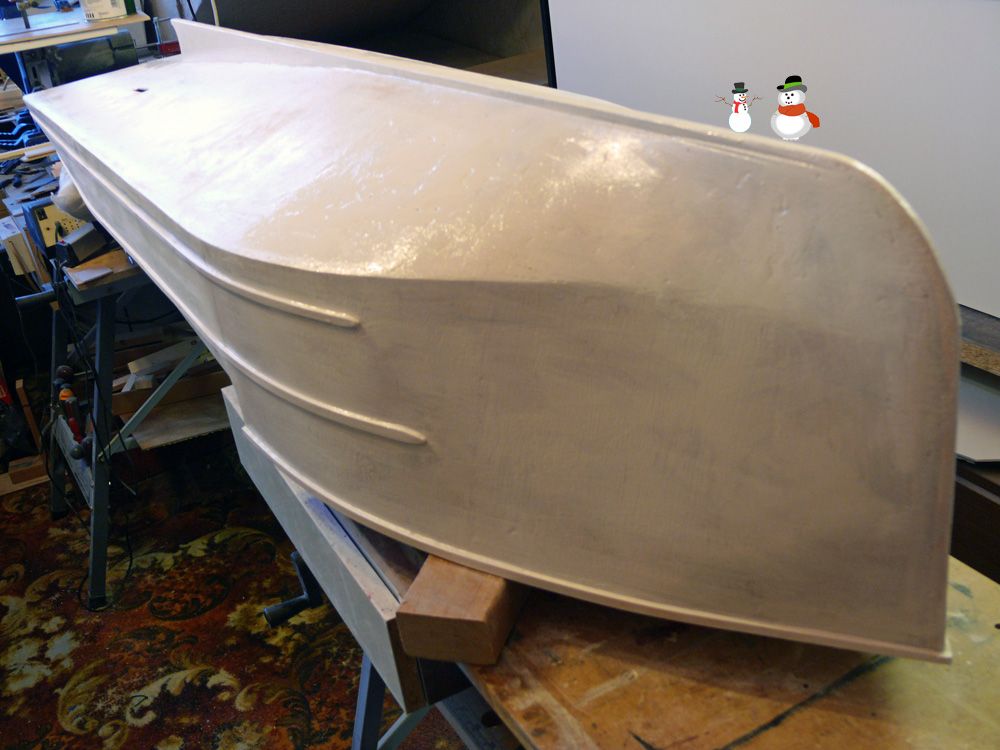

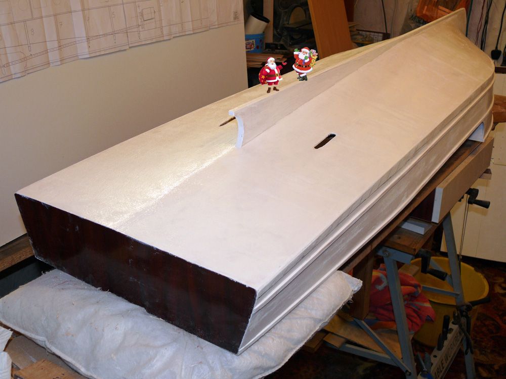

                                                      Latest work in progress
                                                      Nothing too exciting at the moment
                                                      Finished the planking and filling now onto the painting
                                                      Won`t be papering her bottom afterall, as there could be a problem, should the surface got scraped and let the water in?
                                                      Well it`s Christmas Eve once more chaps, how time flies?…… Paul and Capt Bob hope you all have a nice Christmas and a happy New Year
