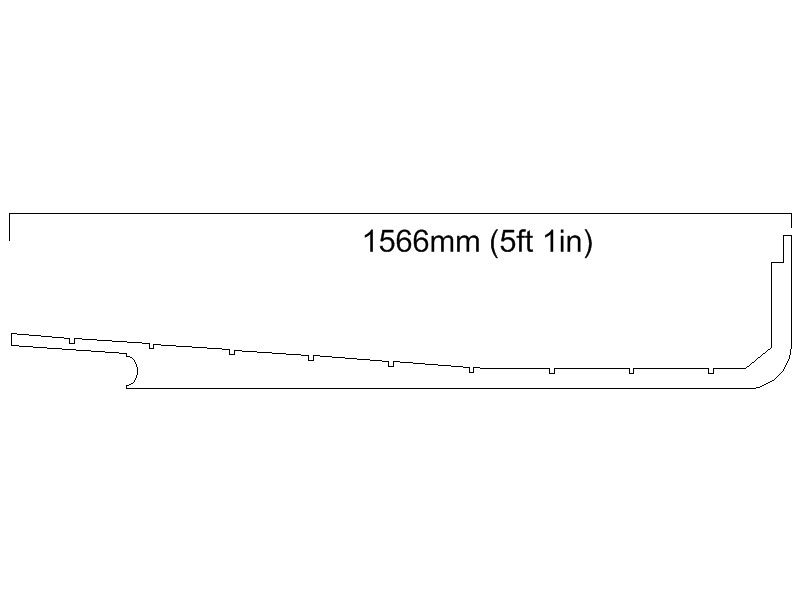

                                Now that we have done health and safety to death (pardon the pun) its time to get back to the project.
                                The keel is drawn
                                But how do we choose the correct material to make it from…..bearing in mind that the main frames will also be made from the same material.
                                What do the readers think is the best material?
                                #49134
                                  Paul……In view of the H & S implications, I would use several layers of Birch ply and PVA glue?
                                  Are you going to use the central spine idea, as we did for the Brutus build?

                                      The material for the keel and frames has to be strong, sound (no holes or gaps in any laminations) rigid enough to remain straight but not oversized as we have to consider the overall weight of the final model.
                                      This is going to be a plank on frame model

                                                  The keel will be the spine of this build and the hull will be designed to be built inverted on a building board just the same as the Ellie boats.
                                                  No this one won’t be a free flooding hull but it might have pumped ballast tanks.
                                                  The keel and frames will be 9mm
                                                  Your idea to build up the thickness using laminations of thinner ply is an excellent one as this will create a very strong and rigid structure.
                                                  Mike
                                                  I have used shuttering ply before but with poor results as the voids within the sheet made it brittle when cut down to make frames. 1in shuttering ply will make an excellent building board.
                                                  The material that I will be designing the keel and frames for the 5ft model is 9mm BB grade birch ply and the shortermodel will use 6mm.
