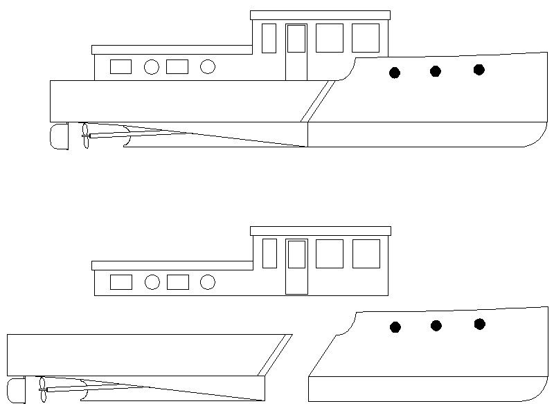

                                        #49106
                                          By introducing some diagonal rubbing strakes above the waterline it would be possible to mask a hull joint.
                                          The strakes aren't by any means part of a traditional design but they do allow a split hull to be created.
                                          What do the readers think?
                                          #49107
                                            Nit Picker to Drawing Office
                                            Going off the angle of dangle of the prop shaft, you'll have a job getting the motor in!…..lol
                                            The joint looks tricky……How does it work, when one really gets down to it?
                                            NP
                                            #49108
                                            David Wooley
                                              @davidwooley82563
                                              Hi Paul a split hull is not an uncommon feature for large warship models especially carriers and solves many of the basic logistical problems yet there is no getting away from the fact that using this method there will be a joint but as you have illustrated this can be disguised . I've encountered the problem of making joints as invisible to the eye as possible using paint lines and natural breaks . Personally I avoid jointing the hull is this way but it can be done with some degree of success.
                                              Dave Wooley
                                              #49109

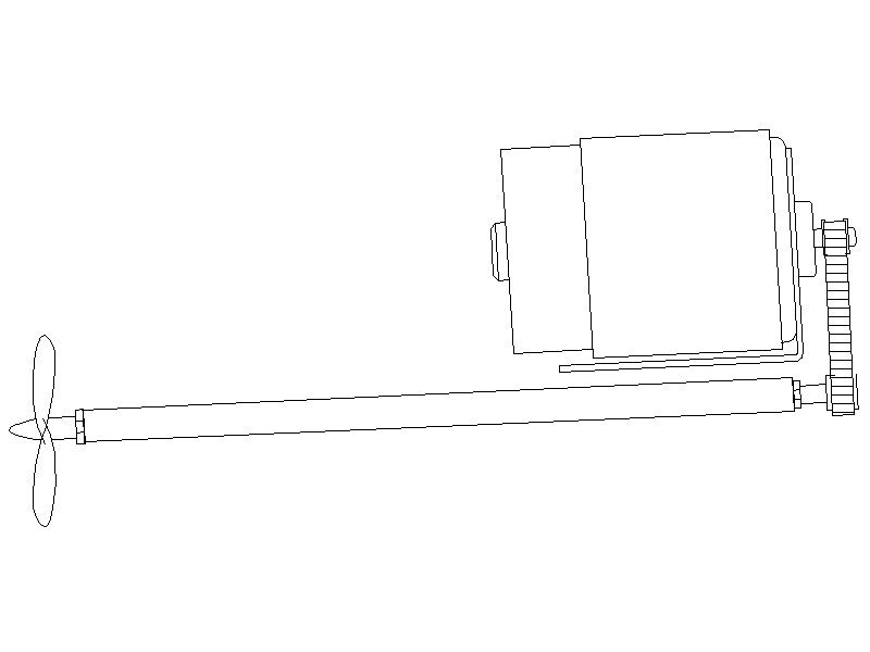

                                                From the office of the chief designer to the office of the chief nit picker.
                                                We have discussed this type of motor problem before and devised the following solution.
                                                The joint isn't really that tricky it is simply good woodwork and encapsulated bolts.
                                                I also use paint schemes to hide such joints, dazzle paint work for example is ideal for masking splits. Like you I don't like building hulls with joints but sometimes its unavoidable.

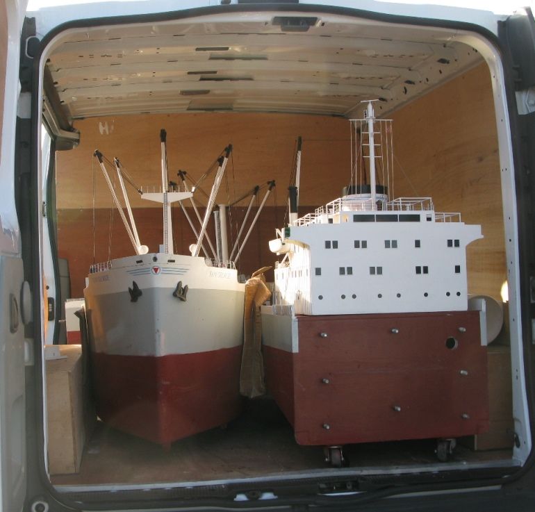

                                                #49110
                                                David Wooley
                                                  @davidwooley82563

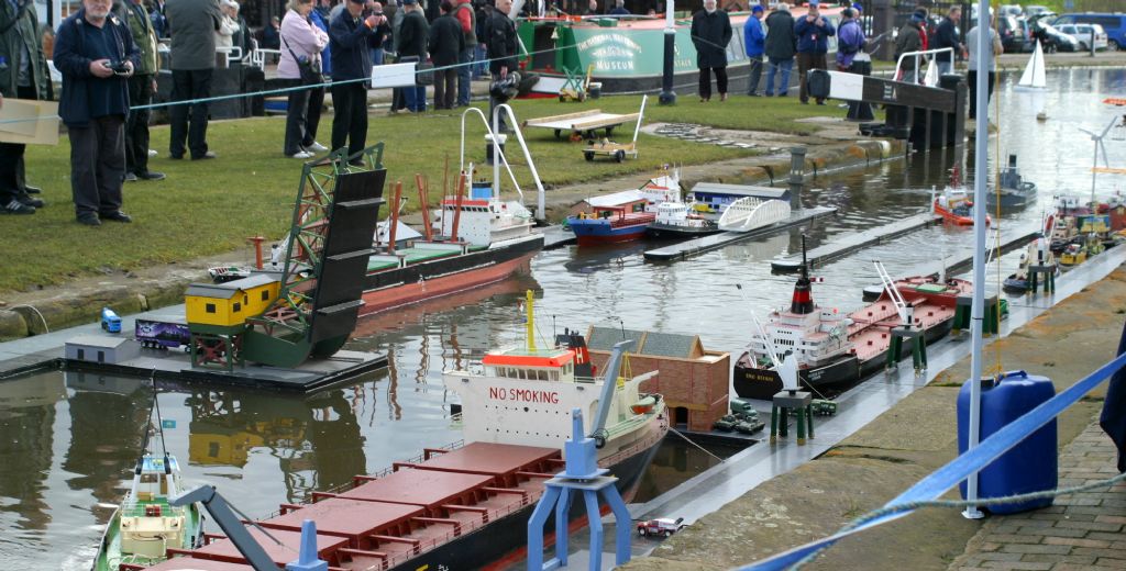

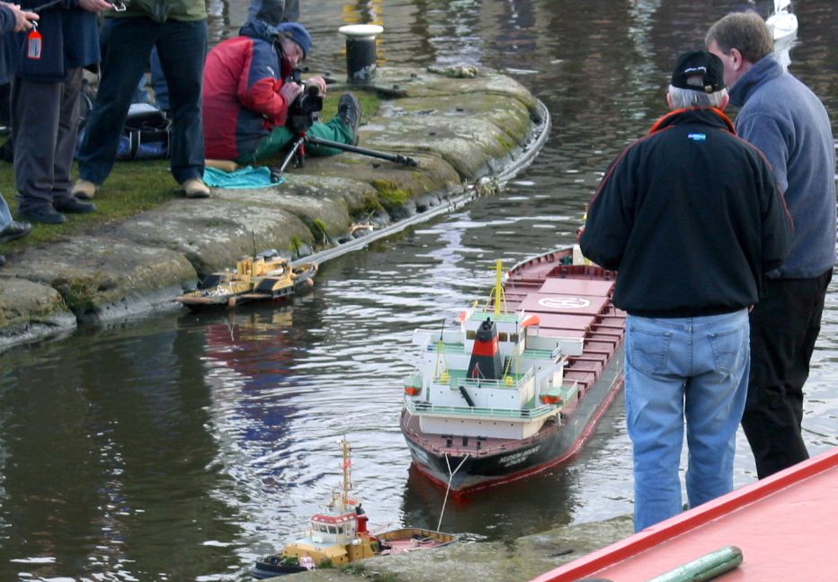

                                                  Hi Paul At the extreme end of the size scale is this 4m long cargo ship used at Ellesmere Port .it is divided into 3 sections and at a distance the joints are hard to see . Transport and ballasting for this model remains a logistical problem .
                                                  #49111
                                                    Hello Dave
                                                    I remember watching the large cargo ships during the event and trying to spot the joints.
                                                    The casters are an excellent idea for moving the sections in and out of the transport.
