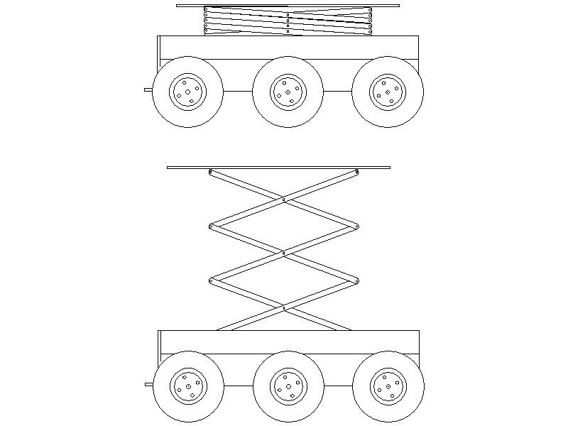

              The scissor lift work bench adaption.

                Hi Paul Well what started as a mode of transport has now developed into a multi function piece of kit .
                Now a work bench ,I can see you developing it into a test bench next .Seriously Paul what next
                Enjoying your build winkmichael
                #59132
                  Hi Michael
                  The project is to develop a multi function unit to aid the less able transport, lifting & launching and lake side maintenance are all part of the design criteria.
                  The base unit can also be used by anglers to transport heavy kit, or gardeners as a motorised barrow.

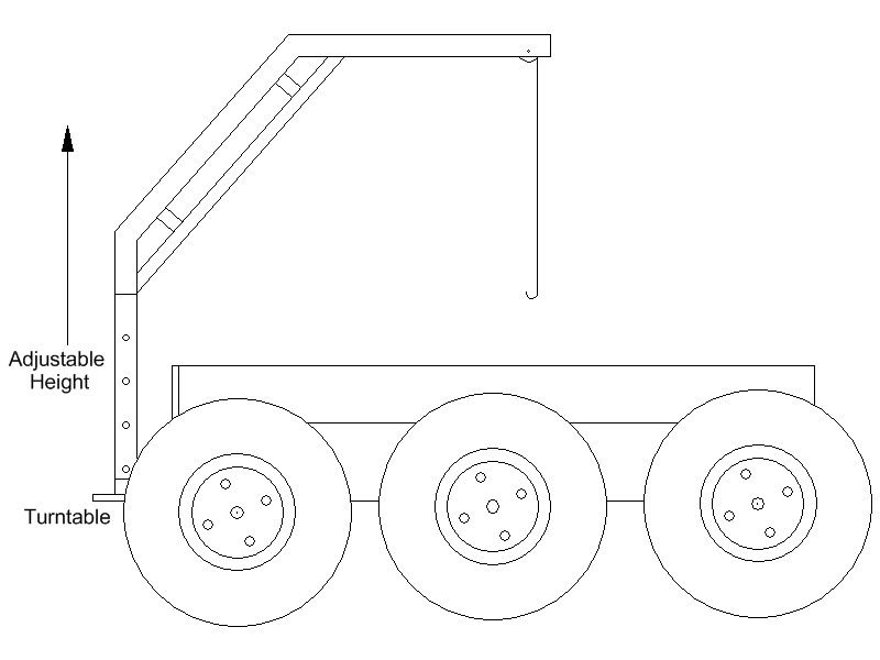

                              #59291
                                Hi Mark & Dave
                                You have both given me cause for considerable thought and taking in some of Colin & Daves earlier comments I have re-visited the design and made some fundamental changes.
                                The size of the wheels have been increased to allow for greater traction, stability and a smoother ride.
                                Suspension is taken care of by introducing anti-vibration mounts between the trolley body and the load.
                                M6 thread and solid rubber body.
                                Unfortunately these changes mean the current body is essentially scrap but if a jobs worth doing……….
