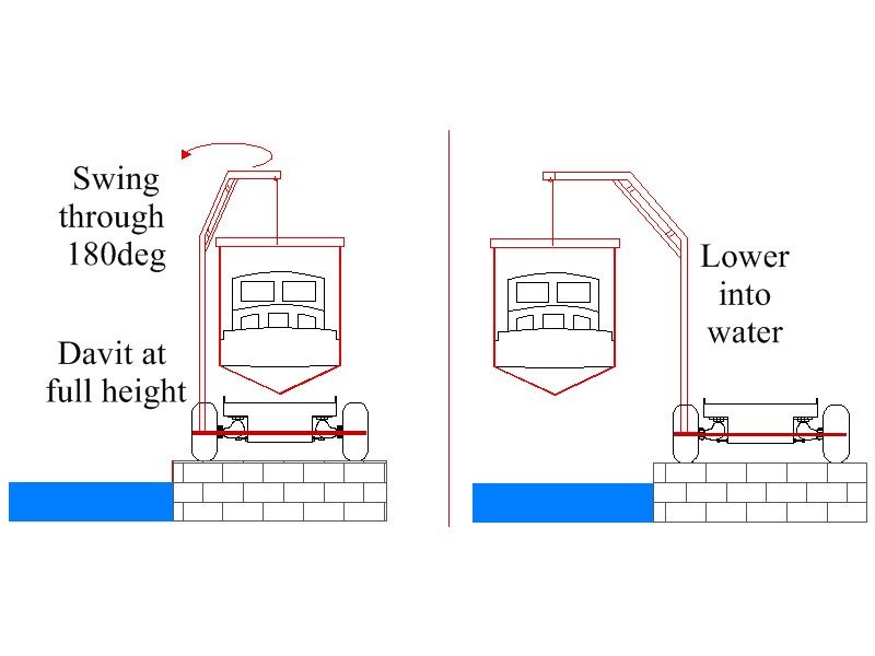

                          Here are the images that you requested.
                          The davit is at full height extension to clear the top of the boat, the Jib swl is 60kg and in this configuration the maximum recovery load is 42kg……kudos to anyone who can tell us why the recovery weight is more important than the launching weight (and its not due to water leaking into the bilges)

                            Having rotated the ship thru 180 deg……Front view is still showing?…..Get the digital Tippex out!
                            The balance still looks a bit airy to me……But it can easily be corrected
                            Is the extra load caused by the suction effect?
                              You should know better than that.
                              The lifting rig turns in relation to the position of the jib so that the mass of the load remains constant to the base, as such the bow will show all the way through the lift.
                              I am curious just how can the balance 'look' airy? all of the calculations have been done and checked.
                              Yes its due to the suction effect Grasshopper has learnt a valuable lesson.

                                Is the Davit drawn correct in both your views?
                                #58966
                                  Yes
                                  Don't forget that this is a 3 dimensional object and it is difficult to achieve a 3 dimensional effect on a 2 dimensional drawing but if you compare the side elevation you should get the idea.
                                  The long explanation is that the jib is mounted on the front offside of the trolley and in the transport or rest position the jib is at a reflex angle to the front view…i.e. part of the angled part of the davit looks thinner.
                                  Yes I know that in the side elevation drawing the example boat is the wrong way around ……this shows how versatile the trolley is.

                                    Doc Pooh
                                    I think a plan view would be most helpful…..For all concerned

                                                    Paul,
                                                    I am intrigued by your comment that the lifting rig turns in position, relative to the jib. Does that mean that the boat stays on the same heading as the jib swings round? If that is the case I can't see how the bow or stern of the boat can clear the upright section of the crane as the length of the jib does not seem long enough to allow that.
                                                    #58980
                                                    Andy C
                                                      @andyc56856
                                                      Hi Paul
                                                      Gareth beat me to it. Looking at all the pics, the boat will be too long to stay in the same position relative to the launch body. Well at least the behemoth that is Lady Joyce looks too big anyhoo. Sorry, doubting Kev will go back to lurking again.
