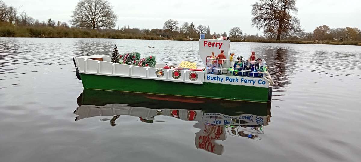

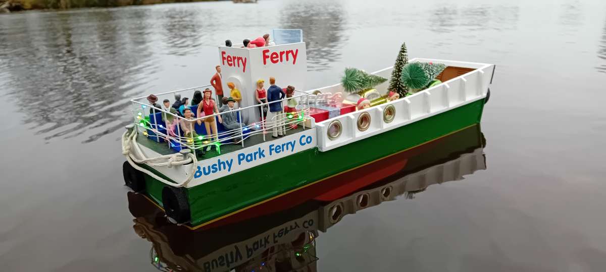

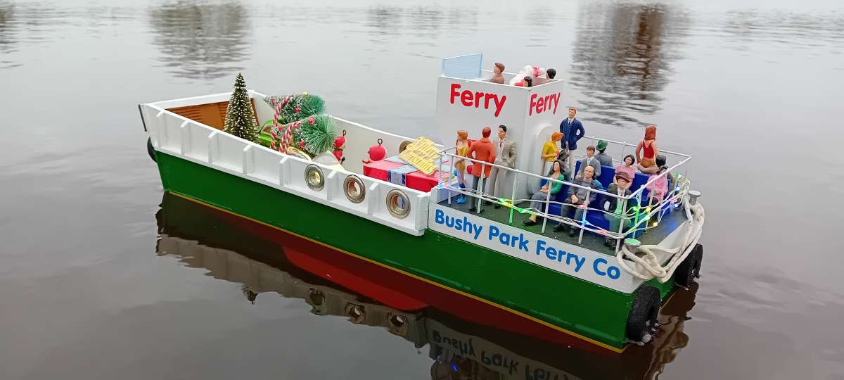

                  • V cold today. Ice on pond. Although very light. No wind. Sailed the train ferry…still very tender despite a bit more lead underneath. Trevor sailed Jesse with Christmas tree etc.
                  • Next week it will be the Christmas ferry top! Lights, music, beer ( ok, no beer really). Dropped the other ferry top getting out the car, just a few people dislodged so no great damage.

                    Repainted the white bits on the ferry as they were looking…aged…compared to the stark white acrylic. It now matches nicely (hull and new cabin).

                      Ferry has been christmatised.
