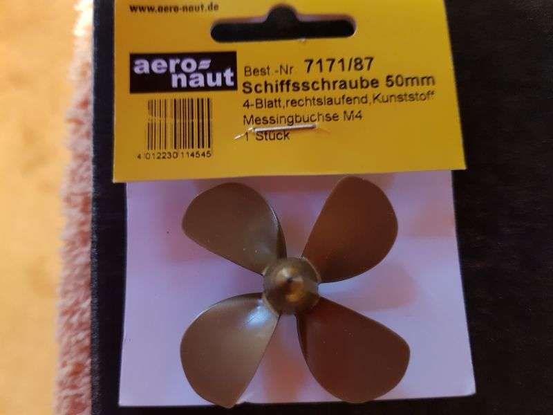

            Hi Len,
            I’m afraid I cheated with my prop for the Puffer. I bought a Nylon , brass finish four bladed, 50mm diameter. Hopefully the picture shows you.

              Hi Jim,
              Thanks for that and well done on finding it.  It’s not cheating at all.  The only reason I made my prop was to get some idea of size and I can easily bend the blades to get the best pitch once she’s in the water.  I’ll probably end up buying the same item and turning it down a little.  it’s impressive how you can give Nylon an aged brass finish (the picture came out very well).

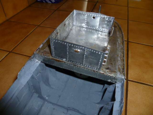

                    Just a progress report.  The stern bulwark supports were cleared and the quarter deck support plate soldered into place-

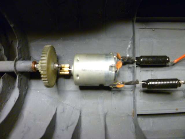

                    The propshaft was stuck into the shaft tunnel with silicone sealer and the drive gear fitted to the shaft. The picture also shows the motor that will drive it.  They came out of a scrap radio controlled car.-
                    P1050354
                    Should be big enough and it’s only to be able to launch her this summer.

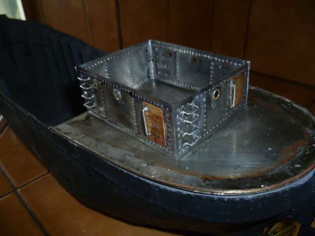

                                Just a couple of progress pictures.  The quarter decks done and the lower bit of the superstructure.
                                P1050380
                                P1050381
                                Not a lot of detail but I just want to try and keep salient details.
                                Len

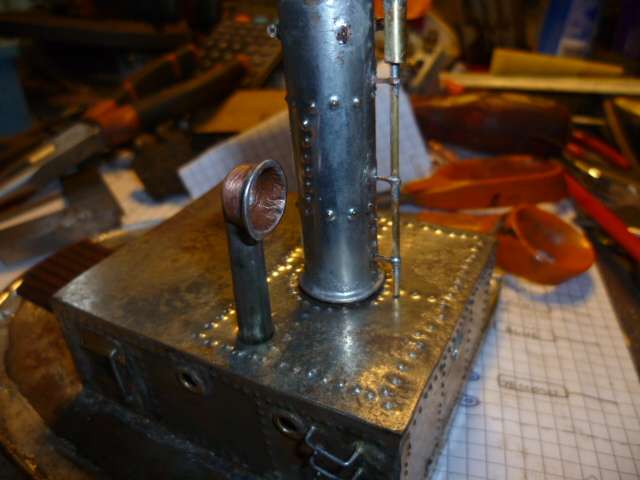

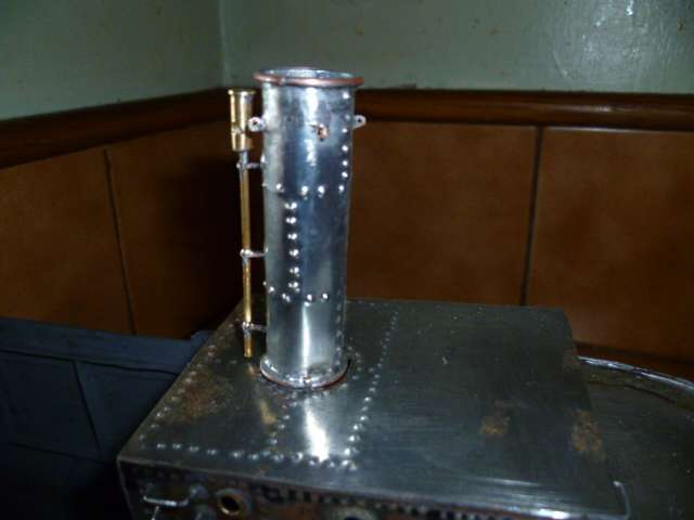

                                          Here’s a picture of mi funnel and the engine room top deck.  Some of the features are well over scale but I’m conscious of Ashley’s comment that scale details on small models don’t always work so well.
                                          P1050382
                                          Just a small thing that might be helpful to anybody working in metal.  If you’re bending or rolling steel around a former, make the former 0.8 times the size you’re trying to get.  I’ve found it works well as a ‘rule of thumb’ for any steel up to 6mm plate.  It springs back to the size you want.
                                          Now getting to the stage where I’ll have to make the deck and wheel house out of dead trees.  Not my comfort zone! 🙂

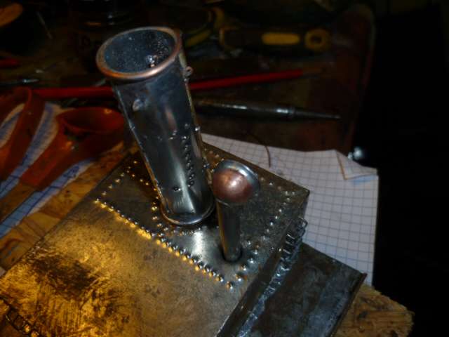

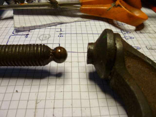

                                              Just a couple of pics of mi engine room ventilator.
                                              P1050396
                                              P1050397
                                              They are not hard to make in tin plate.  The trick is making the cowl but you must have specialist die tooling.  Here’s a picture of mine.
                                              P1050394
                                              Just an old G cramp with a loose shoe.  The shoe edge was polished with a Dremel and the shoe stuck on the anvil with contact glue.  A bit of thin copper cramped up adopts a good cowl shape.
                                              Len.
