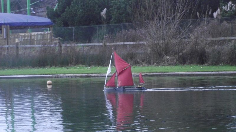

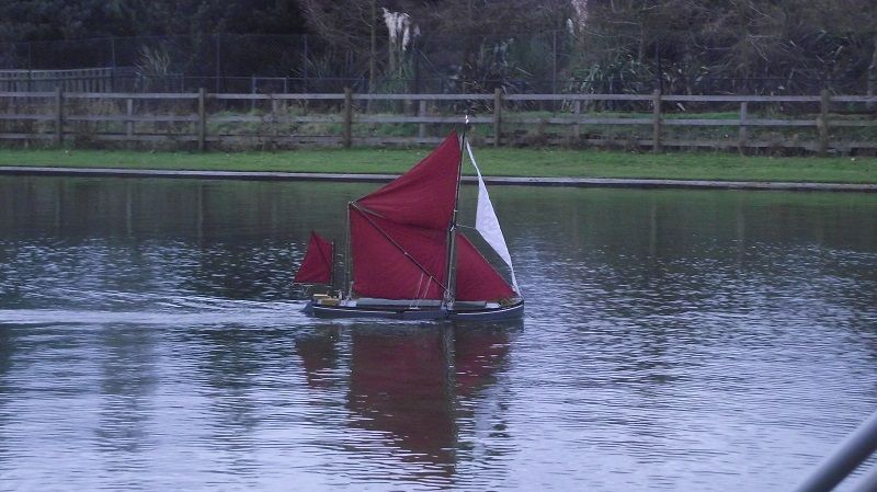

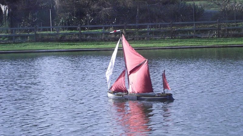

                Susie May
                Susie May on the water for the first time, the sun was shining it was 11 deg. and a nice breeze blowing, it was either go to the pond or wash the car!
                Susie May
                She sails both ways!
                Susie May
                I was very pleased with how she handled, very responsive to the rudder, I didn't try the leaboards I have left that for another day..
                Regards Eddie.
                Edited By Eddie Lancaster on 25/01/2019 16:50:56

                  Looks good Eddie.

                    Hi Eddie
                    Well done she looks good, the secret of getting the stay sail to work is to have the line is attached half way across the cross trees 😊

                      Hi Eddie,
                      she looks nice on the water. We had too 11 °C – but below zero .. everything is frozen,

                        Hi. All thanks, I was pleased with her.
                        Ray when I saw your Veronica at Headcorn I noticed that was where you had the sheet attached, I will change mine for Sunday after I;ve washed the car!

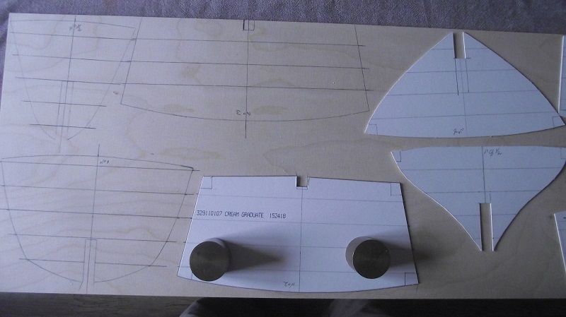

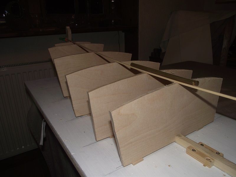

                                Cambria frames
                                The final cardboard frames for Cambria have now been marked out onto 1/4" ply ready for cutting and final fitting to the keel before the notches for the gunwales and chines are cut, and the centres are cut away leaving just the frame. I have retained all of the water lines and the centre lines to help with setting up on the keel.
                                Cambria frames
                                I think I am now ready to start to finish the frames, after two pieces of 1/4" square have been added to the sides of the keel to glue the bottom skins to.

                                  Hi Eddie,
                                  I always think cutting out the centres of the bulkheads is so tedious but using a Starrett hole cutter for the corners and a coping saw does the job 😀 just tracing the bulkheads for HMS Belfast 19 of them, need to find a 6' 6" building board.
                                  Now you have a barge to sail, you can enjoy building Cambria 😇

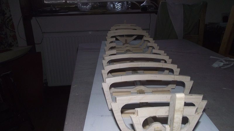

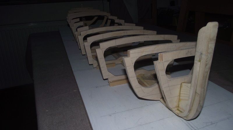

                                          Another wet day yesterday, so some more time spent on Cambria.
                                          Cambria frames
                                          Cambria frames
                                          Frames are now all fixed to the keel and ready to have the gunwales and chines fitted.
                                          Eddie.
                                          #81049
                                          nick viner
                                            @nickviner52422
                                            It is starting to look really good. Cambria was always a lovely big barge. I knew her from her voyages around the East Anglian coast when I was young and living in England. I had a wherry house boat at Pin Mill where Bob Roberts lived.
