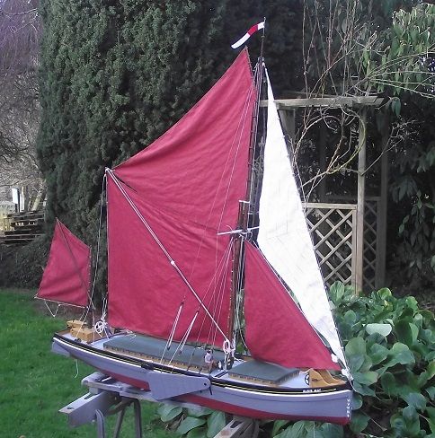

          #80343
          tomarack
            @tomarack
            #80344
              Hi Tom,
              Happy Christmas from the uk, a fine looking barge ☺ is that Santa Claus at the helm ? Keep up the good work in 2019
              Kind Regards Ray

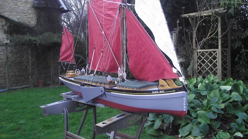

                  Hi All, My Veronica is now finished except for a few details, but with the hatch covers fitted she is now sea worthy, I hope! I have given her a new name in memory of my late father and the river cruiser he built over fifty years ago and named her after my daughter and mother, so my Veronica is now Susie May.
                  All ship shape and ready to go.
                  Eddie

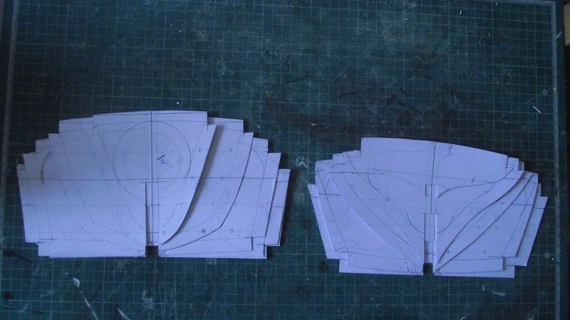

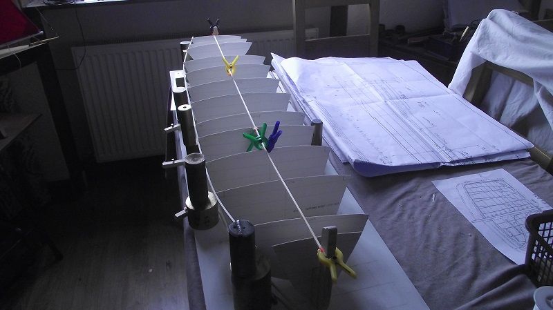

                                        Hi. Tom, as both you and Ray say Cambria is a big boat, but not too big for me to manage,I hope.
                                        With the keel set up on the building board I have now got the final set of cardboard frames fitted, but I started with a copy of the hull lines.
                                        Cambria
                                        I made eleven copies of the lines, folding each one in half and cutting round the appropriate frame number.
                                        Cambria
                                        These were then glued to some thin card using photo mount spray adhesive, with these set up on the keel I could see if all was fair, I had to make two of them wider for some reason and I also added two more, one were the keel fixing will be and another further back in the main hold area.
                                        When I was happy with these I marked around them onto some thicker photo mount card with any alterations that was needed and all the water lines and centre lines marked.
                                        Cambria
                                        With pieces of 3mm. sq. balsa and some bits of brass and bronze bar I was able to again make sure all was correct before cutting any ply.
                                        Slight adjustment was required on two or three frames, but before I applied these I left everything set up and kept checking over a couple of days to see which ones needed to be changed and in which direction.
                                        I now need to work out what wood I require and put an order in to SLEC.
