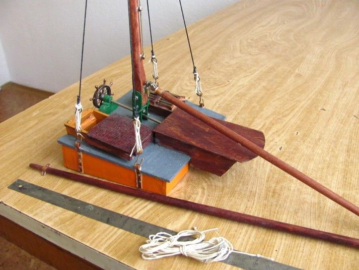

                    Hi,
                    I made next step today, I attached mizzen shrouds . Next step ..mizzen sprit needs some details yet.img_1369.jpg

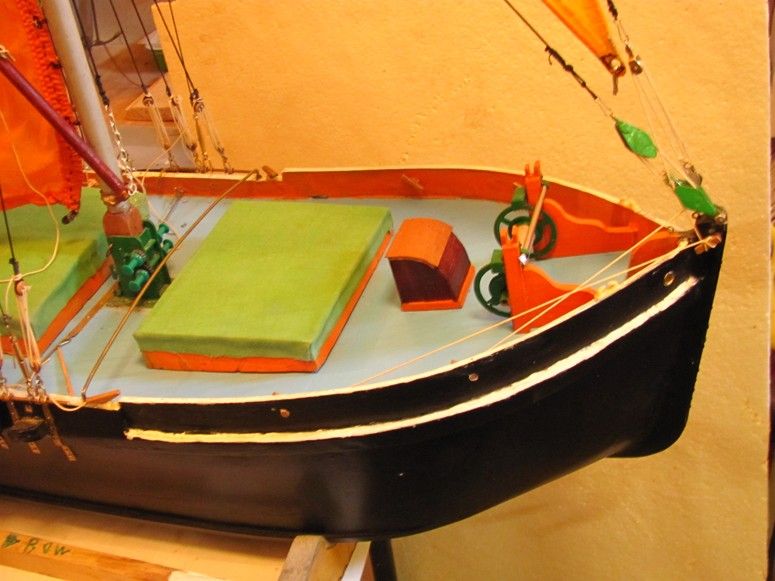

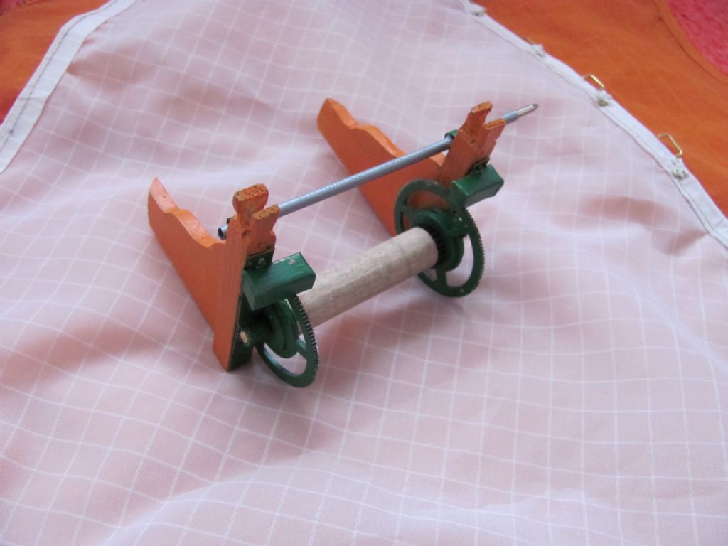

                              Slowly I continue with other work -main mast rigging. m also starting to make the missing pulleys. Some pulleys I still have from RBmodels, I miss primarily pulleys for brails and main sheet – big double block  mainly.
                              Winter is here – with first snowfall…. end of very long Summer weather …
                              I put next photos to album here and to my " Rajce",
                              Greetings
                              Tom

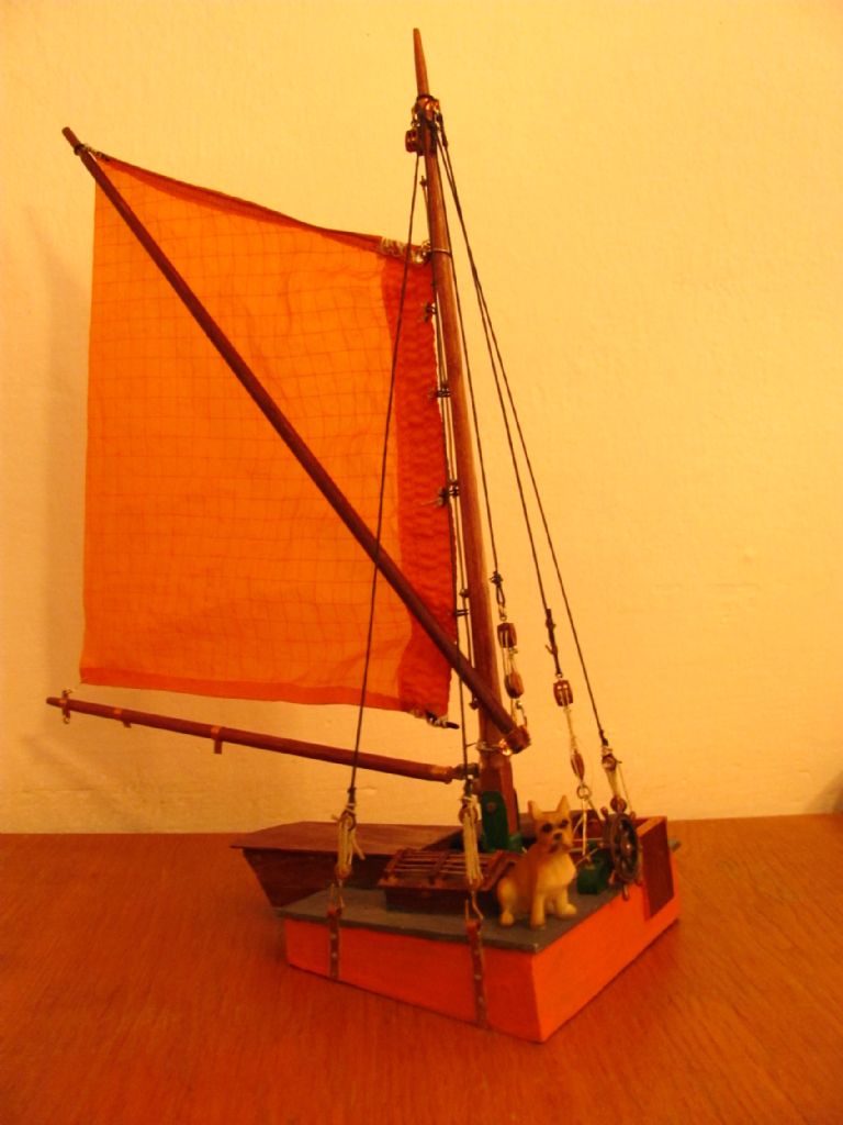

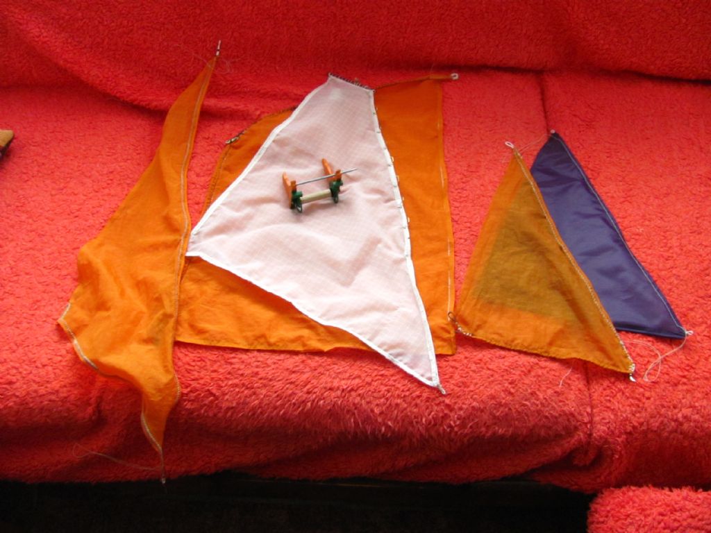

                                img_1394.jpgimg_1390.jpgimg_1387.jpgHi,

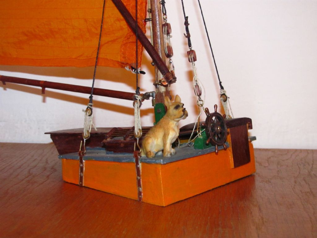

                                #80132
                                  Hi Tom,
                                  We can't let a barge go sailing without ship's dog congratulations on your new crew member, your new barge is looking great.
                                  Kind regards from the uk
                                  Ray
                                  #80137
                                  tomarack
                                    @tomarack
                                    Hi Ray,
                                    thanks… blush the dog is ready, but the barge is still waiting in the dry dock …
                                    I'm missing a lot of details, but I think I'll get to the workshop in the new year.
                                    greetings
                                    Tom

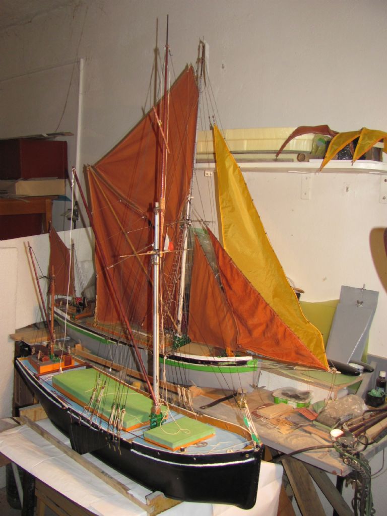

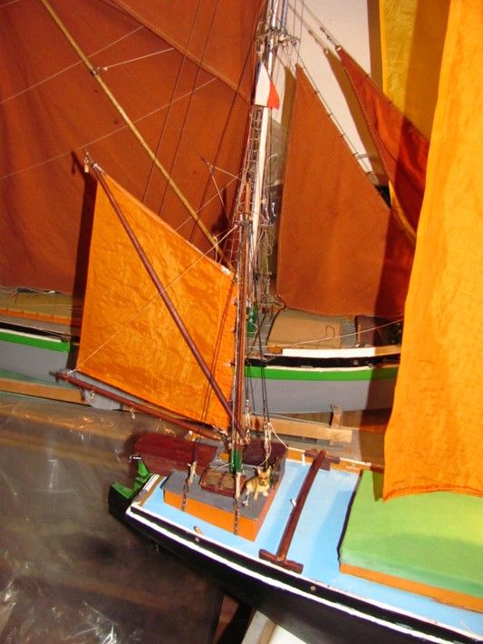

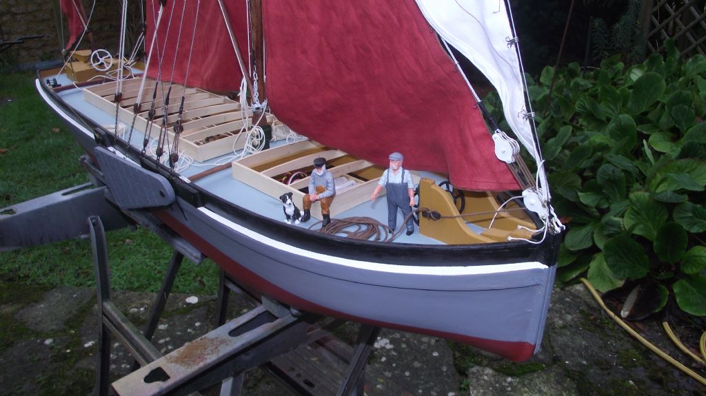

                                              img_1399.jpgimg_1402.jpgHi Eddie,
                                              nice work, indeed!
                                              Today i made testing of test sails . Winter finally came to us, it is freezing at night, temperatures are above zero over the day.No possibility to sail anyway. Park pond is dry for winter, the Becva River is at its minimum, only wild ducks swimming there . img_1398.jpg
                                              #80212

                                                #80214
                                                Eddie Lancaster
                                                  @eddielancaster
                                                  Hi. Tom, thank you, your barge is looking good, I take it that it is Lady Daphne? and all the rigging is as full size?
                                                  I like the dog he looks ready to go.
                                                  We are able to sail here through the winter, even if it is in the coffee shop! We have had one day with ice on the pond so far, and it is mostly wet and mild, I hope tomorrow will be fine and dry.
                                                  Keep up the good work.
                                                  Regards.
                                                  Eddie.

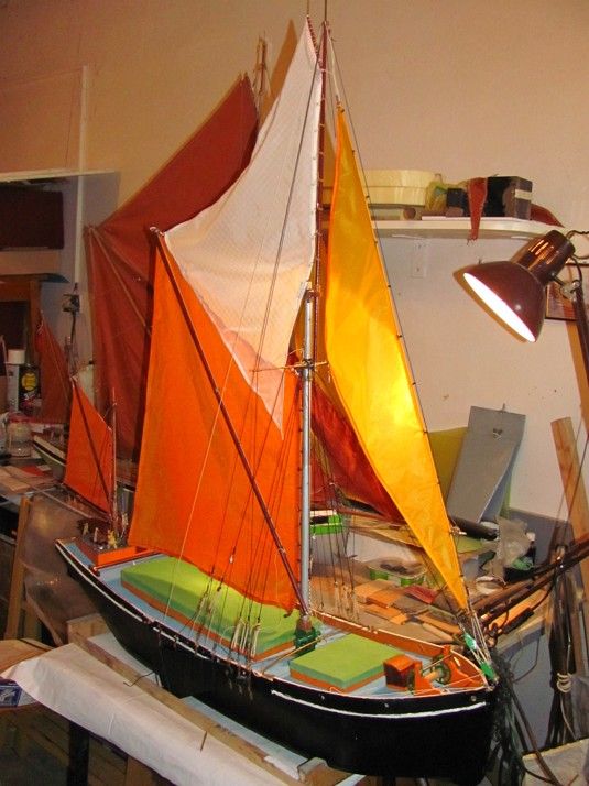

                                                  #80215
                                                  tomarack
                                                    @tomarack
                                                    Hi Eddie,
                                                    as I wrote some months ago .. basicaly it is Lady Daphne in 1:28 scale. nearly 1 meter long,
                                                    I had some troubles with hull making, , so at the end I decided to make some modification with superstructures ( holds),then with rigging .. At the end I decided to refurbish original to model in 1:24 scale.more or less scale unification of both my barge models. As far as the rigging is concerned, I have made the masts longer but meet the conditions of the AMBO races for 1:24 scale. . Gusty .Cat main mast is nearly 1 meter long .
                                                    due to my "rocky conditions" in my workshop I did not have the opportunity to strictly keep the design of all the details and therefore I chose this for me the easier way .. making semi.scale model.
                                                    still have concerns about the longitudinal balance of the model. On Capricorn I had to increase the jibsail to sail with the wind. "Tomcat" does not have a bowsprit, so I'm waiting for a bigger balancing problem. I decided to reduce the mizzen sail if necessary, or to put a Bermuda style sail there.
                                                    Greetings
                                                    Tom

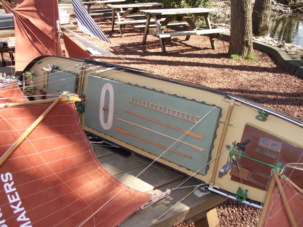

                                                      Hi Eddie,
                                                      As your progressing so fast, here are some nice details on one of Peter Simmonds barges oars, quant and ladder, which at the time it was taken Easter 2015 was being sold to the skipper of the full size Cambria.
