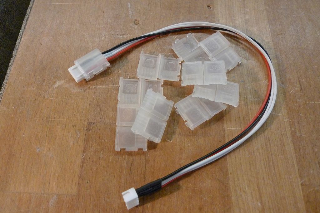

        … and also some protective covers for male JST-XH connectors.

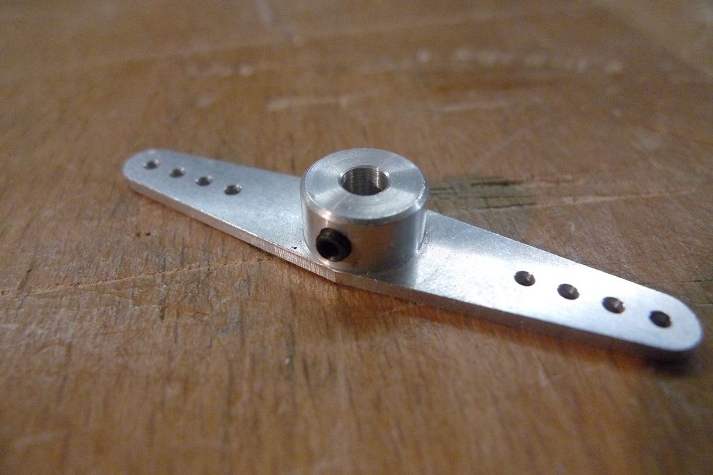

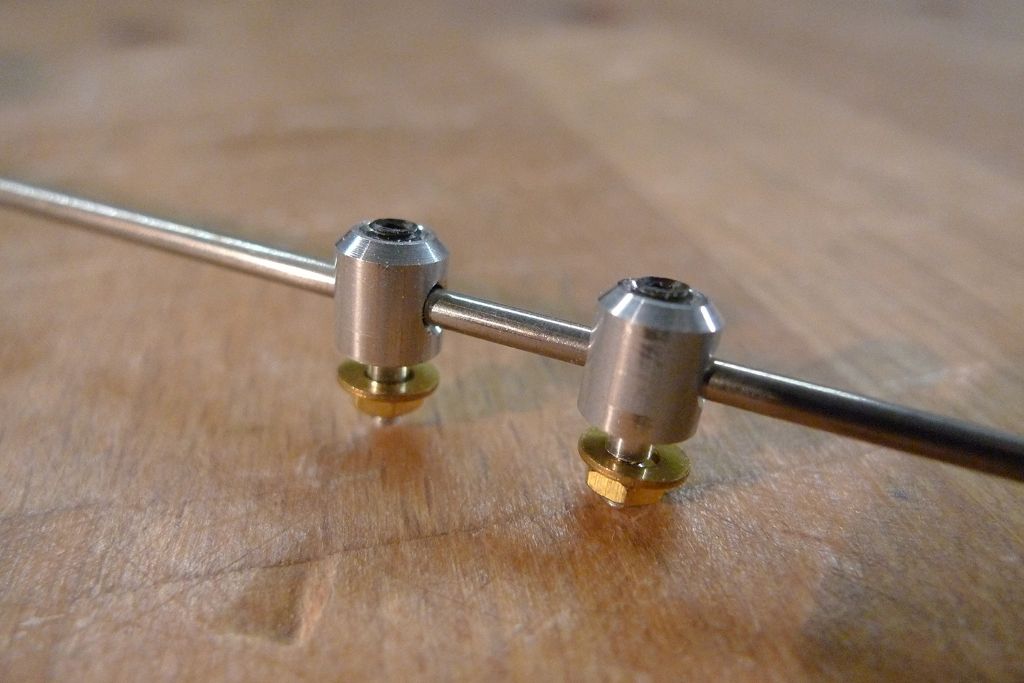

        Furthermore, there was a grubscrew-fastened aluminium tiller for a 4 mm rudder shaft …
        … and two pushrod swivel nuts (also grubscrew-secured).

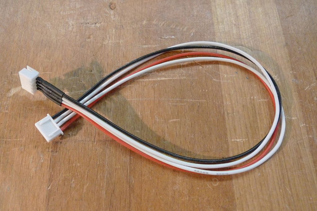

            In any case, yesterday afternoon, the chap from UPS brought me my package from ComponentShop (while maintaining appropriate distance, natch!), in which was first and foremost a LiPo (cue thunderclap and some menacing music) …

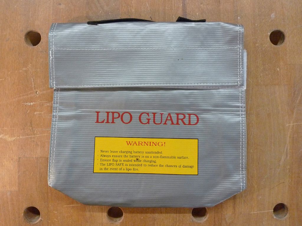

            … but also a LiPo guard bag (soon to be replaced, but more on that once the postman has been along today with a further parcel).

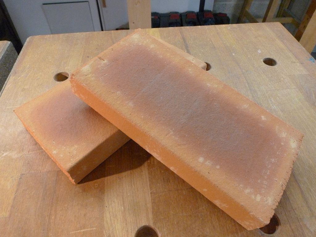

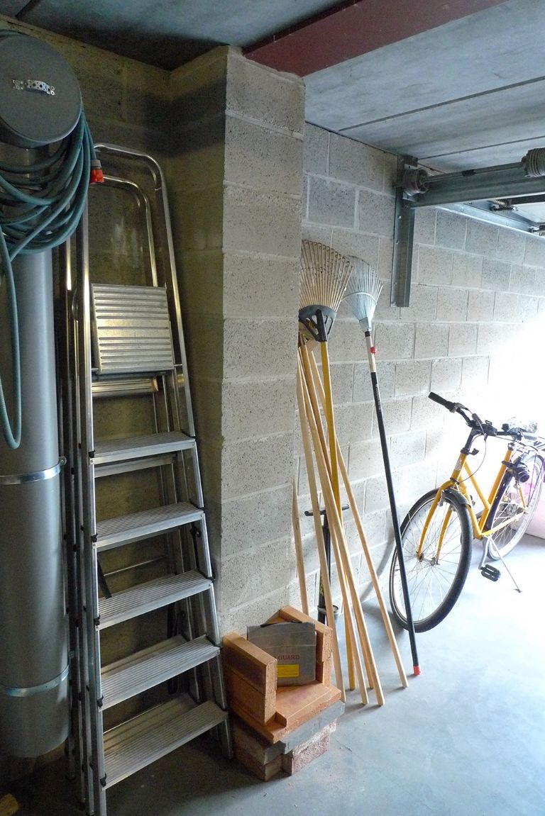

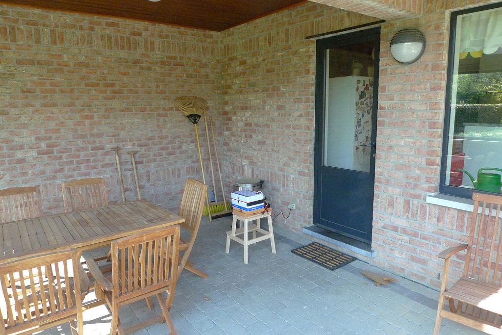

            Here in Belgium, the DIY shops were allowed to reopen on Saturday, so yesterday afternoon I popped along to one and bought some fire-resistant bricks, of which here's a sample …
            … with which I created a sort of secure storage facility in a part of the garage (which is heated in winter, so always at room temperature) where there's nothing else immediately above or in front that wouldn't be able to survive the heat of an incident. I will make this neater with a small metal cabinet from Ikea, once they too are open for business again.
            Am I being overly cautious here? I'm sure I am (if I weren't, I wouldn't have bought a LiPo in the first place), but I'd rather err with a very large margin on the side of safety – if nowt else it'll help me sleep at night!

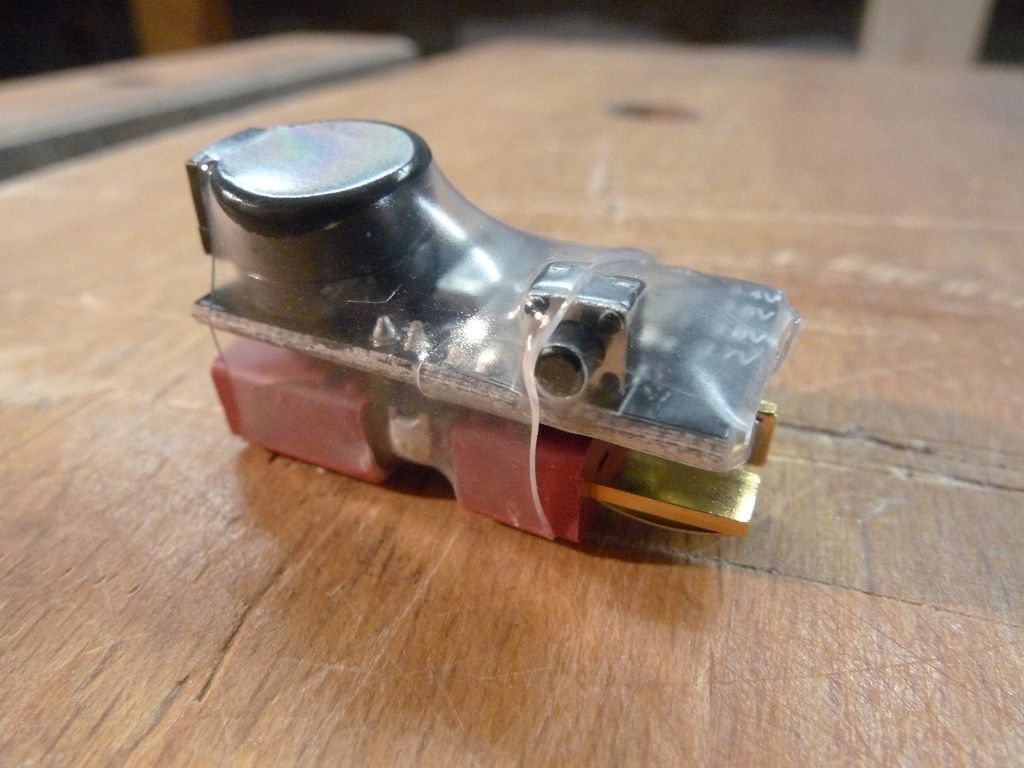

            And while we're being cautious, here's the low voltage alarm as already discussed

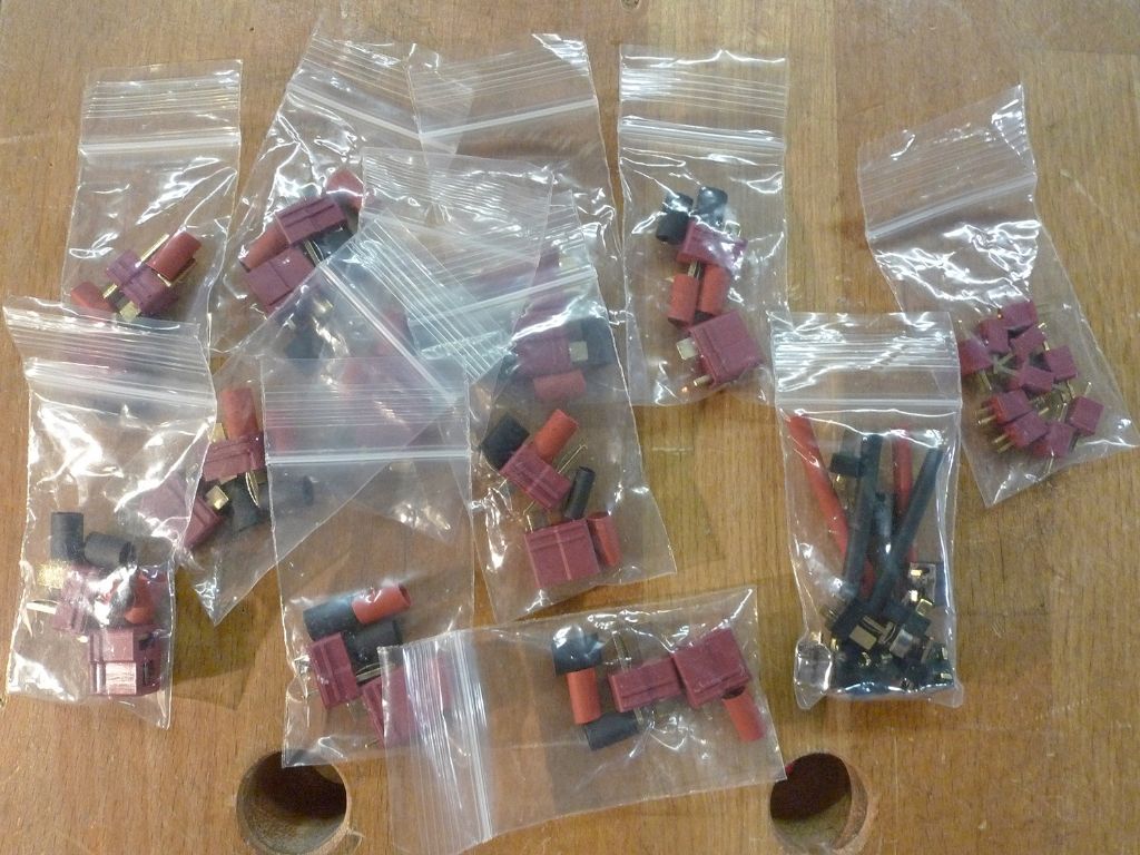

            I also took the opportunity to stock up Deans type connectors, regular, mini and micro …

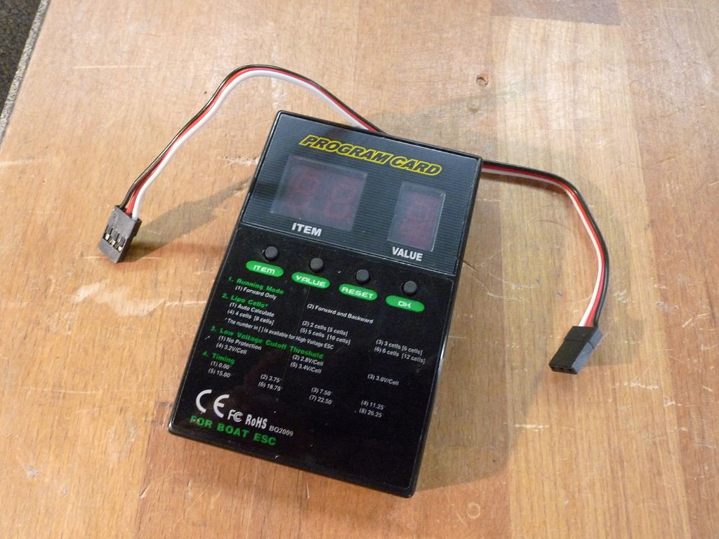

            … and finally there was the programming card for the ESC.

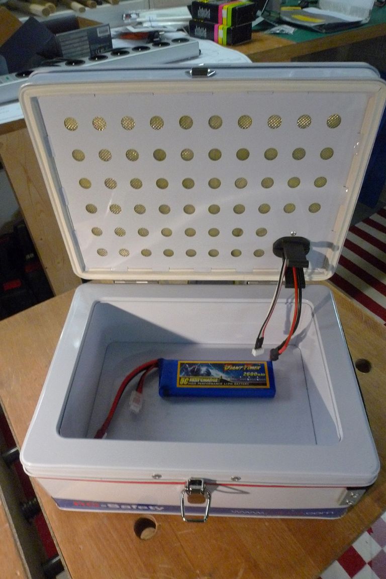

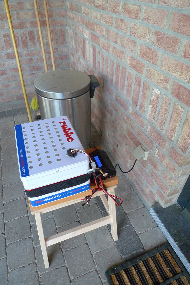

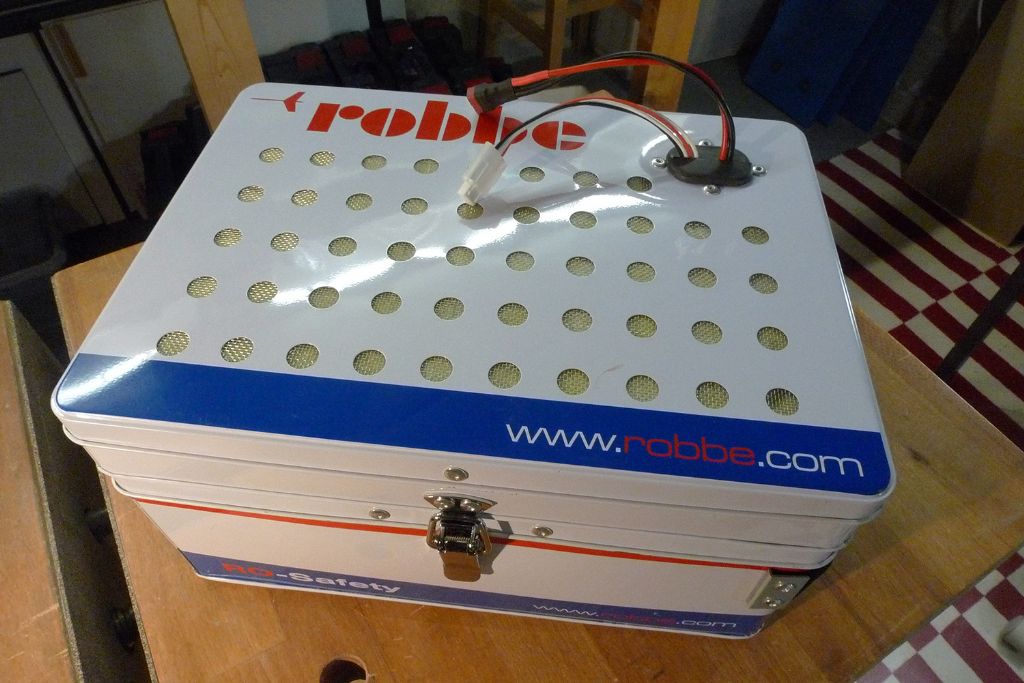

                                    In any case, there it was, and first out of the box was this beauty: a Robbe RO-Safety dedicated LiPo charging and storage box:
                                    According to the specs it is good for simultaneus storage of up to the equivalent of two 6S 5,000 mAh packs, so my little 3S:er had plenty of elbowroom, all to itself.
                                    For the details on the features and specs, see **LINK**. Obviously there's only one way to really know if it does what it says on the box (ha!), and I most sincerely hope I'll never find out, but in any case it is a pretty nice piece of kit. Rather more pricey than the usual soft LiPo bags, but I'm happy enough to have spent that on peace of mind.

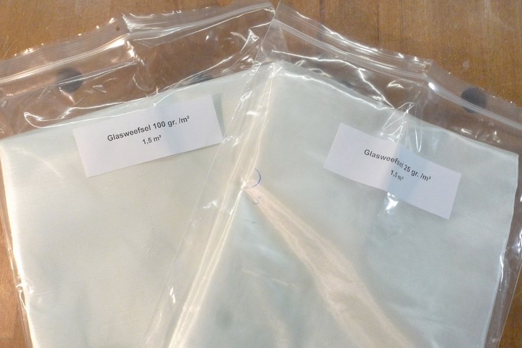

                                    … and glassfiber cloth in 25 and 100 gram/m2 weight respectively.

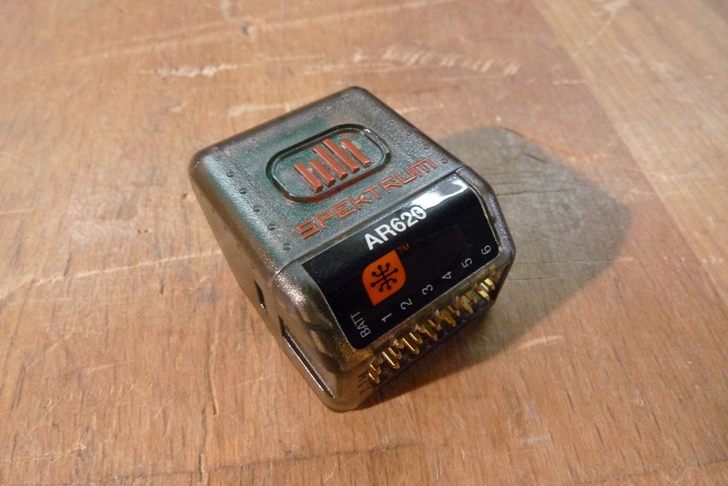

                                    I also recieved a receiver …

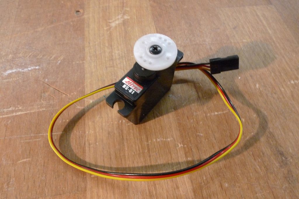

                                    … and a Hitec HS-81 servo.

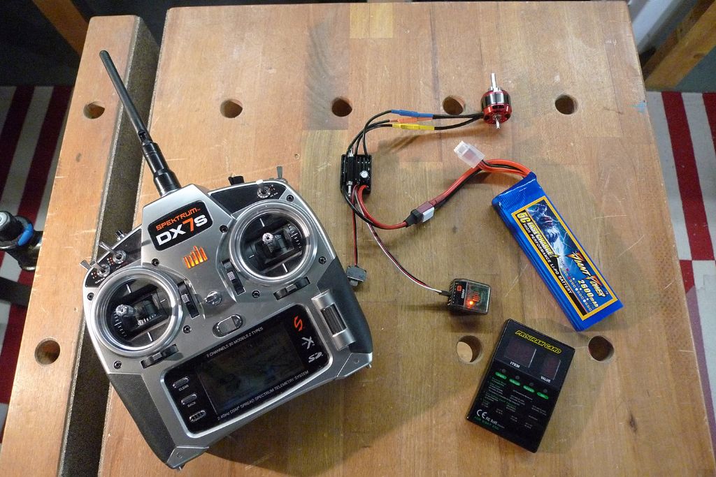

                                    After my days work was done (I'm still working full time from home), 'twas time to set uip out on the back terrace, and fully charge the LiPo, which went completely hassle free, I'äm delighted to say …
                                    … and then to bind the receiver, solder on a Deans plug on the powefr leads of the esc, connect it to the LiPo and set it up with the programming card (another doddle — that card was well worth he money!) and finally test the motor-and-esc set-up.
                                    Everything went swimmingly well: the motor runs nice and smooth, forwards and backwards, and is very quiet, too.

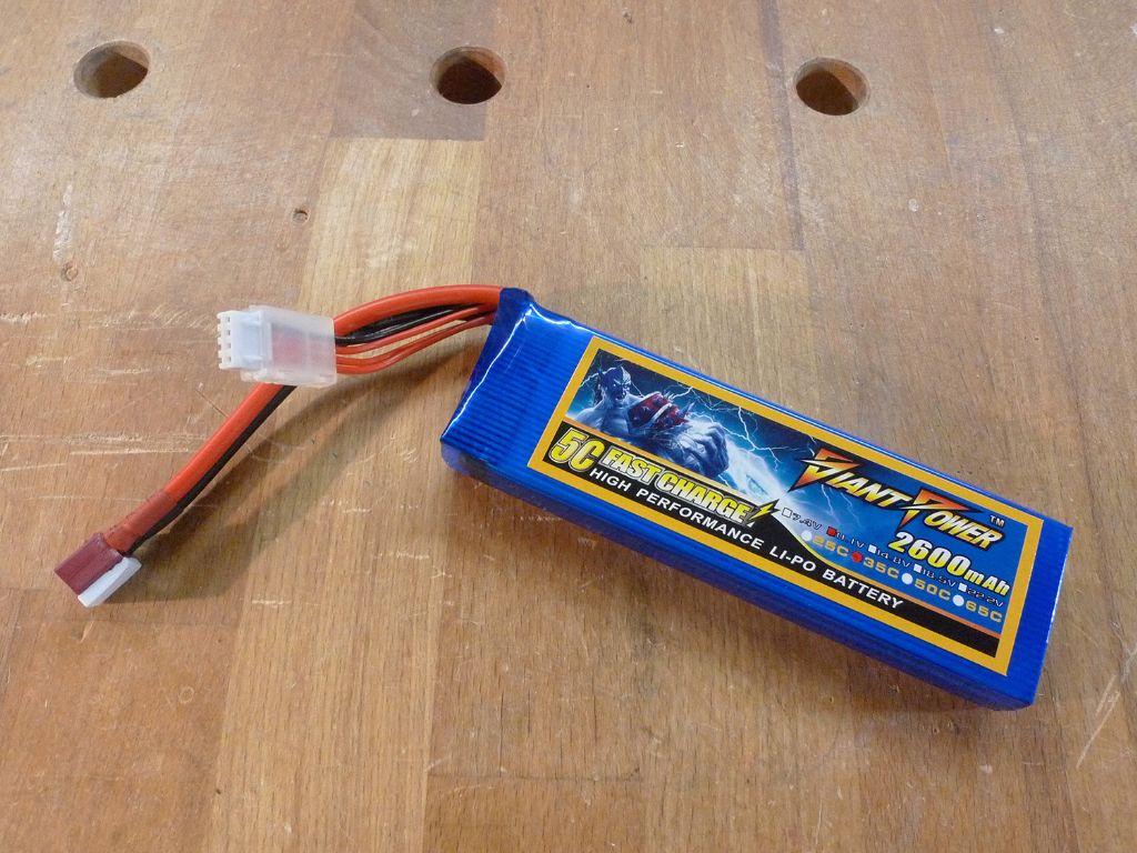

                                    All in all a very successful afternoon, which I then rounded off again, back out on the terrace, by running the storage mode (dis)charging programme on the LiPo, to take it back down to 3.8V per cell. As I won't be using it very much during next stages of the build, I figure it'll be better that way; it can still be used for any occasional testing needed, and then topped up every now and then back to said 3.8V/cell storage voltage.
                                    A couple of things rather struck me during the charging and discharging process.
                                    Firstly, the LiPo didn't increase its temperature in any way that could be detected by simple touch, which of course was reassuring.
                                    Secondly, with the press of a few buttons, the charger very neatly displayed a lot of measurements, including current voltage per cell, which meant that progress was easy to follow, which in turn also felt very reassuring.
                                    All in all, I rather think I've been getting me boxers in a little more of a twist over this whole LiPo thingummy than what was really necessary – but then again, I feel much happier with having been perhaps overly cautious than the opposite.

                                      I forgot to say about the charging and storage charging that the former was done at 1C, so that it took just over half an hour to get the battery up to full charge, while the discharging down to storage level was a rather slower process.
                                      The max current setting for the Storage mode is 1.0A, which is what I selected, but the charger decided for itself to run the process at 0.5A, going down gradually to 0.2A for the final balancing act; that thus took neigh on three hours, but it was a lovely evening to sit reading out back, enjoying the garden, while the book I'm currently (re-)reading is thick enough, too, to last me rather longer than that, so all in all, no worries …
