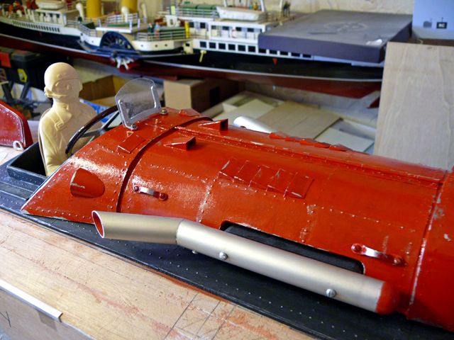

              Another WIP picture…..Fin fitted…….Louvres fitted to engine cover…….Found some nice plastic for the corner trims…..Beginning to take shape now?

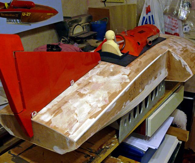

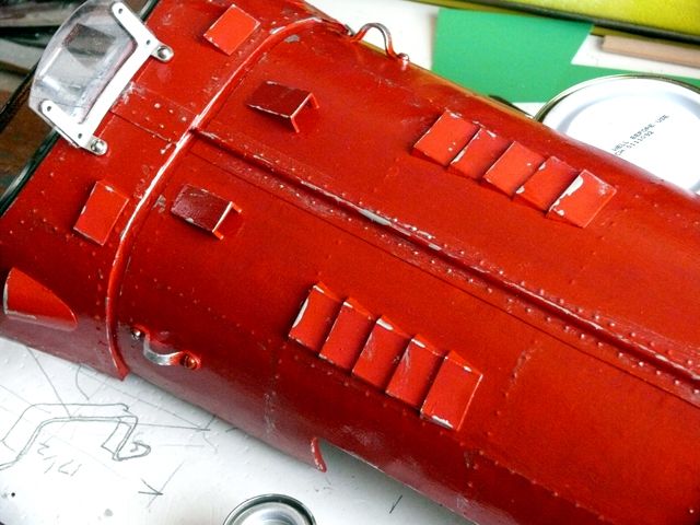

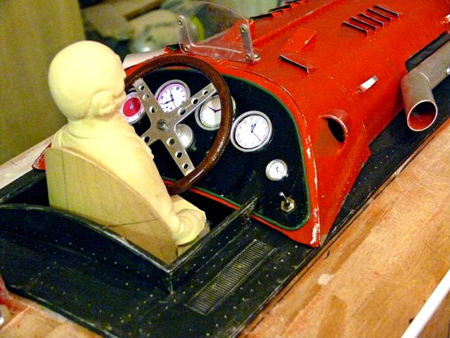

                    Latest WIP picture…….. showing a bit of wear and tear on the engine canopy
                    #23737
                      Dashboard layout with the aluminium effect showing through
                      #23738
                      Dr John Booth
                        @drjohnbooth43899
                        Hello Bob
                        That is a very nice looking wheel and instrument panel.
                        John
                        #23739
                          Thank you, John
                          Here`s another view of the “aluminium” look……..It`s amazing what can be done with card construction and an artistic paint finish……….the equivilent to my normal rusty appearance………….I`m very pleased with the effect!

                              #23760
                                Switch fitted to light up an LED.
                                Note the GoFaster steering wheel

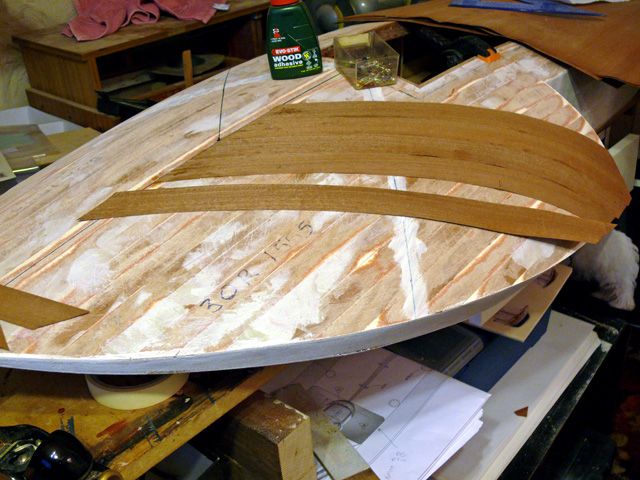

                                  Finally found a local source of veneer.
                                  It`s quite stressful, ensuring a good bubble free job

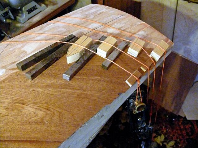

                                                  Came up with this idea………Lots of strings clamps with weights hanging down.
                                                  Using wood blocks for local intensity……….Happy now……Bob

                                                    Method of clamping the veneer to a compound surface…..nylon cord with 2lb weight
                                                    Job sorted!……….Bob

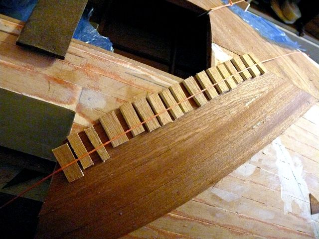

                                                      Another view of the string clamps……It works too!
