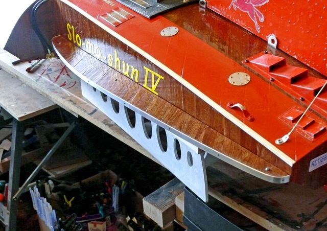

                                              #26214
                                                Fitted the running boards
                                                They might help to keep her tail up?
                                                If not, they look nice anyway!
                                                #26216
                                                Phil Winks 1
                                                  @philwinks1
                                                  Quite a good asthetic improvement in my view Bob and yes they should help esp now her tail  is lighter.
                                                  Phil
                                                  #26221
                                                    Yes, now the running boards have been veneered they look fairly “original”.. good job.
                                                    A flat bottom is the way to keep the rear end up methinks. I know I know all that veneer…but..
                                                    Make a filler box or something to alter the rear end profile and try it (temporary box that is).
                                                    Hey, you could make one out of perspex to use while in the water (so its invisible) and then have it removable to display !  (assuming it works)
                                                    AFTER you have ditched the fans and tried some cheap X50s or something!
                                                    Note for boat builders everywhere…try unusual machines out on the water before finishing the paintwork!!
