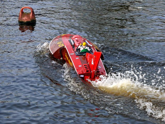

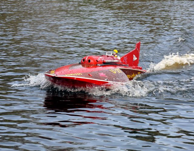

            Test sailing No 2
            A lot better today, but still not on the plane!…………..Actually, it did just once when we were not aiming for it…………..But it wouldn`t repeat the action
            The motors have lots of power but they  consume their energy, blasting the water backwards…………..as though it was pushing against the bank.
            This is probably the problem…….too wide an area……..perhaps a vee shape down below might split the water resistance
            The roar of the engines is very impressive……..Doesn`t need a sound unit at all
            An interesting problem…………Now thinking about water cooling and scrapping the fans and I think a vee up front will improve things

                  It`s obvious the craft is behaving like a Bulldozer………………When it should behave like a Snowplough!………So it needs a snowplough shape underneath
                  The motors are working too hard at the moment and getting hot…….just shifting water……..once the boat starts picking up some speed, the airflow should come into it`s own!
                  If I can find some brake tubing, I`ll make a start on the water cooling
                  That`s the plan, chaps………Bob

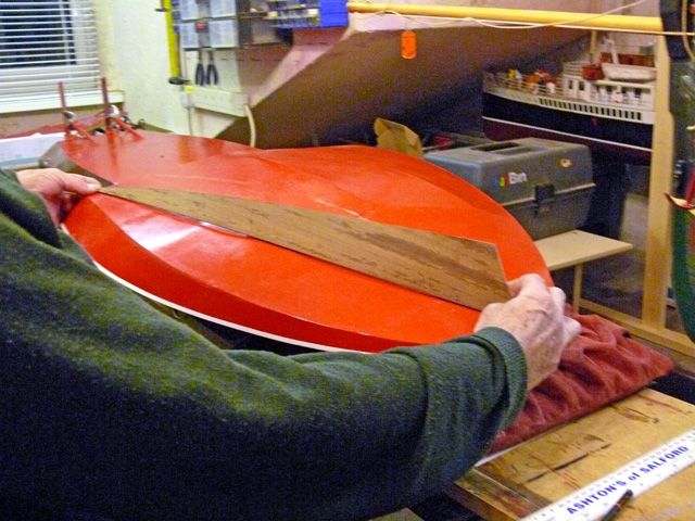

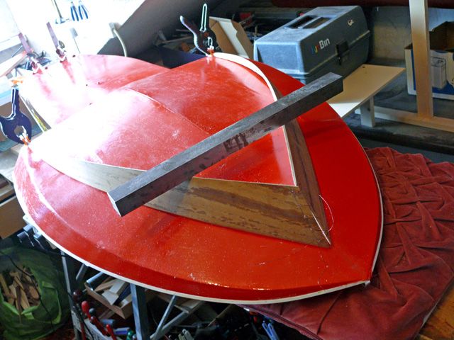

                          This is what I mean by a Snowplough effect…….Two thin strips meeting at the front like a pointed hull…….to deflect the water sideways…….instead of trying to climb over!
                          Any comments on this super idea?

                              Luckily, my latest snowplough deflectors do not over – lap the contraversial void section, so the cover mod can be removed quite easily
                              Look again at the rear section in action!………Look at the side wave and the trough in the prop section………the bulldozer effect is such that the hull as made hardly any headway….so the props have washed the water away instead…….leaving a trough!
                              So now convinced the water barrier has to be deflected!…………..QED

                                  And here`s something we made earlier, in true Blue Peter style……
                                  Rock on Tommy!…………….If this don`t work, I`ll eat my EMBC hat!
                                  I`m highly delighted to discover that a straight edge has settled down nicely to fit the hull contour!……………..That can only be an good omen!
                                  Bob……….Highly delighted!

                                              But to be honest, we`ve deliberately and wrongly weighted the back end down and it fact for the last session of tests we actually had five bottles of pop in the back!
                                              I`m convinced now that the snowplough idea will be a tremendous improvement…….Just waiting for the glue to dry
