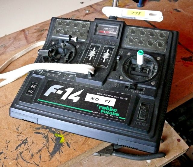

                    I was originally using a mini Rc with three channels……..So without thinking, I used Ch1 for rudder…….with 2 and 3 for the motors
                    Since I`m using the twin stick Navy Tx……….I needed channels 3 and 4!……..Yet another Senior Moment!
                    I did the same daft trick on Jeanie Deans at War……..With the right and left paddlewheels
                    If it wasn`t for you, Matey, reminding me to check the Rc sockets etc………I would have sent the so called faulty ESC back by now by now!!!!!!!……………….You really saved my neck there, pal!………that would have been some egg on my face!………..Dave would have gone berserk!

                      Ok Bob just to clarify on this “Twin stick navy” tx (not a system I’ve any experience with at all)  are chanels 3 & 4 mixed to respond to one stick or have you got the throttles on two seperate sticks??
                      #25937
                        Here yer go, Phil
                        Futaba …………………………..Navy F-14
                        Twin sticks on the left for independant control for two motors….or two paddlewheels
                        A nice toy……………..they can also be used for steering, by messing with the prop speeds

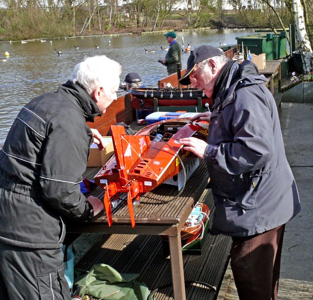

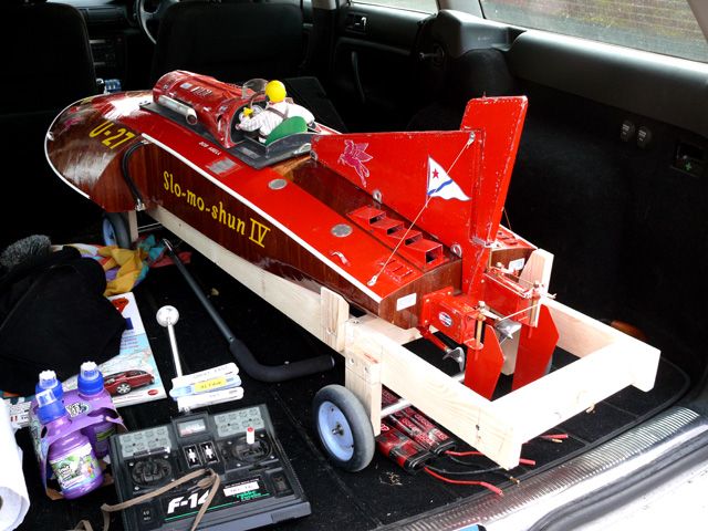

                                  Here we go boyz!………………….Got the car packed…………The sun is shining on the Righteous!………………….Going ……”Over theTop” …….at zero hour!………..10.00pm
                                  Tin hats at the ready!……………………….Bob the Fearless
                                  #25951
                                    The boat was very nice to handle……..The roar of the engines was excellent……..Very impressive………..It was nice to see the driver battling with the steering wheel
                                    But it was pushing too much water and couldn`t get on the plane!
