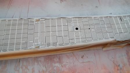

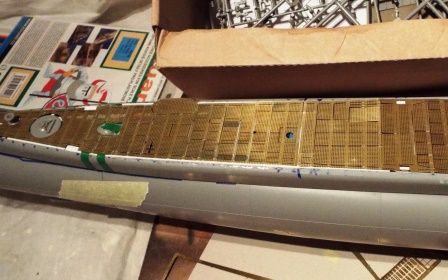

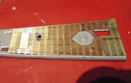

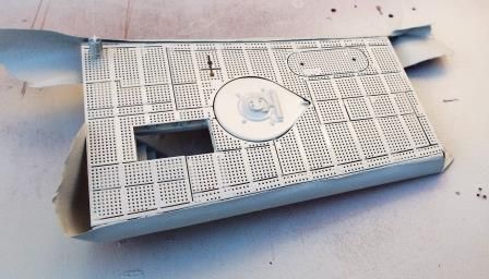

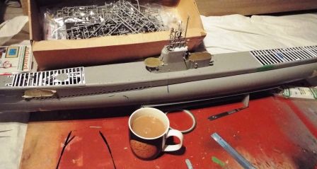

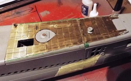

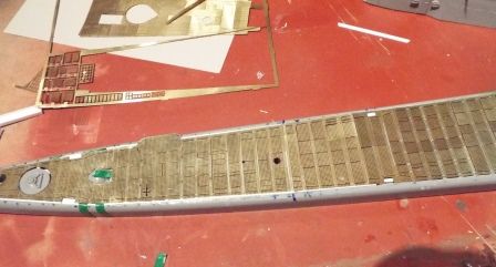

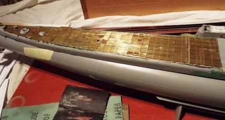

          Back to the Gato and correcting some surgery errors on my part, filling in the gaps where I had been over zealous with the scalpel. I used very thin plastic rod to take up the slack between the PE decking and the hull sides.
          At the same time I have joined the middle deck section to the stern section to provide a very large access hatch.

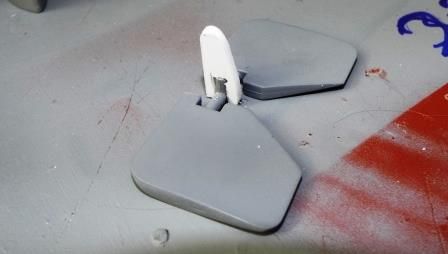

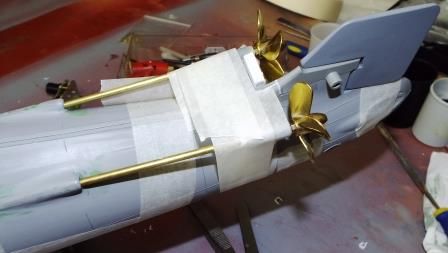

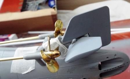

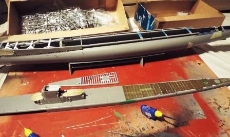

            A little work done recently.
            Ashley you were right, I have decided to build a dynamic diver after all. As only on 2.4Mhz will keep the fin (conning tower) above water.
            I have tried to contact Marks Model Bits with regard to a proper WTC, unfortunately haven't had a reply to my e-Mails as yet.

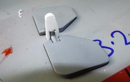

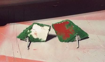

            I have increased the area of the dive planes by 30% using plasticard and filler as advised by others that have built this kit.
            PE decking now fitted, just needs a coat (or 2) of paint.
            Gregg

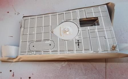

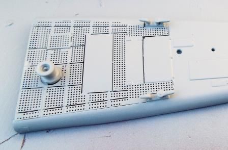

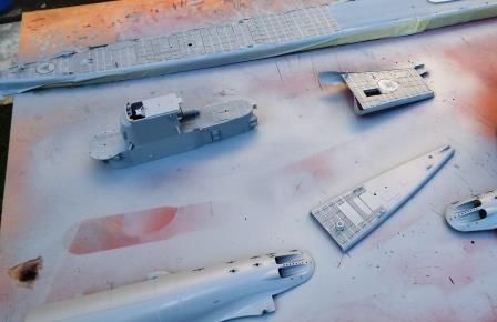

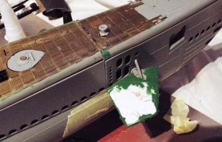

              Beautiful day outside so took some parts into the garden.
              A light coat of primer to show up the imperfections that need some more filler.

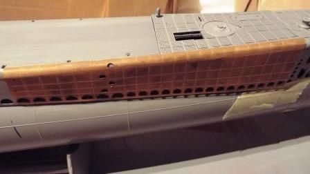

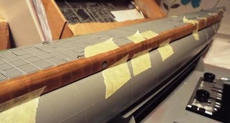

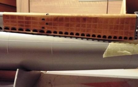

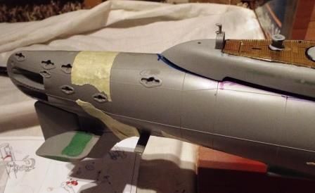

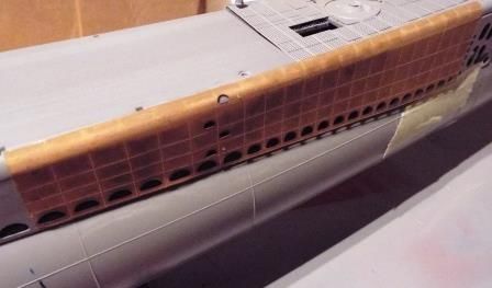

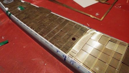

                    While I was waiting for my WTC, decided to take on the Eduard PE side-plates. This is the first time I have used PE as large as these pieces.
                    Formed them up and attached with masking tape, to see where they needed trimming around fittings and fittings placement holes.
                    I have ordered some Cyano Gell to attach these, as it was recommended to me as being easier to use with large areas of PE.

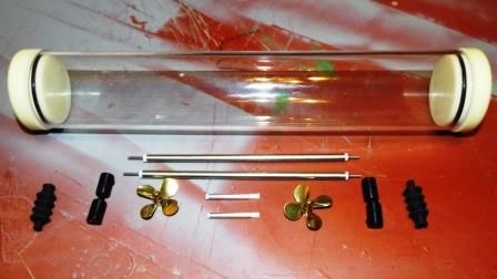

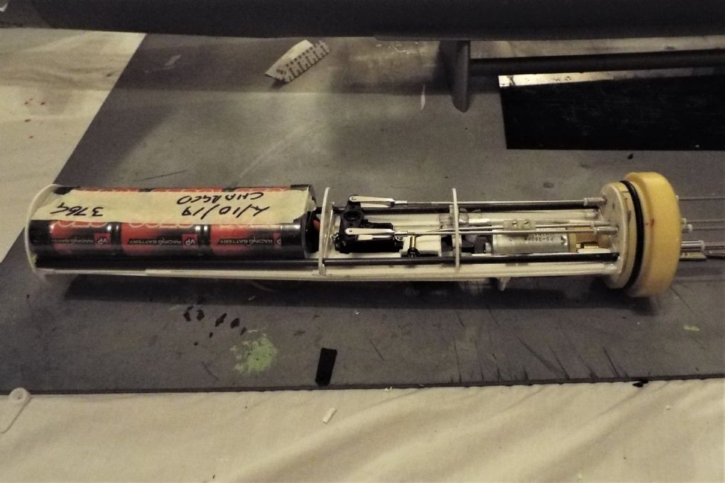

                      'Marks Model Bits' WTC and parts have arrived.
                      Delighted with them, will post picks when I get the chance.
                      Gregg
                      #56356
                      ojays
                        @ojays

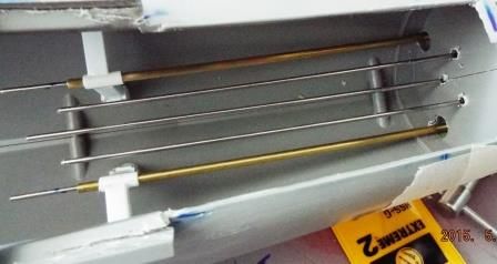

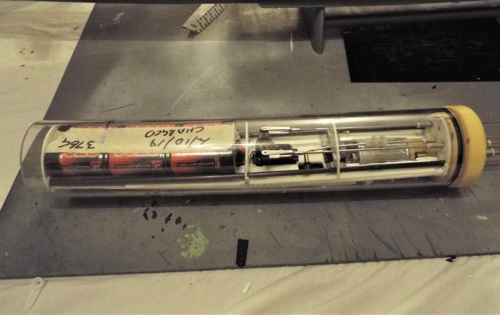

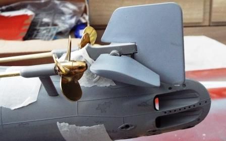

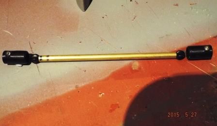

                        WTC Sleeves and shafts from MMB (Marks Model Bits) props, couplings, gaitors from S.H.G
                        Gregg

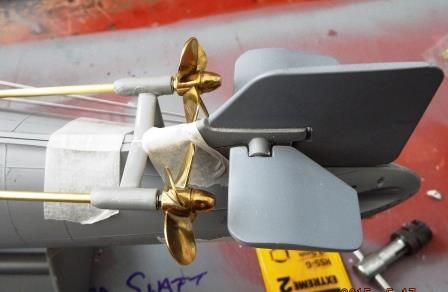

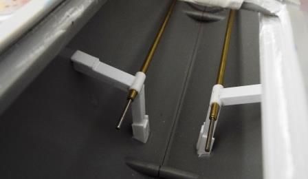

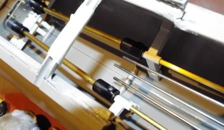

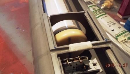

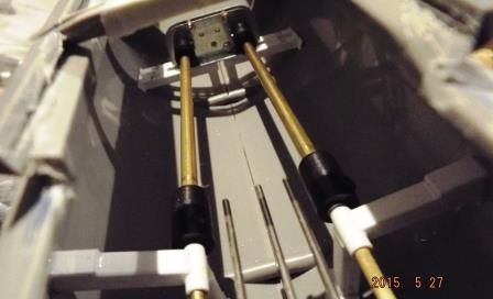

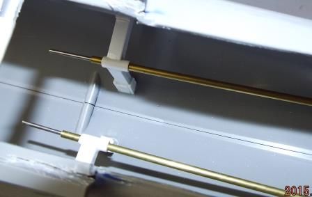

                          A little progress on the prop shaft internal supports, stern planes control arm attached.

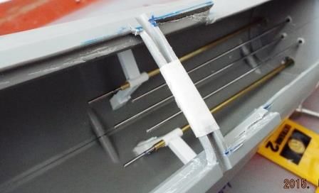

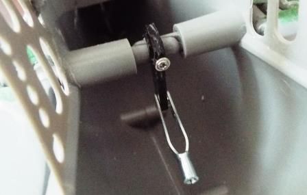

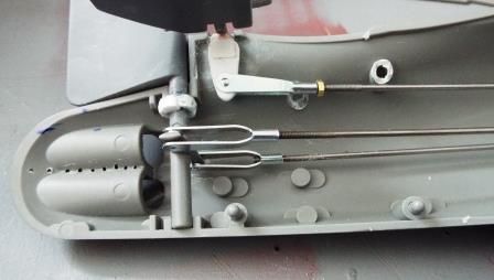

                            Some of the work carried out recently.
                            Trial fit of the control runs to the rudder & stern dive planes.
                            Trial fit of bow plane control horn

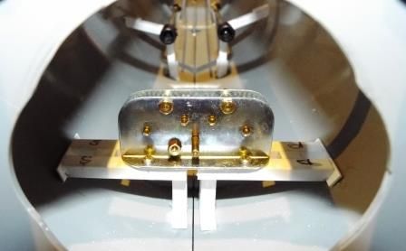

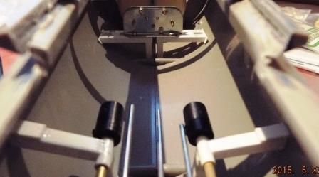

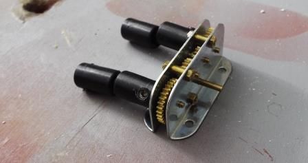

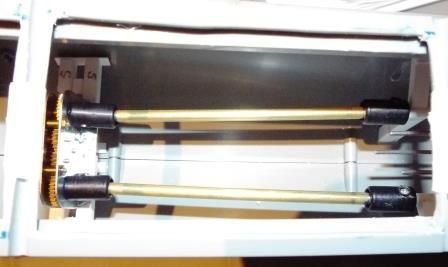

                              Gearbox & secondary shaft aligning.
                              Gregg

                                  Retrieved from the shelf of doom and now making a concerted effort to get her finished.
                                  Making some modifications to the WTC, so hopefully he mechanical side should be completed
                                  in the next few weeks.
