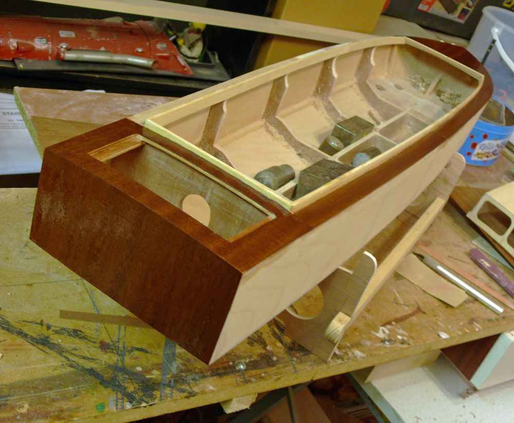

              The Transom shaped and varnished
              Don`t think I fancy doing 36 coats of varnish….As Paul normally spends his time!….lol

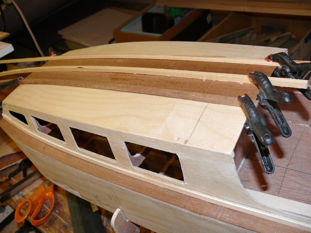

                            I`ve decided to veneer the roof to match the deck and should look nice when viewed from above, as it skims across the Broads?
                            Notice how the veneer strips are held in position along the entire glueing area, using 6mm x 6mm strips

                              It's looking very nice, Bob. I particularly like the veneer, it really does look good. Don't forget to let me know when the plans are available.

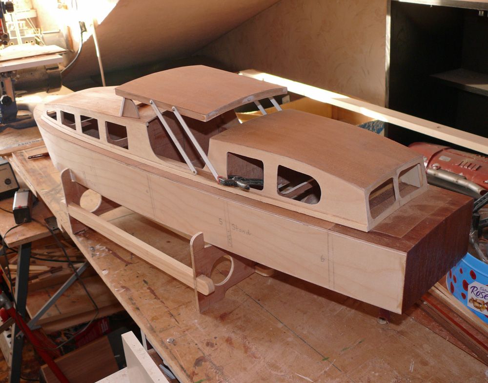

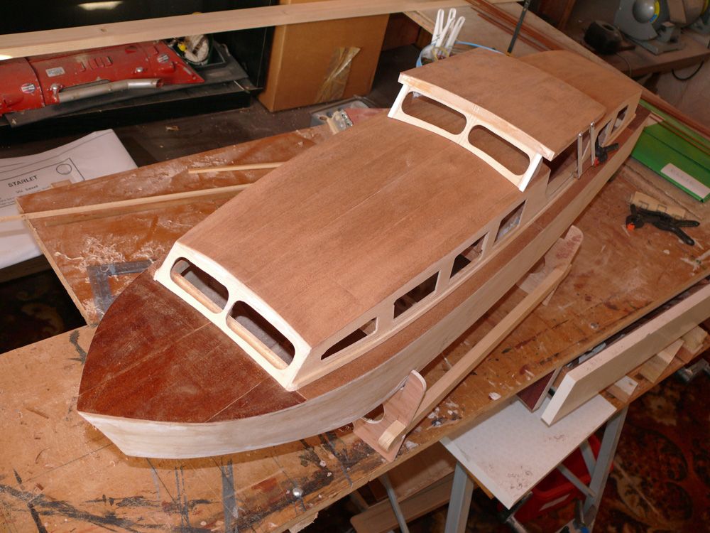

                                                A few work in progress pix, chaps…..In case you thought I`d clocked off the job!
                                                Finally veneered the cabin and canopy roofs as a touch of bling!
                                                As Ashley mentioned earlier, it looks quite pleasing in raw wood state?
                                                Varnishing will either make it….or break it!
                                                It`s surprising how much sanding it takes to remove the slightest mark!
                                                Any comments from the Drawing Office?

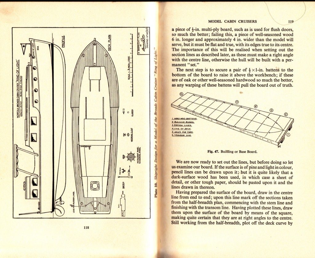

                                                    I think that your build of Ellie looks superb and whatever colour scheme you choose will only enhance the finished product.
                                                    The design supervisor has also added her approval to the build and Jane never lets me publish anything that isn't 'just right'.
                                                    My only concern is related to the design of the canopy as having seen it 'in the flesh' I have to agree with you that it just doesn't sit right with the rest of the boat, of course this might be due to the perspective of the photograph and it might look different again when the gutter lines are fitted to the cabins but at the moment it looks chunky and lacks elegance.
                                                    I will wait until your model is finished before making a final judgement on the canopy but at the moment my gut feeling is to reduce the width by 8mm and move the supporting arms further toward the stern.
                                                    I would appreciate your comments on the canopy.
                                                    #44238
                                                      You might find this image showing the canopy arrangements of Ring of Light from the Reeves & Thomas book. useful.
