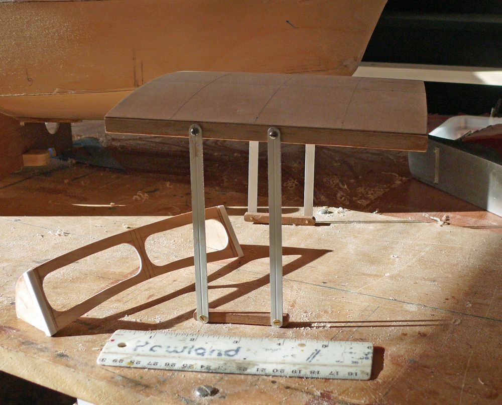

            The canopy is built as a free standing assembly and will be easy to position along the cabin walls
            The windscreen has side walls added for easy installation and rigidity
            I trust this meets with the approval of the Drawing Office?

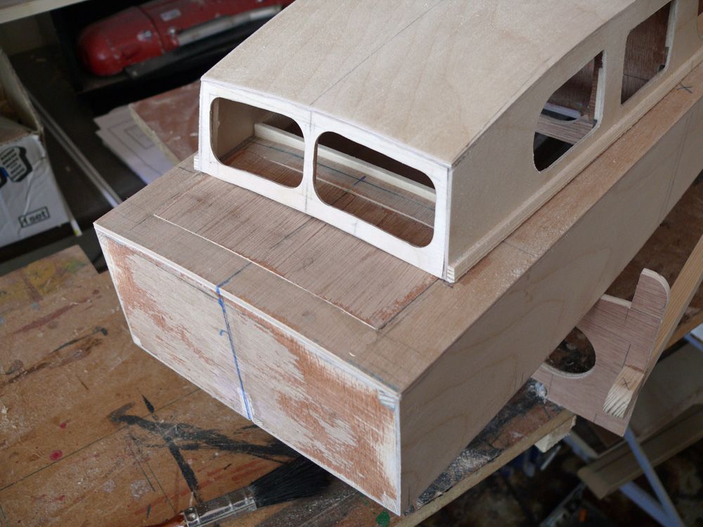

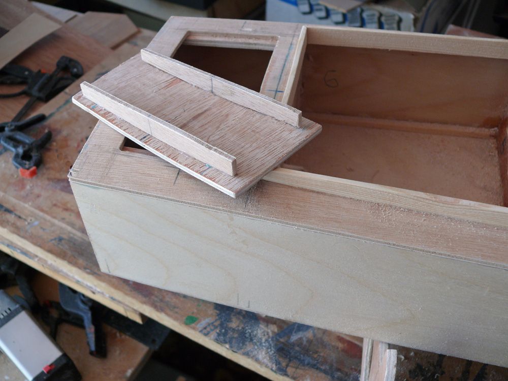

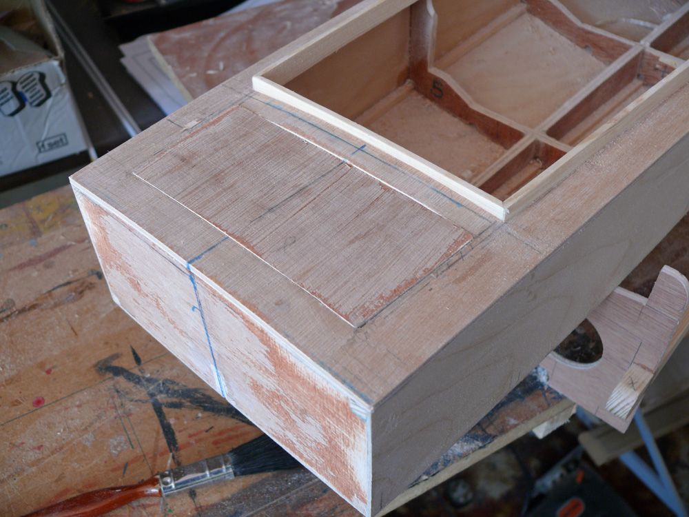

                    The rear hatch construction….
                    Two formers were cut out, using the transom `s top edge as a template and clamped to the hatch lid to obtain the correct curvature
                    I suppose the hatch could be glued to the cabin?…….eh?………Not really

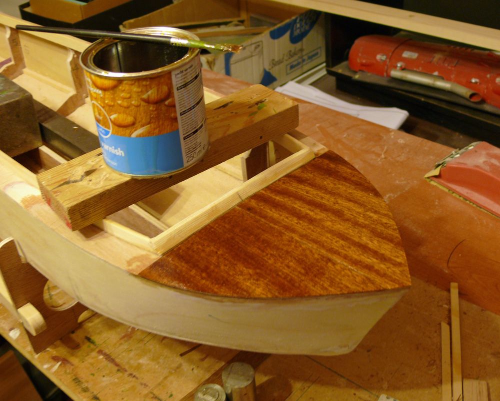

                                            Now for WIP!
                                            Something exciting that will get our Red Leader all excited!
                                            Veneering the deck!….OOOOOoooooo!!!!
                                            Like it, Paul?
                                            Sure do, Bob!
                                            I had to varnish it at this stage, to protect the veneer, as it is very brittle and only 0.010" thick

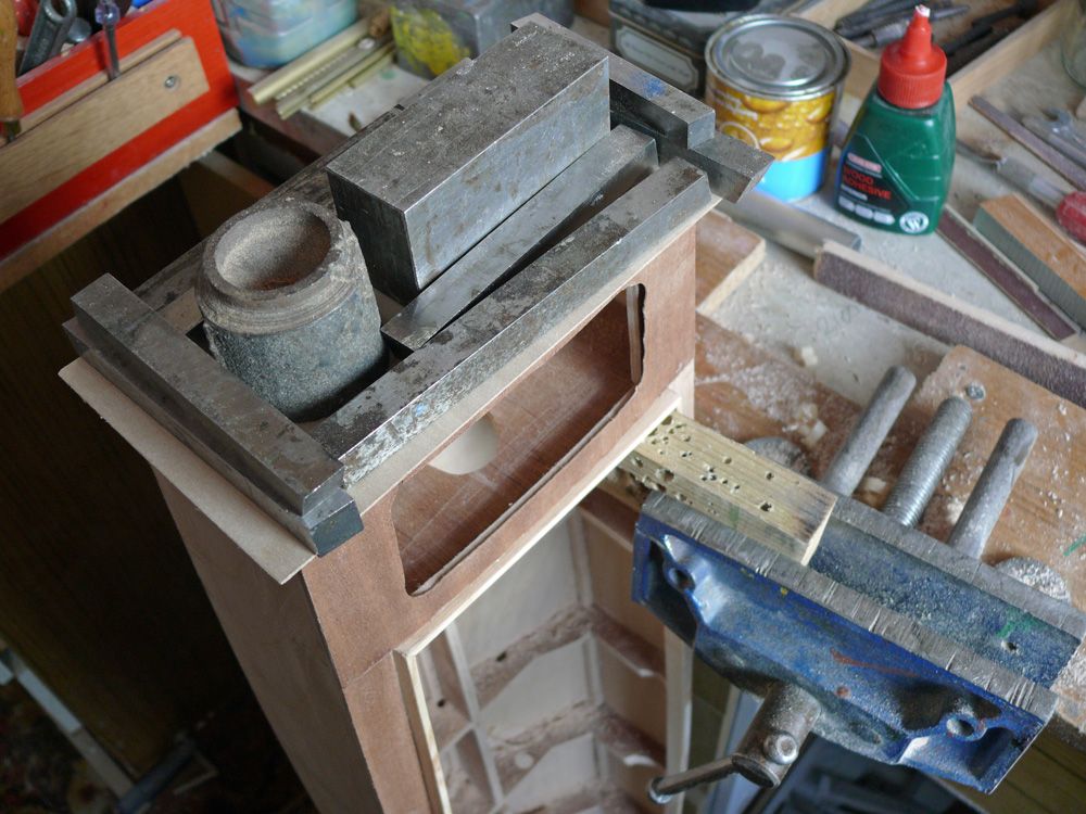

                                                Working on the Sponson is a pleasant job
                                                Note how the hull is resting on a block of wood held in the vice and the other end is restrained by the litter bin!
                                                A clean sheet of ply is resting on the damp veneer to prevent rusting
                                                We`re lovin` it!
