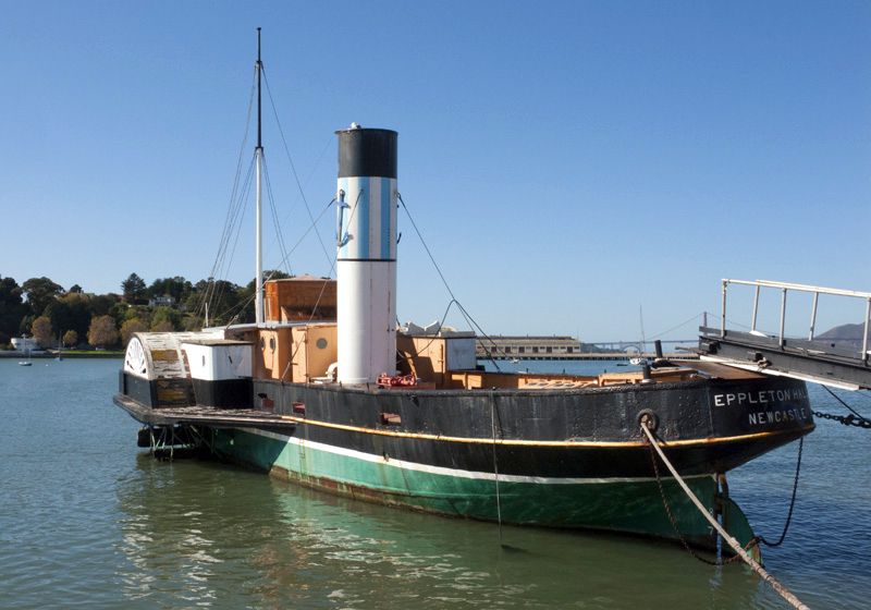

                    Hi Bob , found this while browsing , thought of you ……Larry…
                    #36514
                      Thank you, Larry
                      Any info on this paddler?….It looks very similar to Glasgow

                      LARRY WHETTON
                        @larrywhetton68737
                        Bob thats what thought found it on the web while searching info on paddle steamers , will have
                        new search to what i can find … Larry….
                        #36517
                        LARRY WHETTON
                          @larrywhetton68737
                          try this type in eppleton hall hamish couts , wich takes you into paddle tugs info,
                          some nice pictures there including epplton hall , there is link to the San Francisco maritime musum,
                          again all the info is there , hope this helps …Larry..

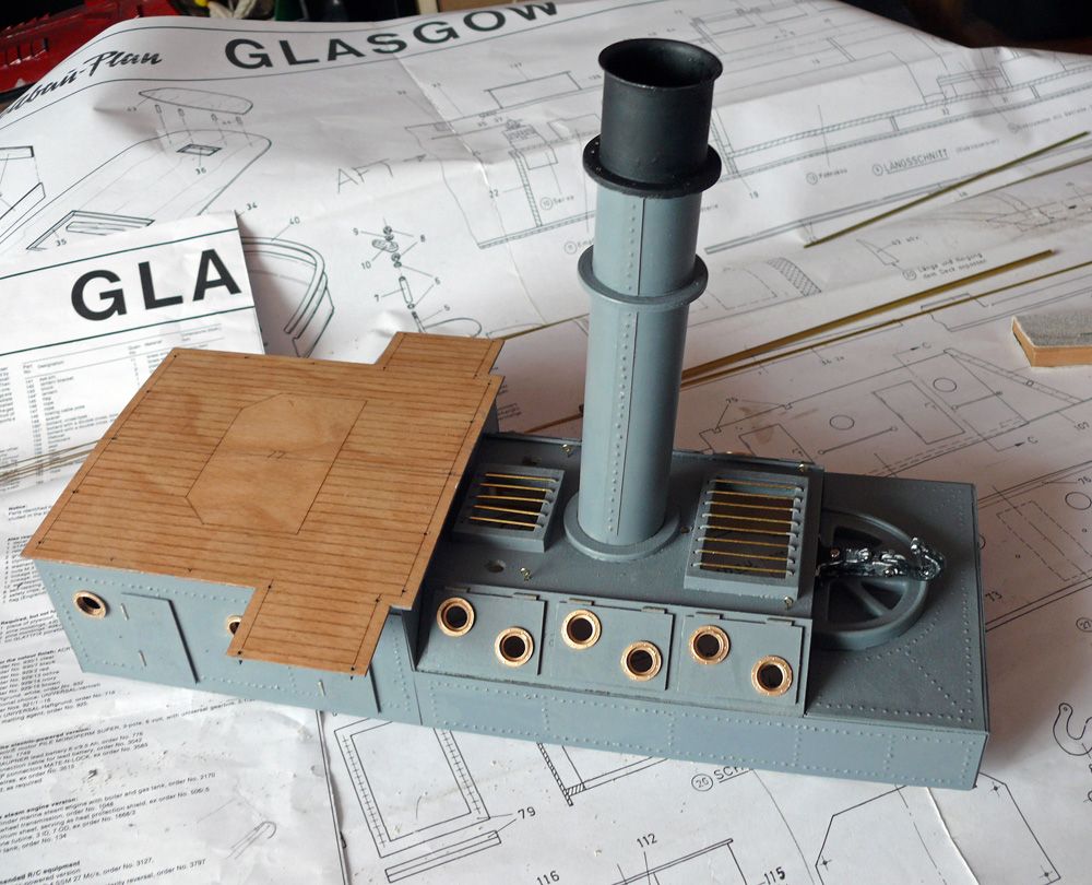

                                    Just a WIP picture
                                    Covered the cabin area with rivetted plating for the wartime naval effect

                                      Nice paint deck looks great , could this boat be scratch built from kit plans.?..
                                      i have put some feelers out for a set ,
                                      all having crack at some paddles using ply and aliminum, using a build jig will post pictures
                                      for comments later ..Larry..yes
                                      #36577
                                        Most kit manufacturers are careful not to produce plans from which a model can be built for commercial reasons – they want you to buy their kit! Usually the key omission is the hull lines or body plan as they provide a readymade hull making these unnecessary in the kit drawing.

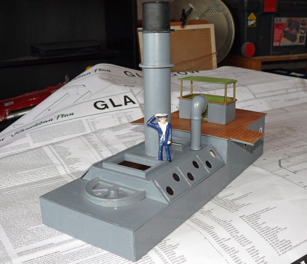

                                        #36613
                                          I`m really impressed with the level of detail included in this kit and the cabin section will really come alive when the handrails and chimney details are in place, in the meantime, anotther WIP picture…..To help future builders
                                          #36614
                                          LARRY WHETTON
                                            @larrywhetton68737
                                            Good Morning,
                                            Bob your rivit detail is first class , how did you do it..?.. Larry..
                                            #36615
                                              Hello Larry
                                              I hope you like the naval appearance now?
                                              The rivet effect is thick artist paper with a mechanical centre punch creating the rivet heads
                                              It`s very easy and rivets always look nice when painted
                                              #36618
                                              LARRY WHETTON
                                                @larrywhetton68737
                                                Bob ,
                                                the gray livery , looks good , are puting a weapon on board ?.
                                                and do think you could scratch build this model off the plans.?.
                                                cheers Larry…
                                                #36619
                                                  Hello Larry
                                                  I think it would be very difficult to build from the kit plan, there are no contours shown for the hull shape.

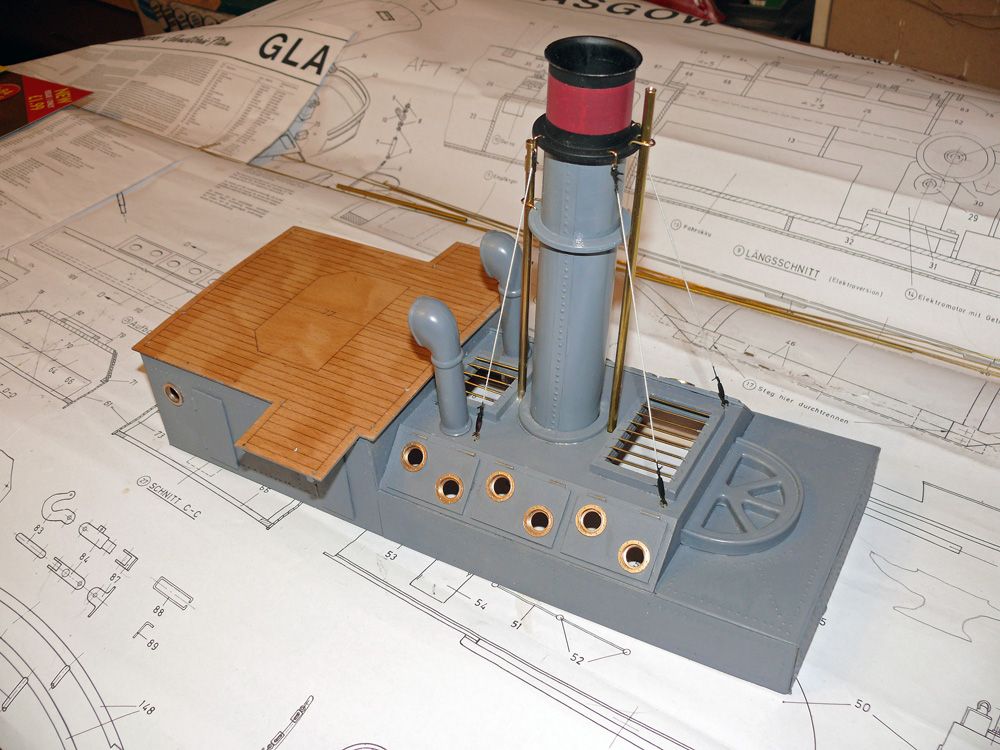

                                                  #36642

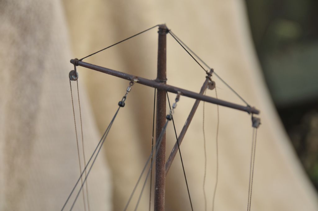

                                                    The thread seems to have a healthy following, although a little light on comments?
                                                    The chimney stays should have been wire, but it was almost impossible to do a decent job, so I opted for elastic cotton
                                                    It`s a shame to paint the brass pipes, but it needs doing
                                                    #36646
                                                    LARRY WHETTON
                                                      @larrywhetton68737
                                                      HDMLhH
                                                      hI Bob, stays look good, i use a shrechtey nylon used to string beads from a craft shop,with a small ali tube sleeve crimped after pased through fixing point, also heat shrink used with small fishing swivels. cheers Larry…
