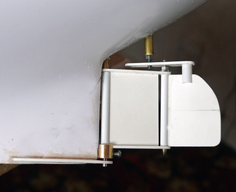

        #35939
          The kit rudder can not be removed once assembled, which is not to my liking!
          Made a Becker rudder instead, just for a bit of interest and it`s nice to show to the club members
          Also modified the bottom bracket, to something more substantial

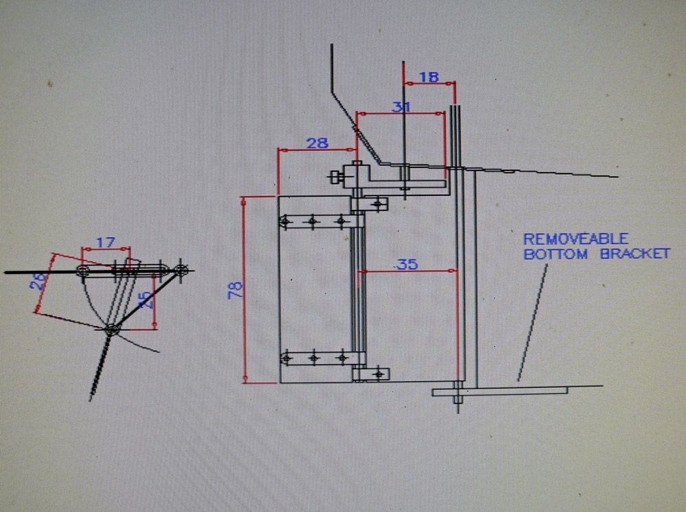

            Hello Bob ,
            thats a very interesting rudder , is there working drawing any where <?, …Larry…
            #35941
              Thank you, Larry
              I'll post a few sketches shortly, with a few improvements of course

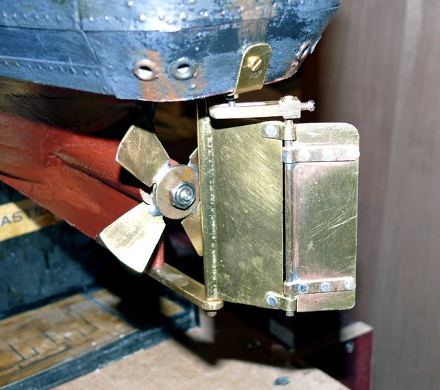

                Hello Larry
                Here is the CAD drawing of my Great Eastern Becker rudder
                And a clear photo of same…….Pick the bones out of that!
                Rudder improvement
                #35944
                  A thought has just struck me!
                  Will a Becker rudder work on a paddleboat?…….ie…….No prop wash!
                  Too late now

                        LARRY WHETTON
                          @larrywhetton68737
                          Hi Bob,
                          Thank you for drawing nice and clear now ………Larry….
                          #35955
                            But , the question should be… how much, if at all, better does it work with no prop-wash?
                            Arguably (just to play devils advocate) an extra large rudder would work fine on a paddler, just as well as a smaller fancy rudder and for little or no extra effort?
                            Ashley bob, that looks much better in brass!!
                            #35959
                              In the first place, I ain't got no brass, but in plastic, it suits the model build?
                              Later on, I may remake the rudder in brass
                              When sea trials arrive, the Becker feature can be removed quite easily
                              #35960
                                Hello Bob
                                Nice engineering work on the rudder and up to your usual standard but have you used some ferrous metals in the construction.
                                #35962
                                  Hello Paul
                                  What a strange question?
                                  I suspect a trap somewhere!
                                  Lucky for me, the rudder post is stainless steel and the Becker hinge pin in made from brass
                                  Now what?

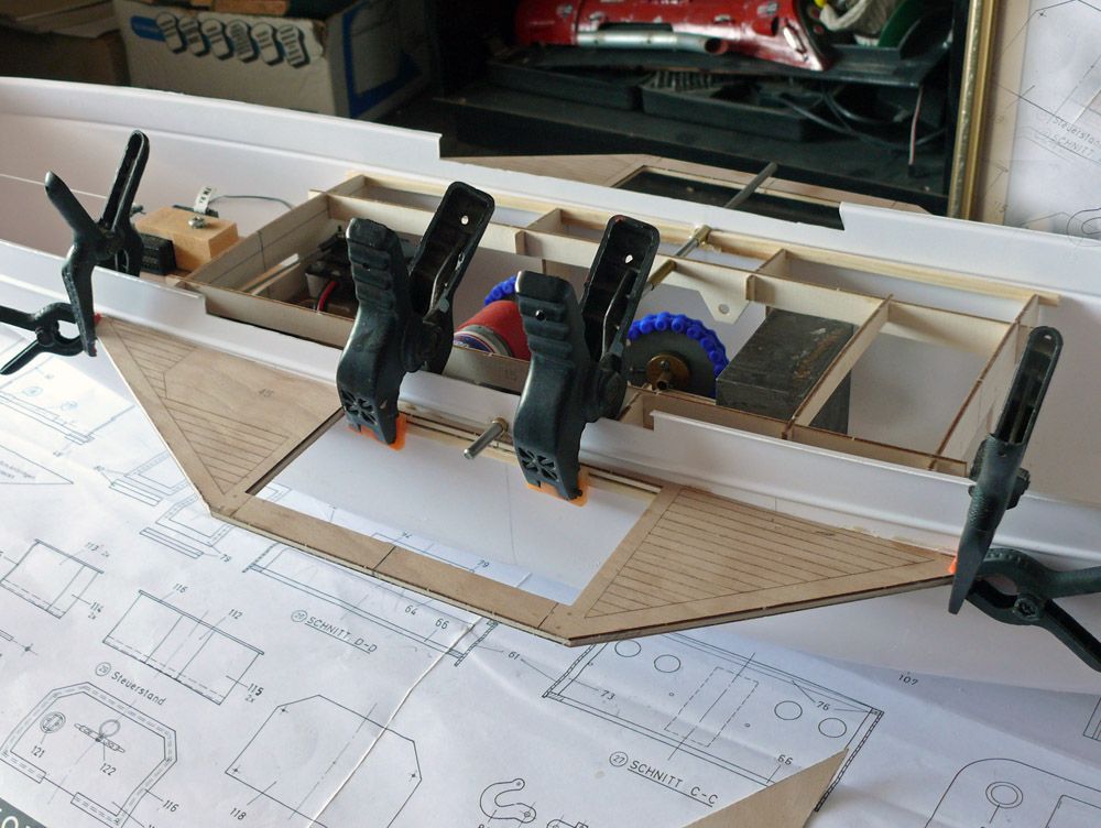

                                                  #36002
                                                    Glueing the paddlebox decks in place called for some nail biting alignment, but thanks to the odd angled supports underneath, the imaginary problems disappeared!
                                                    What a pleasant relief?
                                                    Taking shape now…….Bob
                                                    #36066
                                                    Ducky
                                                      @ducky
                                                      I think we all have those imaginary problems and think about them and put them off by doing something else on the build, then find you have to do them to progress. But you've usually given it that much thought that as you say they've disapeared, so have worried for nothing!.
                                                      Join the club Bob!
                                                      Duckie.
