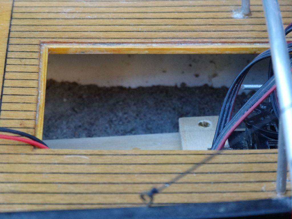

                          Hello Bob,
                          Here is a picture of the ballast in the rear section of mine. The front ballast is behind the front bulkhead and I can only asume it is similar. As previous conversation, mine was a refurb and not a new-build,. I have removed the rx and batteries for this photograph.
                          Earlier in this thread some discussion took place about this kit. From research it would appear that the Glasgow was Graupners (kit) spin-off from the free download plan Strongbow which is readily available on tinternet.
                          Tony.

                            Thank you Tony
                            Your blue ballast looks strange stuff?
                            Found the Strongbow plan………It certainly looks very much like Glasgow
                            I had no idea this free plan website existed…….Looks very interesting

                              Hello Bob,
                              The ballasts blue colour seems to have been hightlighted in the photograph, which was taken outside. In lesser light conditions the colour is more of a grey, hence my thoughts that it is some kind of a cement/mortar mix.
                              It certainly looks strange stuff to me too!
                              Tony

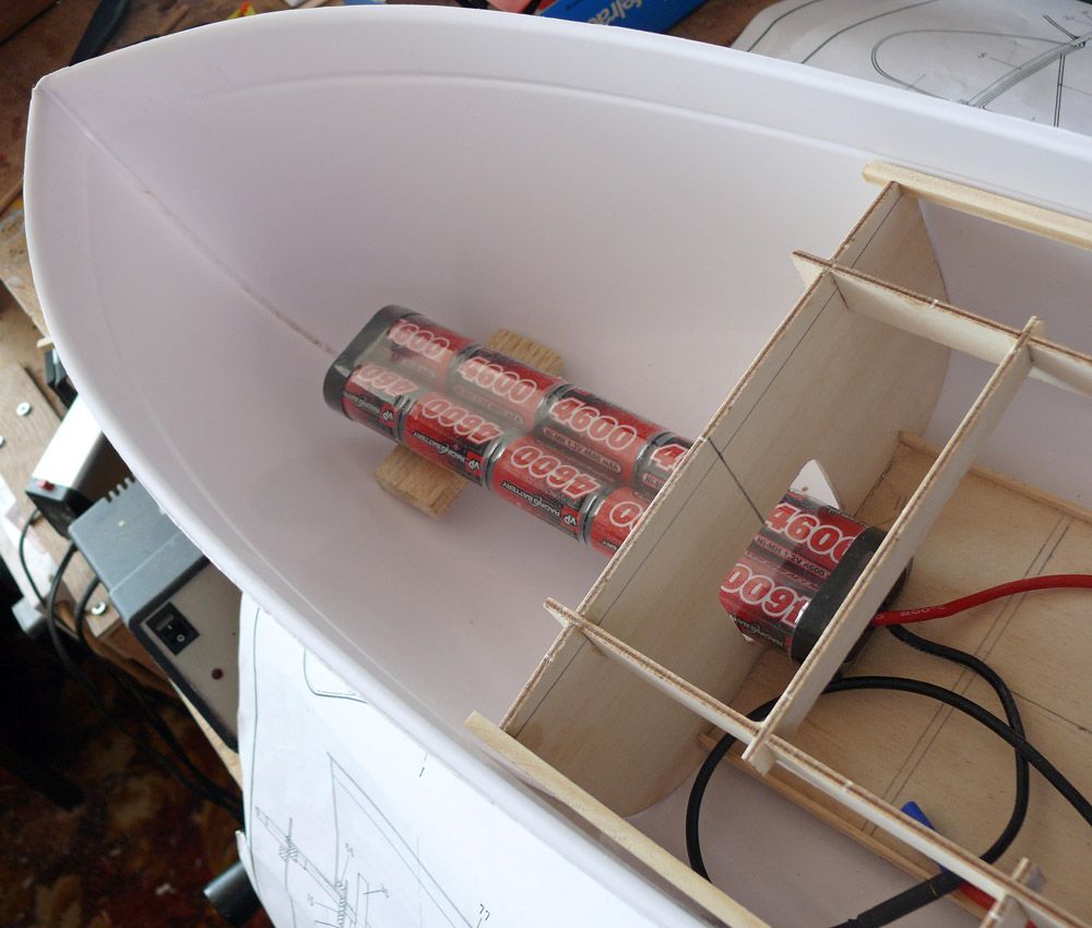

                                  Progress has been a little slow of late, waiting for ballast inf etc and a suitable battery
                                  Then I remembered the old Slo Mo batteries which I had forgotten about!
                                  Ideal for the job!……..12 volt too………Ideal?
                                  I`ve cut a hole in the forward bulkhead and will also be a nice chunk of balance weight

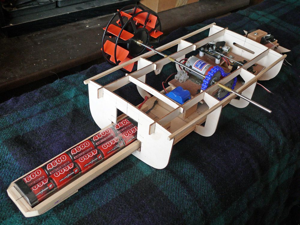

                                  #35843
                                    Made good progress installing all the gear inside the timber skeleton, where it was easy to get at!………Before being mounted into the hull and was quite interesting in the process
                                    Received a PM from a Glasgow builder, who states that his boat without batteries weighs 8lb, but can`t remember how much lead is positioned in forward compartment

                                    LARRY WHETTON
                                      @larrywhetton68737
                                      Hello Bob ,
                                      Nice and tidy job , what esc are you using ?….may do the same set up on LONGOGA….larry…

                                        Thanks Larry
                                        I'm using the old fashioned Rheostat type that came with the motors
                                        They are not to be recommended, but I've got quite a few in stock
                                        If you PM me your address, I send you one…..FOC of course
