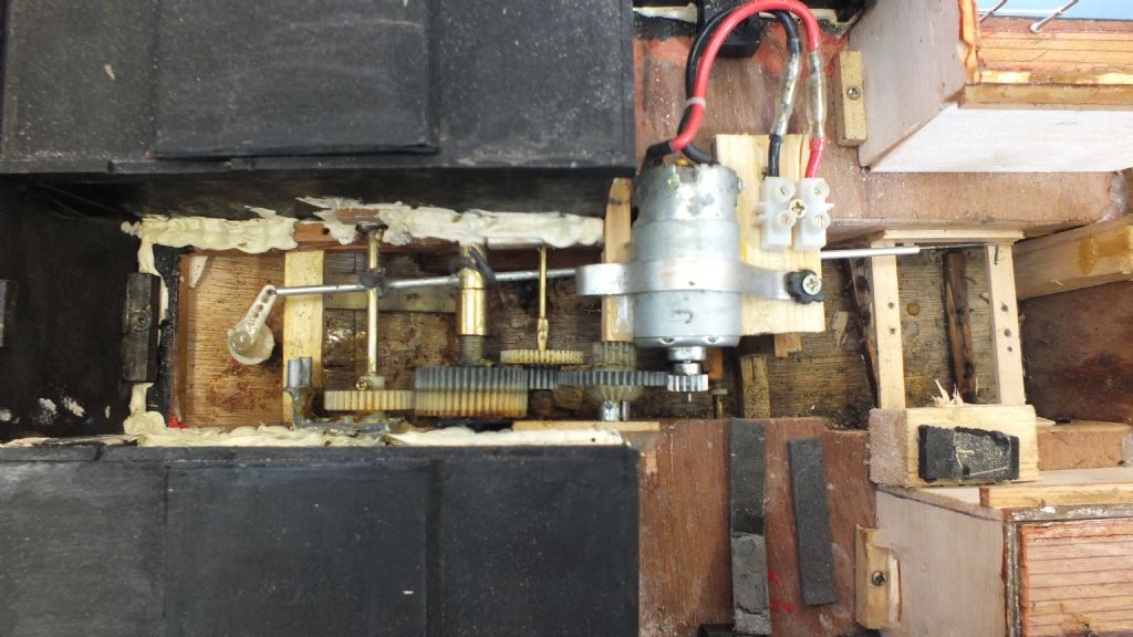

          attended the Portishead ship show the weekend and spoted a Lulonga paddler ,
          asked the builder how he drives his paddles , this what he showed me ,
          i found it mind bogling , what do you think..?.. see picture cheers Larry.surprise

          Phil Winks 1
            @philwinks1
            Hi Larry that gearbox seems to be cobbled together from old Tamiya gears from either a TL or TT 01 chassis The unused diff bevel gear on the 1st lay shaft gives them away and I suspect the servo runs a "Bobs" board under the motor mount, good old fashioned technology if ever I saw it eh?
            Phil
            Edited By Phil Winks 1 on 08/04/2013 21:16:03

              Hi Larry and Winkie
              Sorry for the delay in responding
              Your gearbox drive looks horrendous!……Don't recco copying it!

              LARRY WHETTON
                @larrywhetton68737
                Hi Bob ,
                No way , dont have anougth mastic to replecate the drive but have a old ford gear box i could strip down laugh laugh thanks for replying , weather is on the up,….cheers Larry…

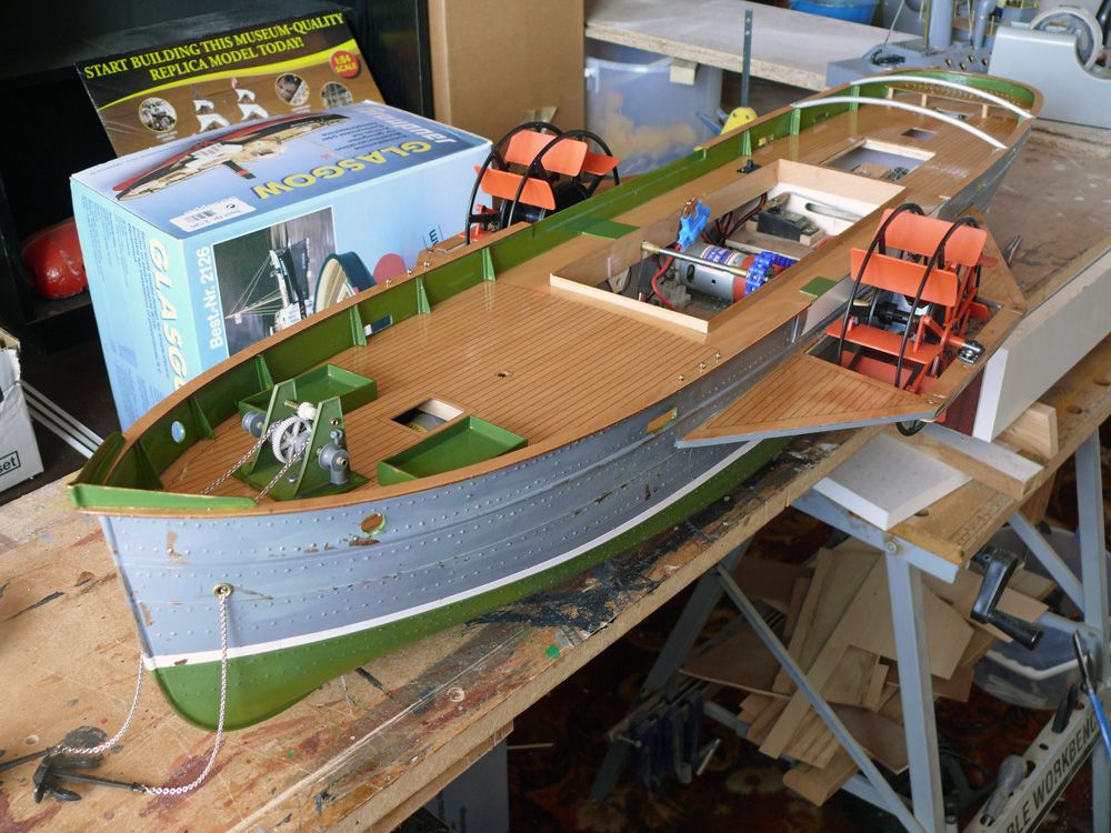

                        Hi chaps
                        Made an effort this morning and tidied up a few bits and pieces
                        Then another coat of varnish for good measure…..
                        Now wondering about the colour of the floats?…..The snag is that the paint may jam up the mechanism?

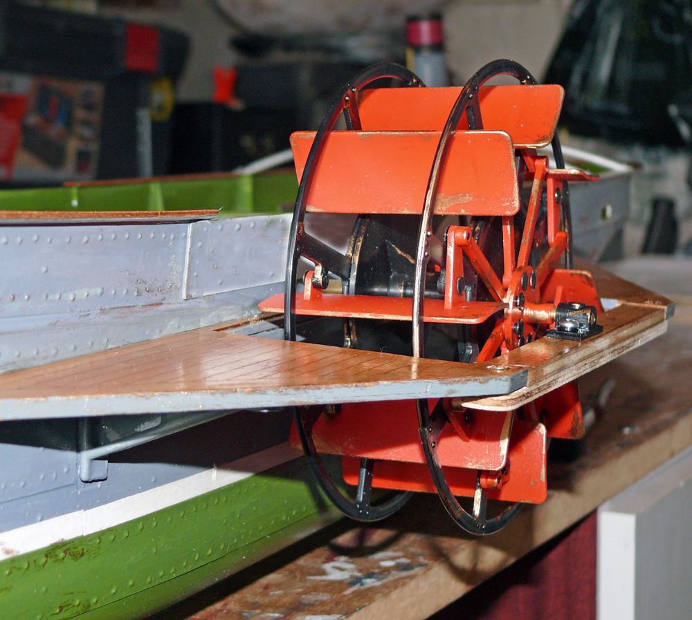

                                                Problem solved with the garish paddle wheel colour……..Mek `em outa brass!
                                                That`s better……Bob

                                                    #40852
                                                    Phil Winks 1
                                                      @philwinks1
                                                      nice weathering again Bob, as usuall wink
                                                      Phil
