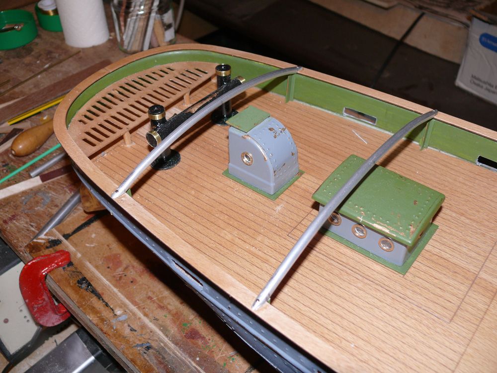

        Thanks Larry…..Good idea!
        The card gussets were too fiddly!……..Used your idea eventually and made them from plastic "T" section………Solid brass of course!

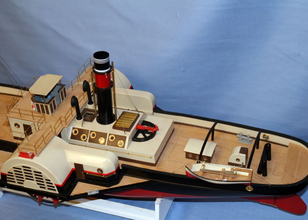

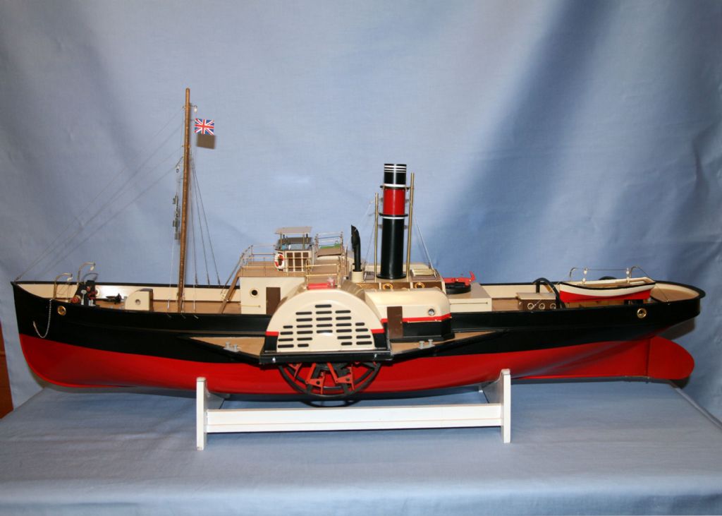

          GUARDSMAN ready to launch , when the weather gets better …..yes….Larry…

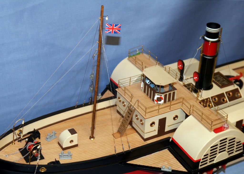

            Latest WIP report on the Glasgow build.
            Not much done lately, due to the gloomy weather. The top deck needs to have a bonding coat of Matt varnish, to blend in the gusset additions etc, but the latest cold weather has put paid to that, at the moment.
            The motor chain drive needs speeding up, having seen a Glasgow drifting about the club pond with no sign of paddle wash!

                      Finally got the chain drive sorted!
                      Actually, I needn`t have bothered!……..The reason for the slow speed, was that I was using a 6v supply instead of 12v!
                      Time for a bath test now and see what`s what!

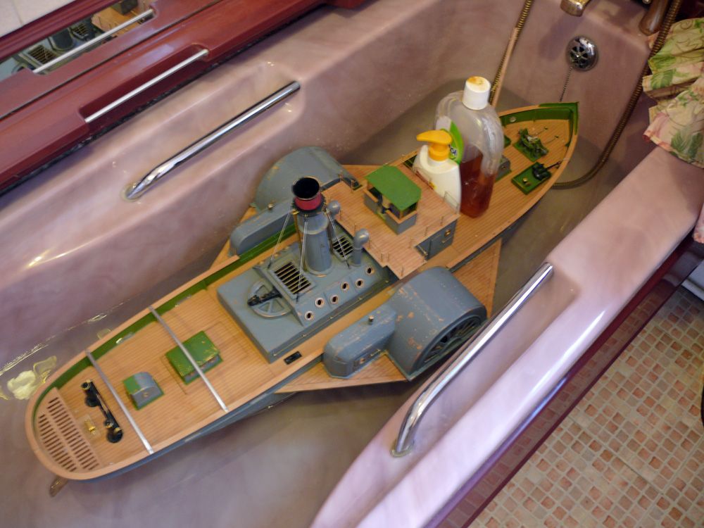

                        The Bath Test chaps!
                        I was surprised how big the model looked in the bath!
                        The model is very balance sensitive about the longitudinal axis and with a few quick bursts of the paddlewheels, she almost rolls over! Probably caused by one paddlewheel doing all the driving in a slight tilt……….Steady as she goes, on the first pond trip, eh?
                        She needed about 2 lb at the front….or about half a bottle of Dettol and a bottle of hand cream to be more precise! More ballast may be required later, as it was difficult to see the waterline
                        The Becker rudder worked well, but the tendency to roll over is a bit of a concern.
                        A keel type weight may be a good idea, for stability, similar to Great Eastern, where the ballast can be adjusted easily
                        A floating safety buoy on deck, with a length of rope may be adviseable……In case she goes under?

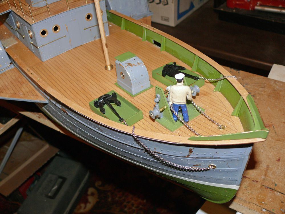

                                                  My attempt at a Glasgow build is now almost complete. I’m waiting for some “T” section to arrive for the rail stanchions and I will paint the waterline when I have checked it. I have been so busy building yachts for other people that I haven’t had the time to do anything other than a straight build. I will however rework the paddle boxes later as they don’t look anywhere near as good as yours. I wish I had your patience and attention to detail.
                                                  I fitted the recommended motor and gearbox which, with the 12v battery, are very heavy so I don’t think I will need any extra ballast. I’m very impressed by the epicyclic type gear box. It is a neat little assembly which will allow me to change ratios if I haven’t enough paddle speed.
                                                  I hope to do a sea trial early next month. I will let you know what happens……..wish I had fitted your wreck marker…………..

                                                    I note you have omitted the bulwark gussets till last?……. They are very awkward to fit at this stage,due to the tricky painting job!
                                                    The waterline should be as drawn and you balance the boat accordingly?
                                                    I recco an external floating lifeline on deck…..You never know!
