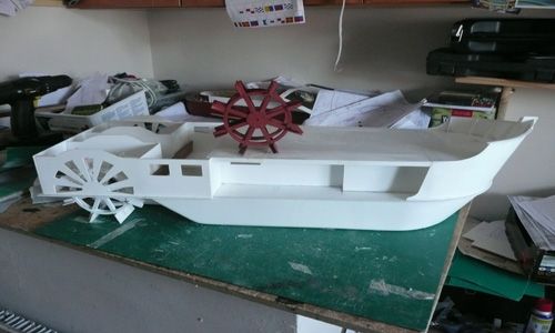

      Good Morning BOB ,
      Great walkways, and the modifide paddle boxes , i fretted out mine on the Longonga,
      see picture , is it christmas launch..?..with little mulled wine/ yes
      LULONGA
      cheers Larry…

        Thanks Larry
        The launch is a long way away at the moment………It`s zero degrees here, this morning!
        Get some simple paddles made for your Longonga!

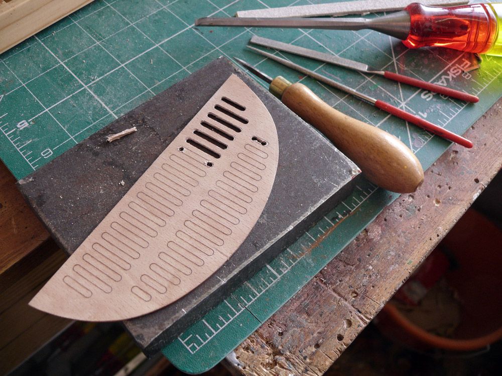

              Glutton for punishment?
              I just couldn`t leave this grid as is!……..Looked at it for ages before….biting the bullet!
              It`ll be worth it!……Bob

                      #37947
                        Don't know if this will be of any help but when I had some similar slots to cut out I used a router bit mounted in my pillar drill.
                        #37949
                          Morning Paul
                          Not a bad idea, but the ply would probably split? I could have done it on the lathe too
                          I did think of making a press tool die set, but getting the spacing right ruled it out
                          It's done now and glued in position…..Photo shortly, when the sun comes out!

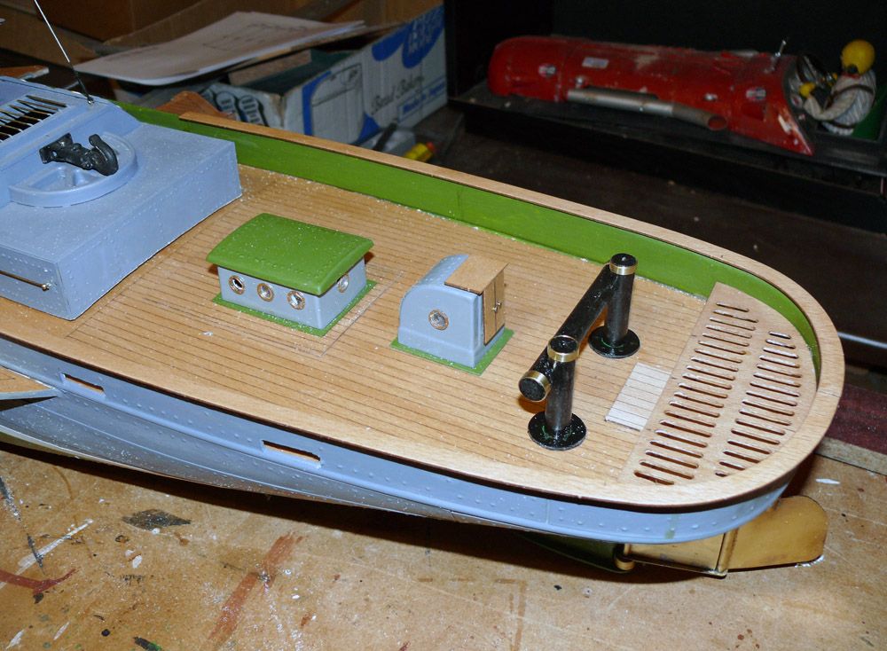

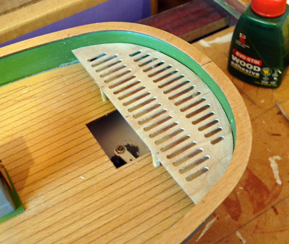

                          #37956
                            There yer go!…….All done and dusted and well worth the effort too!
                            Now then…….Just noticed there are no scuppers in the bulwarks!
                            Shame on you, Graupner!
                            It`s a fine time to cut the scuppers out now!………Will have a look round for some real ones on the net, before assaulting the rivetted hull plating!

                                    #37989
                                      Just noticed the non waterproof glue container on your workbench……..can we assume that you refill this with waterproof PVA as the container is a handy size for model building.

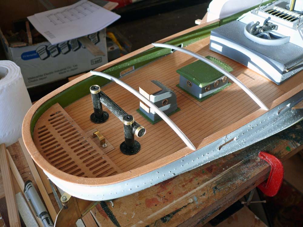

                                        #38034
                                          Work in progress picture
                                          Two scuppers cut out and cable guide fitted

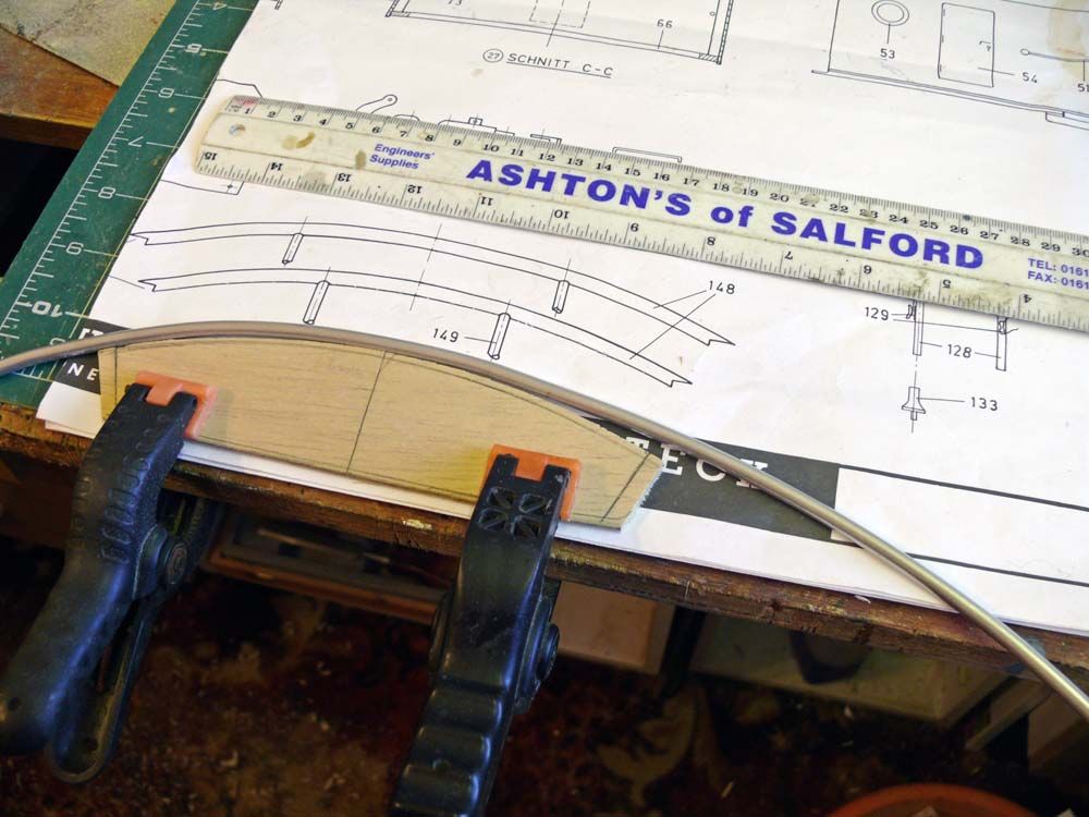

                                              For the non engineers, this job could be a little tricky!
                                              I need to bend two Aluminium tubes to form the rear cable guides
                                              First requirement is a former, cut to the required arc size
                                              Aluminium "age hardens" with time and is stiff and inflexible and needs to be annealed…..This is done on the kitchen stove or a blow lamp.
                                              Heat the tube for some time, all over and cool off under the tap
                                              Clamp the former securely to a flat surface and gently bend the tube over the former……..Be careful!…..The tube is now very soft. After several minutes of bending and shapeing…..The Ali…….."work hardens" and needs to be annealed once more
                                              The former……Use the table surface to keep the bend flat
                                              There we go!…..The jobs done
                                              Filing the ends accurately was quite fiddly
