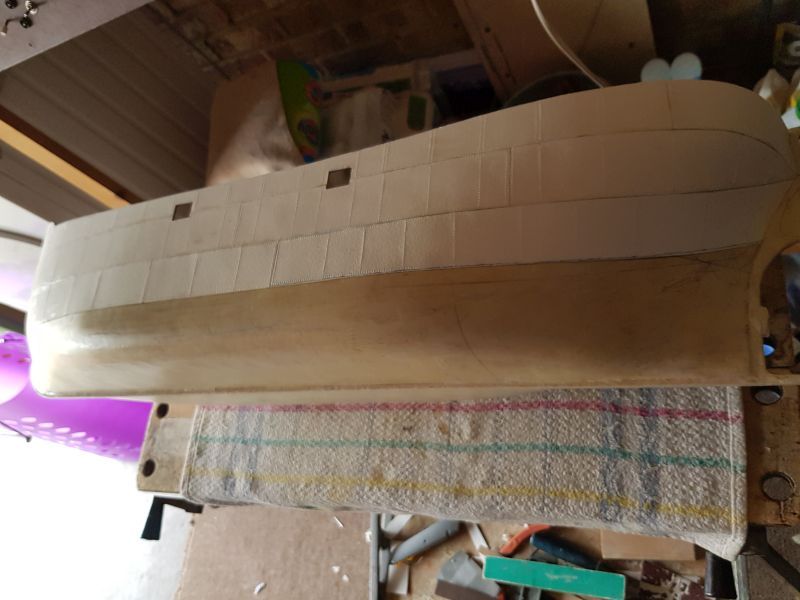

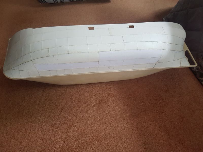

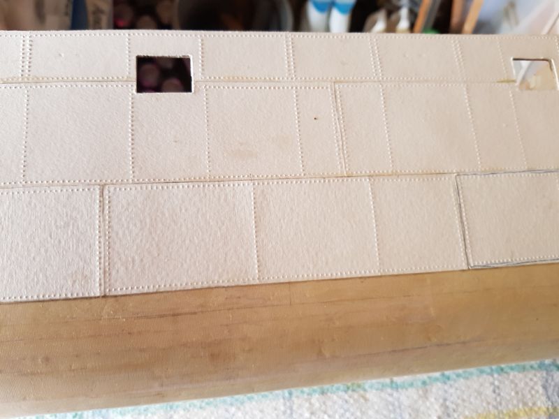

            20230813_155341s.jpg20230813_155243s.jpg20230813_155234s.jpgHi all,
            A little more progress on the plating. I`ve reached a point where I`m not sure what the next move is in regards to plating round the curve of the hull. I`ve looked at as many pictures as I can and apart from many of the boats having welded hulls, I`m not sure how plated hulls would progress. Pictures I`ve seen seem to show a diagonal fixing at the bow and stern but I`ve not found any pictures showing what happens in the centre section, meaning, would plating be wrapped around the curve vertically or narrower lengths lengthways…..if you see what I mean. Most pictures I`ve looked at show a fair old selection of plating, almost made to fit the particular place on the hull.
            In the meantime I`ll draw some lines on the hull to give me some idea.
            #105593
              Plating is looking really good Jim.
              Can't really help you with round the curves as Faireys don't have any! laugh

                #105741
                James Hill 5
                  @jameshill5
                  Now that progress is being made again with my attempt at plating the Puffer hull I`m looking ahead at what I can use to seal the card.
                  I`m wondering if Ezi-cote would do the job never having used it before. I would need to use something really thin or I will lose the rivet detail, and with that in mind, the hull will have to be spray painted.
                  Hoping someone might have experience.
                  Many thanks, Jim.
                  #105744
                    I think EzeKote would be too thick in this instance. As you say, you need something really thin which will both seal and sink into the surface.
                    Glynn Guest uses card a lot in his models and swears by traditional model aircraft dope as a base for painting. It's what I would be inclined to use in this situation.
                    Another possibility would be shellac based sanding sealer.
                    Anything water based runs the risk of lifting the surface of the card.

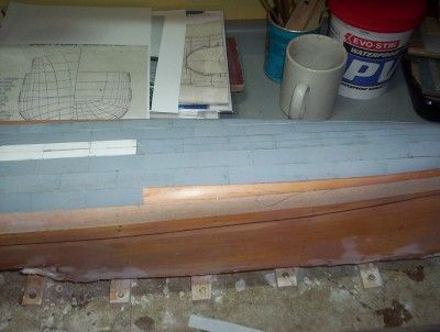

                      de5.jpgde3.jpghi there
                      When I was building HMS Daring, I plated the hull using standard printers' paper – the one we use in our printers. I glued it on, using PVA glue and when it was all dried I sealed it using a waterproof PVA glue. I then sprayed over the top of it with Humbrol enamel paints. I ensured it was well sealed. One trick I did use was to pre-spray the card (before I used it) with a grey undercoat paint from Halfords. I found that this enabled me to handle the card better without it tearing, or, sticking to my fingers – just one side was sprayed of the card.
                      Couple of images follows
                      #105752
                      James Hill 5
                        @jameshill5
                        Thankyou both Colin and John for your suggestions.
                        I`m not quite ready to seal the card just yet so will have time to experiment a bit.
                        I know what you mean about glue sticking to your fingers and then the card John,having suffered a bit of that already. The saving grace there is that the Puffer hull was quite rough so paint will probably hide most of the slightly rough bits.
                        I`ll see if I can find a model aircraft magazine to look for the dope unless someone like De Luxe do something similar.
                        Many thanks, Jim.

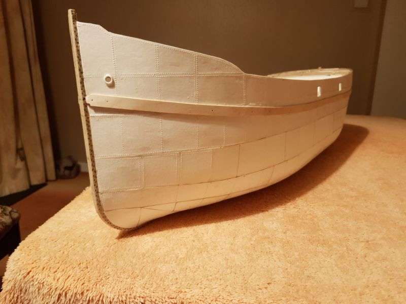

                                James Hill 5
                                  @jameshill5

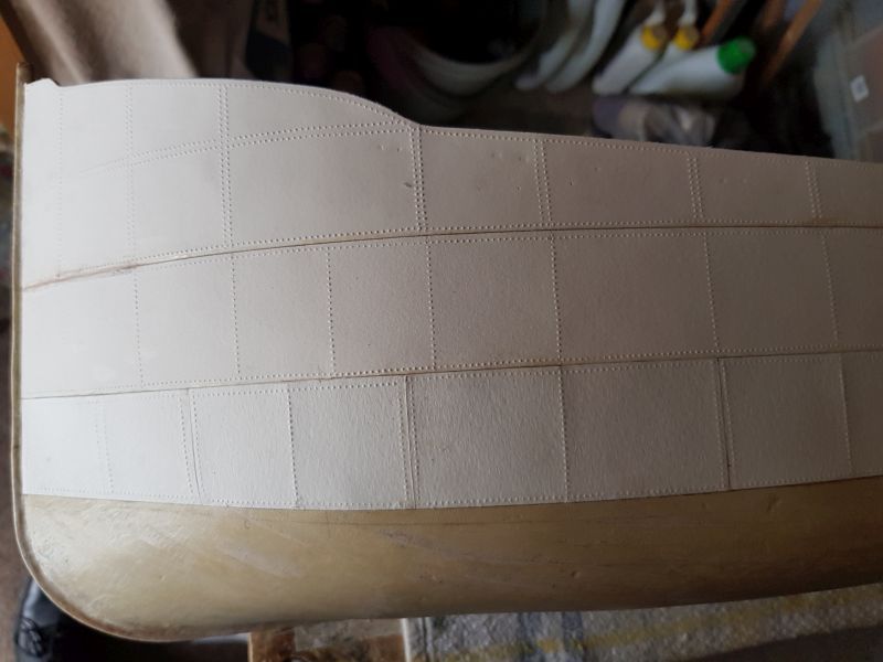

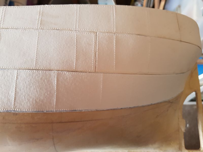

                                  20230910_124630s.jpg20230910_124500s.jpgFinally managed to get one side of the hull plated using card. Some of the butt joints weren`t perfect but I think careful use of filler should improve the look.
                                  Now working to complete the other side. Once done, I can look at tydying everything up and start thinking about sealing it all.
                                  Edited By Colin Bishop on 10/09/2023 18:52:52

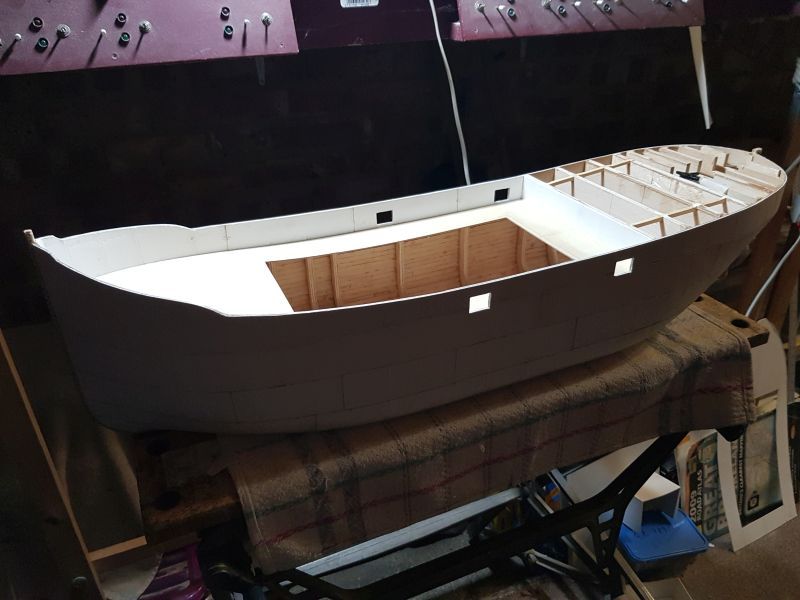

                                      My attempt at card plating the Puffer hull is now complete. There needs to be some tidying up done before I get to seal it prior to painting. I`m going to plate the insides down to deck level, then the next step will be making the rudder and connecting it to the servo and marking the position of the mast.
                                      I haven`t posted pictures as the completed hull looks no different really to pictures already posted.

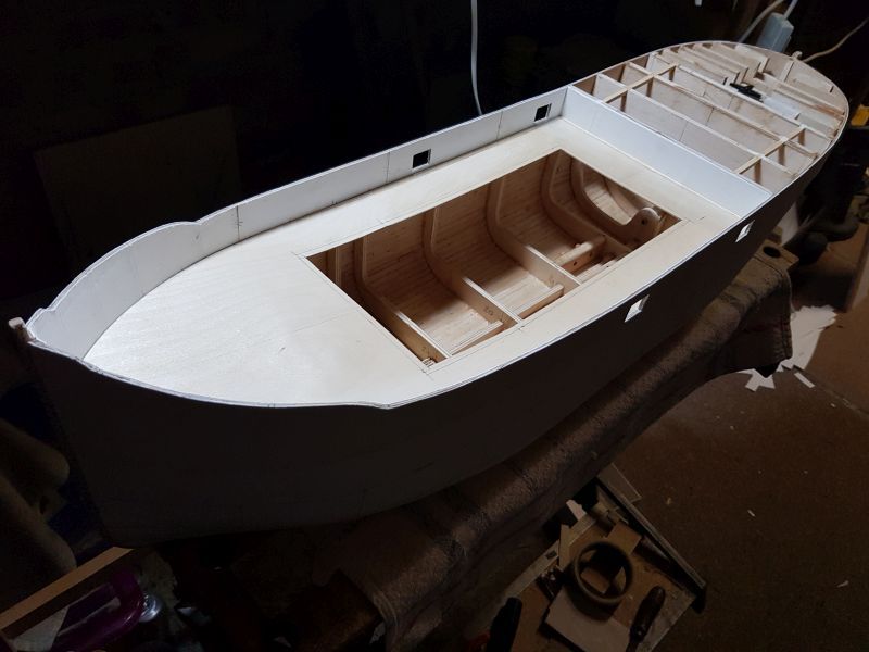

                                        A little more progress today.
                                        All the main plating has now been attempted. Because the card is white you can`t see much rivet detail, so I`m hoping when it`s painted the detail will be more noticeable. If not, I`ll have to re do the rivet detail using the method Neil suggested on his lifeboats.
                                        The deck has been made to fit but won`t be glued in yet as there are things to mark out and it will be easier to do with the deck free. A motor, speed controller, dope to seal the card and batteries will be next to get. I think I said before, I`m looking at a 6v lead acid battery for power as it will help with ballast.
                                        Once I`m happy with where things will go the next bit to make and fit will be the rudder.
