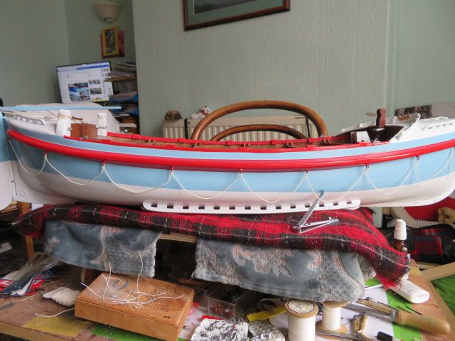

          img_4728.jpgimg_4727.jpgthey look a lot better once all the scragg ends have been removed.
          just be careful though when cutting………… I use nail clippers far easier than scissors as you can get in closer, not to catch any of the grab lines…………….as you cant do a repair, you just have to re-rig the whole side unfortunately………..been there, done that, got the t shirt as they say!!!
          in a few minutes, I'm going to start rigging both masts on the motor sailor and the single main mast on the sailing lifeboat.

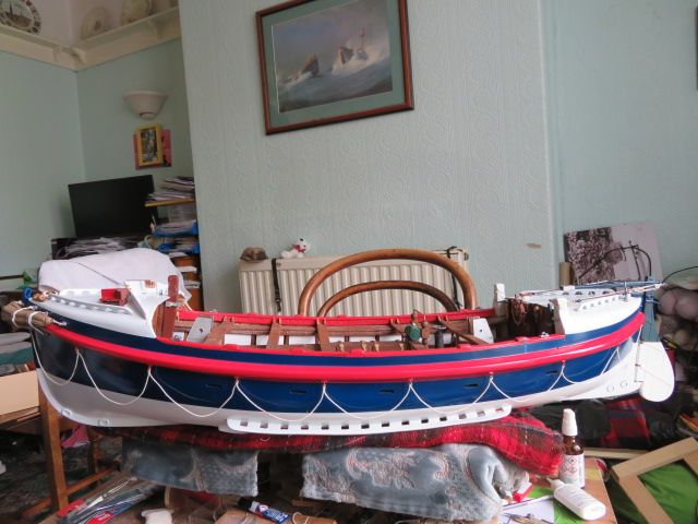

            WELL!!!………I AM MENTALLY KNACKERED!!!.

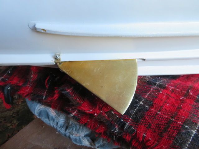

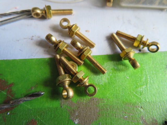

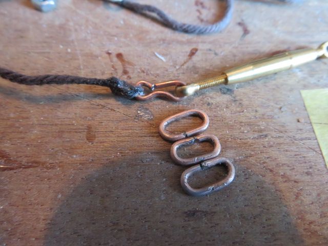

            Started work on the motor sailor at around 16.00 hours this afternoon and but for a short break of 30 minutes around 20.30 to make tea for us I finished the jobs that I had set myself to do at 00.23 this morning.
            first job was to grind the lugs on the brass drop keel thinner so that it would fit into the keel slot in the hum with the uphaul rope to fit without jamming. job done!
            next, was to make link fittings between bulwark tops and turnbuckles/bottle screws for the rigging.
            then to attach the shroud lines to the top and bottom blocks.
            and finally rig them all together………that alone took nearly 7 hours………..and still one boat to do…………
            so!!!! eany meany miney mo, which of the beers has got to go!!
            silly question really……….I feel like both of them to give me a good nights sleep!…….don't need to get up too early tomorrow.

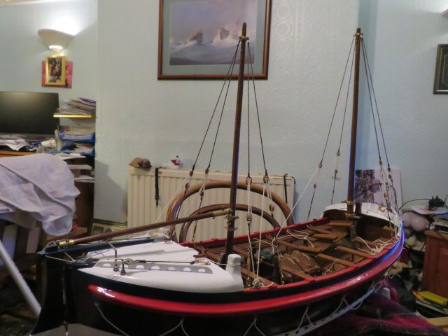

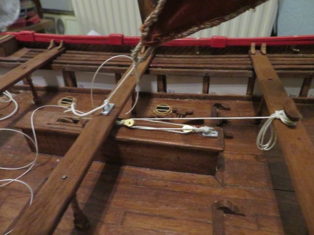

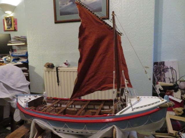

                            img_4758.jpglife would be more depressing than it is, if you didn't take it light heartedly, Bob………always look on the bright side of life……..my motto.
                            anyway……..didn't do too much today as donated blood this afternoon and left me feeling a little tired…..
                            concentrated on the sailing lifeboat this afternoon and evening.
                            firstly I rigged the pulley blocks for the "dummy" drop keel; blocks.
                            Then erected the signalling lamp mast.
                            then it was the time to pull in the mast shrouds and tether them to the wooden cleats that were made earlier.
                            finally it was time to attach the main sail to the upper boom and rig it temporarily before I attach the rigging blocks tomorrow, but had enough for tonight. feeling a little tired after donating blood this afternoon so am going to have a beer and watch some TV

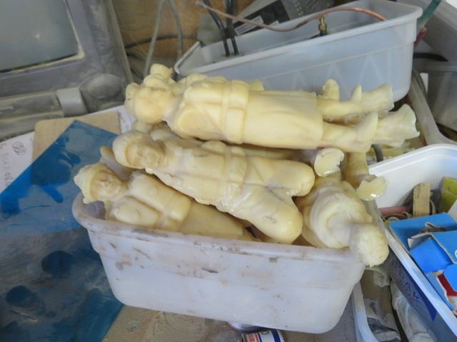

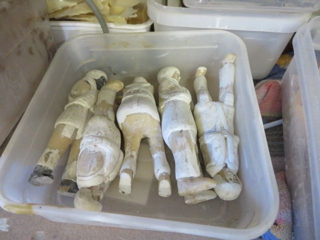

                                          Thank you Bob, Your comments and all who contribute are much appreciated.
                                          the little figurines are not all that difficult to make, to be honest.
                                          I have actually made a set of figures for each change of lifeboat mans apparel since the cork life vests of the late 1890's through the kapok, the first inflatables to the very presently Helly Hanson attire over the last 12 years.
                                          I started off with the first inflatables when I built my trio of lifeboats together and wanted crew. I gave that set of moulds to a friend who was having mental health problems and wanted to focus his mind on doing something creative, and originals figurines to Dave Metcalf .
                                          then I was asked to make two sets for another person heavily involved in the RNLI…..I converted some figure's that I had converted into the CORK and KAPOK LIFE VESTS and moulded them for the chap, and finally i remoulded some of the spares that I kept for myself into the most modern of Helly Hanson dry suit attire.
                                          the only set I have never done was a set of figurines dating from post inflatable of the 1990's until the Helly Hanson gear came in a couple or so years ago, because Adrian Gosling of Speedline models was already doing a set of that attire, and didn't see the point, and also don't like stepping on other peoples toes with repetitive or similar models.
                                          SO the first two photos below are the guys in Kapok attire that I will be putting on my motor sailor, and the last two shots are of my present figures with the originals for the moulds that I sculpted with milliput.

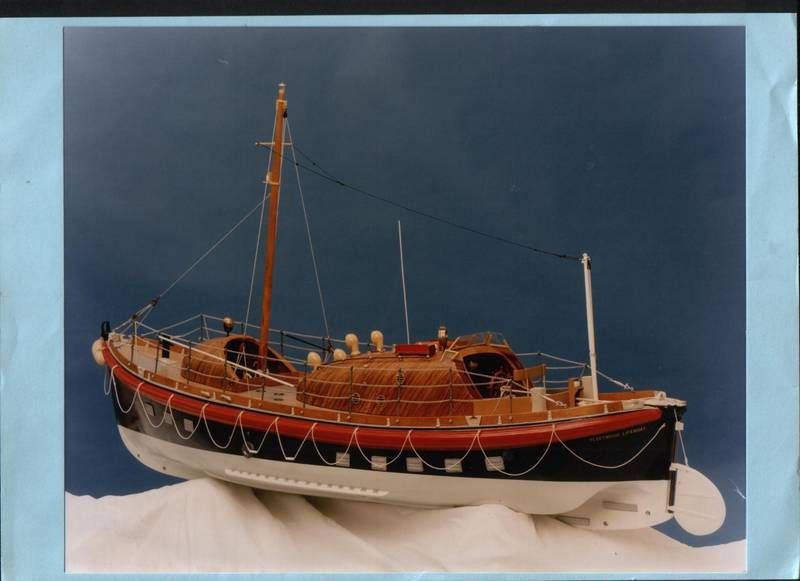

                                                      and Ray, there is a kit available that I designed and developed, which allows you to build that very class of boat, and which is now and has been available through Metcalf Mouldings since 1999.
                                                      and these two photos are of my original prototype model kit as built  by myself in 1995.
