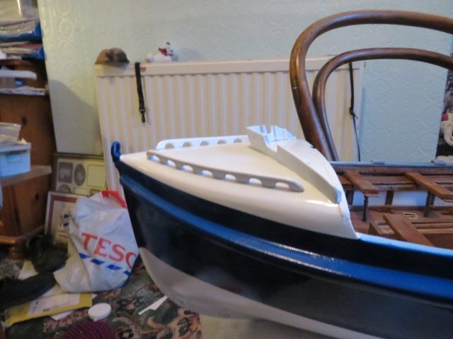

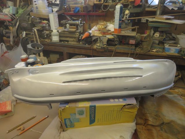

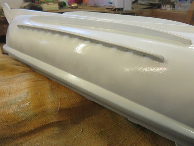

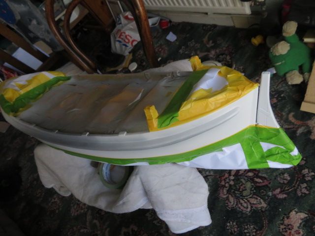

        have this morning given the end boxes of both boats a spray with appliance white from Halfords.
        I have set my phone alarm for an hour, when I will turn the boats over and paint the under sides of boat.
        reset alarm for another hour, and then give the end boxes their second coat…….and visa versa……….giving a 2 hour gap between each coat on each part of the boat.
        I have been told by my good and learned friend that 4 full coats is enough.
        then I will leave both boats for a full 48 hours, upside down so that the hull isn't touched by anything so that the paint will cure and harden perfectly..in this way, both end boxes and hull will not come into contact with anything that might leave an impression on the "soft" paintwork.
        that will be purgatory, but has to be done, lol.
        and now the first light coat of white has been added to the hull…….in an hour the next coat to the end boxes.

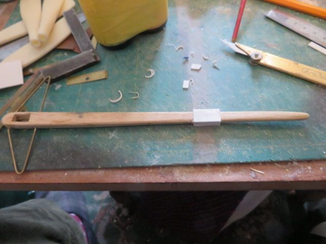

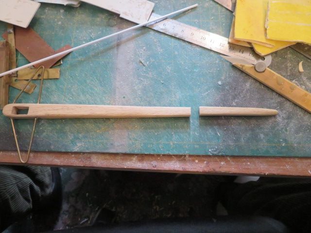

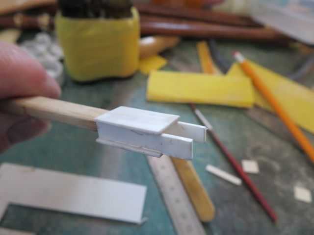

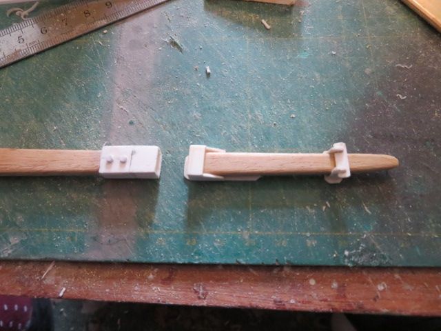

          now that I have done the work on the hull readying for paint work there are a few little bits that I have to do on the fittings for the model , readying to stick them to the boat.
          the first of them was to cut the tiller arm to the rudder on the motor sailor into two pieces.
          the boat was mechanically steered by a wheel mounted on the stern bulkhead, but with emergency tiller steering.
          however, when erected the tiller extended over the ships wheel, and would most certainly have got in the way for the helmsman, and so the tiller was shortened and relocated into a metal bracket on one end of the tiller permanently, with the shortened end located in a storage bracket on the aft bulkhead.
          with only very poor photos and brief sections of plans to look at, I can only use modellers licence to judge what the set up looks like, and in photos I would like to present my interpretation of what I could make out……….all parts were made from 0.8mm plasticard using plastic weld liquid glue.
          but as my old late friend Frank Hinchliffe used to say about detailing ……….."bull pooh baffles brains mate when detailing a model…….let the rivet counters prove differently."
          Edited By neil howard-pritchard on 28/04/2020 22:02:59

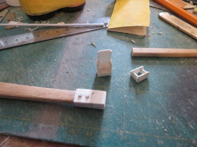

          #87363

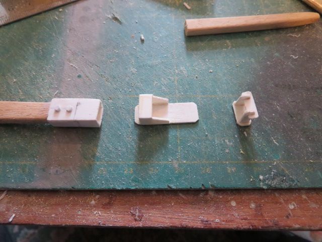

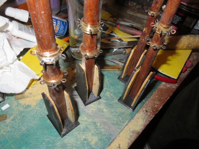

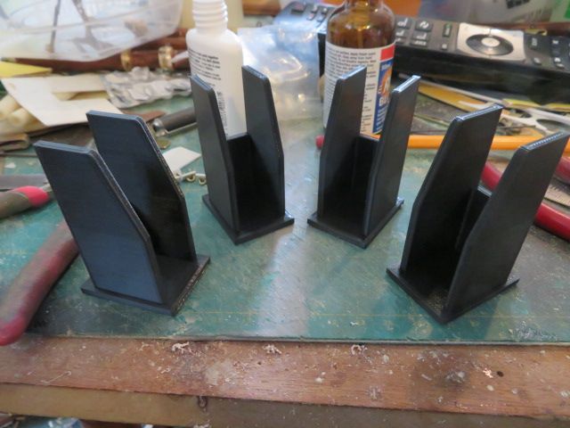

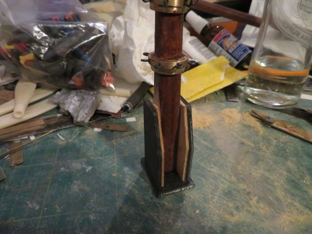

            today, I picked up the tabernacles from a friend who had them 3D printed. he did this for me as my two other sources were unable to get them to me because of personal illness and then the stand by set, because the company he was working for closed due to lockdown.
            these were made as a temporary set to get the model rigged. If the printed ones work for a while on the working boat with the stress that they will be put under I will still have the brass ones when they eventually arrive as a stand by..
            They will be kept on the showcase model as she will come under no stress from sailing.

            #87364

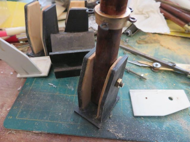

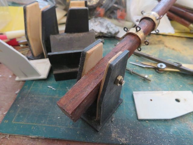

              the tabernacles have been fitted with timber "shims" so that the masts can fit snugly without any twisting of the mast in its seat .
              tomorrow they will be finely sanded and then stained with dark mahogany to match the masts,and then sealed with cellulose sealer. In the mean time I will cut some threaded bar to length to run through the tabernacles and masts so that they pivot on the correct axes.
              once done the holes for the locking pins will be drilled through all as well.
              then it will be just a case of drilling the bases for securing bolts to the decks of the boats.

                    #87396

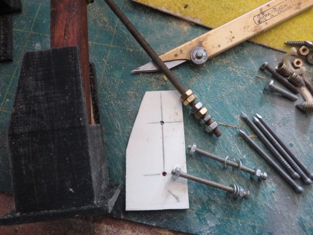

                      The old plastic tabernacle sides were used as templates for size and positioning the holes for the printed tabs.
                      every thing was lined up, drilled from both sides so as to get the holes running true through the timber, and then the securing bolts and the locking pins were put in………
                      that process turned out well.
                      once the hulls have been painted, the tabernacles will be located on the correct positions on the boats, and fixed in place, ready for when I want to rig the two models………but I don't want the masts, sails and rigging to get in the way of any deck clutter.

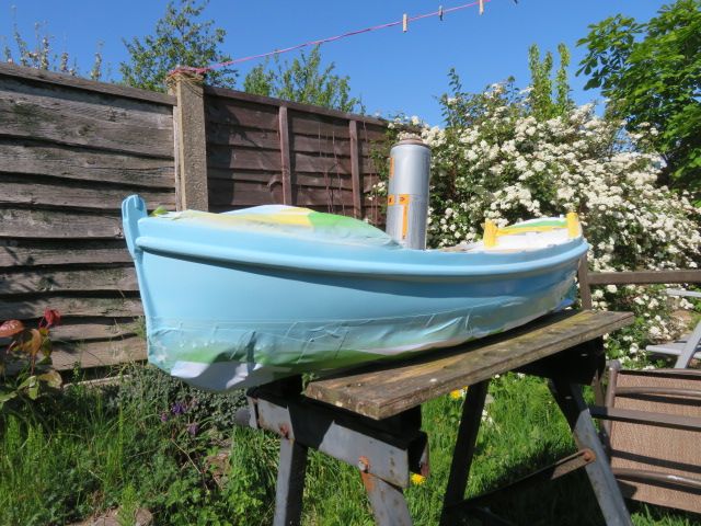

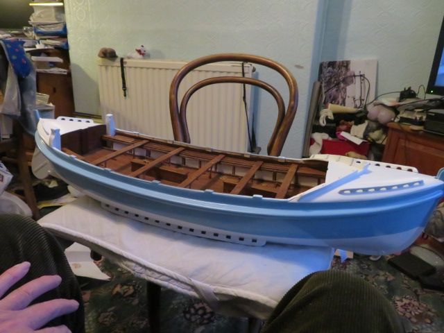

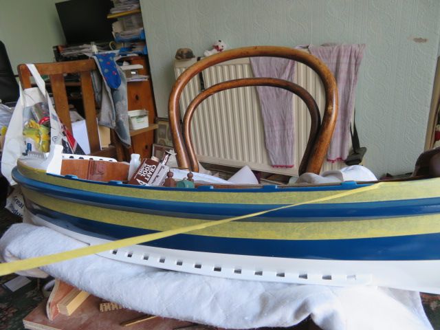

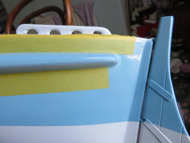

                        thought i'd do a little masking up today,

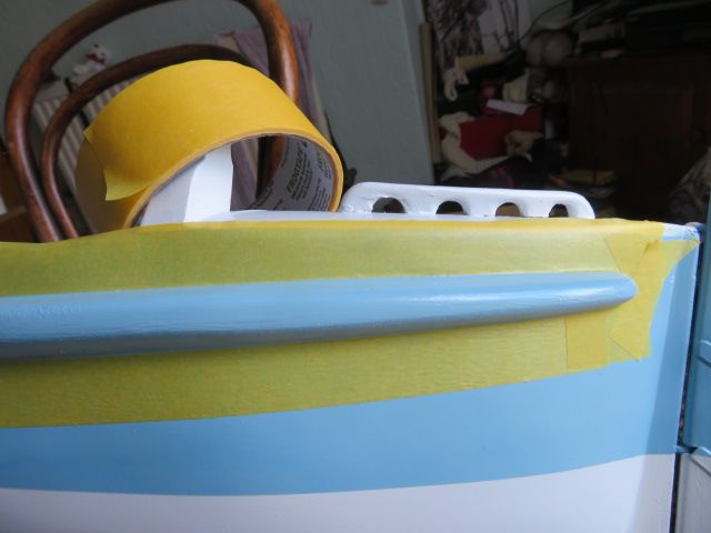

                        usually use "Frog" tape, but have heard so much about Tamiya tape that I bought a small roll……so used that as the lining tape to begin with. seems to have stuck well, so will see what the outcome is in a few hours..
                        gave both boats their respective colours.
                        Ford Bermuda light blue from Halfords for the "Victorian" Blackpool lifeboat, and because I only have one can of Halfords Ford Baliol Blue, I used a base coat of Ford Royal blue, which I had half a can left from a previous paint job. So the colour on the motor lifeboat at the moment is Royal Blue…..slightly [ever so] darker than Baliol blue.
                        next coat on each……….just another hour to go!

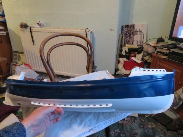

                            img_4600.jpgAshley, you are as child like as me, as I have done that many times in my building days, and ruined it…..this time I resisted, lol.
                            Just the gloss tartan red to paint on to the belting and the inside and tops of the bulwark capping rails to paint now, and this will be masked up and painted in a few days once the blue and white have settled.
                            then onto fitting out with the fittings already made and some coming from my friend Dave Metcalf.
                            must admit, that Tamiya masking tape is the dogs doodahs,,not a single leak under it at all.

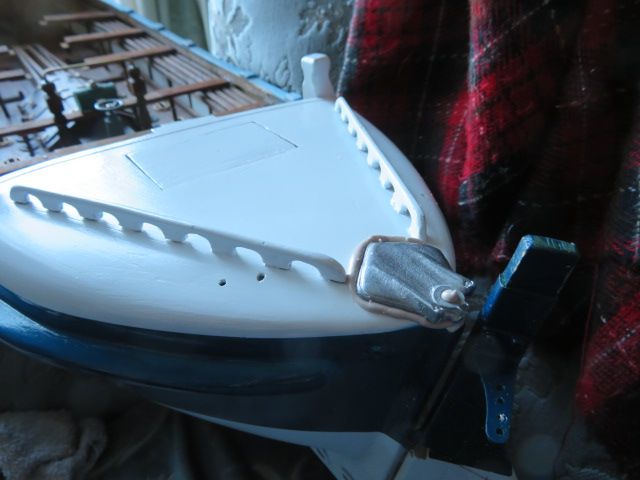

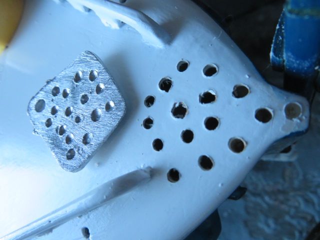

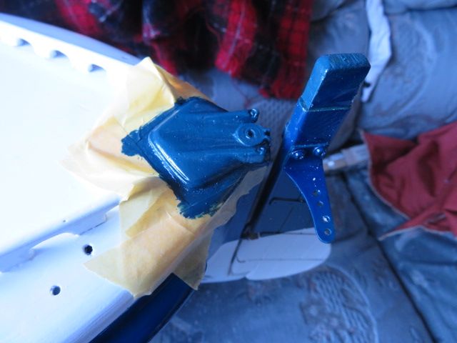

                                    an afternoon of both painting such things as tiller arms and the motor sailor rudder…and the white oars
                                    and then modernising a rudder steering head that was originally made from plasticard and then moulded in white metal for the Liverpool class boat that I designed for Dave Metcalf.
                                    this I marked onto the stern [of course…..why I said that gawd knows] end box, then I decided that to be a good fit I was going to "glue" it on to the hull I was going to use p38 filler..
                                    to aid the adhesion, I drilled partially into the white metal fitting and through the grp end box. I have used the method before, and never had a problem with such a mate as long as you key both surfaces with abrasive paper and put plenty of filler on so that once pressed down into place the filler is squeezed into both sets of holes.
                                    once it started to set and go rubbery I cut off the excess filler that had been squeezed out, and trimmed it up[ neat and tidy.
                                    it was then masked off and painted with Humbrol gloss blue no. 15 which is an almost perfect match for Baliol blue'
                                    Edited By neil howard-pritchard on 02/05/2020 19:51:38

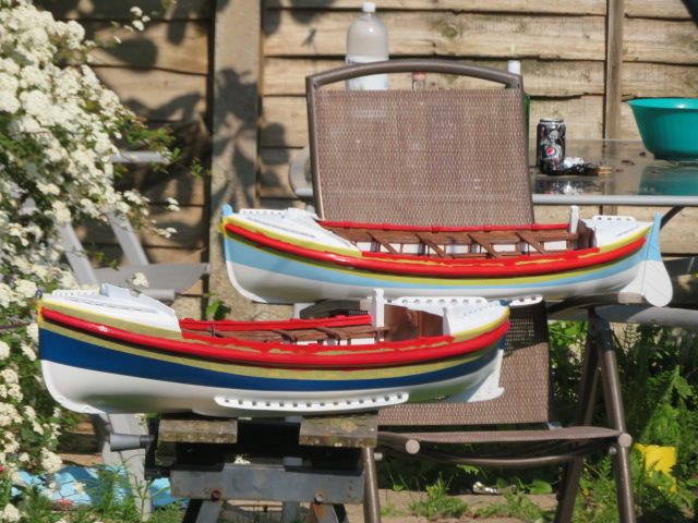

                                        masked up for the bulwark cappings and the belting…..ran out of Tamiya tape, just an inch from the end of the last belt and so had to finish with frog tape.
                                        and then sat them out in the sun to dry…..may be able to get a finishing coat on them before bed time.

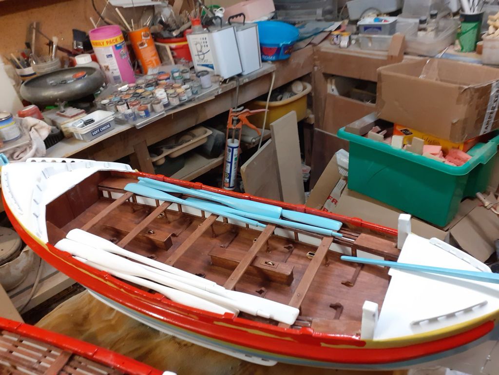

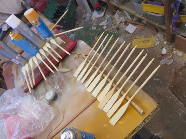

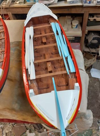

                                                      oars painted and fitted loosely to the thwarts for the sailor lifeboat whilst the red paint dries over night…..still tacky, so will give a second coat tomorrow on both boats.
