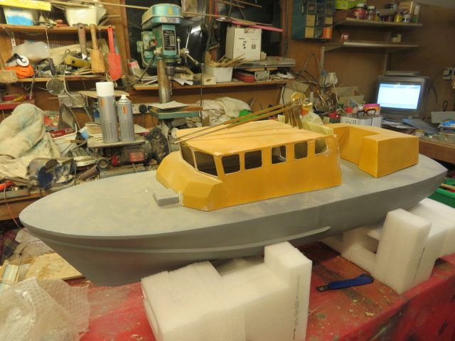

        just the fit between hull and stand cradles Bob…….no rattle and roll…perfect contoured to the hull…………bragging now at my woodworking and tech drawing skills…….mind you I did teach both for over 25 years lol. should be spot on.

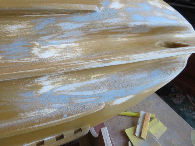

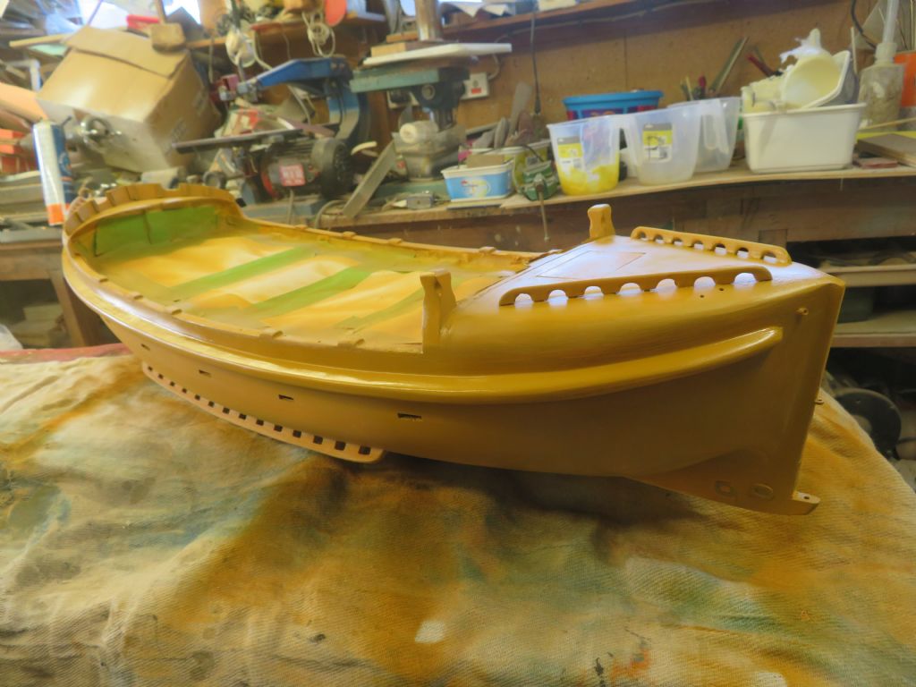

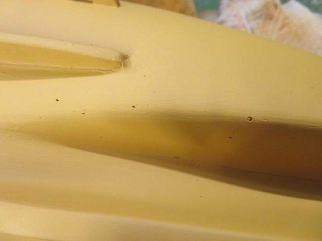

                SPENT a good long time this afternoon [ about 3 hours] on just one boat sanding each section in turn to flatten and get rid of all excess filler contouring into the lines and then using two more finer grades to get rid of the scratches into the gelcoat so that the filler primer has a chance to eliminate all defects……it worked mostly…
                img_4461.jpg will need another coat of filler primer before I can flatten off again with a finer grade paper, before a final coat , flatten off and then the white primer to take the white gloss for the below waterline and end box tops.

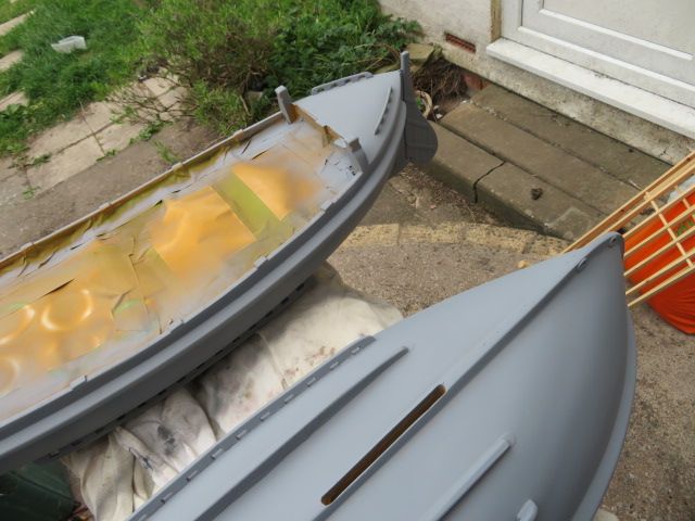

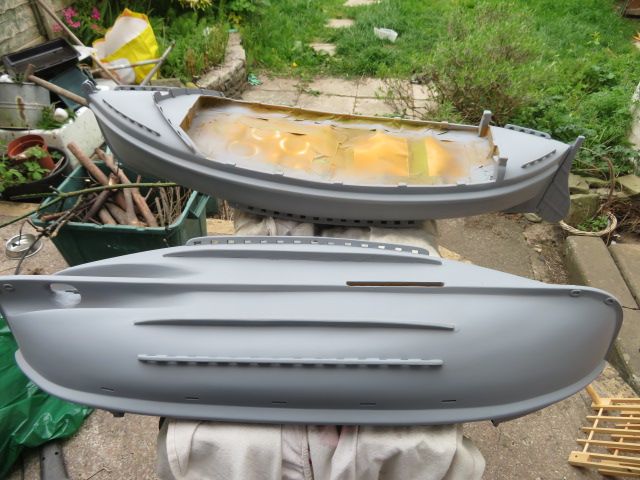

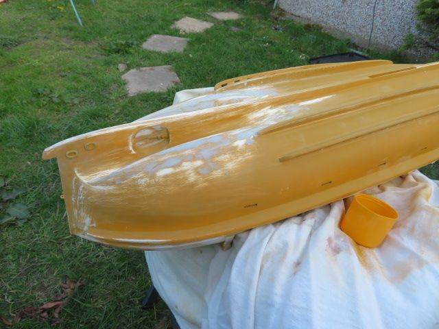

                      I have just sprayed the bum now with filler spray……looking a lot better now all the blow holes have been filled………but still needs more work to get a glass like finish that my mate Stavros will be proud of. lol.

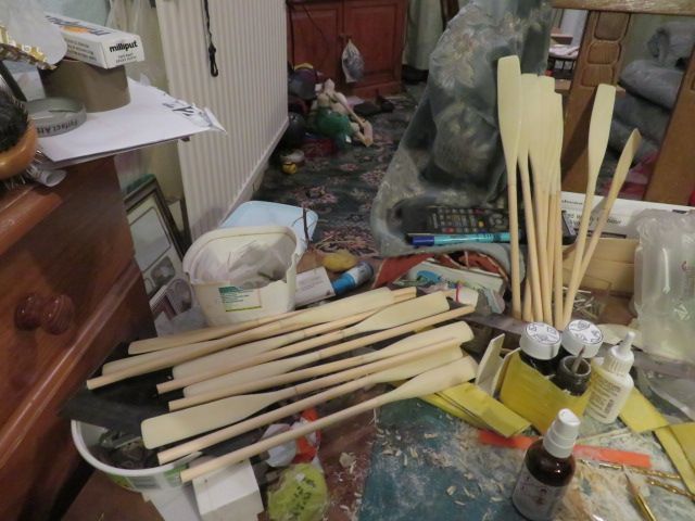

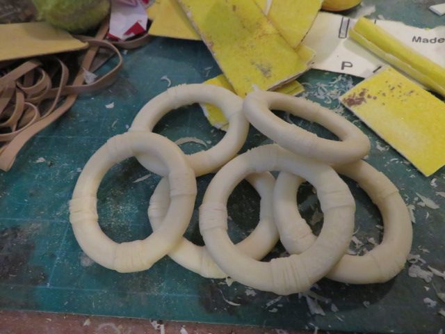

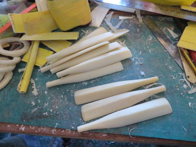

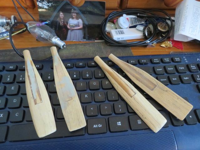

                        for those two boats I made some masters, for both the life rings carried by them, and oar blades to make moulds of.
                        these moulds came in earlier for producing more of the same for these two boats.

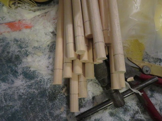

                        6 x life rings and 20 x oar blades, which will be extended to full length oars once I get hold of some 9mm dowel. hopefully o might be able to get some when I go food shopping tomorrow.
                        but here are the rings, and pictures of the wooden masters and reproduced oar blades.

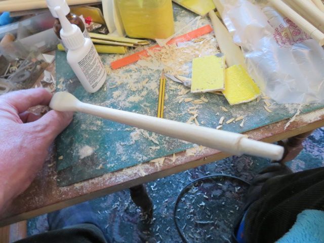

                            the oars have been cut to a standard 12" length, and then marked, cut parred and sanded to make the hand grips and smooth the joint between blade and dowel, and getting ready for painting.

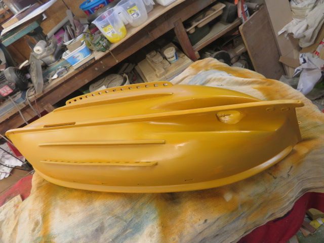

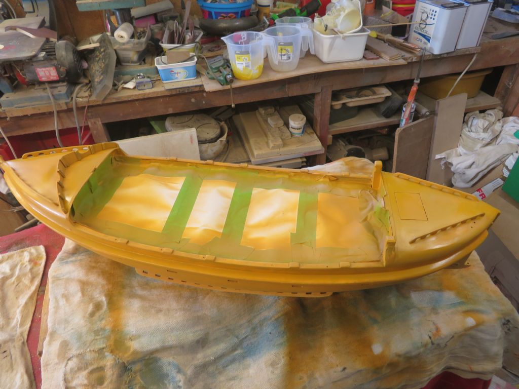

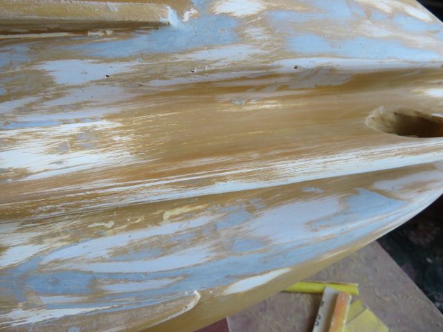

                            then I attacked the hull with more filler primer, before leaving it to cure. there were still a very few blow holes in the filler, and so I reverted to an old trick that Frank Hinchliffe told me many years ago.
                            he filled the last few with moulders plasticine. not the same as children's stuff that never fully sets hard. Moulding plasticine sets rock hard, and as such I duck some out and filled the last few holes after heating the piece up to be able to become pliable. It also has the property of being paint friendly.
                            now filled, I gave another spray of filler primer, before hopefully I can start wet and drying the areas that have stood out under the primer.
                            That should take me a few hours in the garden under the sun……….and hopefully it will be sunny and not too windy.

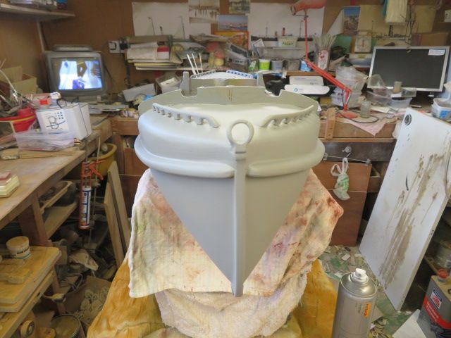

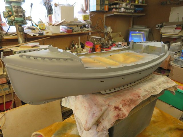

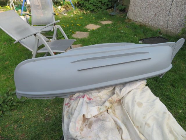

                                                I ran out of patience totally last night, with just staring at the walls or TV, doing nothing.
                                                Watching a spider spin its web on your boat is onething..stiring at the walls hoping the paint will change colour is close to insanity, and so hobbled onto another chair, evacuated the spider to the safety of a pot plant  and then sanded the first layer of grey primer with some 800 and then 1200 grade wet and dry carborundum paper, used dry………it gave a very smooth silky finish.
                                                this afternoon, after all that work last night rubbing down with very fine grade paper, I couldn't let it go to waste and so added the final coat of grey primer to both hulls, before I proceed tomorrow with the first of numerous coats [over many days…] of the white top coat for the bottom of the hulls and the end boxes inc. the towing bollards…………and they feel smooth as silk. hopefully that will show in the finish.

                                                  That`s the way, Neil……Get summut done!
                                                  Occupy your mind with good thoughts and ideas
                                                  I don`t go for spotless paint finishes…..Thank goodness…….Too stressful

                                                    That's the way to do it! Nothing stops a boater from modelling!
                                                    Great finish, always looks good in grey (whatever it is)
                                                    When I made the Farnham, the superstructure was sprayed undercoat matt white and looked just fantastic, and then I sprayed the gloss on…
