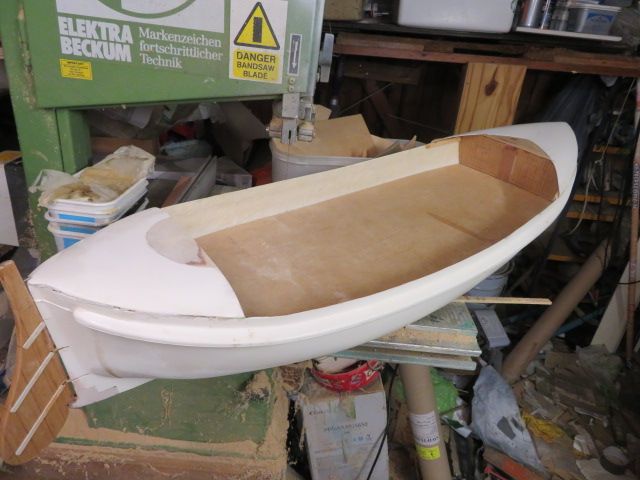

            and the two began when I made a call to my friend Dave Metcalf who supplied me with two hulls and end boxes for a suitable boat to fit the models.

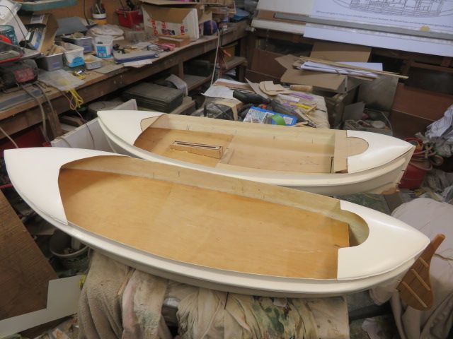

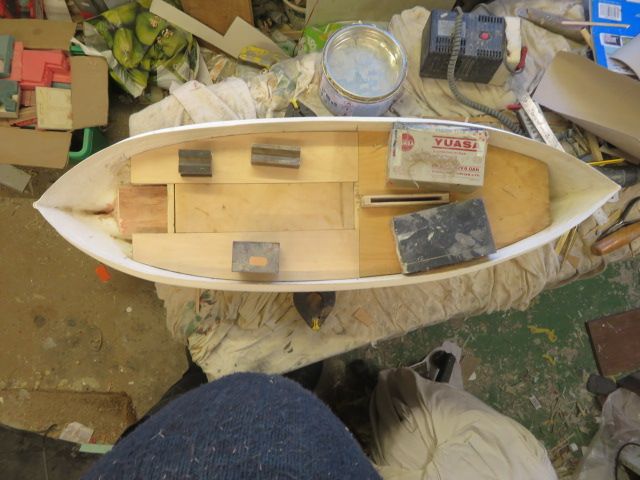

            first task was to mark and cut away the "deadwood" recess for the propeller on the motor lifeboat
            and then to fill in the tunnels with polyester filler for the sailing lifeboat, and then to drill for the prop shaft, before beginning a straight forward build of deck supports, and decking.

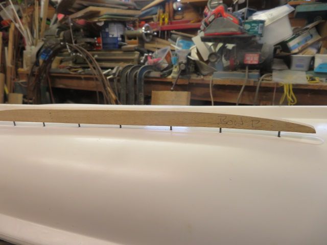

                then down to pinning and fitting the bilge skeg keels.

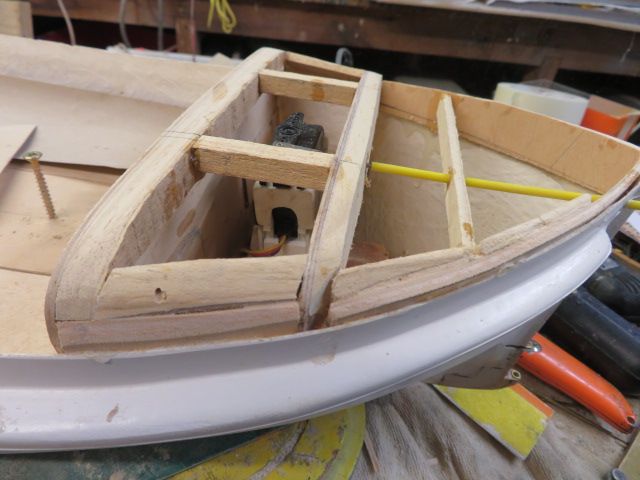

                  itting out the supports for the end boxes are shown in the last picture and the next one
                  #86347

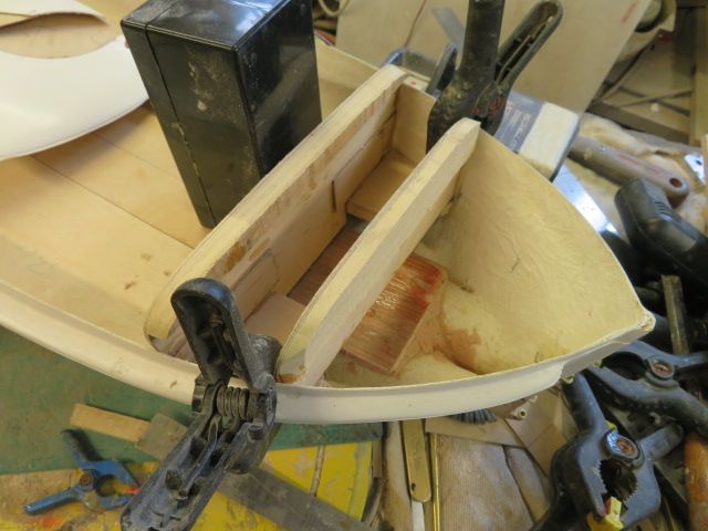

                    then comes fitting of the end boxes and sealing them up to make air tight flotation aids to the lifeboats.

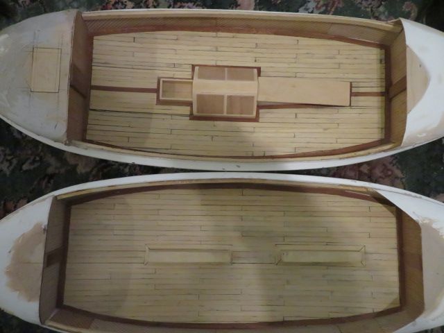

                    then it was a case of making up the deck fittings for the tow lifeboats…….the engine casing and cover plus the drop keel housing box for the motor sailor, and the two dummy drop keel boxes for the sailing boast.
                    plus at this stage i planked and caulked the decks [using aliphatic resin quick grab glue coloured with black ink to represent the caulking……….the messy job is easily sanded off later

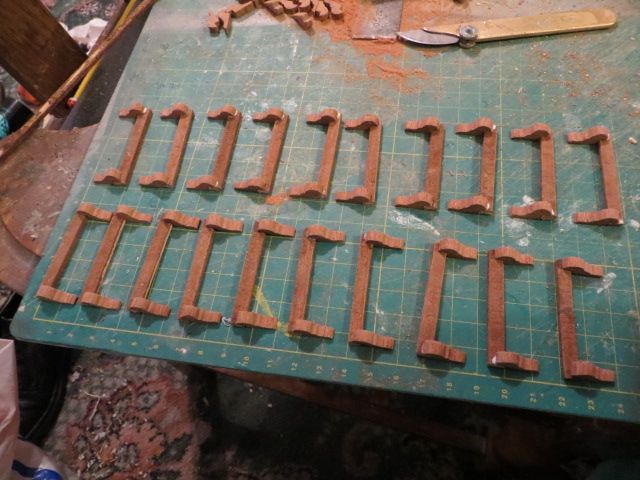

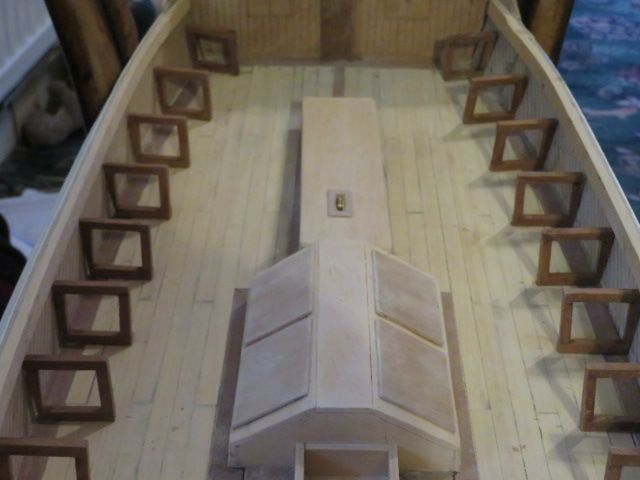

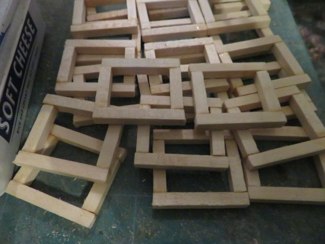

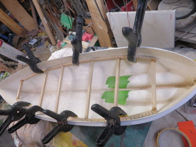

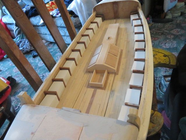

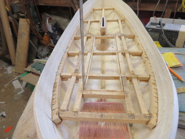

                      next job was to make the frames for the side benches. these were made from 5mm square section obeche and glued together using aliphatic resin…….only 88 pieces to cut accurately…….I make a jig to cut them with a fine blade pad saw.
                      stained with mahogany colron water based wood colouring and fitted
                      then the flotation boxes were made from 1.0 plasticard, and being hollow add just a little more aid to keeping the boat afloat in event of an accident.  the boxes for the static sailing boat was made from solid obeche……….then both sets were sprayed white.

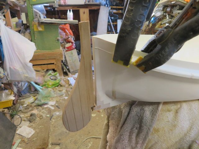

                      #86349
                        and finally for tonight, the rudders were made from 100 thick oak planks, and cut and fitted to the receptive holes in the rudder skegs

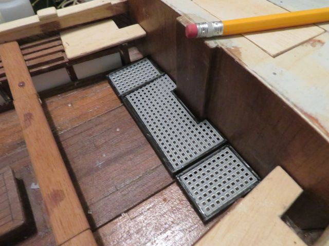

                                  the helmsmans gratings were added from plasticard and cro
                                  sstitch matting.

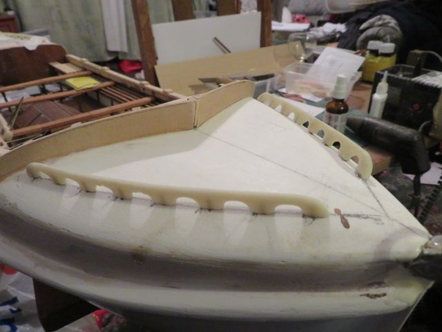

                                  then the end box grab rails added from resin castings I made, using original plasticard masters I made for similar models 8 years ago.

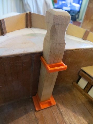

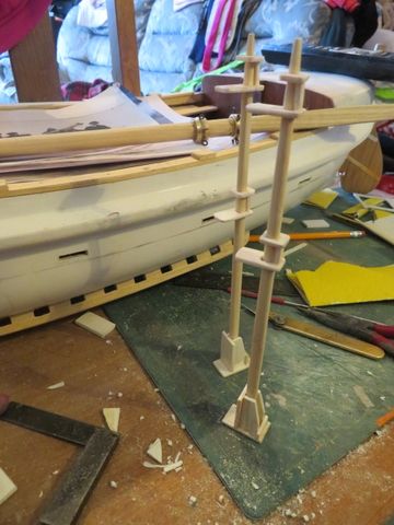

                                  before making the signalling lamp masts and tabernacles using plasticard and chop sticks from the local Chinese restaurant.

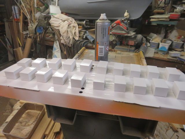

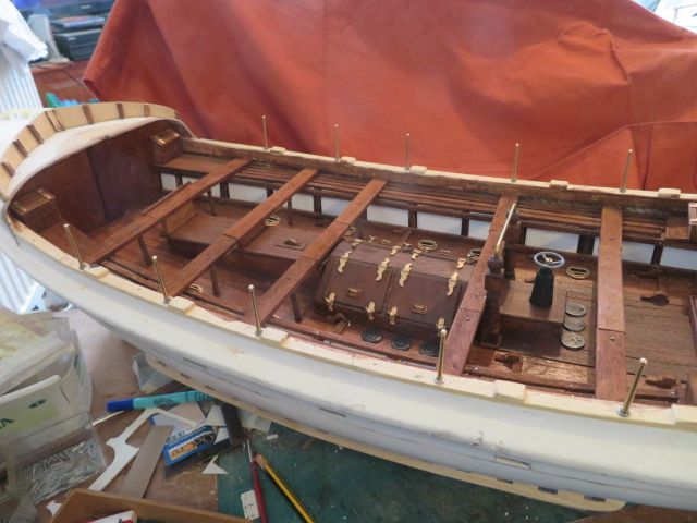

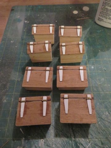

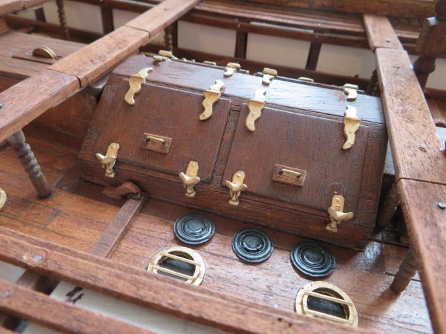

                                    next was to paint and detail the various tool and chart/compass boxes adorning the boats.
                                    next came the kick boards for the oarsmen to strain their feet against. so were made from a picture framing moulding cut into thin slices and some 5 x 3mm mahogany strips cut on my band saw.
                                    the veering down and towing bollards came next.

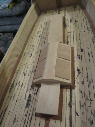

                                    and lastly some detailing of the engine cover
                                    and deck adornments including drain tube capping's, fuel caps and bilge pump capping's……..plus temporary fitting of the brass stanchions to the motor sailor……….the pulling /sailing boat will have white metal ones fitted when I can find them in my workshop………..but there's plenty of time for that the way this crisis is going. .

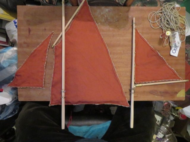

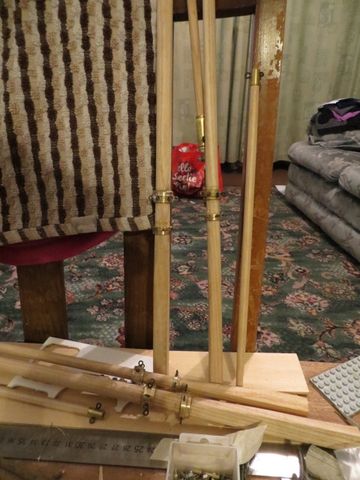

                                      finally, the masts were made for the two boats……….a fore mast with dipping lug sail and a mizzen mast with styay sail on a boom.
                                      however it was found later after some research that the pulling and sailing boat only had a fore mast with dipping lug……however not that the extra sail. mast and boom will go to waste…my friend mick French in Cornwall has claimed the mizzen sail, mast boom and brass tabernacle for his Liverpool class boat.
                                      all masts, spars and booms were hand shaped from square section Ash……….a lovely springy straight grained very strong timber.………it was formed into a round by my lovely little palm plane given to me some years ago just before he died from pancreatic cancer……….I love my hand tools, but treasure this one.
                                      all fittings for the masts were turned on my myford lathe.

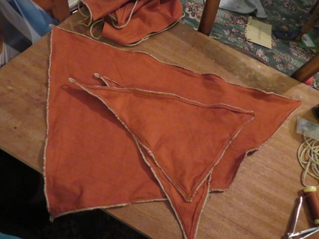

                                      and then the sails were cut and sown from calico cotton by my ex wife, and I finished them off by sowing on the rope binding to all the sails for added strength,

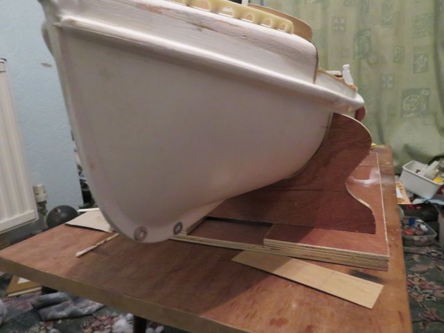

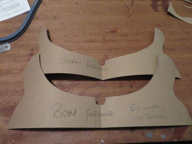

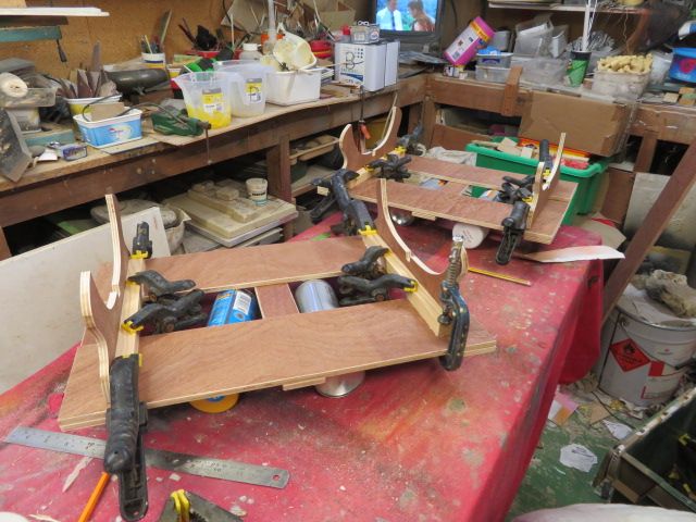

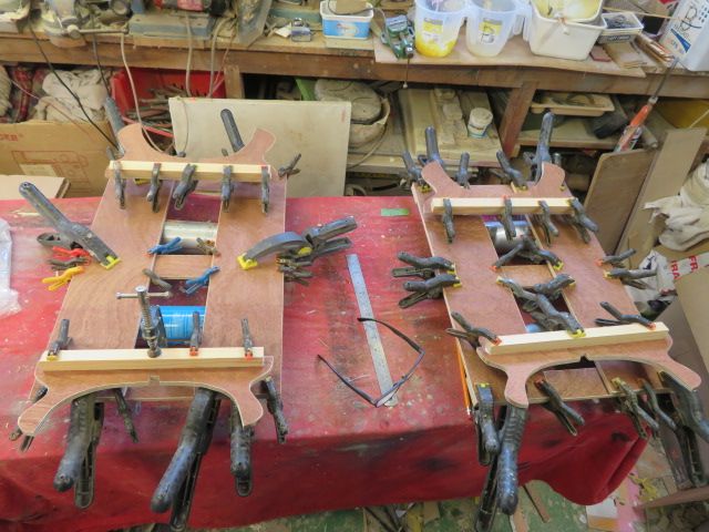

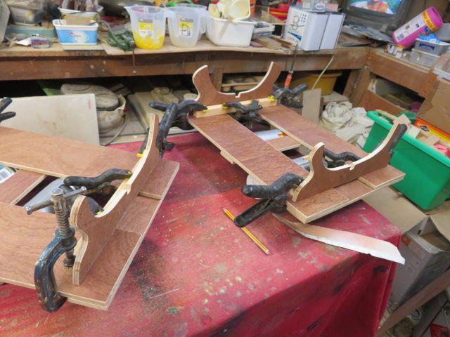

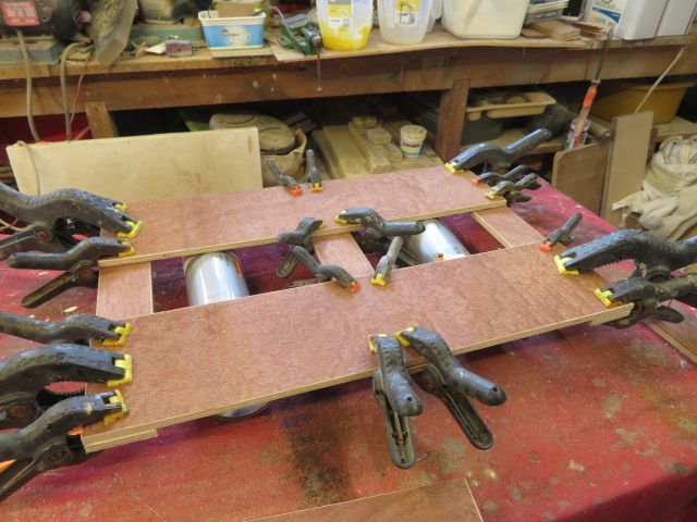

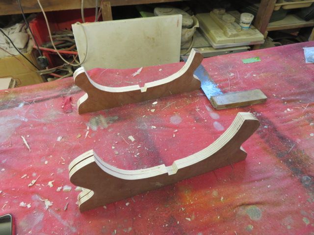

                                                thought it was about time I made a couple of building stands for the boats now that I am getting closer to spraying.
                                                I don't build my stands as works of art or anything fancy…………just work horses.
                                                I first cut out two card templates using French curves to get the templates,
                                                before transferring to 10mm ply.
                                                I then cut out the strips of ply for the bases
                                                and the cross members, before gluing them all together using clamps to hold together
                                                Edited By neil howard-pritchard on 12/04/2020 22:05:05

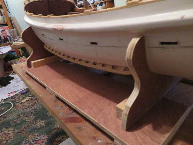

                                                      well, if I do say so myself…….the boats fit to the stands perfectly.
