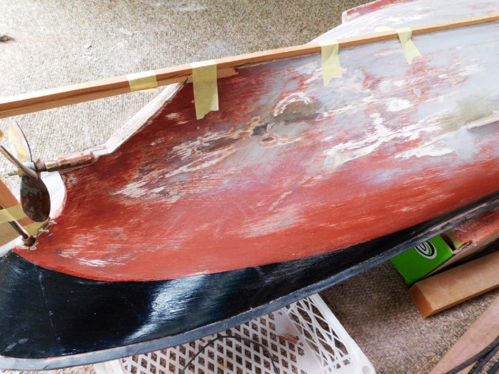

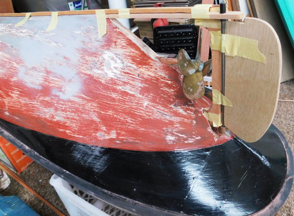

              shove it 22.jpgshove it 21.jpgshove it 20.jpgshove it 19.jpgHi Ashley
              Dig out the rot and Plastic bond by the bucket loads !!!!
              Lots and lots of sanding with 80 grit sand paper.
              Knock out a lot of lumps and bumps on the hull so far.
              The lower section under the drive line was rotted, so a big cut back to solid wood.
              Winging the rudder design and thinking of stainless strips from car windscreen wipers !!!

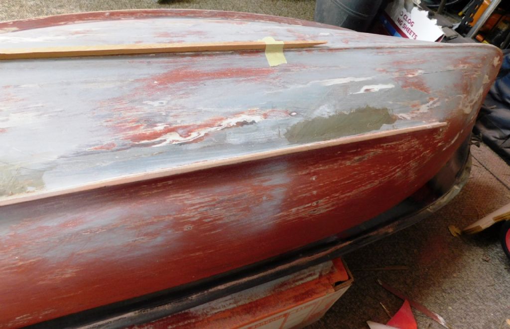

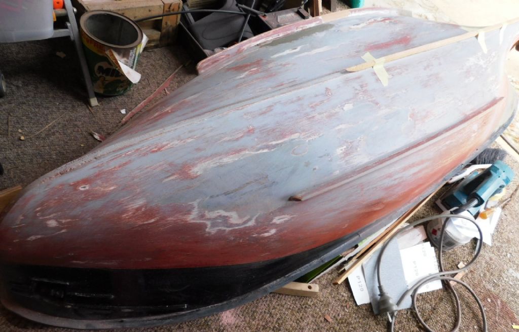

                  shove it 29.jpgshove it 28.jpgDay 3 on the hull, more digging out rot and filling !!!
                  Starting to get some good wood back in the boat.
                  Still finding little holes and lumps.
                  #103899
                    stove it 34.jpgshove it 33.jpgshove it 32.jpgshove it 31.jpgHi All
                    Starting to get the stern into shape !

                      shove it 45.jpgshove it 44.jpgshove it 43.jpgshove it 42.jpgshove it 41.jpgshove it 38.jpgshove it 37.jpgshove it 36.jpgHI Lads
                      With the summer weather, I have fibreglass the hull and added three coats of red oxide paint.
                      Still working in the rudder area.
