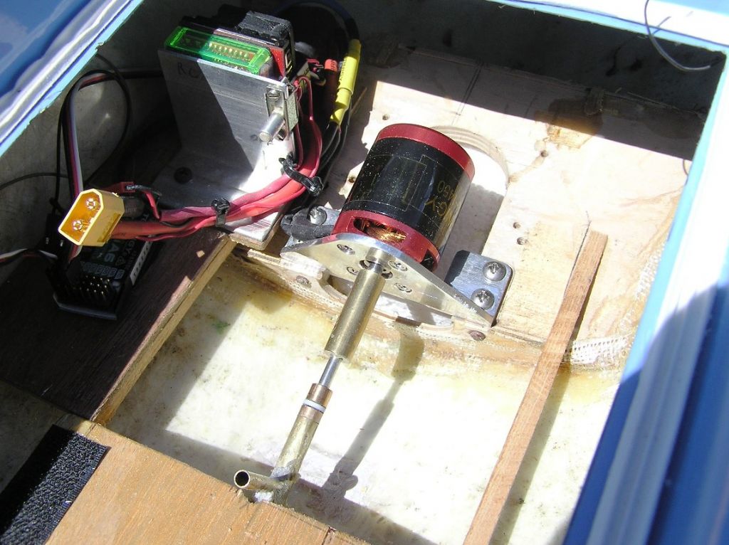

      Whilst this is my mate's boat and he is recovering from an operation.
      I am fixing up his boat for him.
      He is the club go to guy for machining and welding, also the keeper of the plans!!!
      The boat started as IC and when he received the boat it was in poor condition.
      First motor was a 3639-750kv on 3S.
      Next was a 3639-1100kv on 3S.

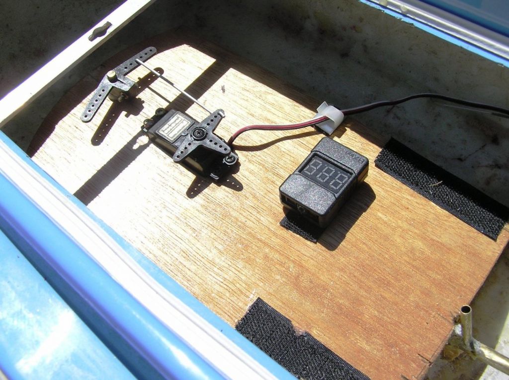

      The 3S battery dropped a few cells, so, it was replaced by a 4S 5800mah 40C.
      With all this upgrade the boat still handle all weather at a very fast pace.
      So, this step was another upgrade in motor to a 3648-1450kv.

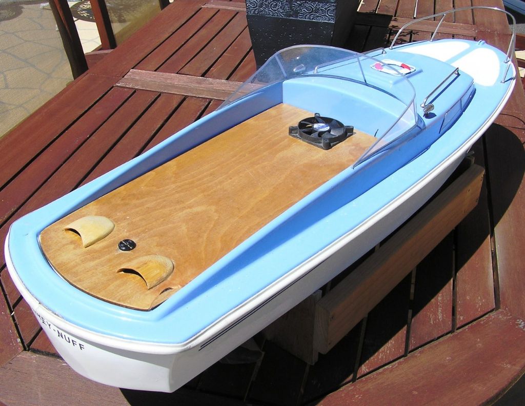

      This the boat handle no problems, but, with no cooling the motor was getting to HOT!!
      As it had no air flow in the boat, I installed a 12 volt old computer fan and two air scoops at the rear.
      Ran the boat at the last club meet and drove it like it was stolen !!!
      The motor temperature was about a third after a very hard 10 minute run.

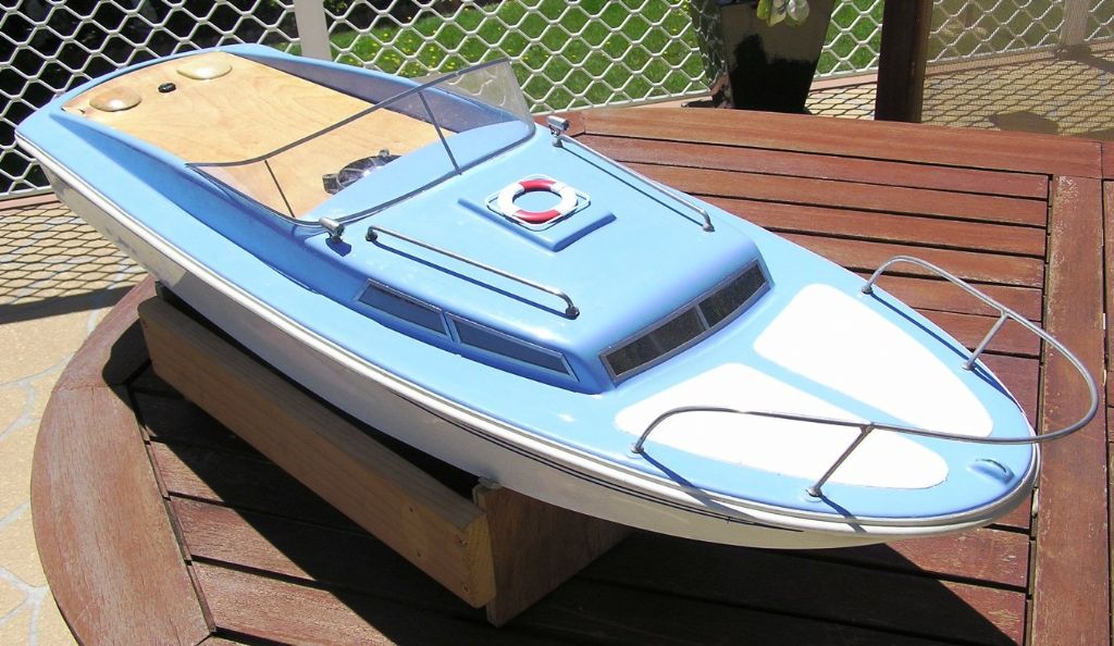

                        Hi. I know this is an old thread but I wondered what rubbing strip you've used on this Spearfish?
                        I had a Spearfish back in the early 80s, powered by a good old Merco 61…. haha.
                        Just got hold of another now and converting it to brushless. I'm planning on repainting the superstructure in a very pale blue, as in the later full-size ones and have been trying to find a white rubbing strip to go around the edge, as in the one Harry has used but can only find spongy stuff….
                        #100465
                          Kev. Car trim suppliers are a good source of this sort of thing. Woolies is a name I remember, but an ebay search will probably find what you want.
                          You can use plastic tubing and split it lengthways but its a tricky job.
