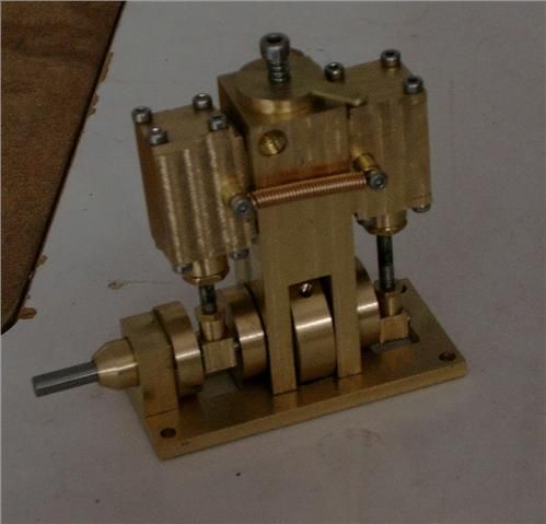

                                      Hi Carl. This is the twin oscillator that I have built for my Clyde Puffer:
                                      /wp-content/uploads/sites/5/images/member_albums/2648/engine-compressed.jpg
                                      It is my own design based on information gleaned from Tubal Cain, Stan Bray and photographs of commercial designs.
                                      It has a 10 mm bore and a 12 mm stroke. I do have a set of drawings but I could not guarantee them since I tend to change things as I progress and I don’t always record the changes. You could try this site http://www.john-tom.com/html/ElmersEngines.html. Again I have used info from here in designing my engines.
                                      You obviously need a lathe and preferably a small milling machine. I find the engine is the easiest bit. It is the boiler that presents the problems for me. It is always a challenge trying to produce enough heat to braze the various parts of the boiler together. I am getting better at it, but it has been fraught with difficulties. This is my latest boiler:

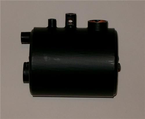

                                      /wp-content/uploads/sites/5/images/member_albums/2648/boiler-compressed.jpg
                                      It is 75 mm diam and 90 mm long, and is based on a design from Model Boats.
