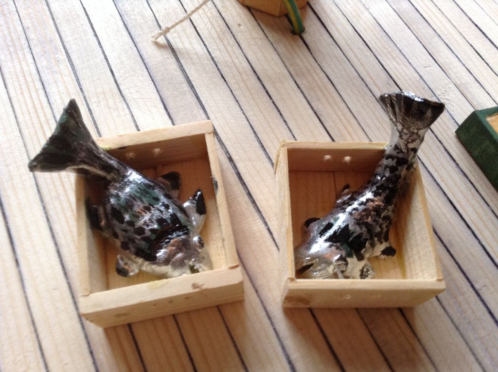

      image.jpegAnd some rather lifeless fish!

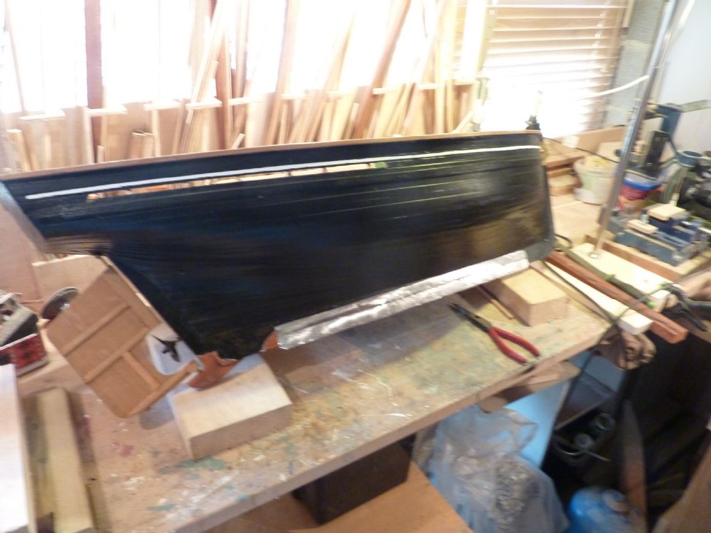

        Just wasted my time painting the white trim line along the hull, but having used cheap masking tape, I was left with a blotchy finish when I removed it! Now repainted black and awaiting purchase of a better quality masking tape.

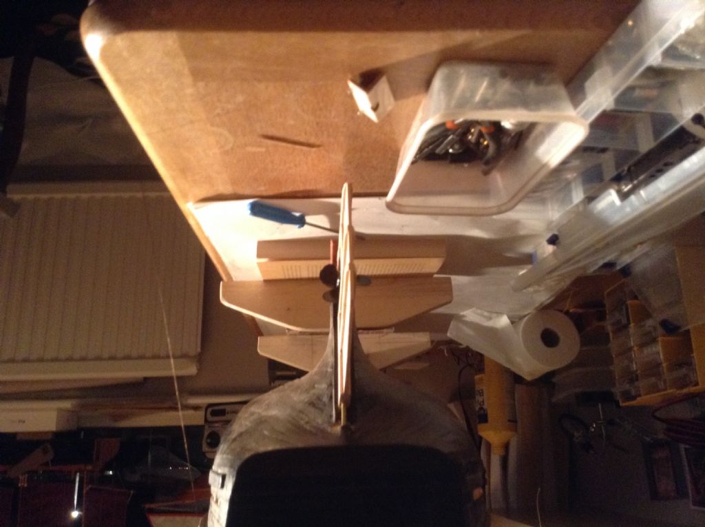

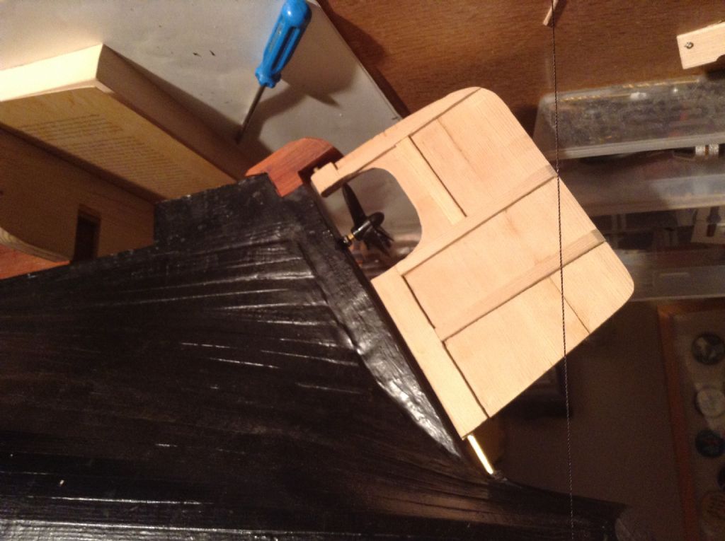

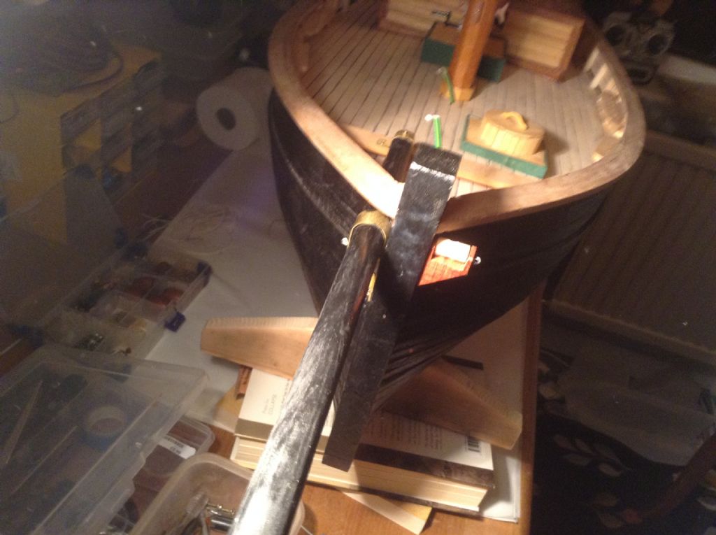

            Had to drill out the old rudder post tube, and fit a new one taking much more care to line it up correctly. I have tried it out with the old rudder – see pictures. It is too heavy though, so I'll be making a slightly smaller and much lighter one soon.

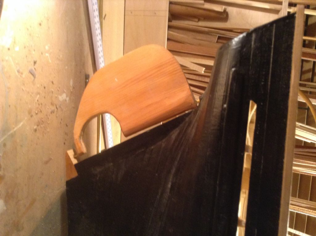

              The new slimline rudder, all working well.

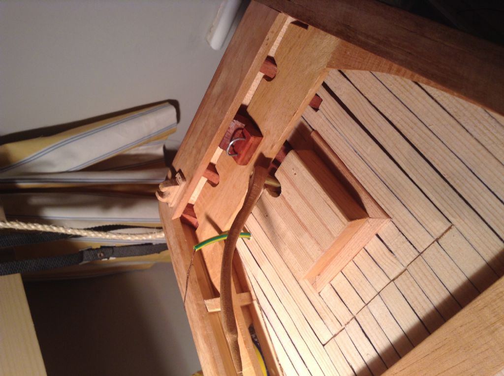

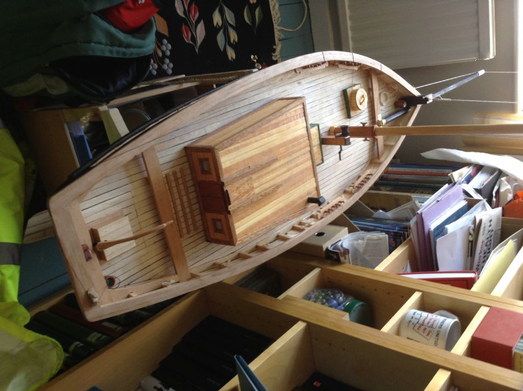

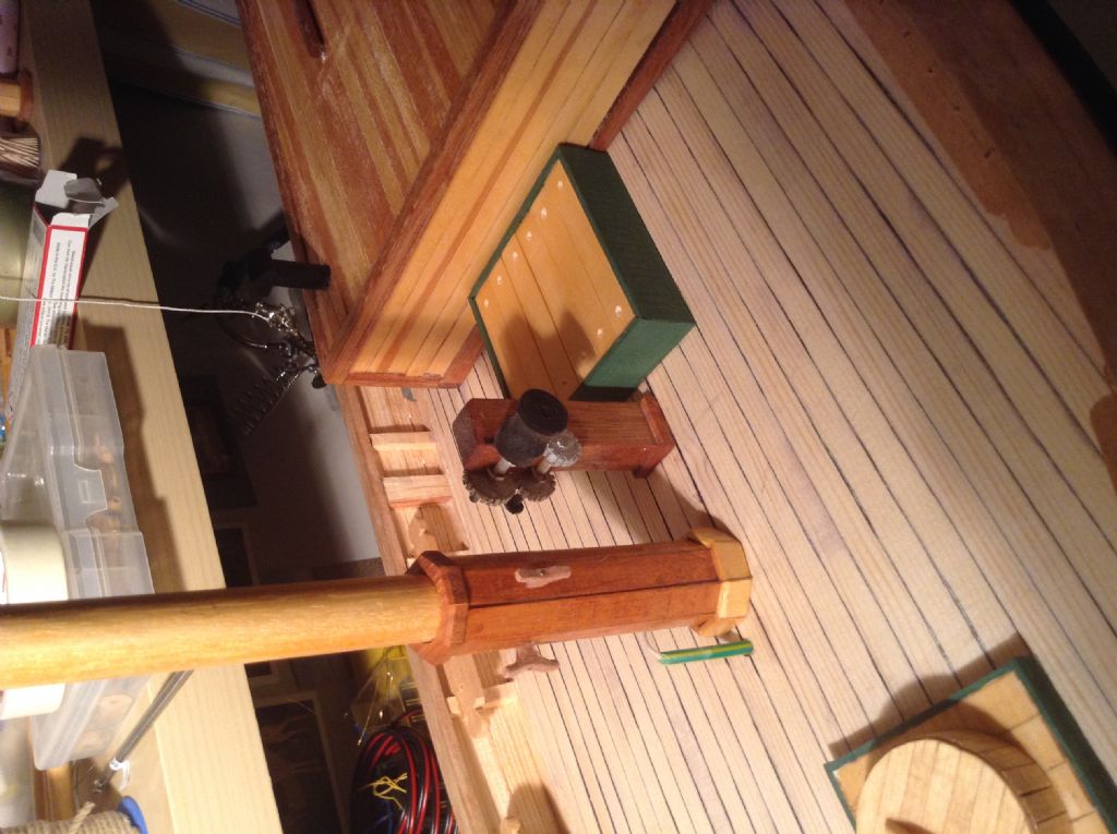

                #64016
                Brian Muir
                  @brianmuir84327

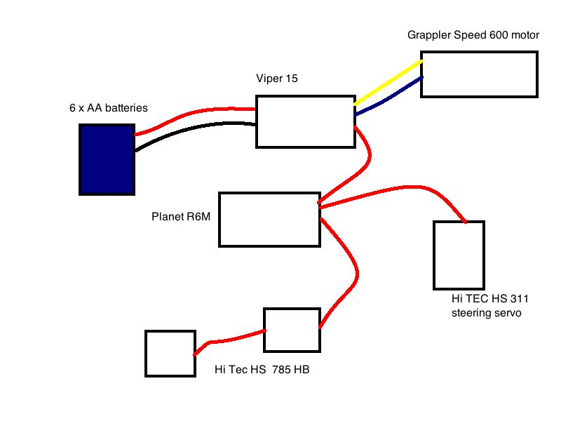

                  Just some more details on the deck, then varnishing. BUT the battery pack 8xAA is overheating, I assume that the 600 motor is trying to draw too much current? Is the solution a bigger battery pack?

                      When you say that the battery pack is overheating is this with the model in the water and speed set to full ahead ? If this overheating is occurring with the boat out of the water I would suspect propshaft misalignment or a seized bearing. Under no load the drain on the battery shouldn't be too high. What type of battery are you using and what voltage and Ah ? – is it a battery pack or a number of individual cells inserted in a battery holder ? Do you have a meter to measure the current ?
                      #64033
                      Brian Muir
                        @brianmuir84327
                        This was out of the water, an 8 AA battery pack (not 6 pack on the diagram), I was trying it out for about 20 min and ar the end of this period as I lifted out the batter pack it was hot and one battery was leaking. I had run it for short periods at full ahead, I noticed that if I put it full astern the circuit cut out, then resumed after a minute. There is a UJ between the motor and the shaft and it is pretty well lined up.mi don't have a meter to measure current.
                        Edited By Brian Muir on 25/03/2016 15:50:47
                        Edited By Brian Muir on 25/03/2016 15:52:39
                        #64034
                        shipwright
                          @shipwright
                          Looking back to a January posting of yours it looks like you are using 6 x Varta AA cells in a plastic battery holder. Are these cells NiMH rechargeable or alkaline non-rechargeable cells ? For powering the ESC/Motor I would use NiMH rechargeable cells and only buy it as a manufactured pack where the cells are connected via spot welded metal strips. Alkaline cells in a plastic battery holder are fine for powering the Rx and servo (I use that) – BUT Alkaline non-rechargeable cells cannot meet the current demanded by a Graupner Speed 600. Obviously a leaking cell is no good and must be replaced before it rots the electrical connections – and I would spend a bit of time cleaning away any cell discharge that might have leaked.
                          #64036
                          Dodgy Geezer 1
                            @dodgygeezer1
                            Note that different batteries can put out different maximum currents. Some can only manage very small currents. That motor can probably draw 20-30 amps max, though I would defer to DM for an accurate figure. But at the least I would think your battery pack ought to have a max discharge rating of some 20A. What batteries are you using?
                            #64037
                            Brian Muir
                              @brianmuir84327
                              Another correction 10 AA standard alkali batteries in the pack. I am going to look at the battery packs you suggest. The motor takes 12amp so what size battery pack would you suggest?
                              Edited By Brian Muir on 25/03/2016 17:45:09
                              Edited By Brian Muir on 25/03/2016 17:50:17
                              Edited By Brian Muir on 25/03/2016 18:08:46
                              #64039
                              shipwright
                                @shipwright
                                Have a look at Component Shop :
                                It even gives how long the battery will function at C amps discharge, 2xC amps discharge etc. In this example of a battery pack of 7.2 volts with capacity of 4.3 Ah, 1 x C = 4.3 Amps, 2 x C = 8.6 Amps etc. If you look at the graph it says that discharge at 2 x C would give you a sailing duration of approx. 20 minutes assuming that the battery is fully charged at the start of the sail and the throttle is kept full ahead (or thereabouts) for all of those 20 minutes. In reality you will be sailing the boat with occasional bursts of speed so the duration is likely to be significantly more than 20 minutes. This calculation has assumed that the motor consumes 8.6 Amps when going flat out. Hope that helps. Of course there are several battery packs on sale on the Component Shop website and which one you choose is down to cost, weight, size, Ah and voltage of the battery – often space inside a boat is limited. Hope this information is of some assistance.
                                #64045
                                Dodgy Geezer 1
                                  @dodgygeezer1
                                  Posted by Brian Muir on 25/03/2016 17:41:34:
                                  I would have thought that taking 3-4 Amps from standard AA alkaline cells would be not that far off shorting them. The internal resistance is probably too high to get more out – which brings me onto another issue: how did the plastic battery case stand up to it? The contacts would be getting hot and melting into the plastic! That's probably what was happening to you earlier…
                                  What voltage do you need? Pretty much any of the Component Shop power packs will do – just work out what length of run you want and pick a pack accordingly.
                                  There is no substitute for a meter. You can buy a decent one for £20-£30, or this little Watt meter will tell you everything you need to know… ccAAOSw42JWC6oJ”>http://www.ebay.co.uk/itm/100A-60V-DC-RC-Helicopter-Airplane-Battery-Power-Analyzer-Watt-Meter-Balancer-P5-/171953594396?hash=item28093ba01c:gccAAOSw42JWC6oJ
                                  #64322
                                  Brian Muir
                                    @brianmuir84327
                                    I have bought and fitted an NiMH battery pack and it is running smoothly and keeping cool! Fingers crossed that's that. I am now looking for 5kg of lead for the keel, so I can do some pond trials.

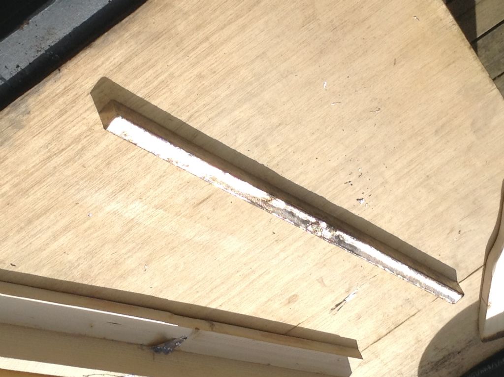

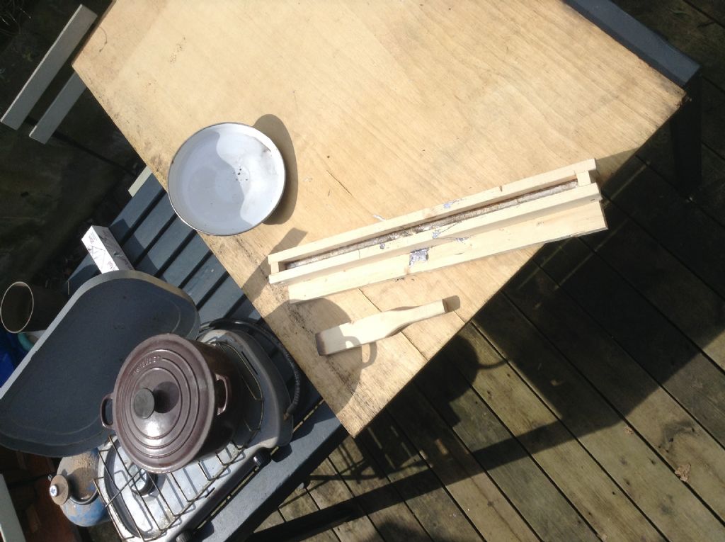

                                      image.jpegI got 7kg of scrap lead for £10 at my local scrap yard, now have to work out how to melt it all down, I used a camping gaz stove and a cast iron pot for a smaller amount last time. This time I'll need a bigger mould, I'm going to use sand, but I need clean dry sand, will builders sharp sand do?

                                        Brian
                                        Well done with the model build……Nice job too
                                        Now beware!
                                        You sound inexperienced in lead casting?
                                        Use a wooden mould……..From about 1/2" wood……….Bone dry!
                                        Plaster is OK but it must be bone dry…….Or else, you may get an explosion!
                                        Make the casting in two layers,,,,,,,To reduce the amount of lead involved and bolt the two halves together
                                        Cast the lead in the open air on a suitable table
                                        Melt enough lead in a strong old pan on a picnic stove………Use big metal G clamps as pan handles
                                        Use thick oven gloves…..Googles are essential
                                        Use an old spoon, to scrape away the muck and slag off the top of the molten lead into a further old pan
                                        It may be prudent to have a bowl of cold water handy, near by……Just in case?
                                        Check on the route from the stove to the pouring position for a clear run
                                        When the lead is shiny and runny
                                        Take the pan of molten lead and pour it in the mould……To the desired height
                                        Stand back and wait for the lead to cool down
                                        Turn the mould over and tip it out…….And make another
                                        Keep the children and pets out of the way
                                        Show me the mould before you cast, please……..For my comments
                                        There is another write up, for casting a shaped yacht weight……I`ll try and find it
                                        All the best

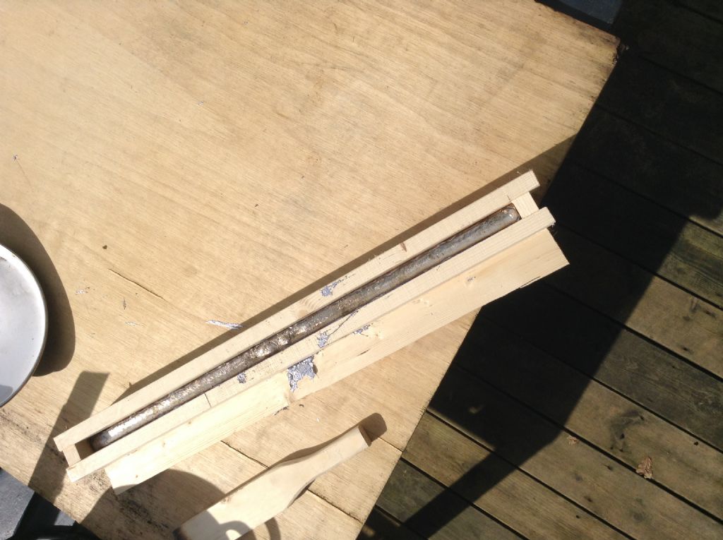

                                              After a tense but rewarding morning, two lead oblongs that will hopefully make the keel

                                                Well done, Brian
                                                How much weight have you allowed for?…………I had 9lb in mine and she sailed well

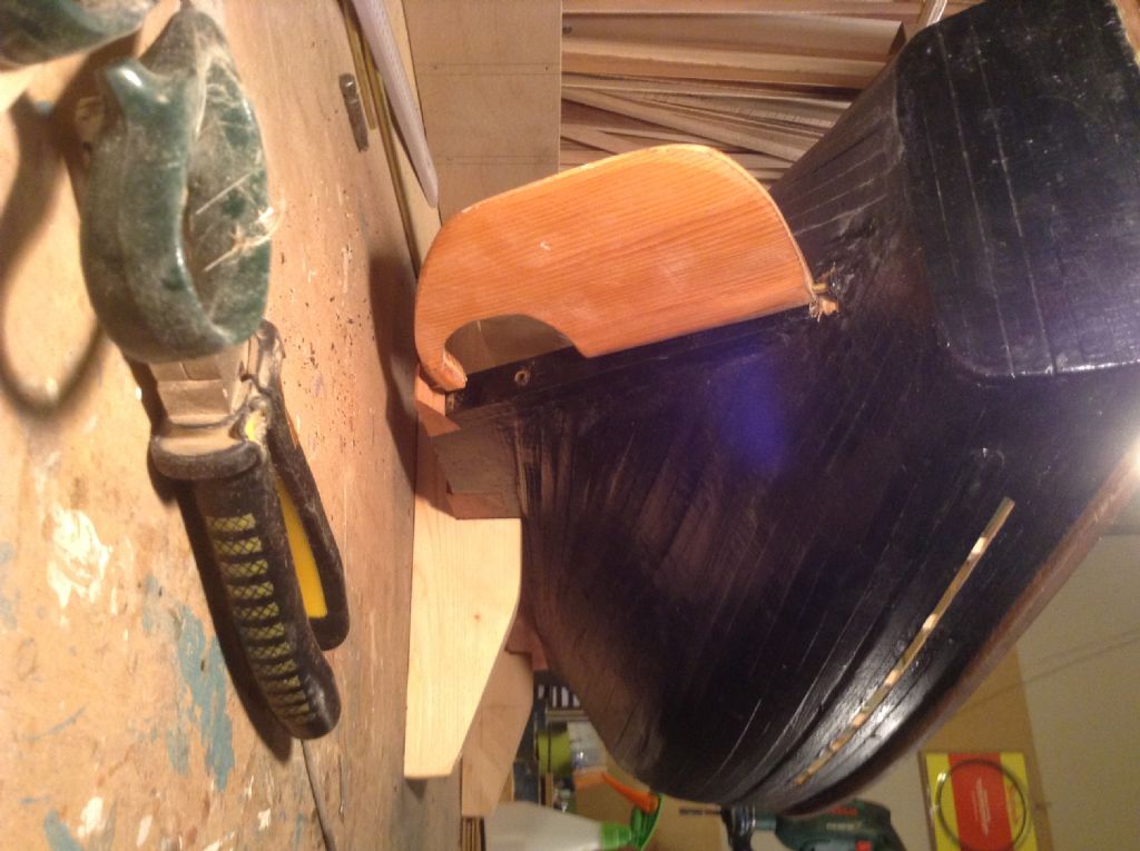

                                                    Lead keel cast in two sections and bolted together, then fixed in placep1030133.jpg

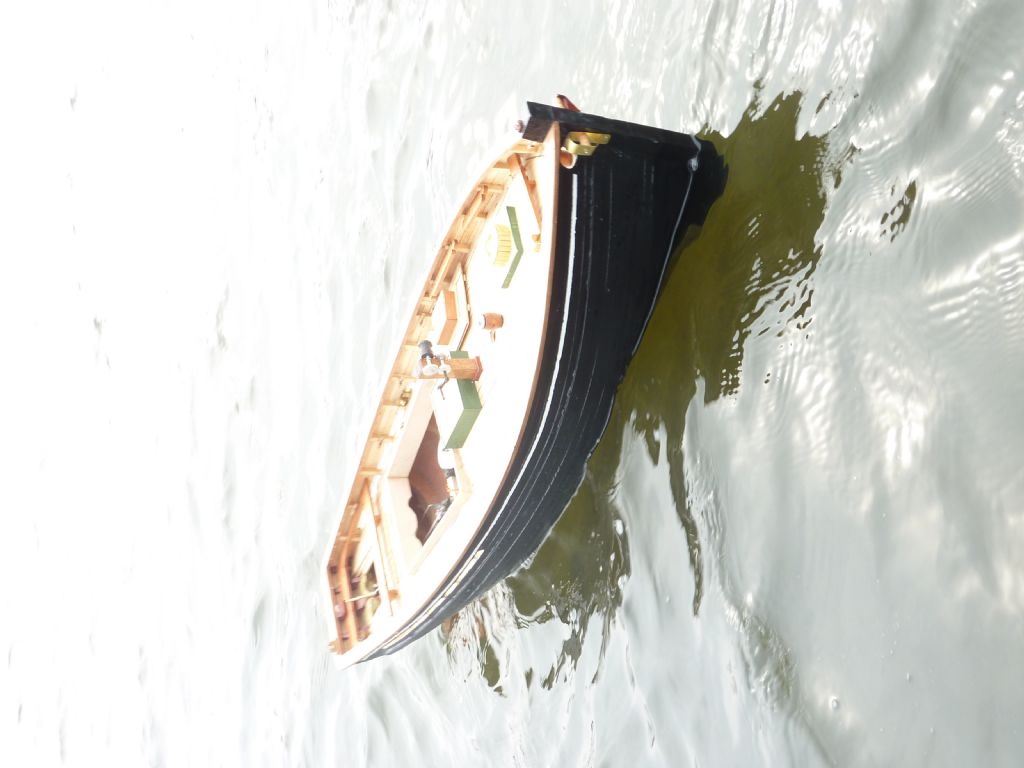

                                                      First time in the water, slight starboard list, hull totally watertight… YES!
