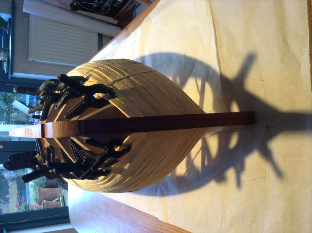

            Brian Muir
              @brianmuir84327

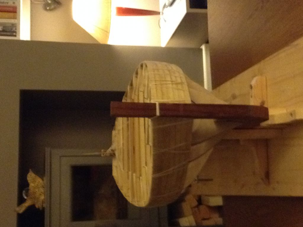

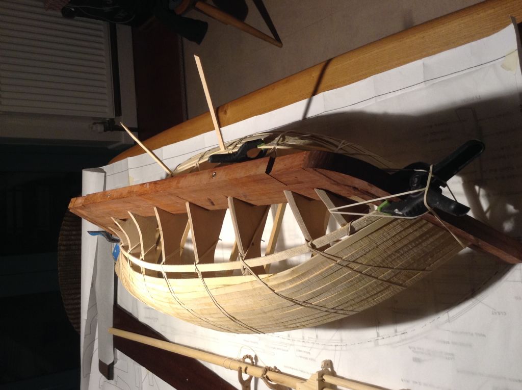

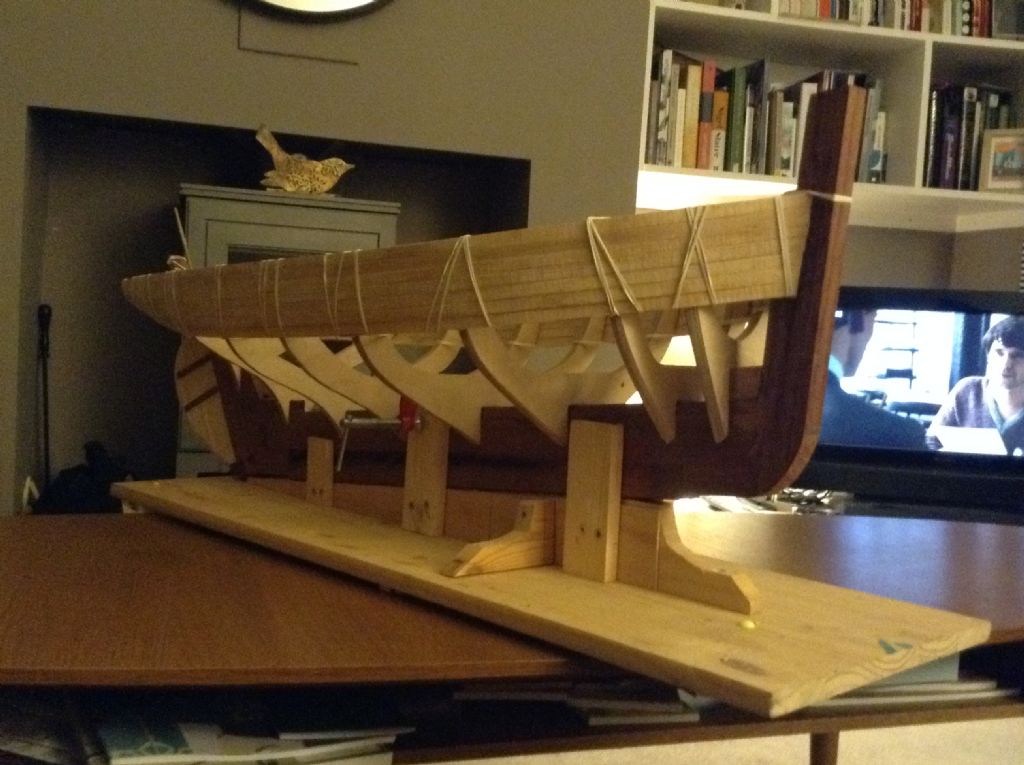

              image.jpegimage.jpegimage.jpegI'm using pine planking that I cut myself, quite rough sawn, well soaked, it bends and flexes easily and has gone on very well. I'm using elastic bands to hold them in place, and I was putting them on so tightly that they were forming Lille depressions in the bottom edge of the planks! I can only fit one each side per day in order to let the glue and the wood dry out. I intend to use Halfords fibre glass kit to seal the inside of the skin, then sand the outside, leaving edges and the grain visible. The model is supposed to be painted, but if I get a nice finish I might just varnish it.

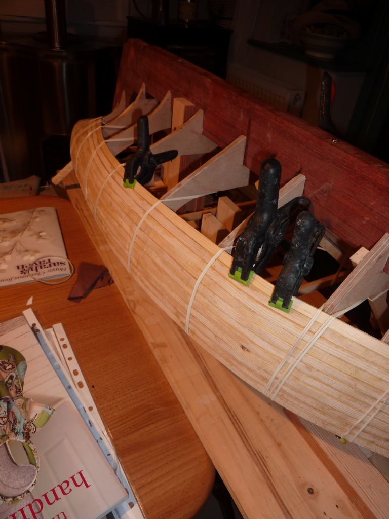

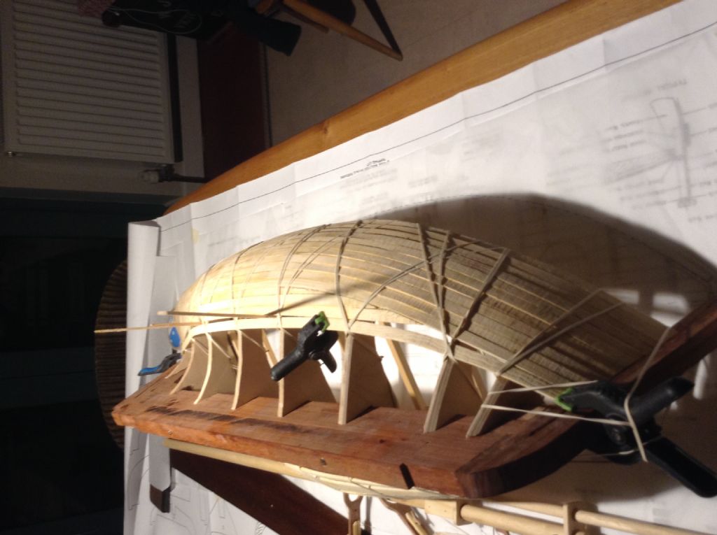

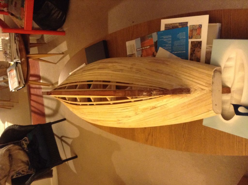

                  Ok the planks have gone fairly easily so far but it is becoming hard to get them to line up now. Is this where I have to start shaping the planks? If yes, can anyone suggest a straightforward way of doing this, I've seen an article in MB about marking plank widths then fixing a plank and filling in the gap.p1030115.jpg
                  #61508
                    Hello Brian
                    The planking is coming on well
                    There's no short cut to a planked hull…….Just plane each pair of planks to suit and take your time
                    The stern is a tricky area……Just follow the formers
                    Can we see a more pictures please?
                    I fitted a motor and it was a nice feature to have…….What about you?

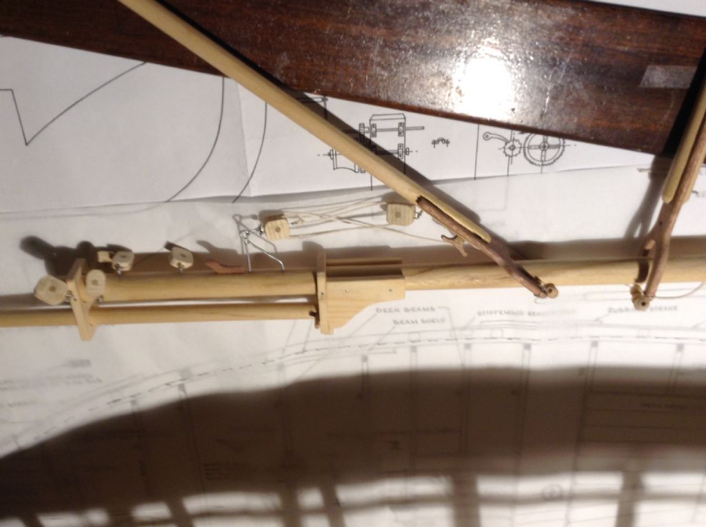

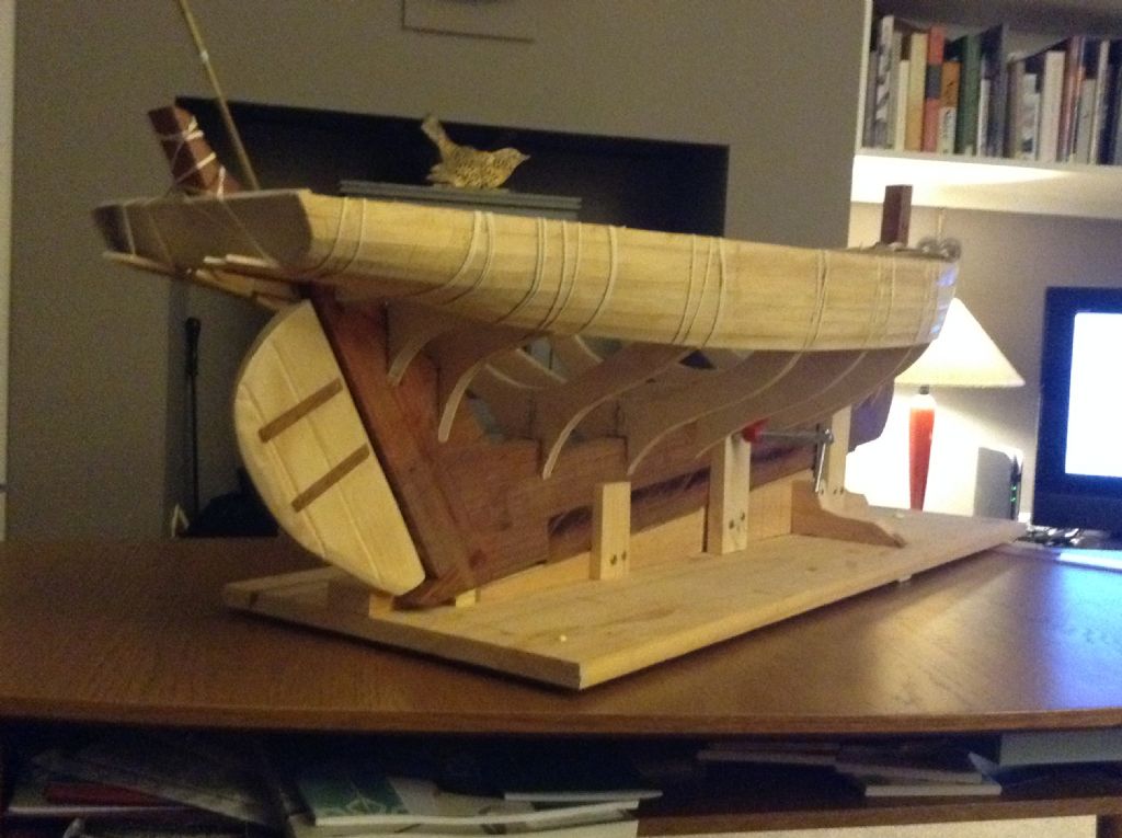

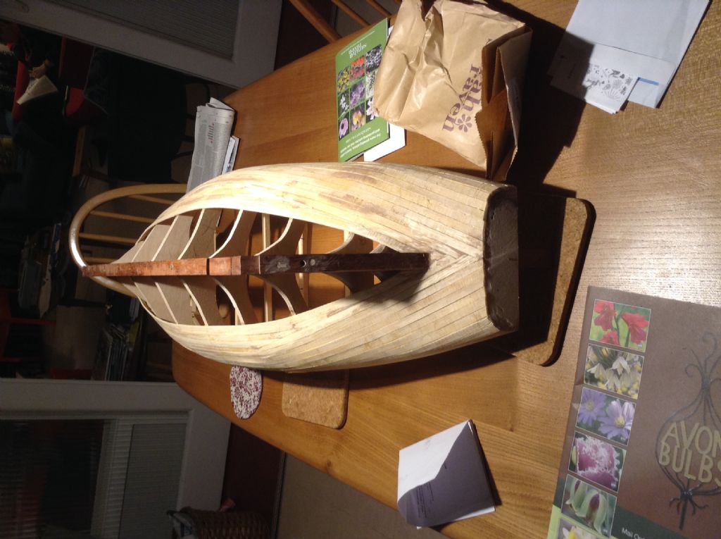

                        Stud 1.jpegBut I'm now getting to the tricky parts of the planking… I have fitted a full length plank from bow to stern, and I aim to fill the gaps to the existing planks, then work towards the keel. The idea is (I hope) to keep the bows and stern looking nice and symmetrical.Port 1.jpeg

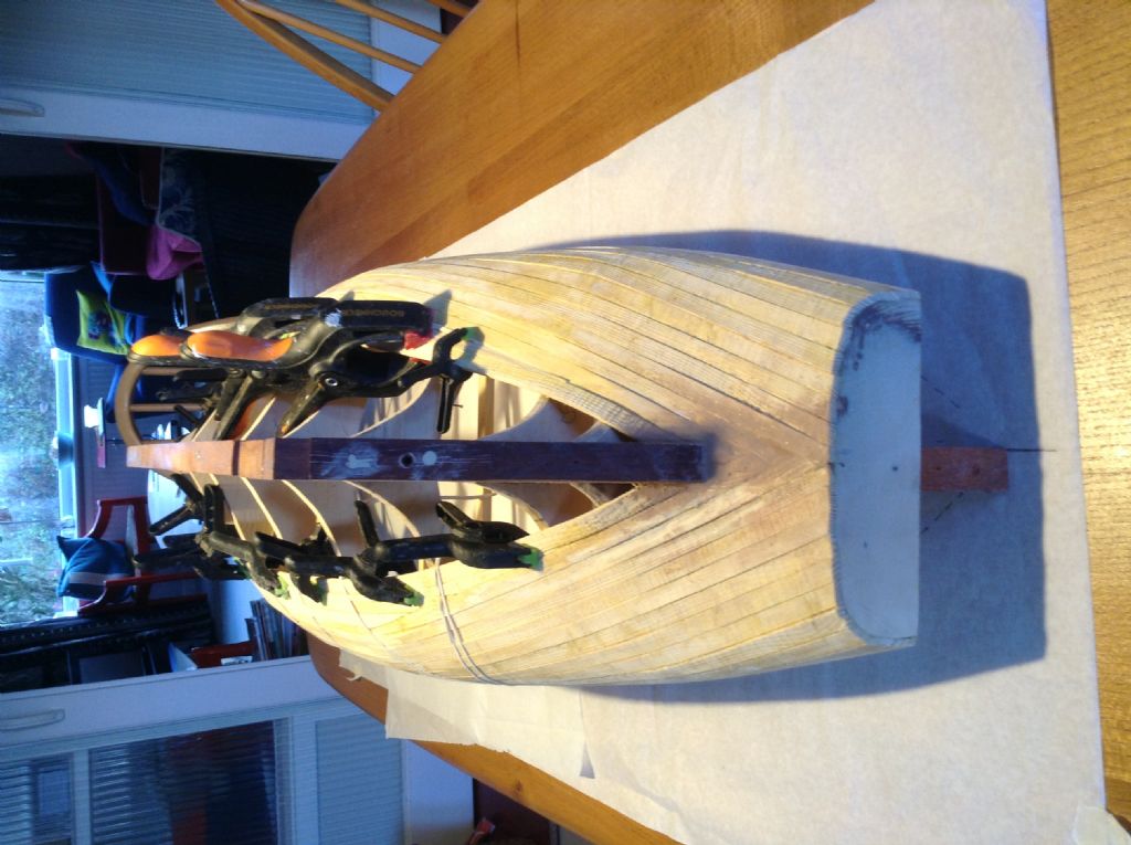

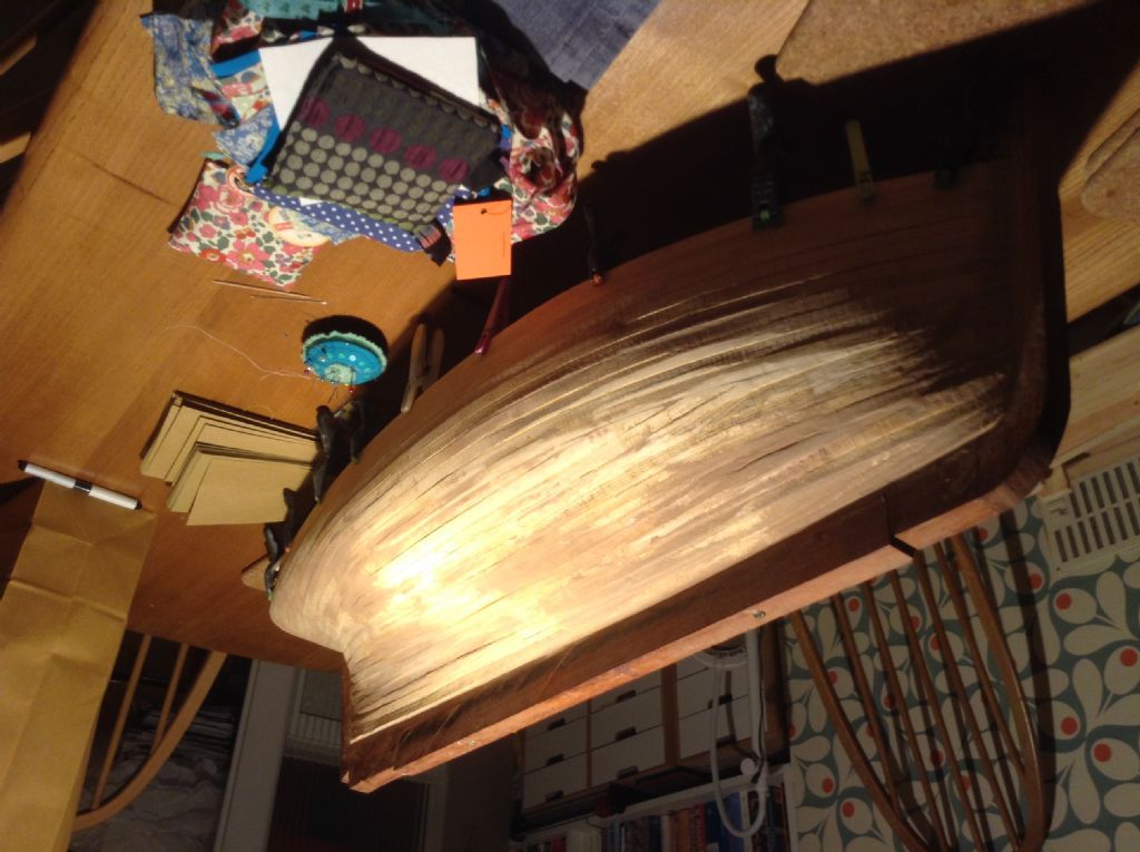

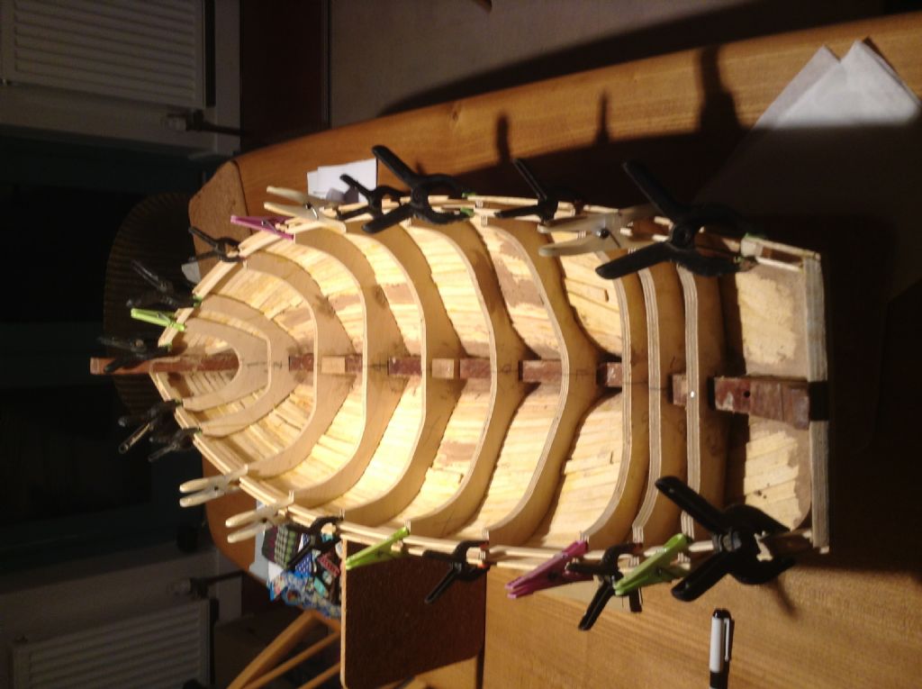

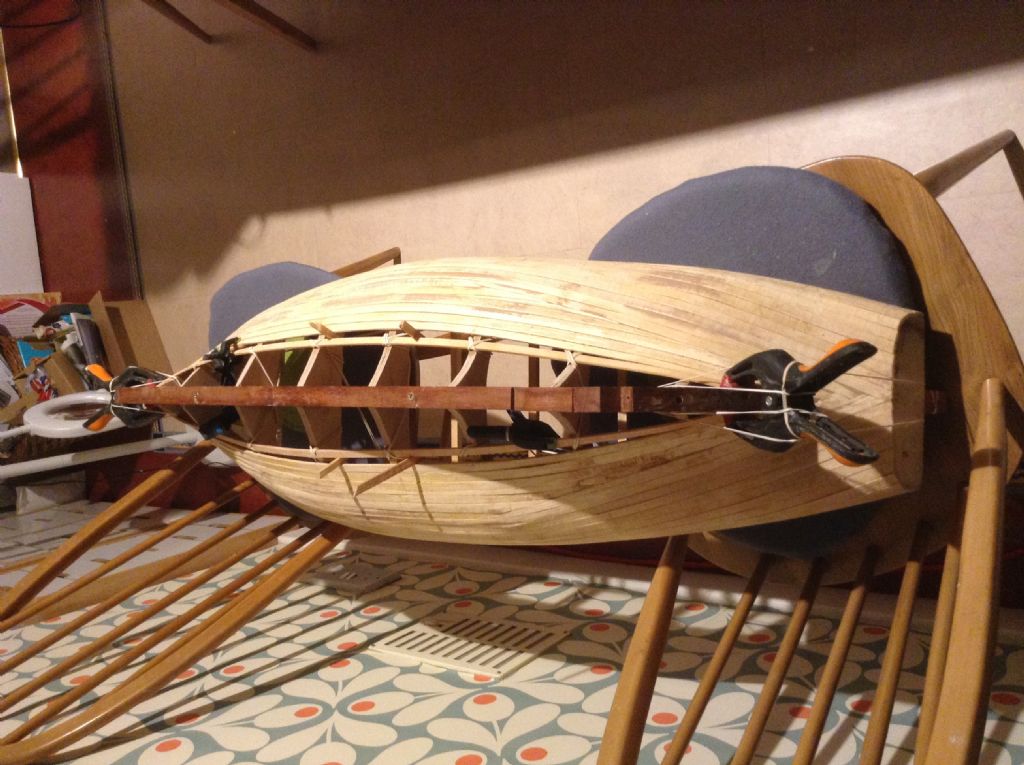

                        #61603
                        Brian Muir
                          @brianmuir84327

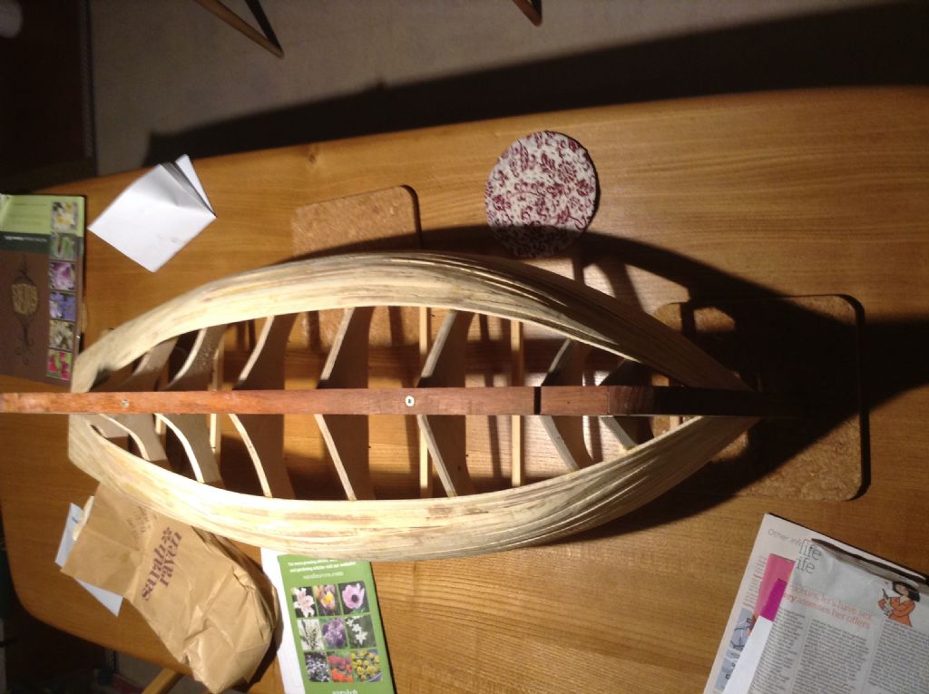

                          Stern planks.jpegHad to use 3 substantial filler planks and one small wedge on each side, but it seems to have worked and the hull appears nicely symmetrical.Bow planks.jpeg
                          #61620
                          Brian Muir
                            @brianmuir84327

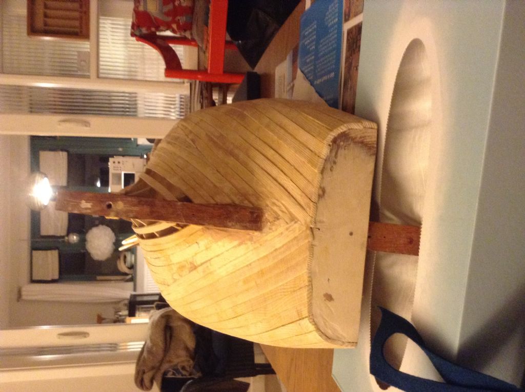

                            image.jpegNot looking too bad, some minor lumps and bumps, a a little bit of filler applied. I have realised that I was soaking the pine planks for too long, so they were quite swollen when I fixed them in place, then when they dried out they shrank away from each other, leaving very small gaps! Fortunately it will be sealed inside with fibre glass and epoxy resin, and painted on the outside, so will end up water tight.image.jpeg

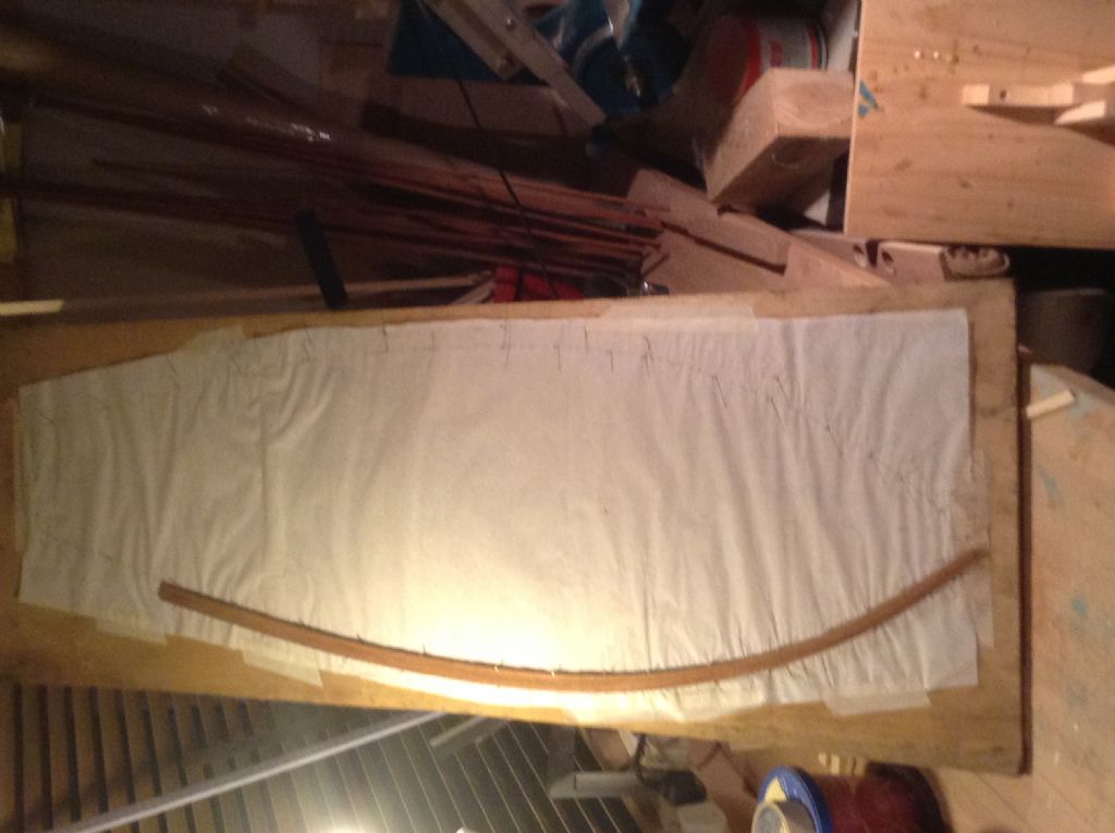

                                  Made a former and bent three strips glued together to form the laminated taff rails. Worked very well.image.jpeg

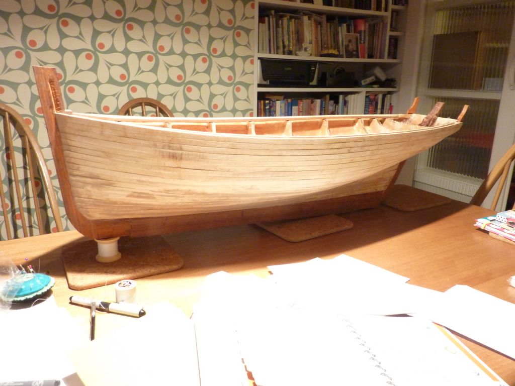

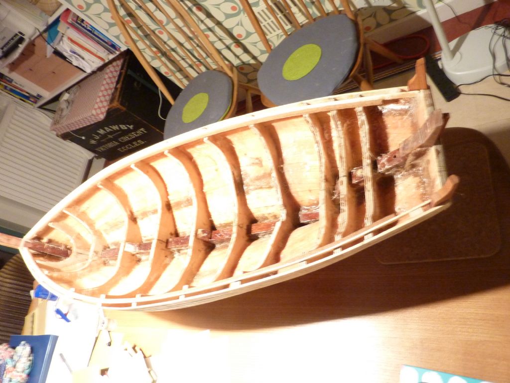

                                              p1030120.jpgFibre glass resin coating applied inside the hull, what a smelly, messy job, a bit thick in places but does appear to give a flexible reinforcement of the planking and hopefully a waterproof lining too.p1030119.jpg

                                                Looks good, Brian
                                                It`a all good fun from now on!
                                                Brings back the pleasant exciting memories of my build……All those years ago
