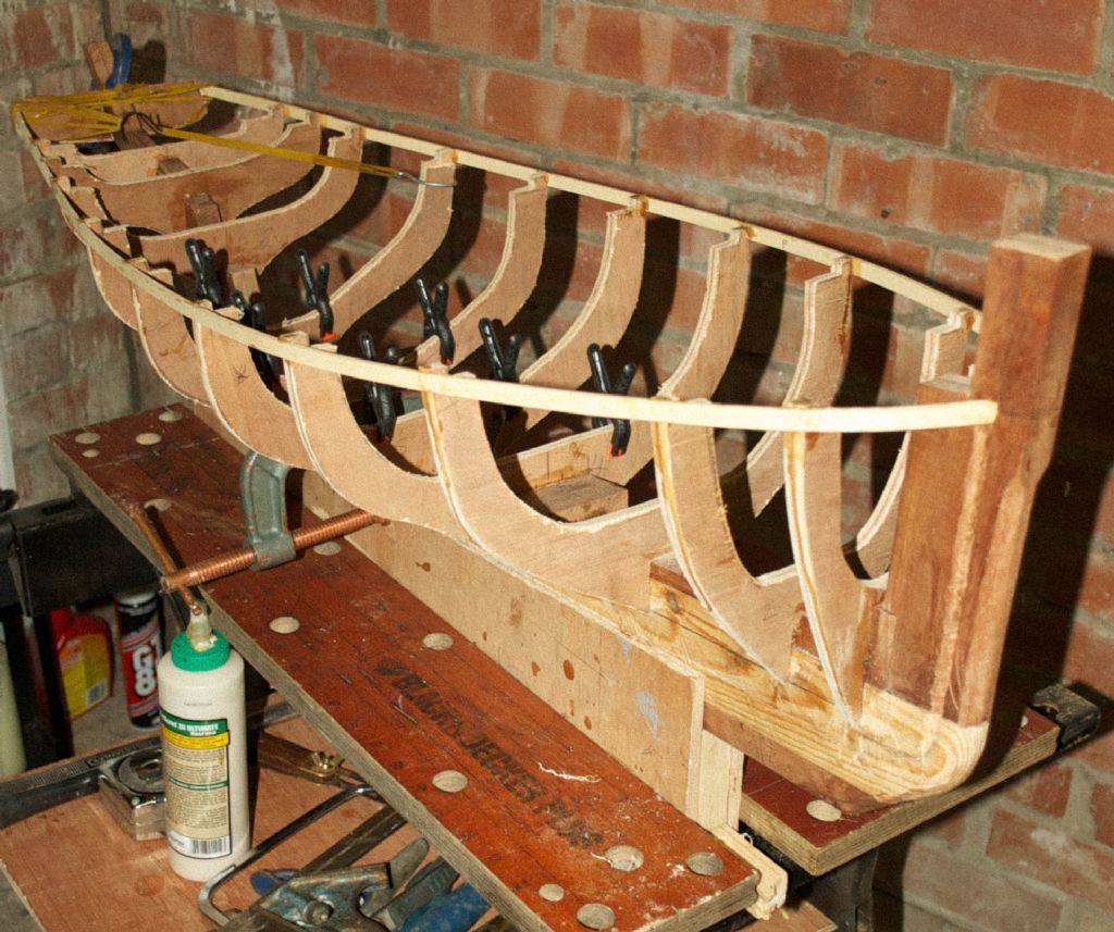

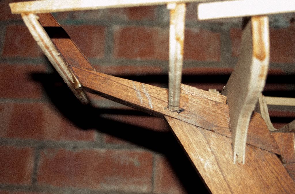

                        I had the added problem of involvement in other activities, when I came back to the boat, the keel had warped,stem and stern were totally out, I should have put the lead in before I left it…. I did learn one thing though, when you throw a keel at a wall step to the left a little, and when it bounces back at ya i"tl miss….frown but eventually I got to this stage..trnsm web-2.jpg
                        #58672
                        steven smith 6
                          @stevensmith6
                          The pic above needs a little finishing, but now I'm fired to finish it, the new keel is pitch pine and the rest is mahogany, it will be a reminder of my little error, I can only get 9×3 obechi, and it's a little short so I'm having to scarf joint it…

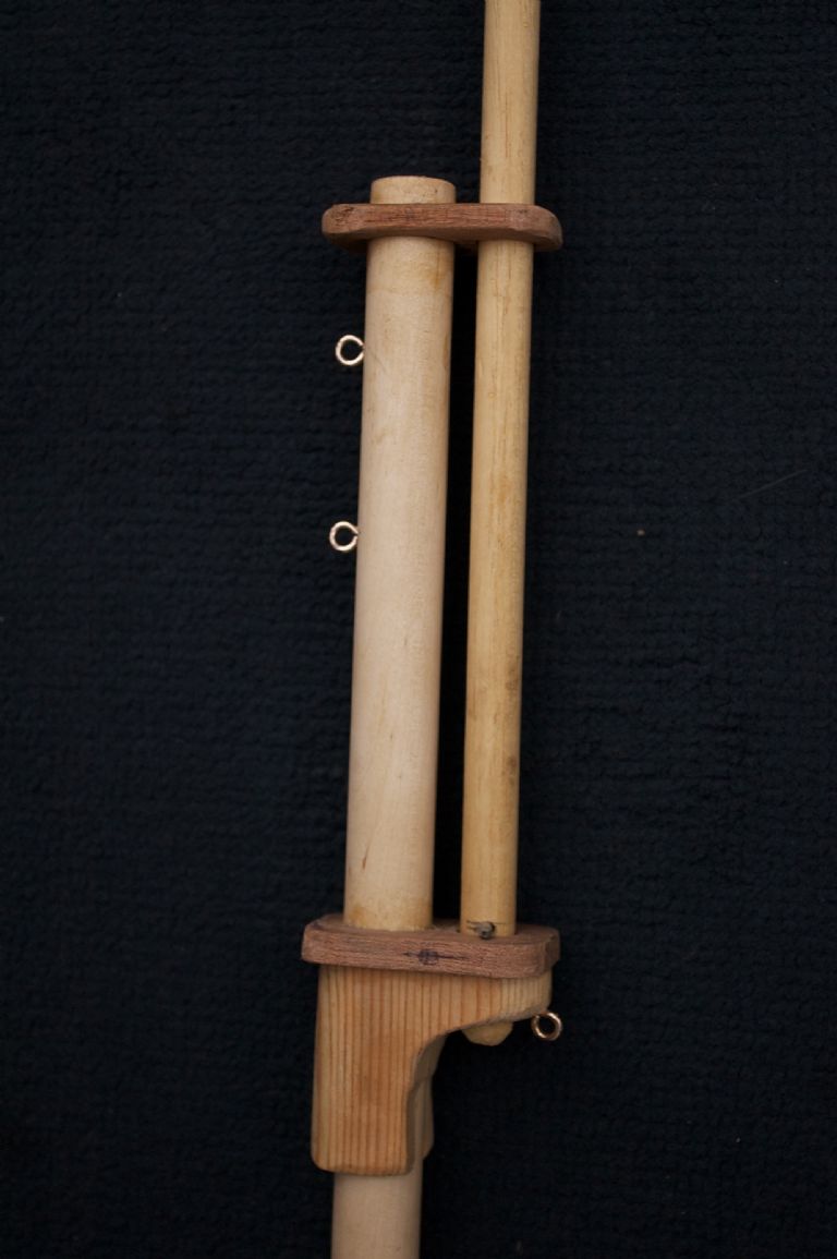

                            As I have not been able to get more obechi, I decided to work on the mast..dsc_8822.jpg

                                                  Had to remove some of the frames to realign them, and then fix the first plank on each side. I have bought some lime wood planking, and cut some longer pine strips for the upper planks.

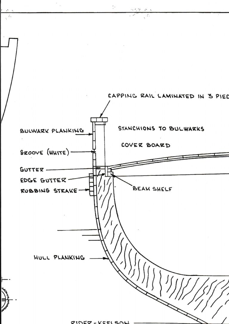

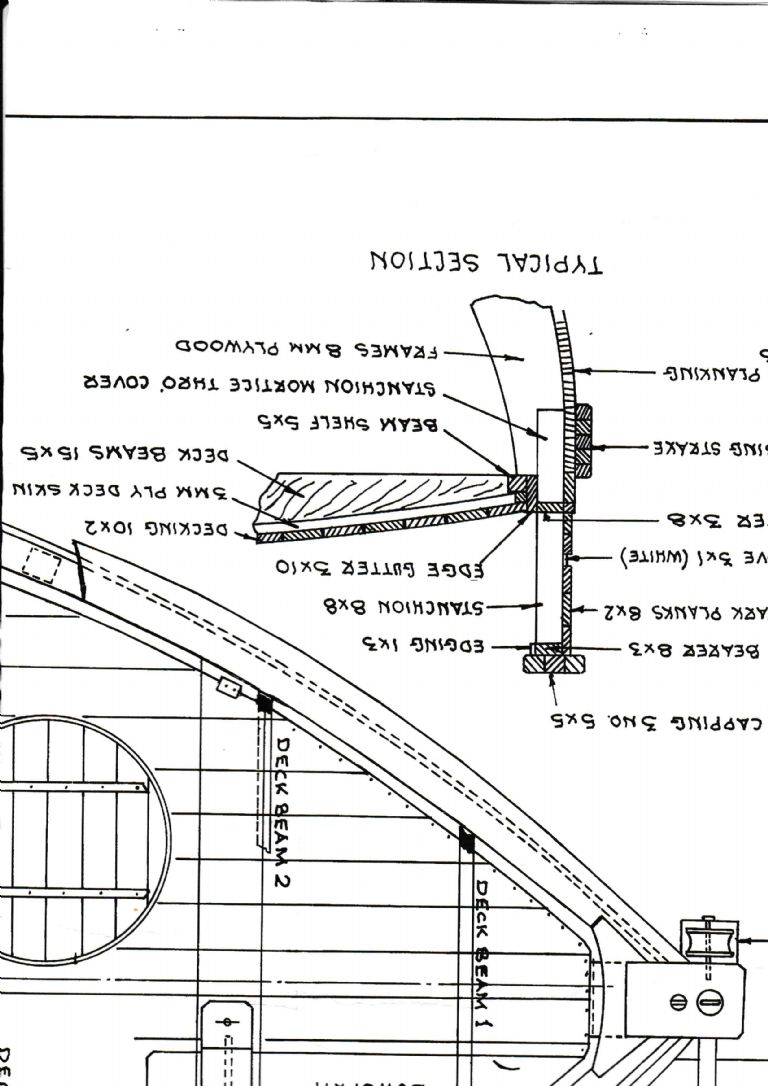

                                                      image.jpegimage.jpegCheers Bob, been busy sailing a real boat over the summer, I have been going over the plans, see pics below, and I'm a bit confused about the stanchions being mortised into the "cover board". But as far as I can see the gutter boards fill the gaps between the stanchions, and the ply deck cover with planking on top stops at the edge gutter?? Am I missing something?
