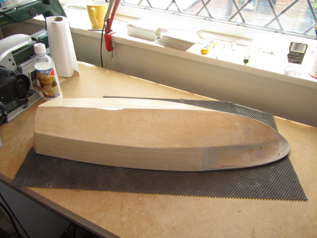

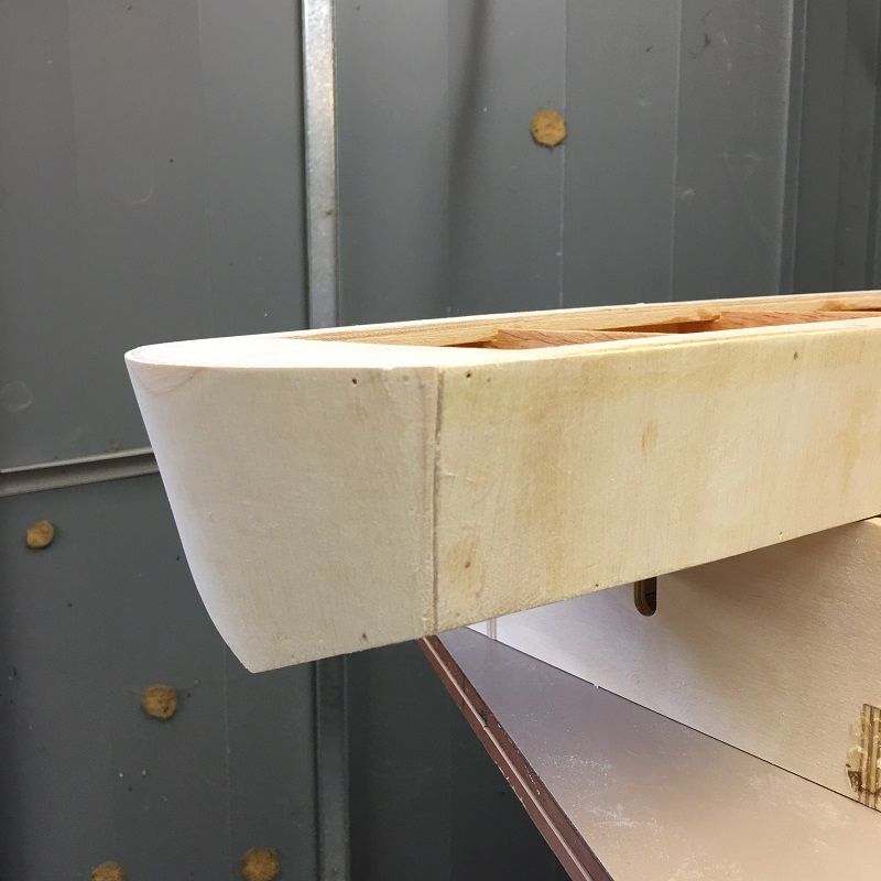

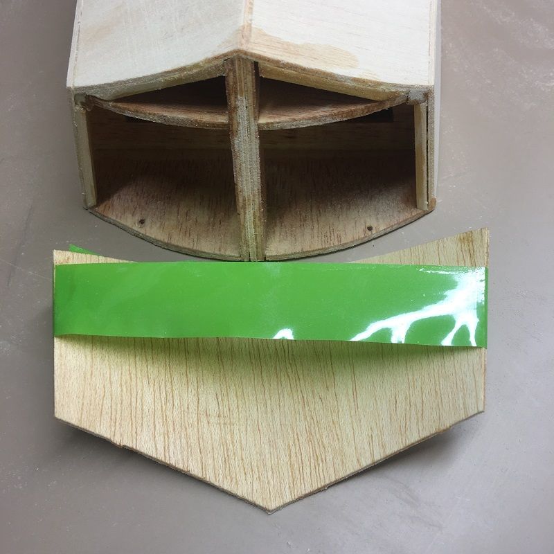

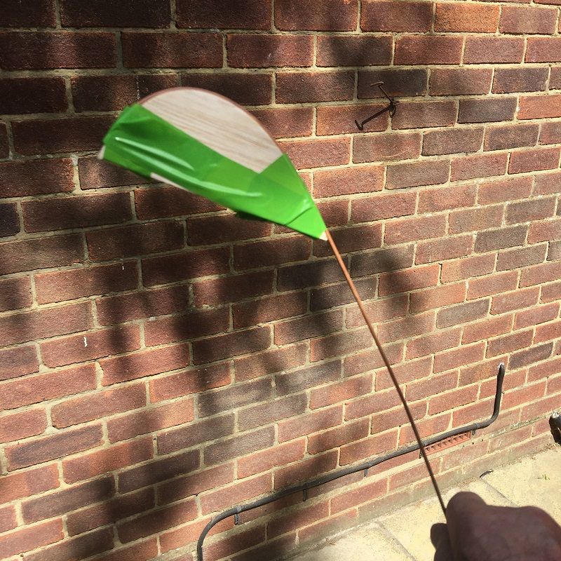

      Not a lot to show for another days work, mainly waiting for epoxy to harden, the inside had a coat of thinned epoxy yesterday along with the inside of the transome.
      A piece of tape held the shape of the transome while the epoxy cured.
      Before it was fitted today, and then a second coat of thinned resin on the inside.
      I think you must have been unlucky with your transome Colin as ours went round the curve quite easily after a bit of steam on the outside.
      The bows are about there now.
      The glass fibre and more resin are on order and should be here this week, we can then get the hulls finished.

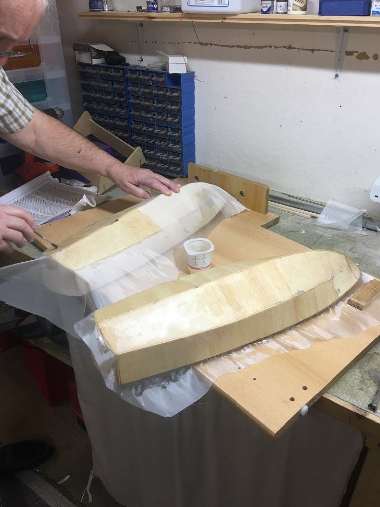

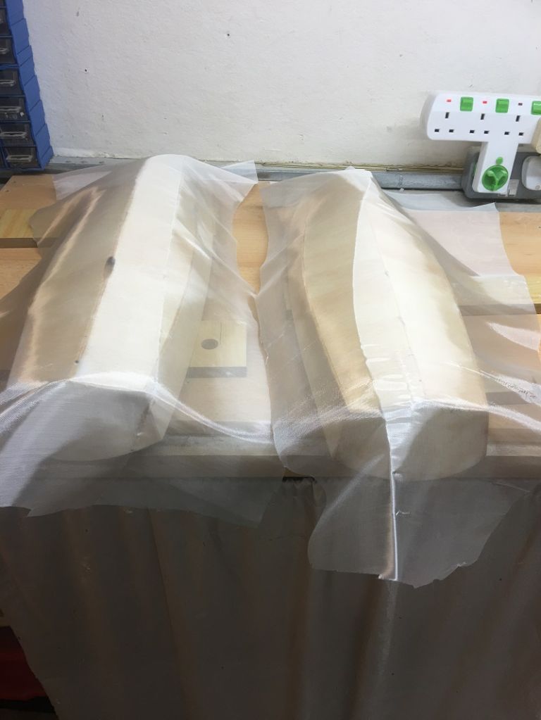

        Glass fibre cut over size and laid on the hulls.
        The first hull is finished and the second one on its way,16 grams of thinned epoxy resin was enough for each hull.
        Back to rigging the main mast on the Zulu while the resin cures, we should be able to get the second coat on later today in this warm weather.

          The best results for epoxy are obtained on what's called "wet on wet". As soon as the first coat has gelled and is robust enough not to wipe off, you can put another coat on. This creates a homogenous chemical bond as if it is one layer. Technically if the epoxy fully cures it should be cleaned and abraded before extra coats. A bit academic for our purposes maybe because epoxy is such a good adhesive. It is more important if you are using polyester resins.

            Not unlucky with the transom Eddie. It was my own fault, I kept offering it up and bending it dry without steaming.
            Live and learn!

              Hi.Tim, yes the second coat has just gone on, I remembered your advice from a previous post.

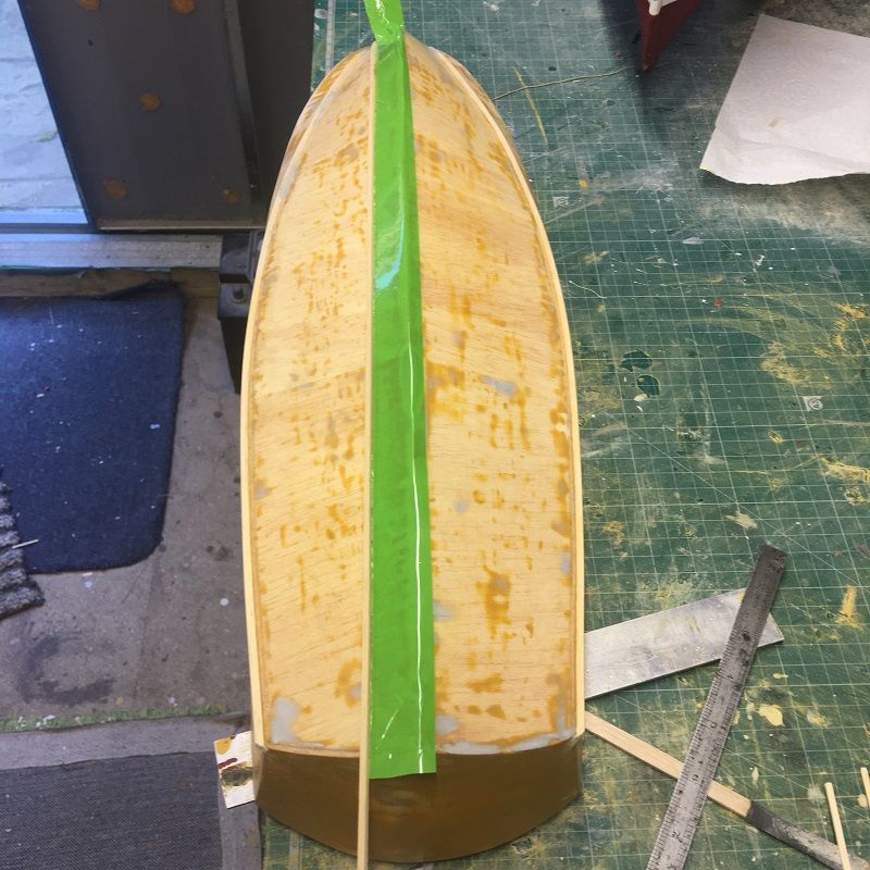

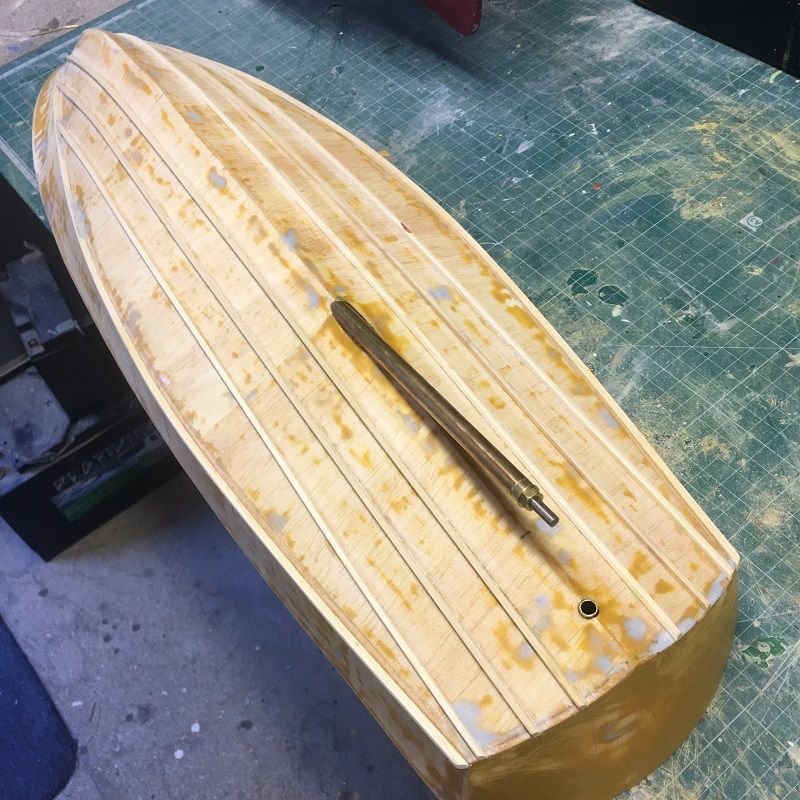

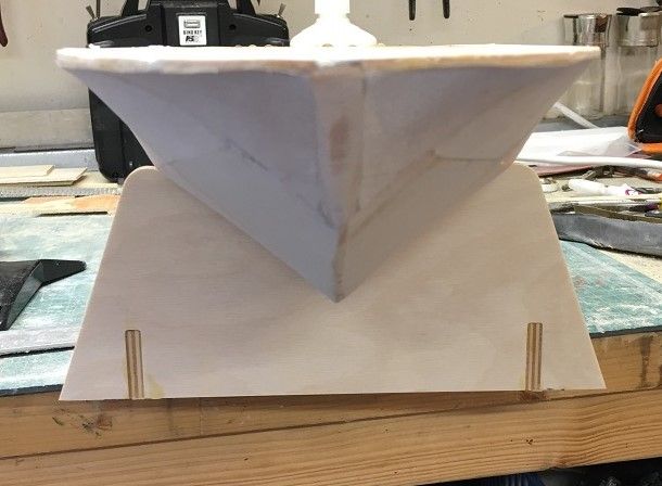

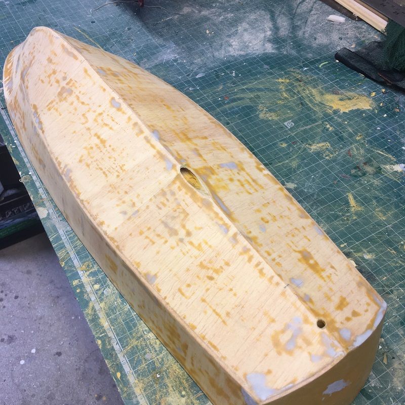

                                  I thought it would be a lot easier to prepare the hull for final painting at this stage, before the spray rails are fitted, with all of my previous builds, around eight now, I have found that 90% of the first coat of primer filler is removed,and this gives a far better indication of the areas that need attention,so after three light coats of filler to get a solid colour, this was rubbed down, just leaving paint in the low areas,most of them were filled with the paint, but a few needed additional filler added and then rubbed down.
                                  Most of the paint and filler have been cut back to the glass and resin so that the cyno gell is applied to the resin and not onto the paint layer.
                                  The next job was to fit the spray rails, a job I was not looking foward to, but with a bit of thought it all went quite well.
                                  The first one fitted, using a length of tape as a guide.
                                  All the spray rails fitted plus the prop shaft and rudder tube.

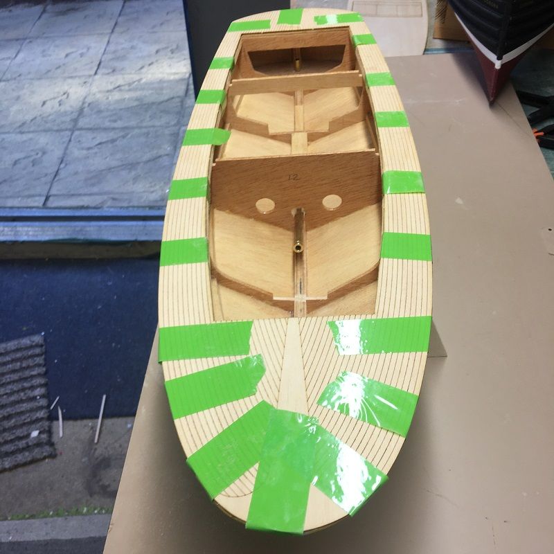

                                    I made a former the shape of the bow,and after steaming the mahogany rubbing strip bent it around the former to help when fitting it to the hull.
                                    The deck is now fitted using a slow set epoxy, the hull has had the filler primer coat applied, after sealing the deck the rubbing strip will be fitted then onto the cabin and finish fitting the electrics.

                                        That was a very good plan for the rubbing strip Eddie.
                                        I am impressed (and slightly envious) of your progress. It's all looking very good indeed.
                                        Not sure how I am going to tackle my deck as the panel supplied in my older kit is just plain plywood. Looks like I may have to invest in a decent pen! And borrow some of Job's patience.

                                          Hi. Tim, progress is so good because I have no other distractions such as shopping, housework and cooking to do.
                                          One possible snag with.the new lined deck is that the hull has to match the outline of the deck exactly as you cannot sand anything off the edge of the deck without it effecting the look of the planking.

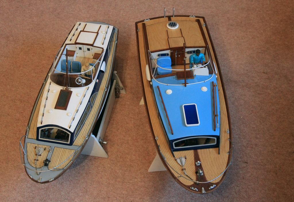

                                                  Yes, sharp curves can be difficult which is why even owners of full size boats have opted for straightish planking which is what I did on my Huntsman. It was easy enough and reasonably effective.
