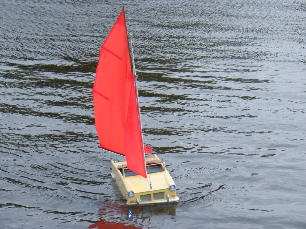

                      You can always glue sails together using a fabric adhesive if you don’t want the ultimate in realistic sails. This avoids sewing entirely. Lines can be folded into the edges and additional material let into corners etc. The glue dries clear and is relatively waterproof. “Sewing” can be drawn on using a fine felt top pen.
                      I believe the racing boys use Mylar (..?) film and simply reinforce the corners etc with tape (or have I got that wrong?)
                      snap…glued up sail. Not a great work of art, but ok.
                      Triumph Herald#2

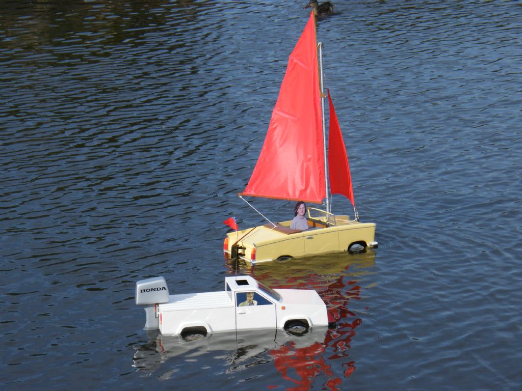

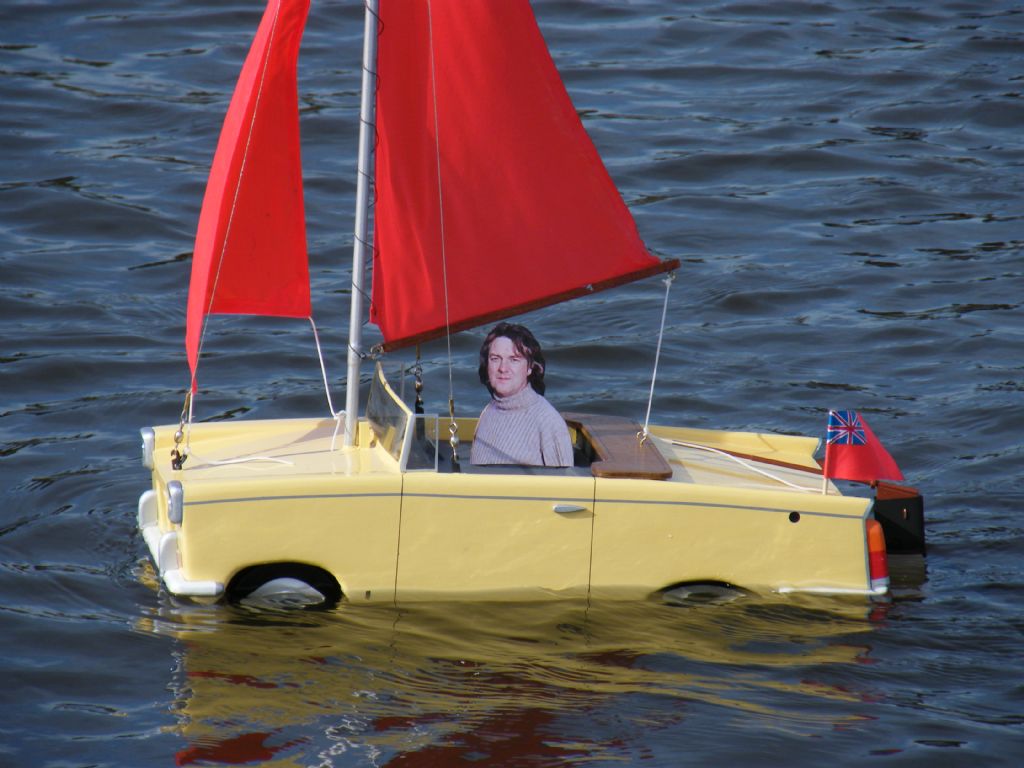

                          That's an interesting model you've got Ashley, an amphibious car is it? Does it sail across dry land as well?
                          #101727
                            Hi WB. This is a model of James May’s converted Triumph Herald car from the Top Gear TV program a few years ago for one of their water challenges. I also made a Toyboata and a Hovervan to go with it.
                            Its a rubbish sailer, as one might expect, and needs a stiff breeze to do anything much.
                            Herald and toyboata#2
                            Triumph Herald
