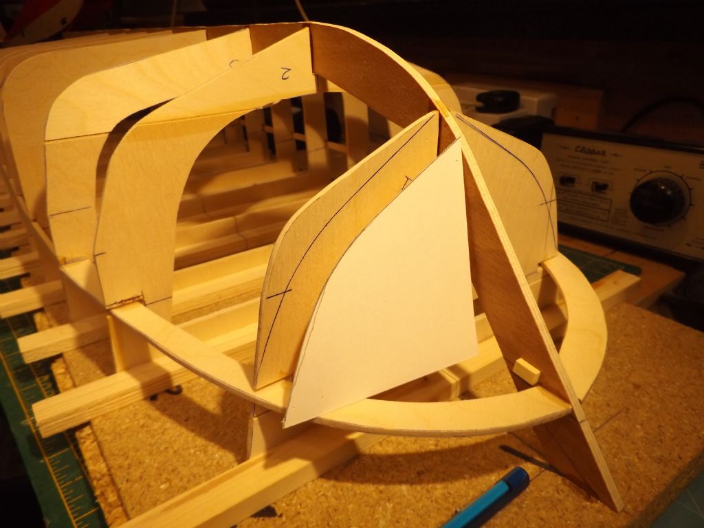

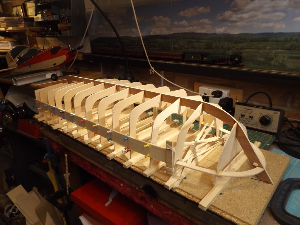

              delight 9.jpgdelight 7.jpgHi Chris,
              You are right ! since retiring I have discovered there is always tomorrow
              After a couple of days feeling rough and now my systems seem to be back on the top line
              The bulkhead 1 was much to full and would have created a rather bluff bow so some sketching and a template made to get both sides the same, I have altered the shape .
              The main part of the hull will be 3/16" soft balsa sheet and is taking a bit of coaxing to bend !! the area to the bow will be Styrofoam and carved to shape.

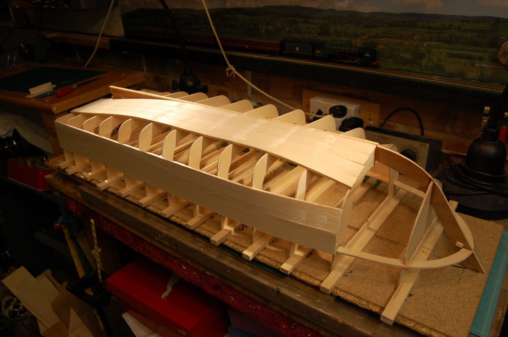

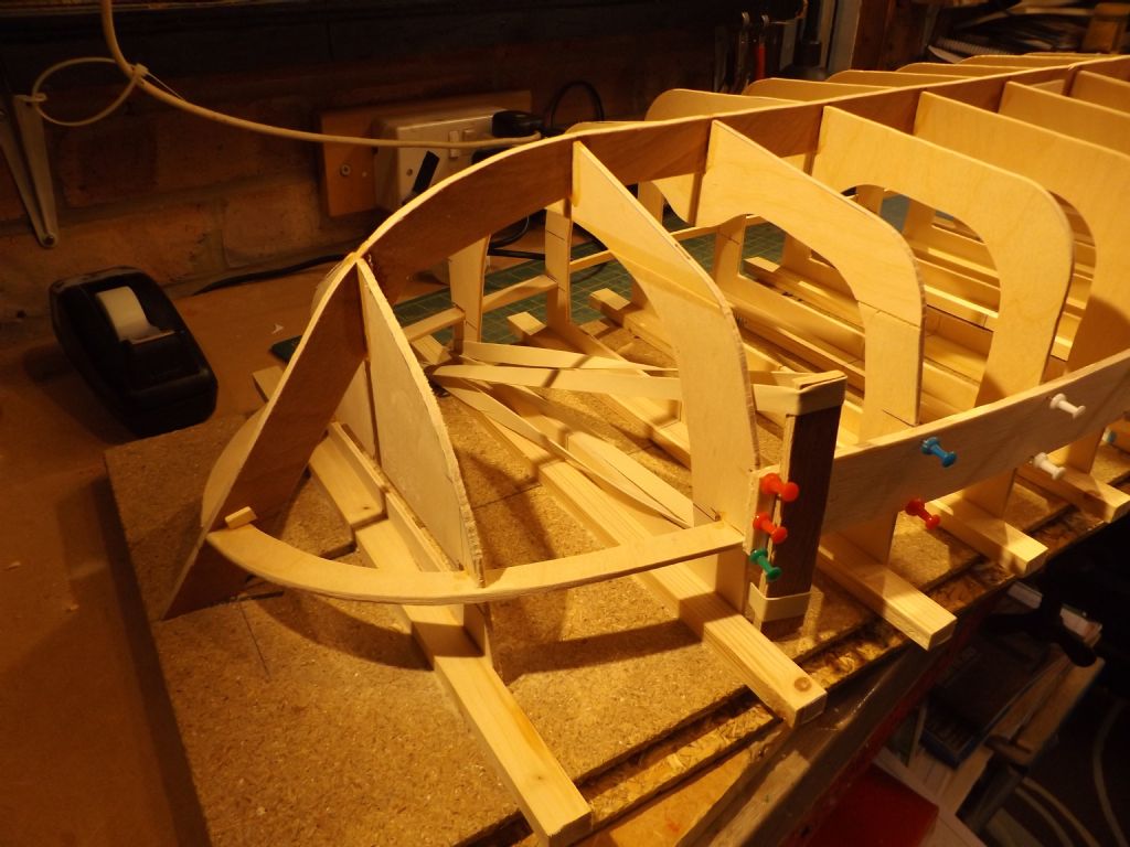

                            Delight planking moving ahead, 1" wide so that helps on the bottom, the acid test is the bow shape in foam !!!
                            The knuckle feature is going to be interesting.

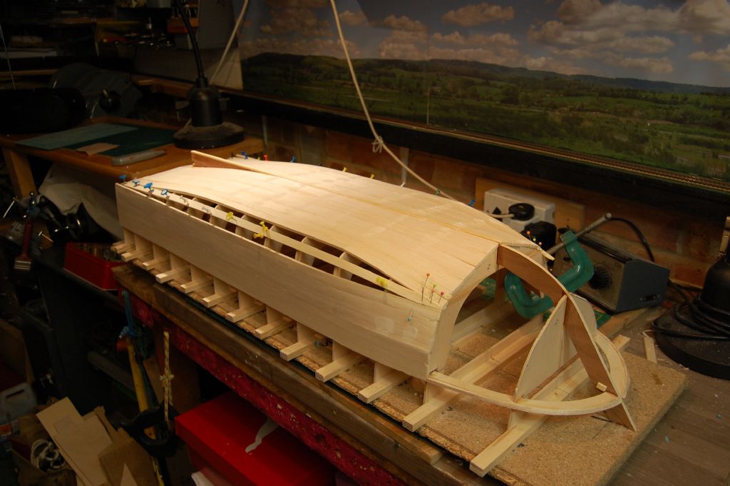

                              This hot weather has driven me back into the workshop ! the planking has just reached the tricky stage !! I'm almost looking forward to the foam blocks at the bow !!

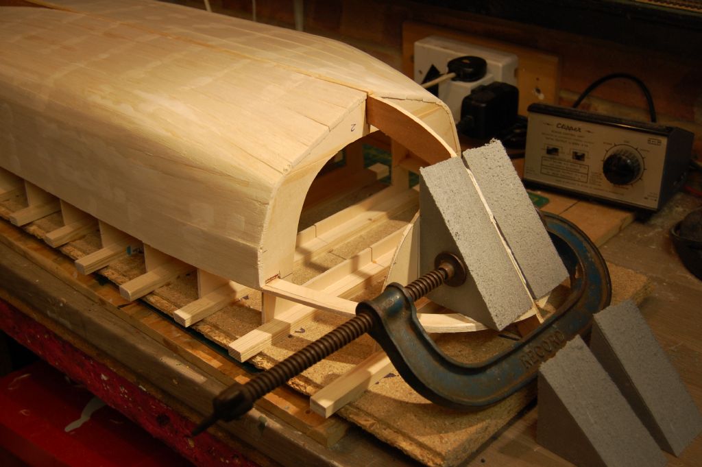

                                    Well the planking is complete ! why is it the two sides never go the same although I'm sequential one on each sidedelight 12.jpg ? still onward now with the styrofoam bow blocks being glued in position, carving soon
                                    Nothing like having a big enough Record G clamp to hand !!

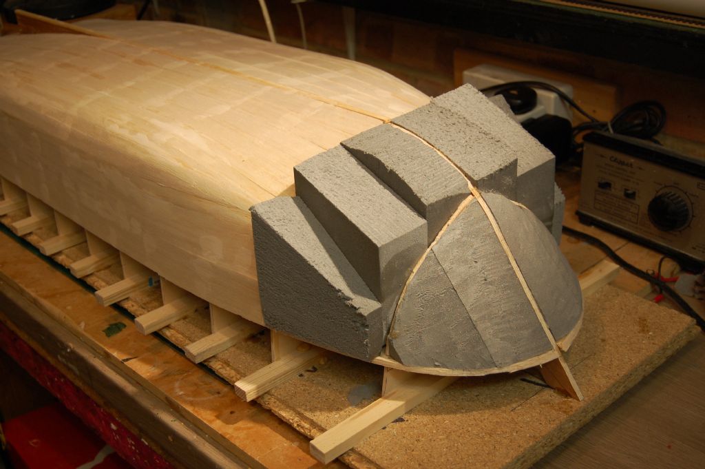

                                        #105798
                                          The last foam blocks are glued in place, next stage will be interesting !!!

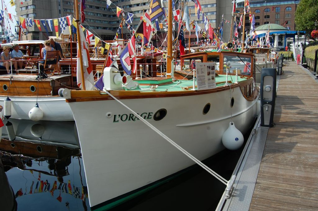

                                            Delight's bow is now finished , pictures to follow,
                                            Slight distraction last Friday to go on board my next build L'Orage at St Katherine's dock,l orage.jpg the founding craft of the Dunkirk Little Ships Association, then owned by Raymond Baxter, now owned by John & Sally who keep her on the Thames , she is immaculate in every respect
                                            Loads of photos taken so watch this space.

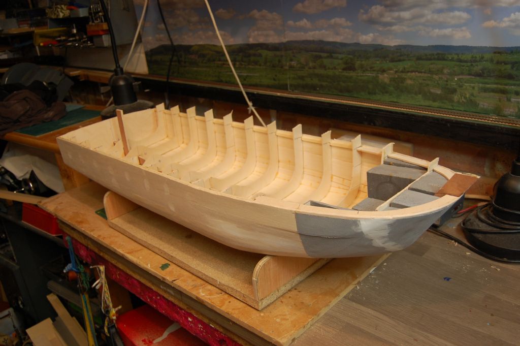

                                            #105863
                                              Well as Ashley would say that's the easy part done !! not really a thing of beauty but a good displacement hull for 5mph on the delight 15.jpgBroads
                                              Build a stand next and get her off the board.
                                              Bit of a cock up not making the keel/skeg really deep enough for the prop, sack the draftsman !! , some skull duggery will be required

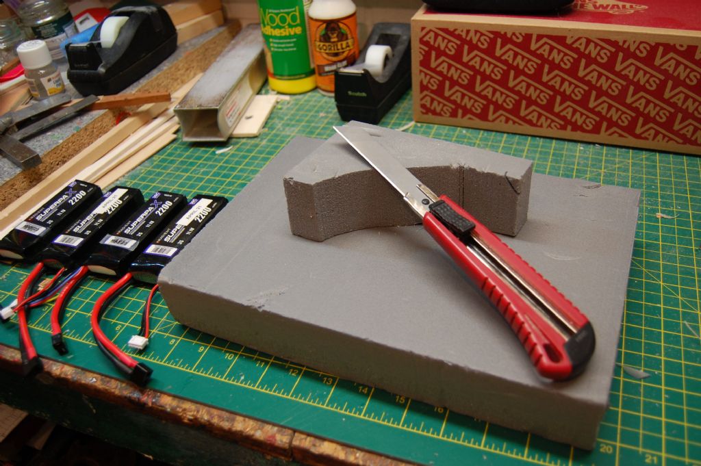

                                                    Hello David,
                                                    The grey Styrofoam is from 4 D Modelshop Ltd The Arches Leman Street E1 8EU , fab shop mainly for Architectural Modellers . They have a Website 50 mm X 600mm X 1250mm 33Kg density £35.60
                                                    This is my cheapo snap off blade knife with a 4" bladefoam & knife 130923.jpg which I use to carve to the rough shape then a Permagrit block & fine abrasive paper.
                                                    Glue I use is Gorilla Woodworking PVA , other makes available
                                                    Also used to be called Blue foam by Dow chemicals but becoming hard to source .
                                                    George,
                                                    We I thought I'd sack myself, but as I'm a gentleman of leisure these days ! that could be tricky

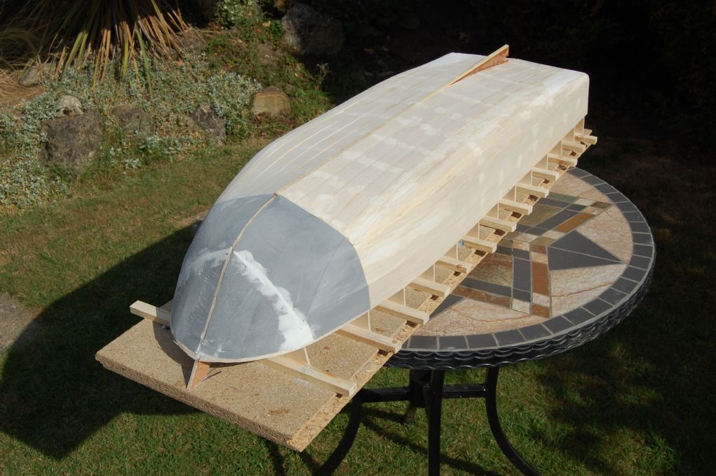

                                                    #105896
                                                      Knocked up a chipboard & plywood stand for her and cut free from the board, with one side trimmed we appear to have a boat !! at 1- 12th scale she's going to be a good size hull currently weighs in at 2 lbs.
                                                      As Ash would say that's the easy part done
