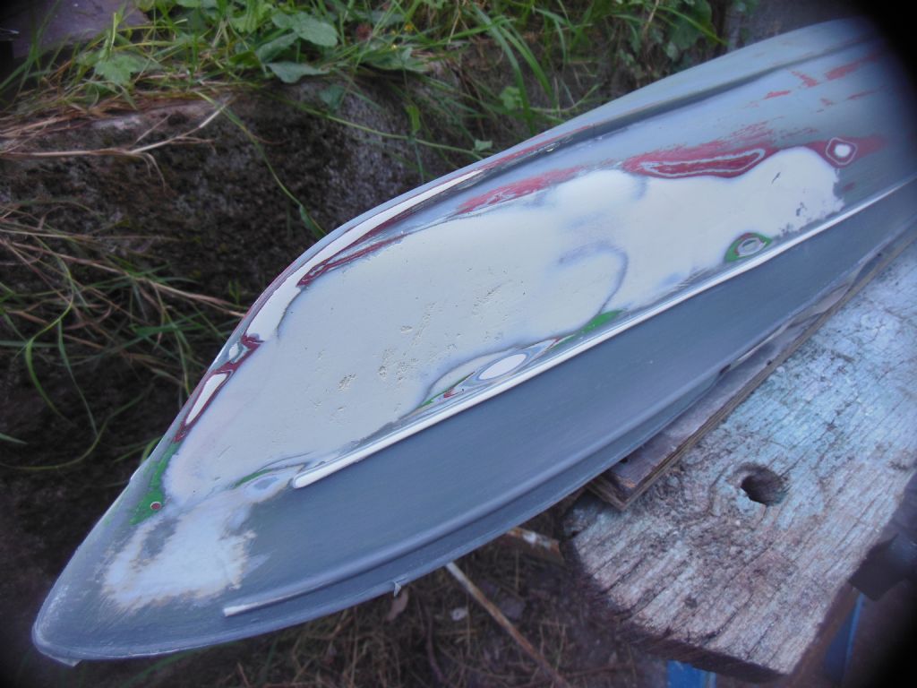

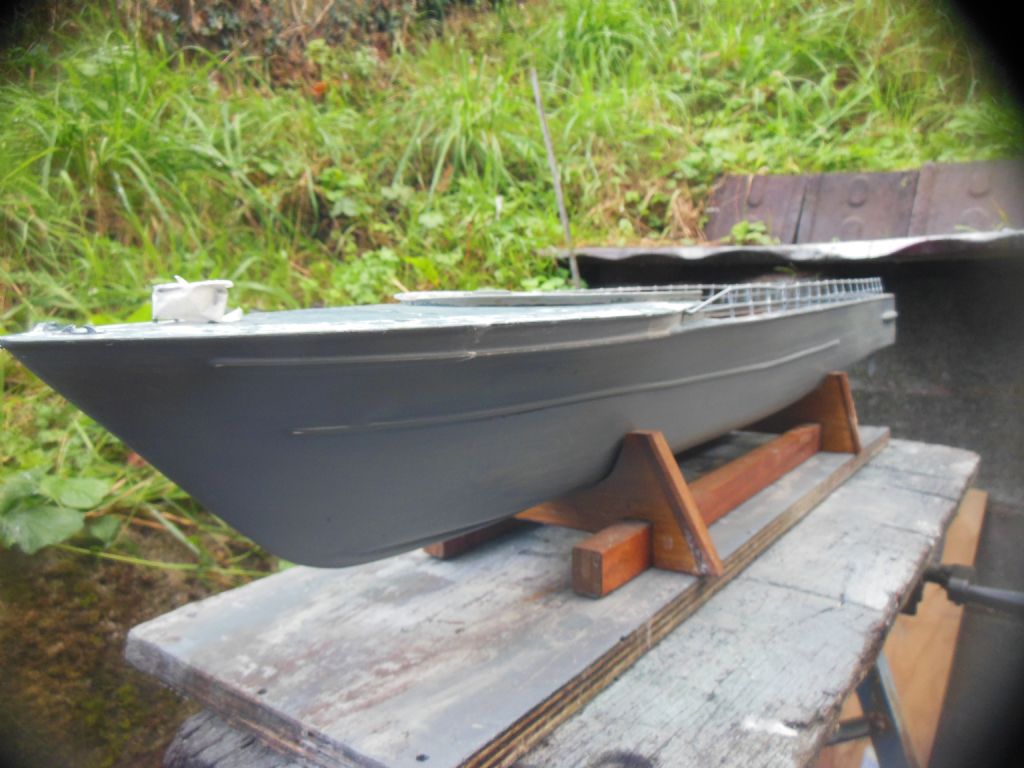

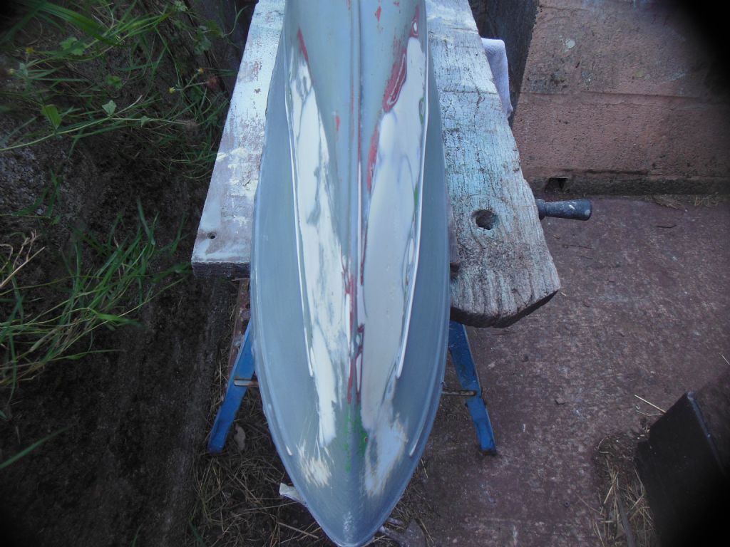

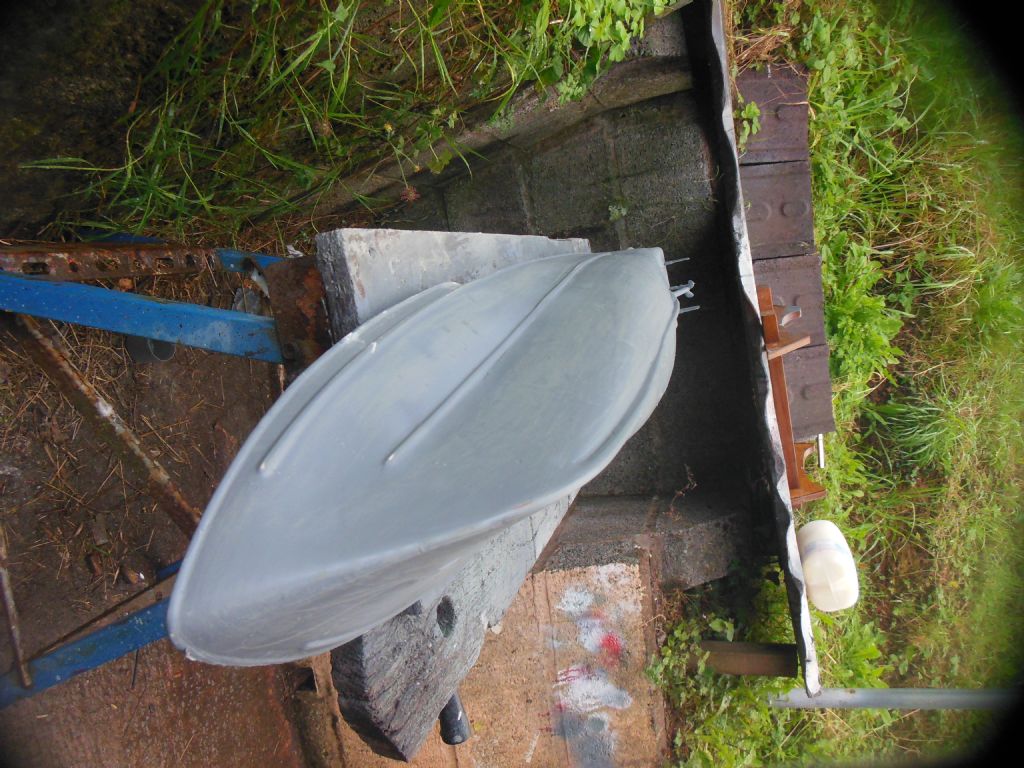

      Back again, a month!!! been busy in work so apologies if you were waiting. Looking at the hull again I wasnt happy. imagine looking at an arrow head face on concave from point to where it meets shaft, that was the shape of the hull viewed from the bow,from keel to w/l. after a week of working on it, sanding whole hull filler,sanding spraying more filler etc, (you get the drift?) I have got as near as dammit as I think it should be. alot more work than i wanted to do. gonna have to repaint the whole hull now,which is what i tried to avoid, not sure of painting the hull below w/l red lead again, it seems to look nicer with grey primer/filler spray, will have to see. At least now I havnt got knife edge looking bow and its a bit more rounded as it should be. Not too worried about added weight in the bow as when first built I had a fairly heavy lead battery up front compensated by lead at the stern to compensate, have to see when i do ballast test in local duck pond.. some photos of work so far

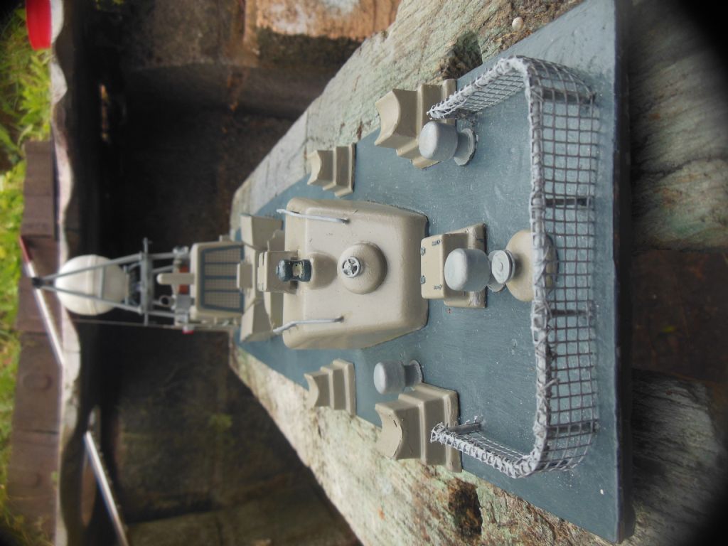

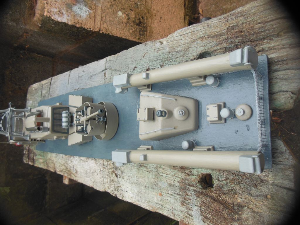

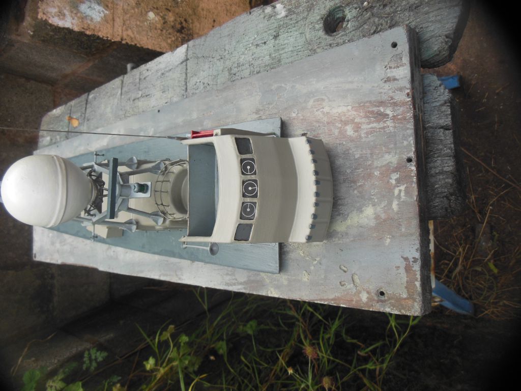

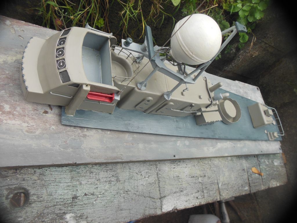

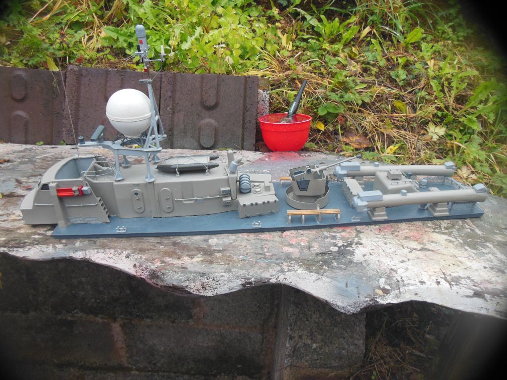

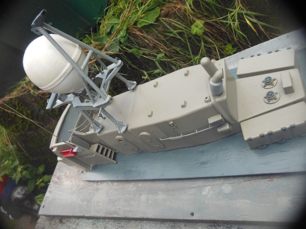

            started the removeable deck. the parts you see are those that could not be removed.not sure what araldite was made of in those days but after 40 yrs i still cant get them off. these days i find epoxy is not nearly as strong as it was years ago. Anyway, painted in revel matt and then coated in ronseal exterior matt varnish. doesnt do what it says on the tin sad it has come out more like a shiny satin. never mind, this job is taking me longer than i thought, and lots more to do. i left the gantry on because believe me I didnt want to break the soldered metal work. if i remember right, back when i made it originaly, this part was the hardest part on the boat.lots of shouting and binning soldered parts untill it was right. enjoy the fotos so far,its coming together.

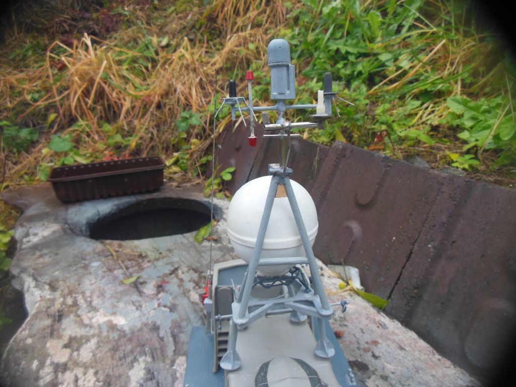

                BTW, does anyone know what the fenced off well is/for behind the open bridge? I have searched online and cant see any info. there doesnt seem to be a way in or no steps down to it. I know it was only a semi scale model but graupner seem to have got all access points pretty well covered in other areas. just curious, a swimming pool/jacuzi?

                  Hi Captain,
                  It's a hot tub, they all had them 😀

                    seriously ray? i was only joking when i said jacuzi. its just that its the same shape as the 1 on deck 9 queen elizabeth

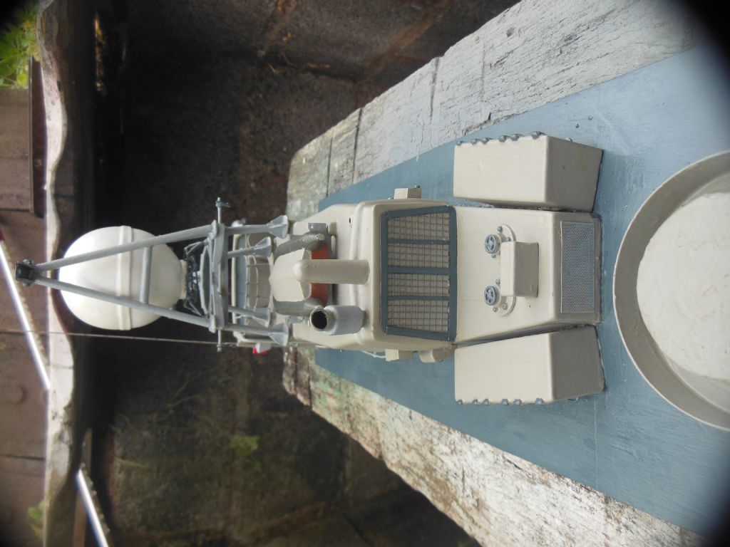

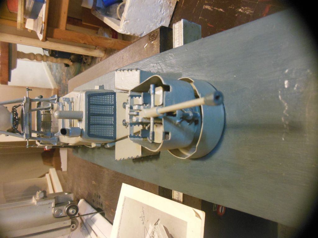

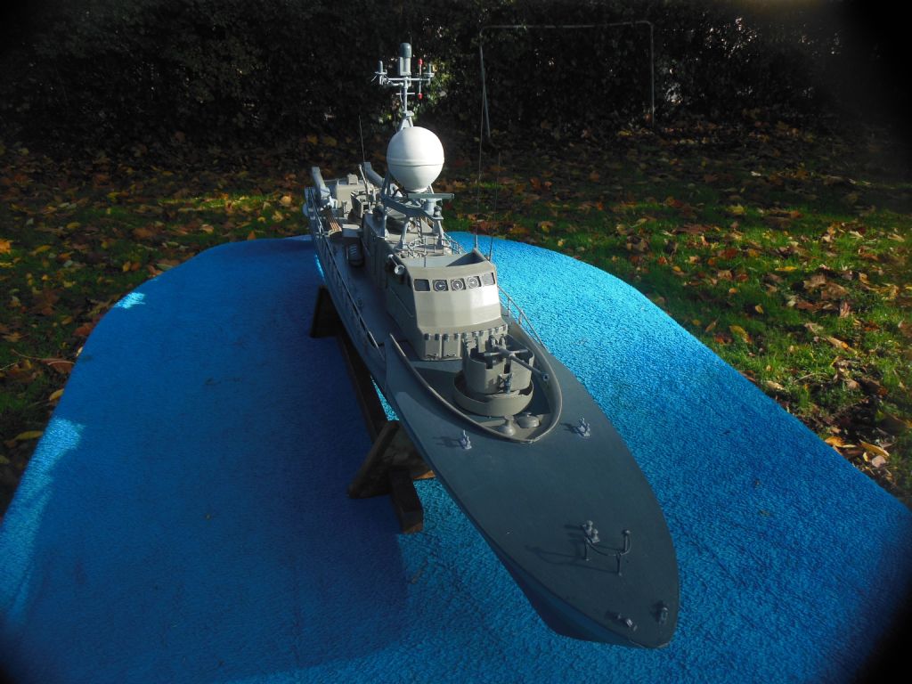

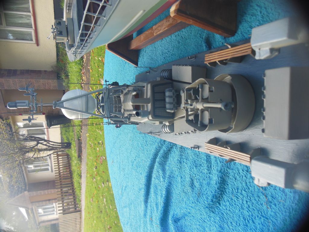

                          cheesed off with picture rotation. originals on d/top all rotated /saved. soon as i post on this site the pictures revert to origal rotation. 2nd time of trying this post no joy. thats life apologies but turn your heads to view

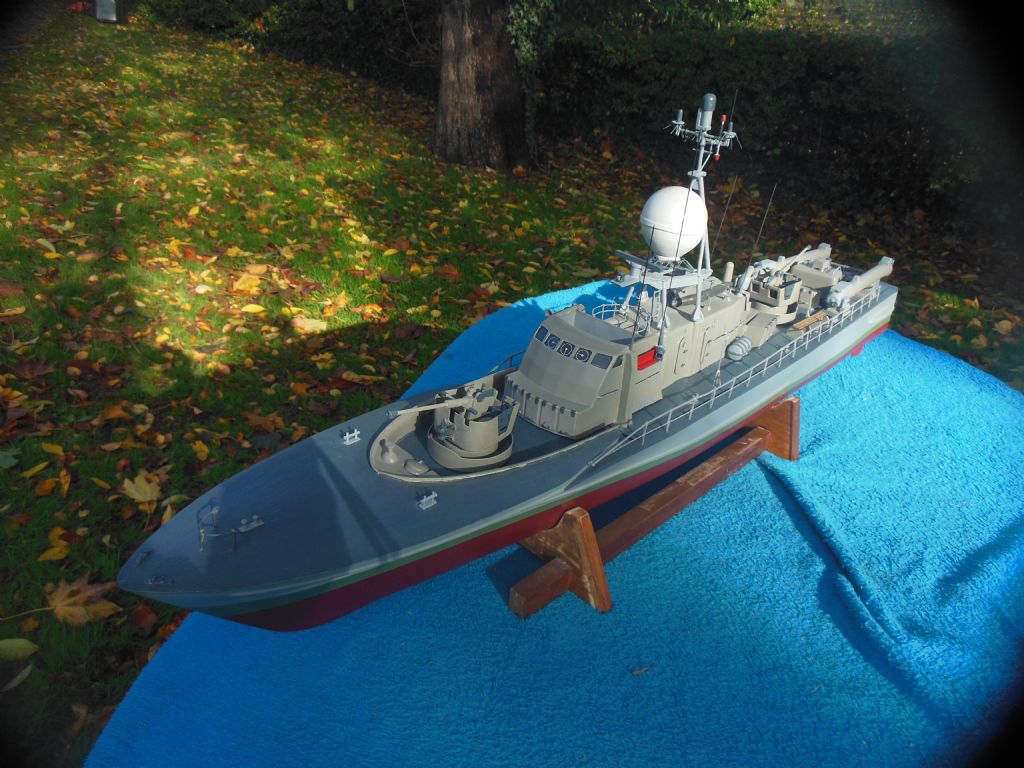

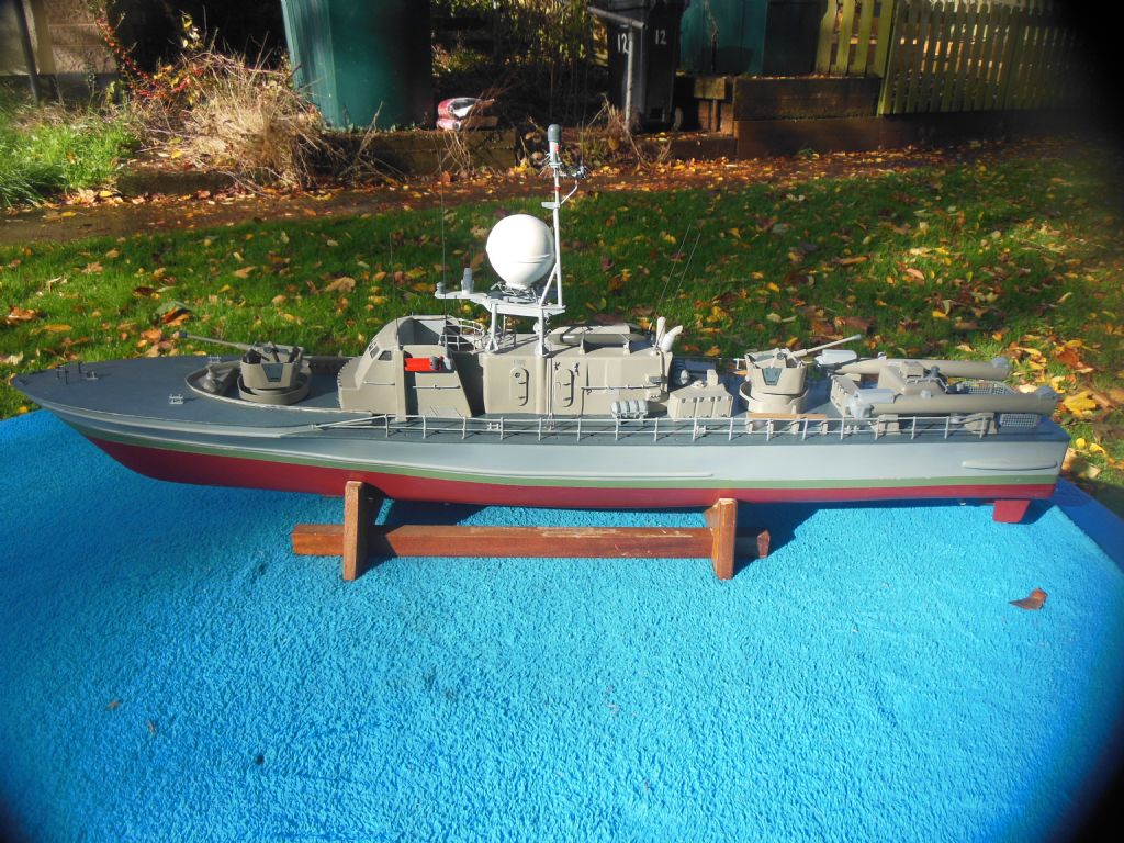

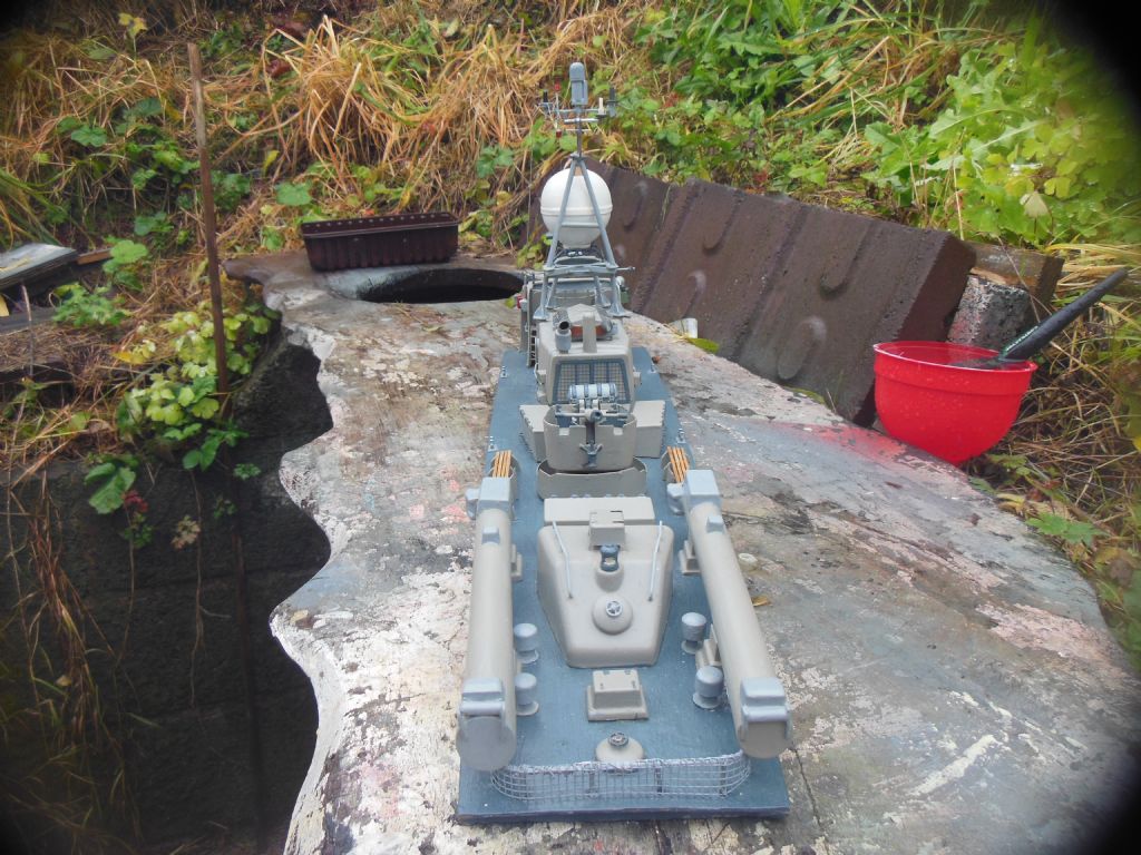

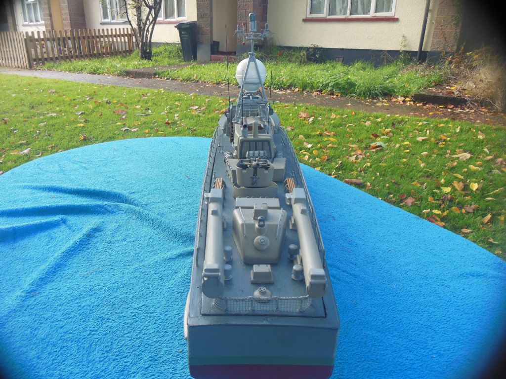

                            all original transfers removed or decayed so improvise. 1/35 military etch brass fittings came usefull. large grating midships was a net from a guppy breeding box and some card. slowly taking shape and i know its scale but i want it back to how i built it back then and to the graupner design. More scale can be added at a later date but I am pleased with the result so far. the hull is waiting for the green w/l to be painted on and sealed. hope you like the refurb so far

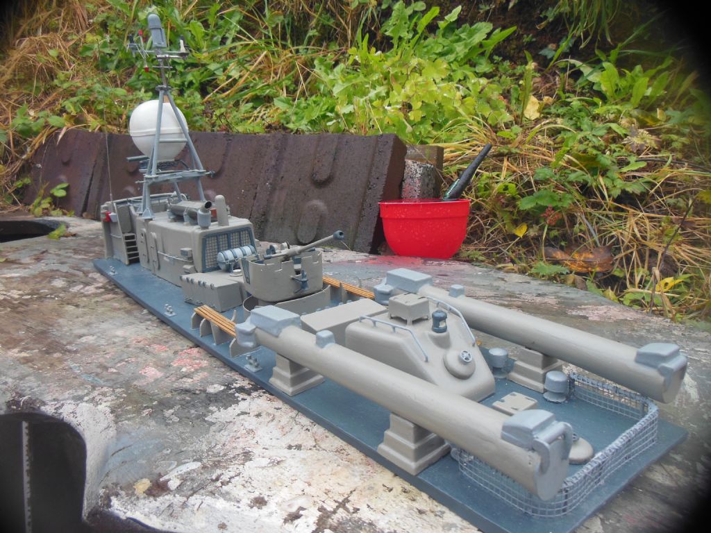

                              smiley 80% of fittings now back on deck,hardest part was the gantry and mast/radio unit on top of it. Decided to virtually make a new one but looks much better than if I had just repainted the old one. Just all the small pieces on deck and sides of the main cabin. waiting for new tiller arm for the 3x rudders. should be on the water by end of next week. enjoyed this project and very grateful to original poster of this thread to motivate me to retrieve this boat from the attic. wonder what else lies therein?

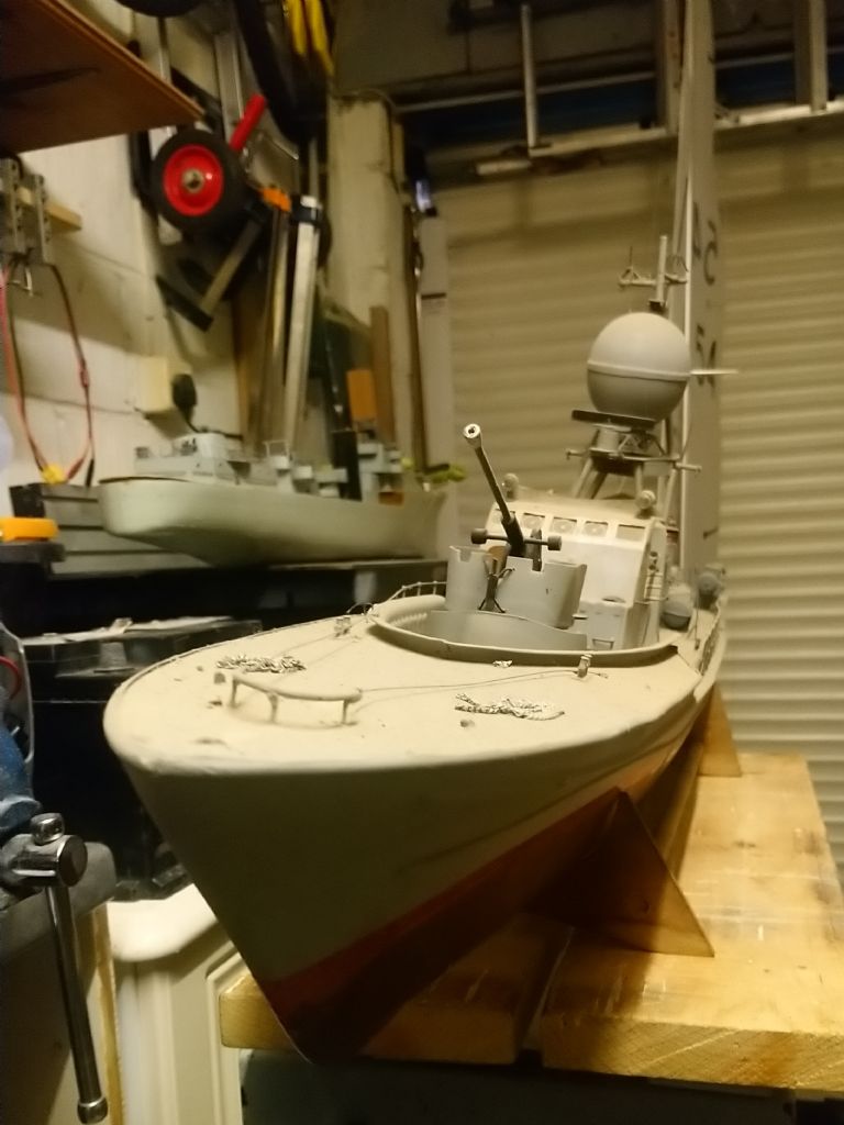

                                  dscn4575.jpgdscn4571.jpgdscn4568.jpgdscn4567.jpgback again guys, nearly there now, a bit of rigging to do and some minor adjustments to r/c gear. should be on the pond end of week depending on weather.its been a long slog but so glad i kept those plans,couldnt have done it without. dscn4565.jpg

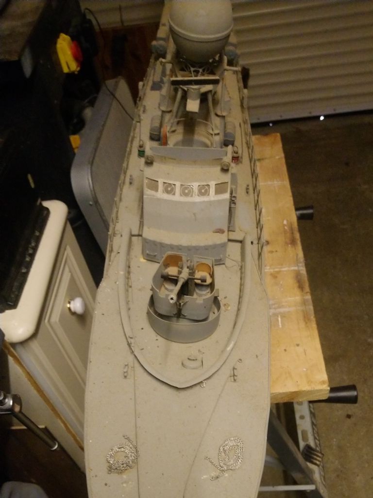

                                              dsc_0014.jpgHave just rescued an example of this model, it has been sat on a shelf in a garage for 30 years, it had the 3 Graupner 2000 Jumbo motors fitted with a 'Bobs Board' speed controller wired to run all 3 motors in unison.
                                              Have begun the task of ripping everything down & if the motors are the actual ones that Graupner designated for it, I would like to keep them as the power units.
                                              Should they prove problematical due to age, what would be the best 'brushed' alternative be?
