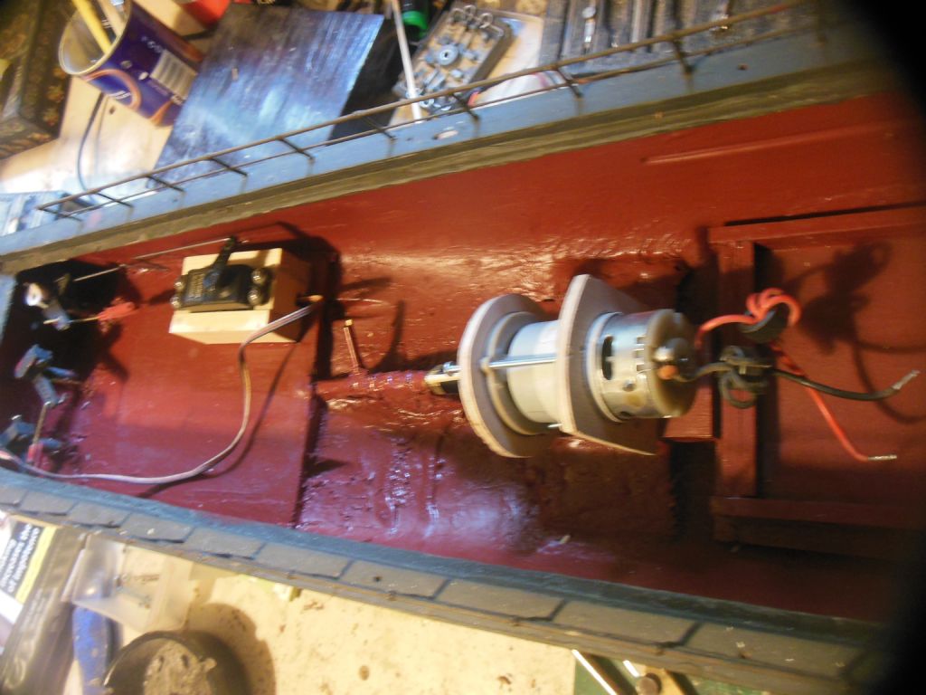

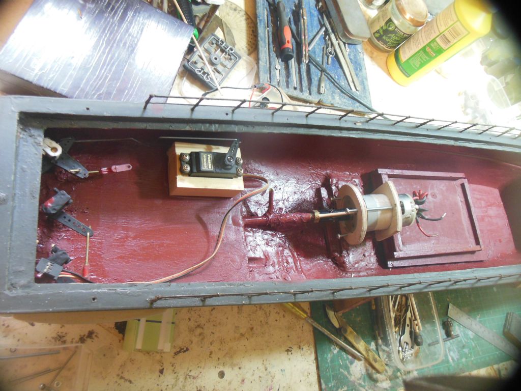

        new motor and servo installation. its a johnson rs 550 looked it up on google and apparently it runs from 7.2v to 14.4.at 7.2 it gives 12000 rpm and @ 14.4 it will reach 22500. that should do just nice as i will have a fair choice of battery size. no load current draw is 1.5 amps and stall is 35 amp (whatever that means) the motor mounts are cut from ply and the plastic mount on the front of the motor will be attached to the ply mount. motor will be removeable if necessary. really getting into this now, cant wait to start main deck and fittings

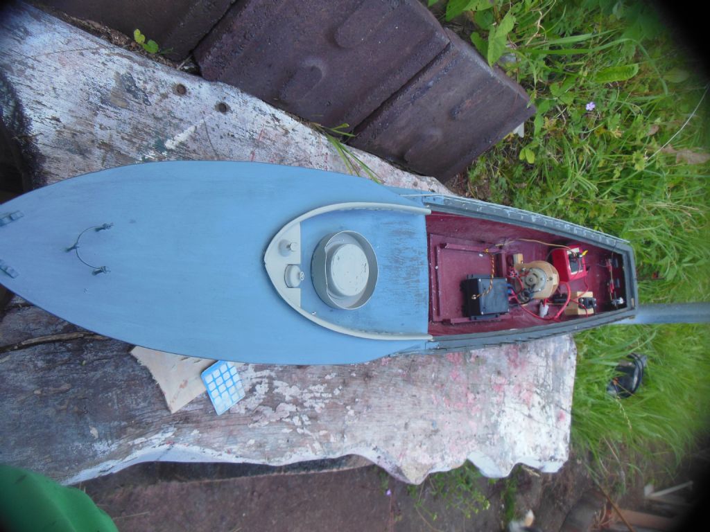

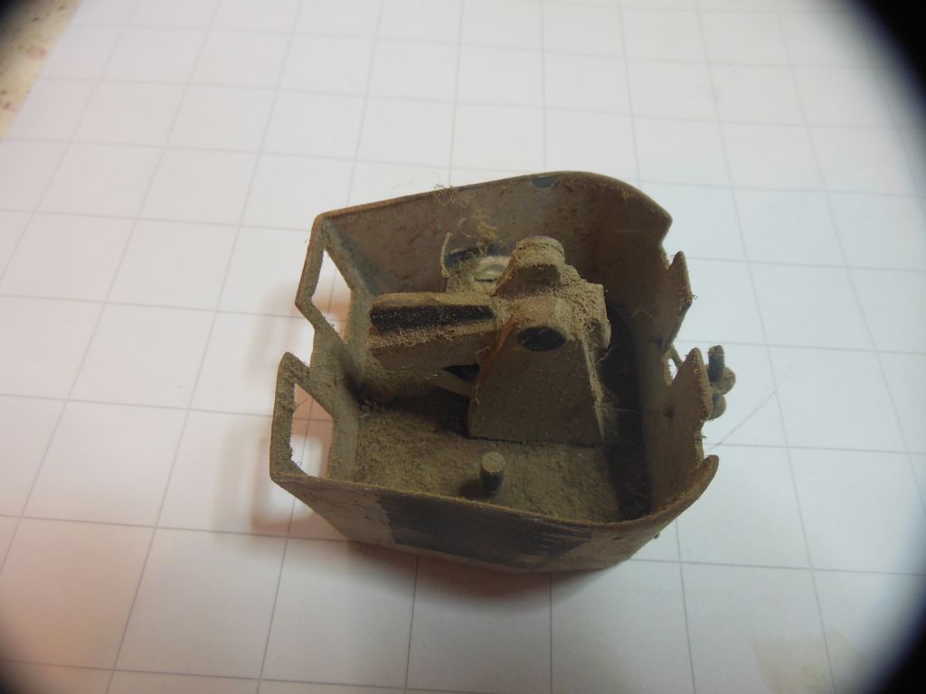

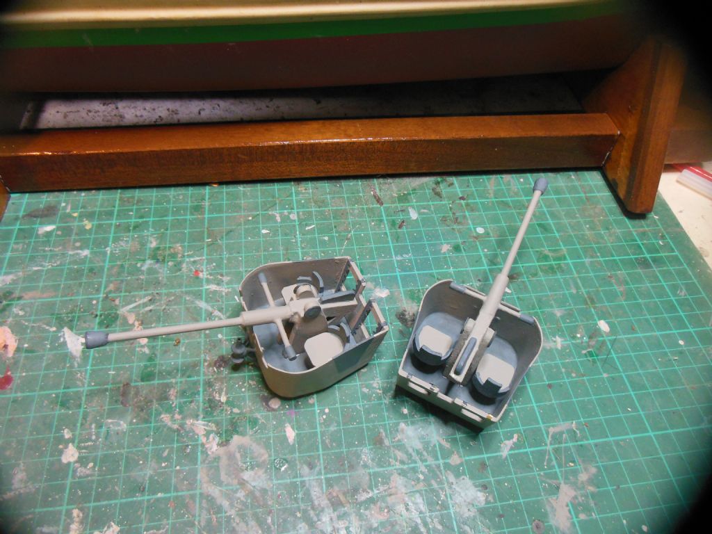

                            Hi guys, back again, still on the refurb, all r/c gear working. 1xhitech sp6/10 from the original set up smiley still working perfectly. just got overlander 7.2v 2000mh batteries. speed controller working perfect with johnson 550. any way here are a few shots of the guns as were and after a bit of work a shot now. quite chuffed. sorry chaps need to load them onto my foto album first, why cant we just take them from or computer i dont know

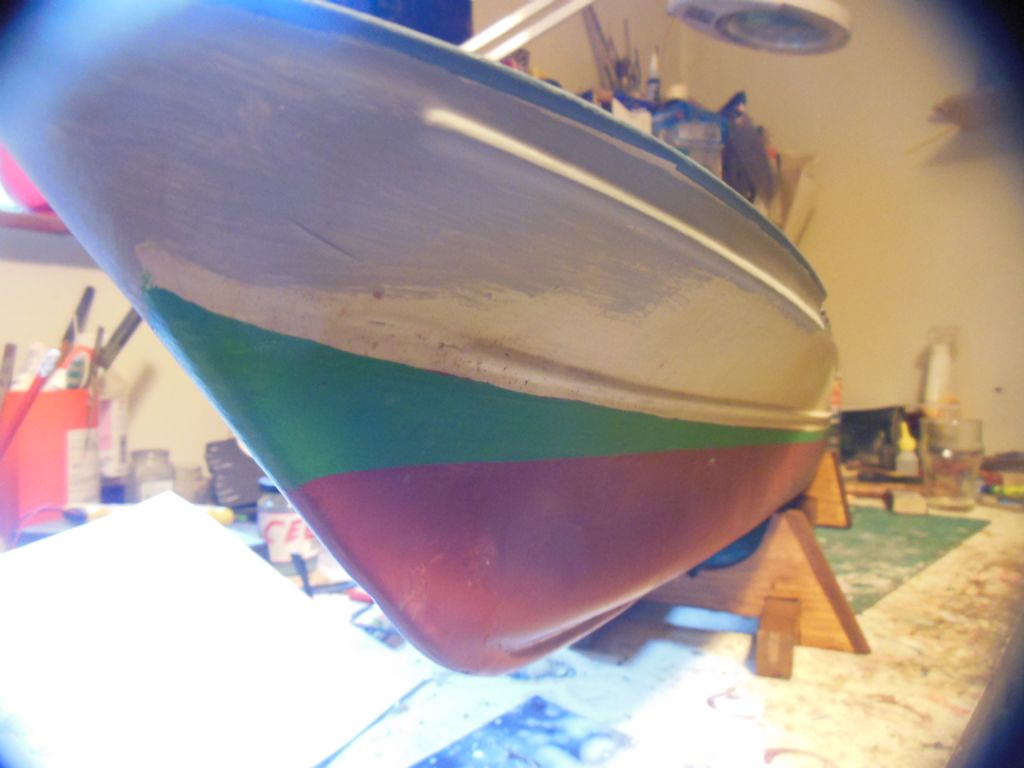

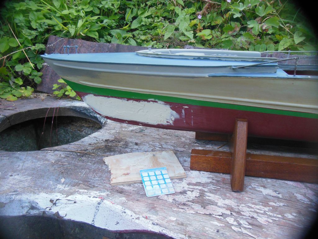

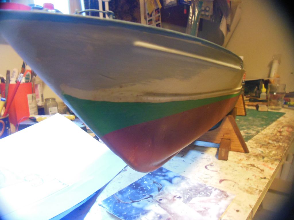

                                dscn4437.jpgmany years of hanger rash on those, my other problem is with the bow. it seems to have collapsed inwards over the years, not sure if you can see clearly on the fotos. about 3 or 4 inches from the bow back can be sorted with filler and sanding. but towards the end of the foredeck it needs nudging out slightly to give the hull a continuous line towards midships.(if you know what i mean) as it is abs plastic i was wondering if i could blast some hot air in and physically push the sides out untill cool? dont know why graupner supplied formers to insert when hull construction took place. all it was were a couple of ply strips across the beam to hold the deck up. anyway i digress any ideas?dscn4438.jpg

                                    anyway, as noone seems to know whether heat will work on abs and hold position when cool I have decided to first try the wifes hairdryer and if not enough heat I have a hot air paint stripper gun. obviously will have to be very cautious but will let you know what happens later.(a melted mishapen hull perhapsfrown?)
                                    #83569
                                      I would try boiling water, with the heat gun you'll put a hole in it very easily 😢
                                      Also consider putting some formers inside? Is it that bad anyway? It still looks like a boat !

                                        as it is 24/08/19cheers ray, tried hair dryer no good. heat gun gently, not brilliant and didnt hold anyway. pushed some foam into the bow and using some filler on the outside, will sand back to shape i think. as you say it looks like a boat and is 40 yrs old.plodding onAll those years in the attic and window sill doesnt do abs plastic any good.bit of filler

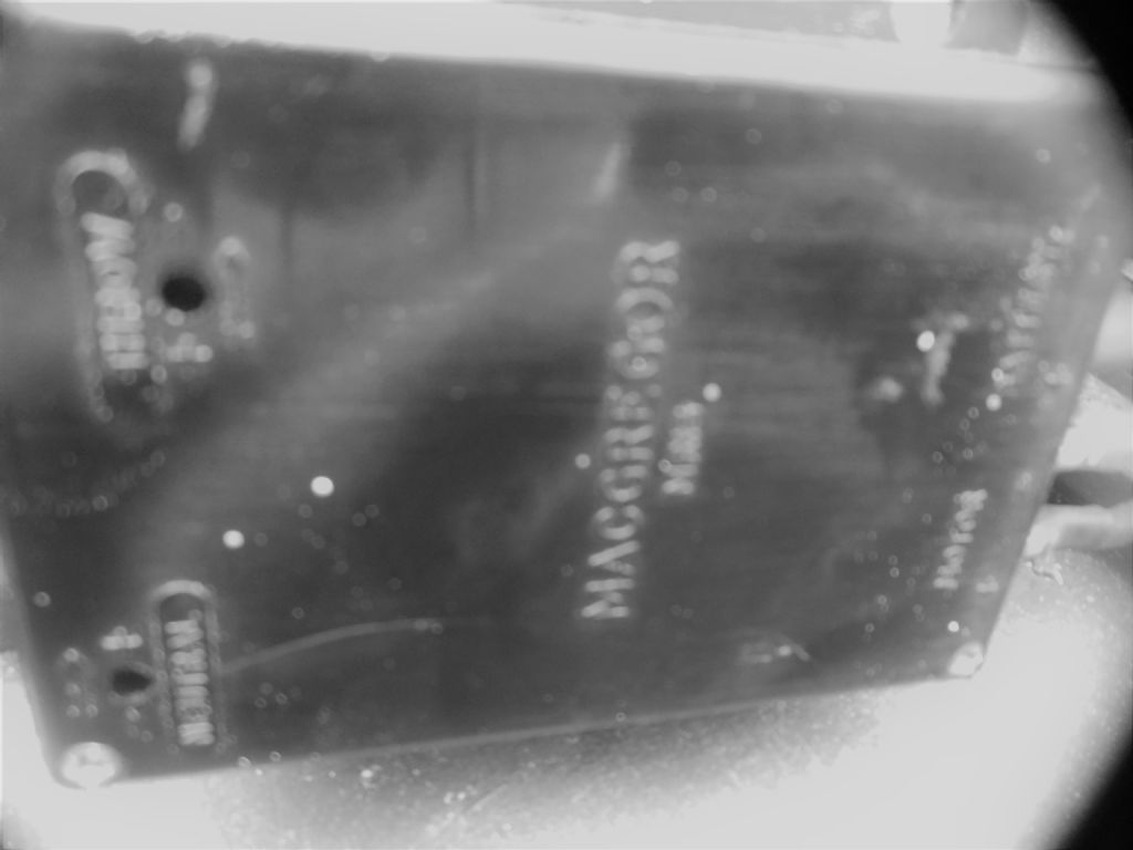

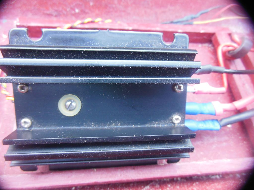

                                          macgregor s/c mr15macgregor mr15 s/cRight bad news first, put hitech esc 610 in. after about 10 miutes trying it out, it got red hot(burnt my fingers) and the motor stopped. not sure if I blew it but out it came. had a 5amp car fuse in line and wondering why that didnt blow first? so,in 1974 my uncle bought a macgregor s/c type mr15. 2 pots underneath,one marked neutral (self explanatory) one "throw". changed servo plug and hey presto. what a beautiful controller, no glitching, responsive to stick movement? so smooth!!! a 40 year old boat with electronics from the 70s. after 15 minutes continual use it was cool to the touch. btw the throw "pot" sets the motor speed to your stick. very clever, Set the s/c to the max speed of the boat type that you are sailing. I think thats how it works anyway. well pleased with a good days work.macgregor s/c mr15
