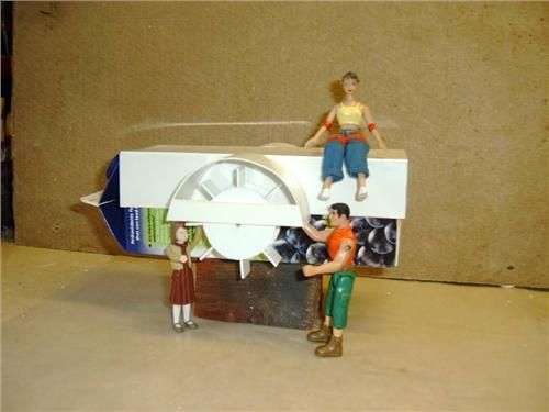

            Motor fitted also pulleys and belt, had a test run in dry dock and it worked ok.

              The paddle blades being full width and full length (like big wide spokes) will pick up water and carry it the full circle of the paddle wheel, just like a water wheel, the problem is compounded by fitting the two side disks, these in combination with the blades have become buckets and will hold more water as the paddle wheel turns.
              The paddle blade should only be solid where it is intended to push the boat i.e. the bit of the blade that actually goes into the water.
              Have a look at the big american river paddle boats and you will see what I mean.

                I thought that before I altered things I would try it out,so switched it on and was pleased to see it head for the other side of the pond,when it got midway some cargo must have moved down in the hold and a list developed causing it to turn in circles and I had to rescue it with a net.
                More things to do!

                  http://www.modelboats.co.uk/wp-content/uploads/sites/5/images/member_albums/2627/Son_of_SS_Great_Britain_001_1.jpg
                  Deck and wheelboxes added.
